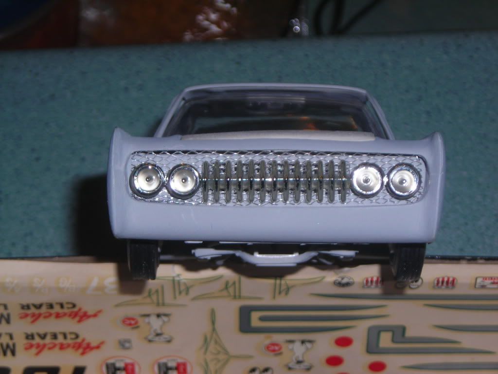

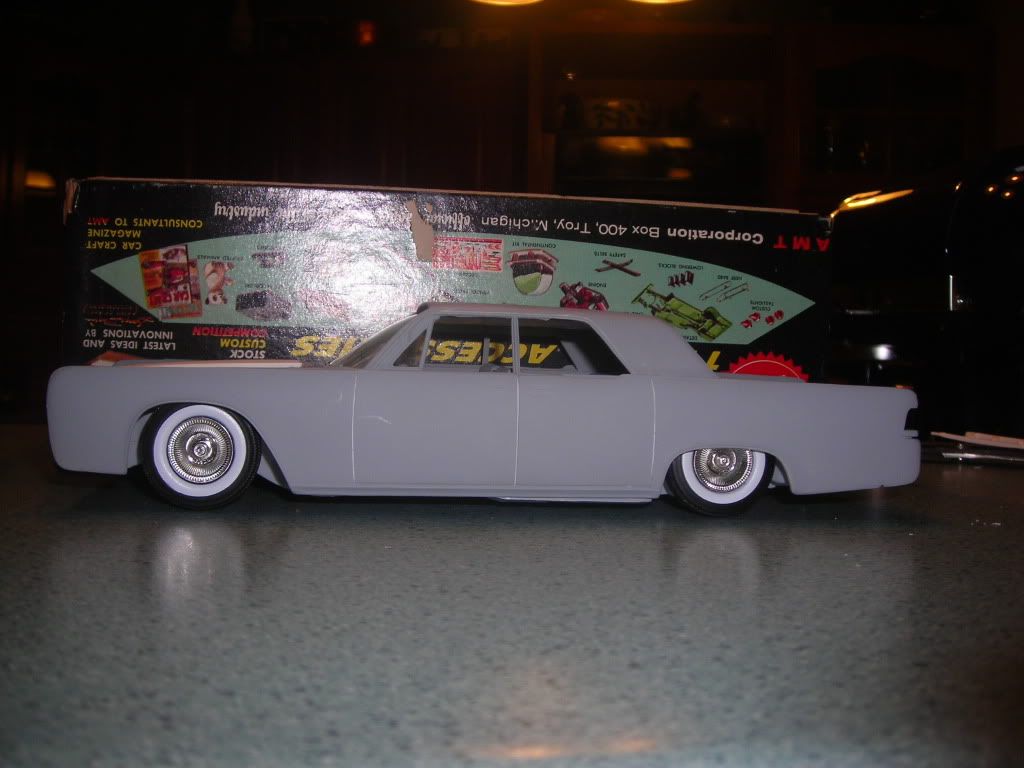

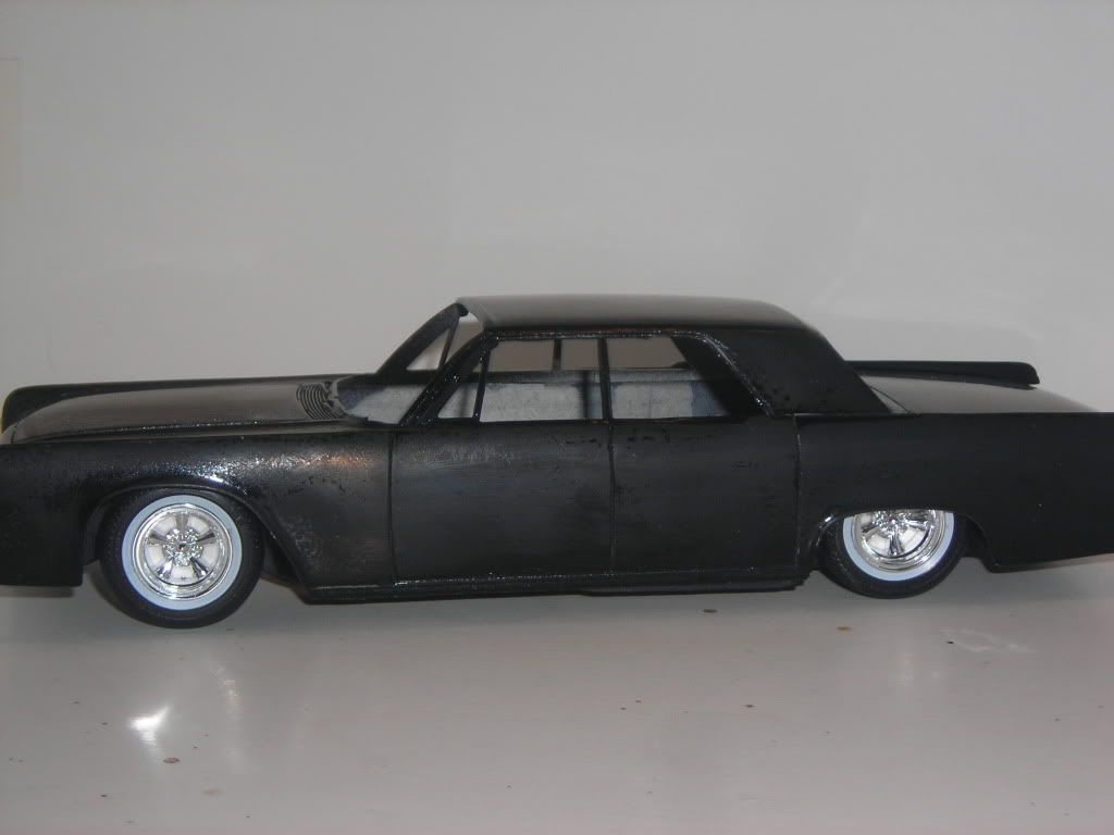

Here is one we don't see enough of built up, Although there are 2 being done here now. This was one of my grail kits until I got lucky enough to grab one on e-bay. Better yet It was 100%, and un-started, and less than $50 shipped! I didn't want to go to crazy as I find it to already be a perfect design in terms of proportion. I did use the custom option front bumper/roll pan, but hated the rear custom option. That said, the stock rear bumper looked odd paired with the custom front. In the end I decided to attach the stock unit and file and sand until it was flush with the body sides, retaining the stock rear light set up. Pictures show the lowered stance, and front and rear treatments. The only parts so far that are not kit supplied are the tires and some mesh behind the front grill parts.

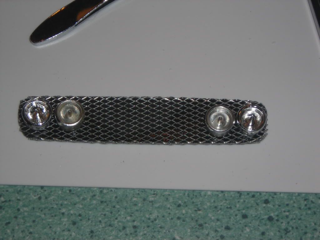

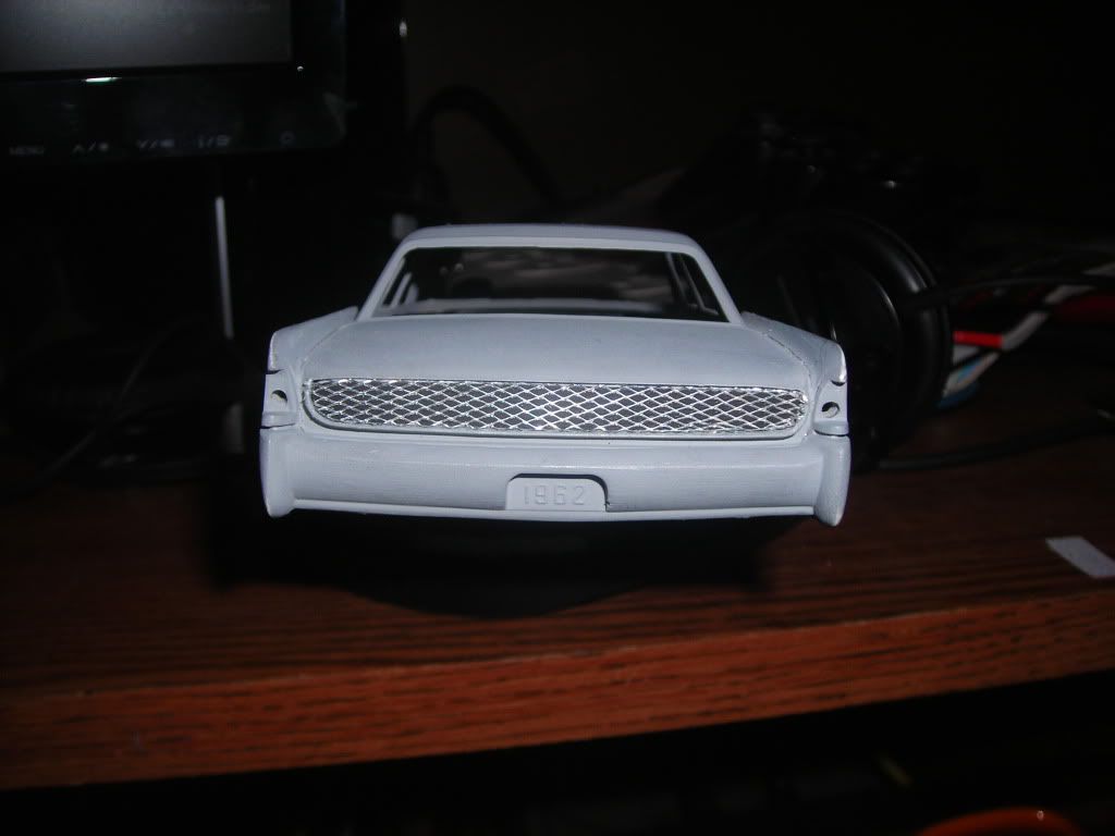

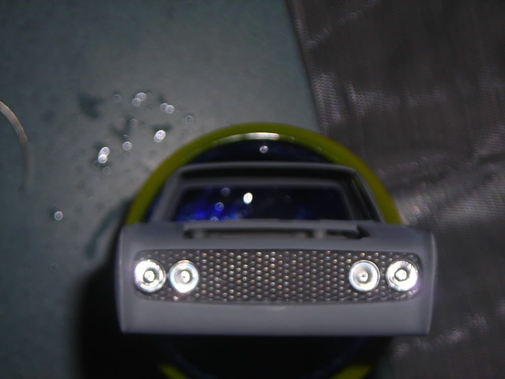

Well I scrapped the grill arrangement I showed earlier, something just wasn't doing for me. I tried a few things yesterday and came up with a solution that makes me much happier. I filed some sheet styrene down to fit the grill opening, painted it flat black so it would not really show on the finished build, and wrapped it in the mesh. This solved my problem of the mesh being so soft it was not holding it's shape without support. I will add small pin heads as "drawer pulls" when I can get to Michaels to pick some up. I was happy with it so I did the same for the rear panel opening.
The finished and glued front panel
this one the lights are just sitting there, not glued down yet.
Here is the rear part, and then it in it's place.

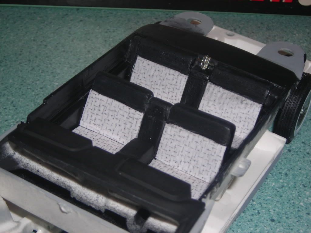

On to the interior next, I will be using Dr. Cranky's paper upholstery trick to put in patterned panels on the seats, white panel on black seats.
Interior pretty much set, I still want to figure something cool for the dash though. I may foil the two pods on the dash and lightly scuff them to replicate a brushed aluminum, we'll see. First time trying Cranky's paper method, I think it came out acceptable? Let me know what you think...

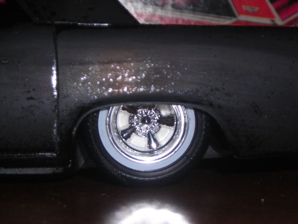

Anyone wanna offer their opinions on which wheel to use? Stuck on which to use, the originals in all the mockup shots or these:
Would really appreciate any opinions, thanks
Hello fellow Green Mtn boy! I love the classic 5 spoke on just about anything, but in this case I like the full covers. Seems to go a little better with the 'sled' theme.
I like the ones you have on the mock-up.
Took the words right outta my mouse, Rob. Those full covers oughta look the business against a black car.
as usual i like the 5 spokes better as a wheel...not as a whole though, it seems to clash styles with the grilles you made
im no fan of the 347 spoked rims (just guessing, i didnt count them) but i think in this case they fit better with the overal look of the car
though they would look even better if they were 1-2 scale inches larger

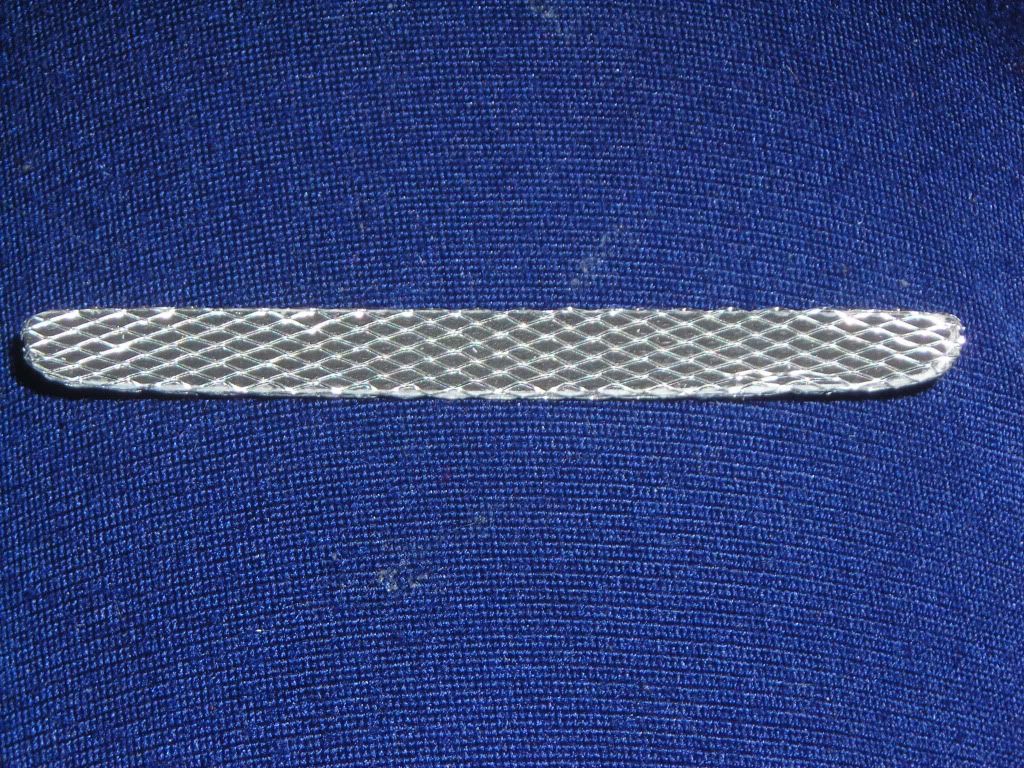

i was gonna ask, where did you get the mesh for the grille from?
im gathering parts to replicate a car i used to own fresh out of college and that mesh would be perfect
The Mesh came from Michael's craft store, about $3 and you get more than you could use in a lifetime.

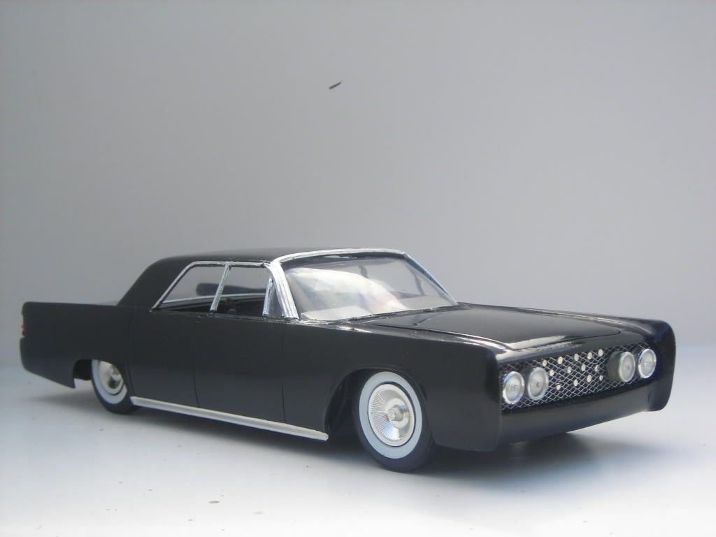

Almost done with this one, just need to do the engine and firewall and put the steering wheel in. I went to the LHS yesterday to get some BMF to do this and all they had was Ultra Bright Chrome, man that stuff sucks compared to the normal stuff I have been using. Really hard to work with IMHO, wish I could have used reg on this one, oh well... Here are a few shots as it sits now.

Hey .. I'm in the Green Mountain range too .. but down here we call it the Berkshires! B)
I really like the work on this one, especially the grills!
I have one small suggestion though. The paper interior pieces look really good, but next time try using a straightedge to cut them. I'm sure it's not even noticeable from a distance, but cameras are nasty when they get in closer than you're view in real time. :)
Very cool build.
