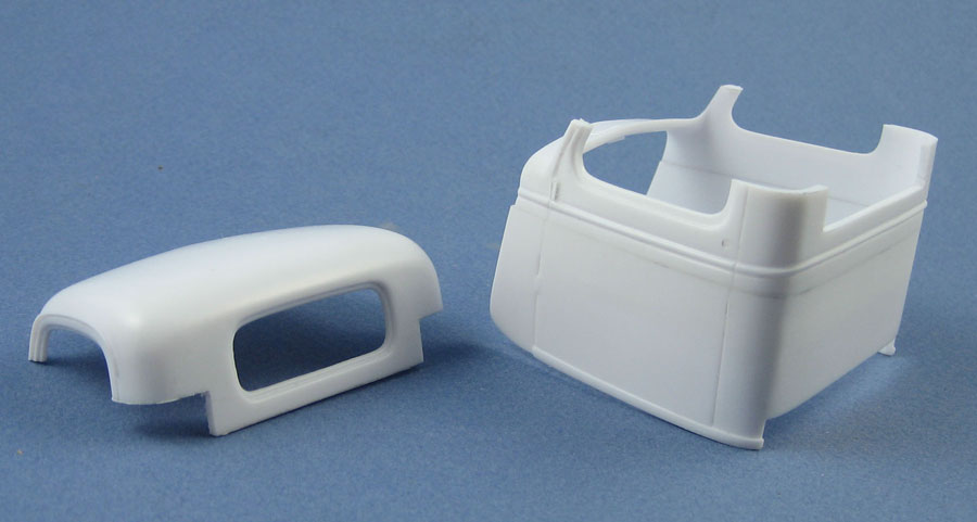

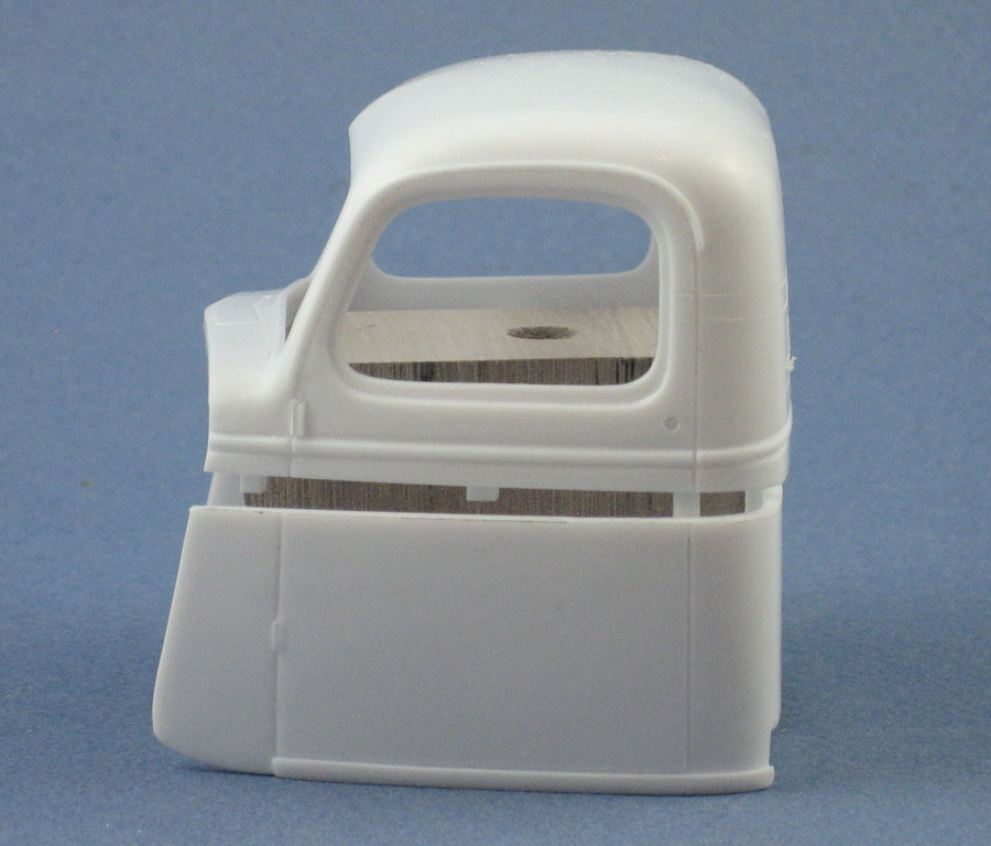

The first thing I knew I wanted to do was to section and chop the body.
This was probably the easiest part.

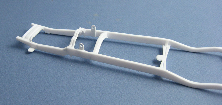

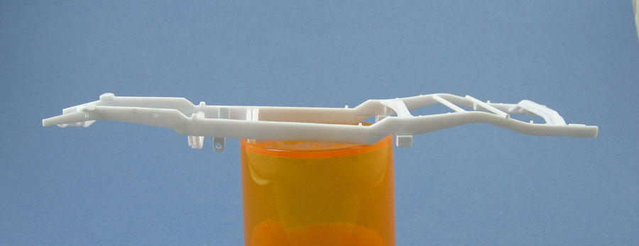

The chassis got some smootherizing too, as well as zeed.
post-10054-0-37949200-1340603415_thumb.j

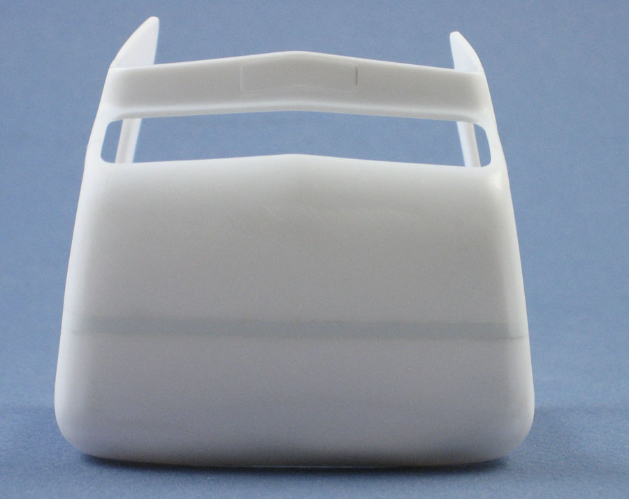

I decided to make it a flip nose but had a problem. If I removed the entire fender
there would be a backdraft with the cab, not allowing it to open and I've never
liked the break line running across the outside of the fender like some set-ups.
This was my solution.

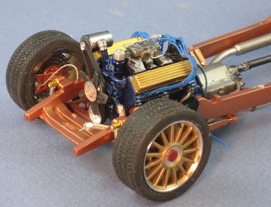

Finally something to show. I used a parts pack caddy engine, just because it looked nice
but I gave in a little to reality and put a double pumper on top rather than a city of Strombergs.
It'll get an air cleaner later. I cut down (narrowed) Pegasus tires and wheels. The wheels and brakes
are stripped of their plating and repainted. I also scratchbuilt the exhaust system and clamps.

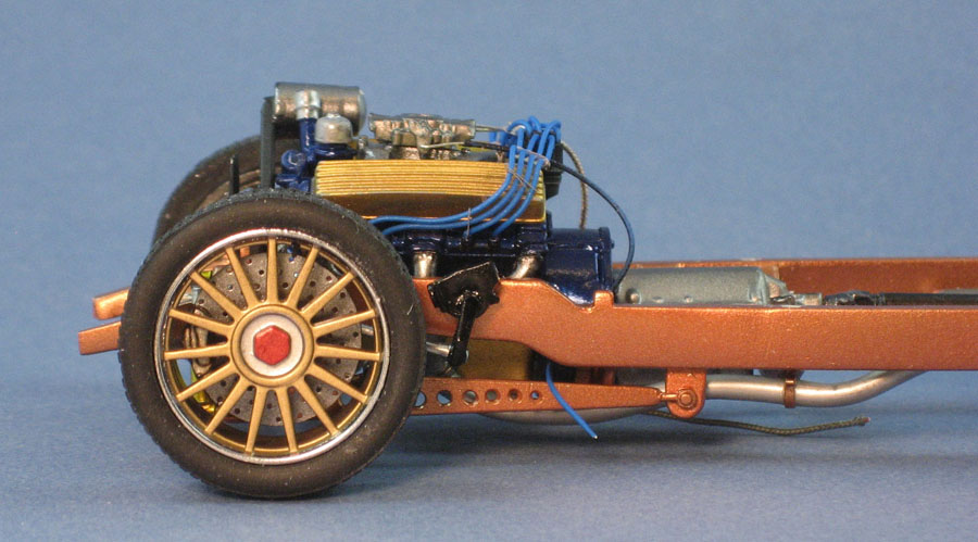

I changed the front suspension to coil springs with a fair amount of scratchbuilding and installed
a Camaro rear because it was lower profile and I had an extra one around.
post-10054-0-30847600-1340604356_thumb.j
I like the way the brakes look.
post-10054-0-81632200-1340604356_thumb.j

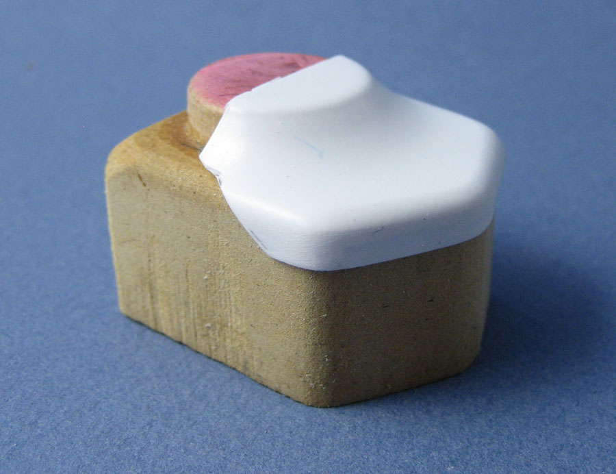

I've done some vacuforming along the way. This is a new section for the firewall.
(I had a serious miscalculation when locating the engine) There's also the back
of the bed,tonneau cover, wheel wells for the bed and some minor parts.

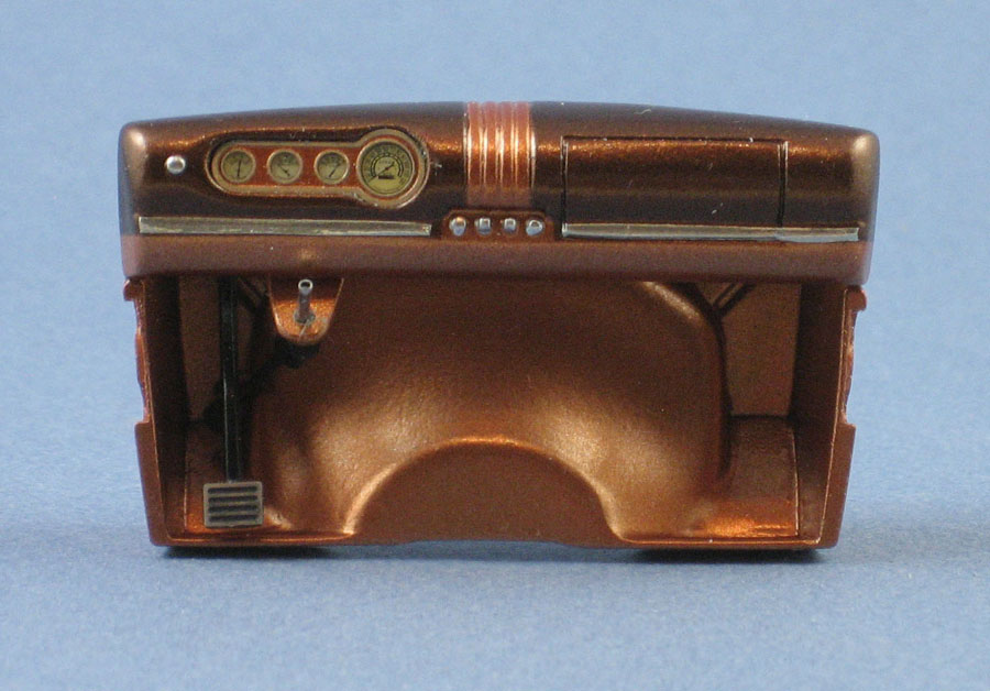

I filled in and recut the dash for this nifty PE instrument panel.
post-10054-0-02832800-1340604359_thumb.j
post-10054-0-53225000-1340604359_thumb.j

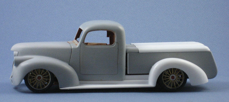

Mocked up again, I can't believe I finally got that flip nose to work. (for the moment, at least)
I like it, although I think a shorter bed would improve the proportions.

woow looks great. how much did you chop and section the truck?
I think it came to about 1/8" on each. I lost track because I went back after the first cut and cut some more.
