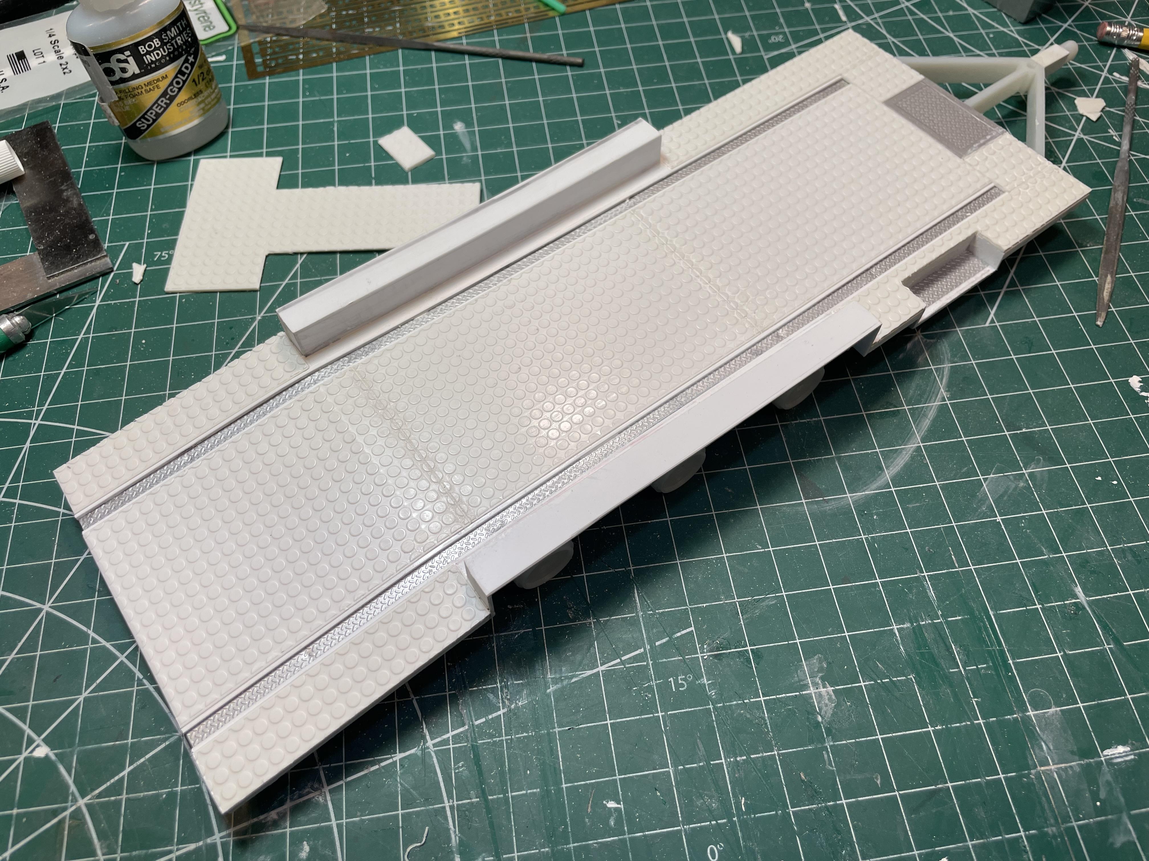

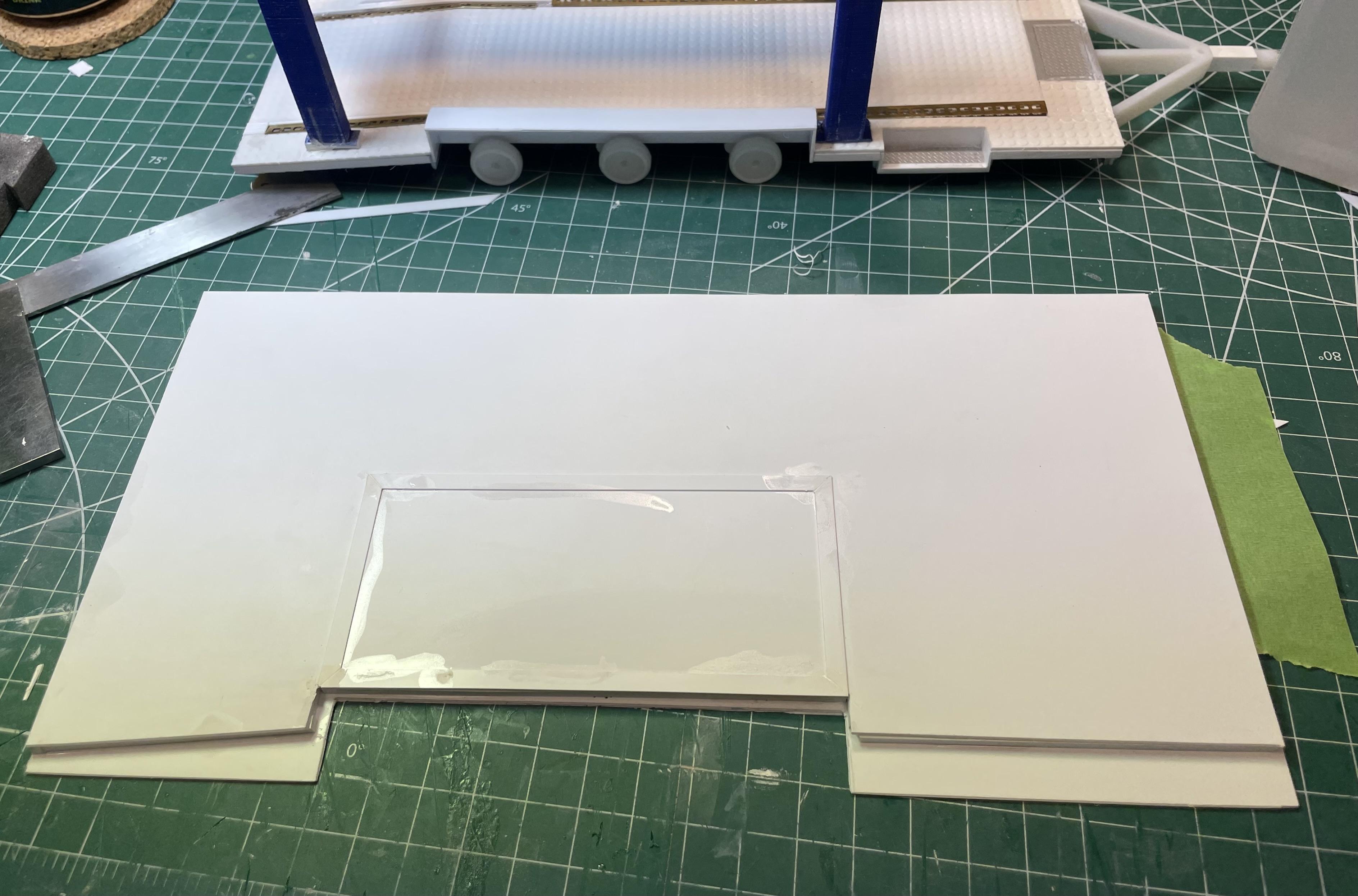

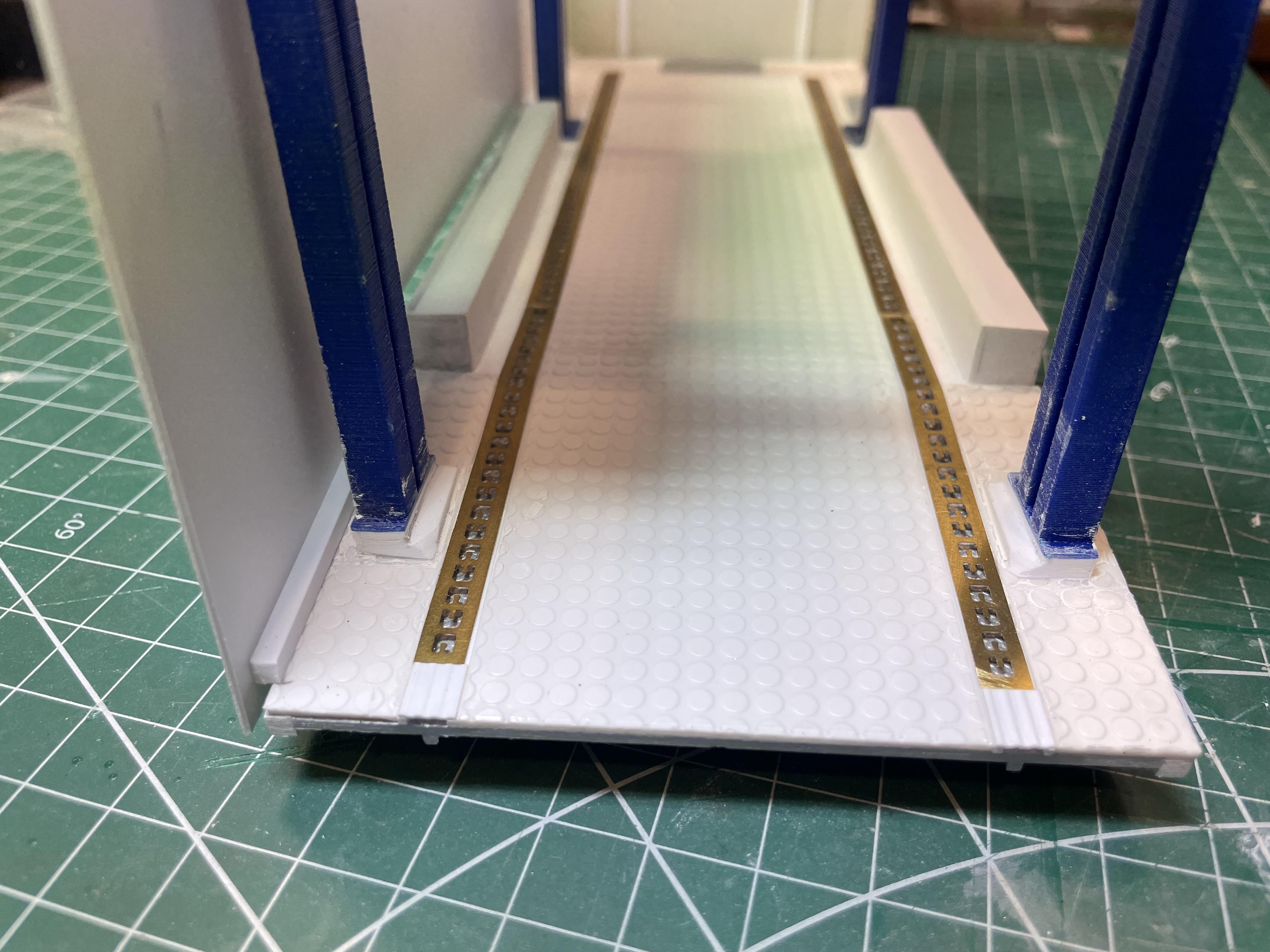

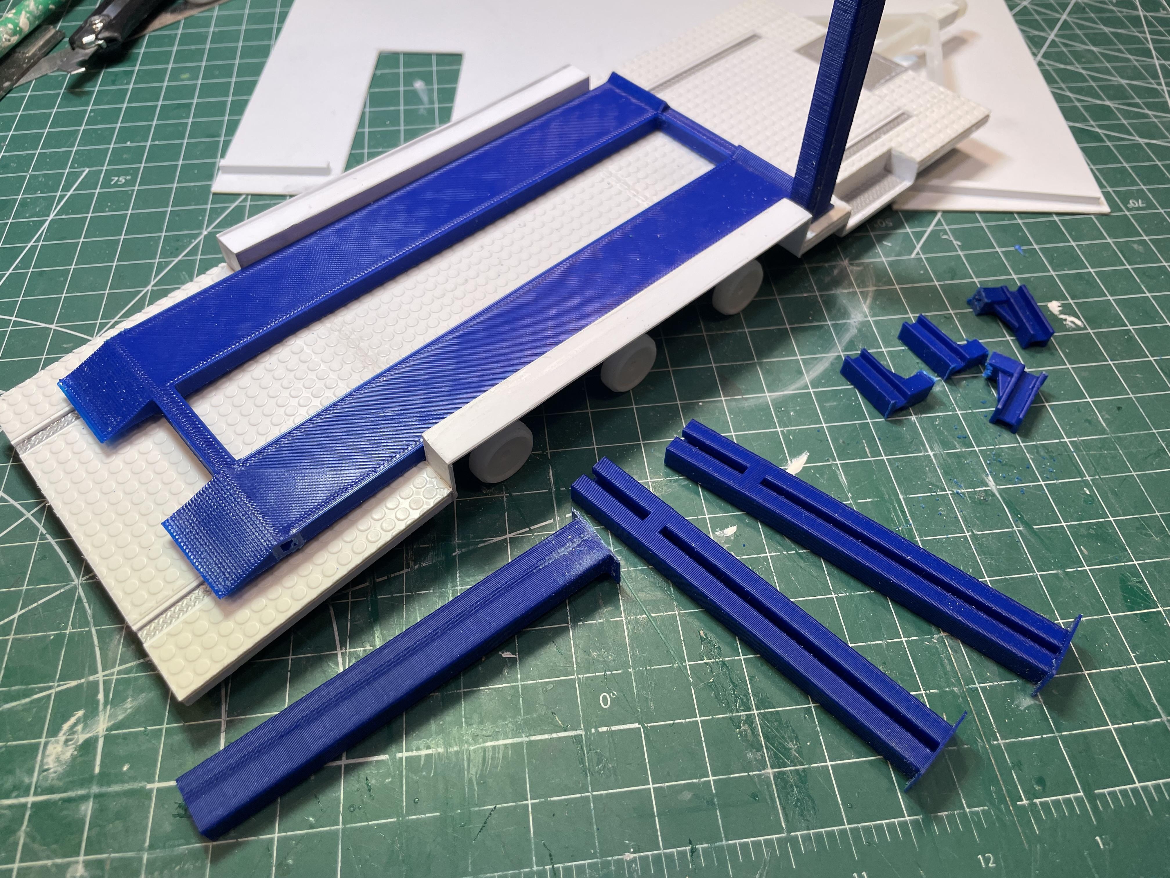

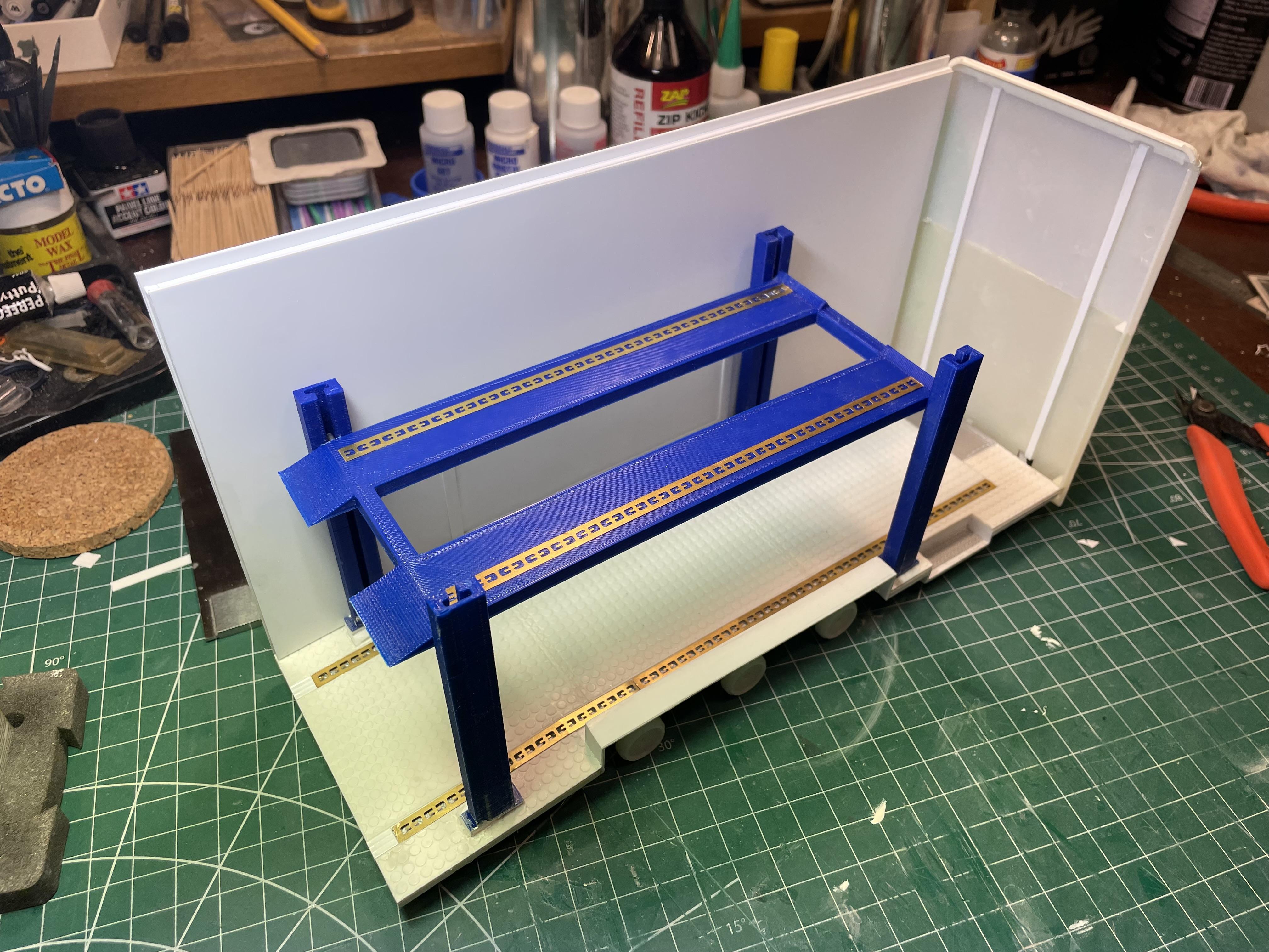

  1. It’s been a few months, but here’s another update…completed the stacker trailer flooring, lift, and one of the interior walls. I used 1/24 rubber coin flooring from Plastruct. I wanted a different look from the typical diamond plate, and it gave me the opportunity to elevate the photo-etched “track-style” tie down system from Tom’s Modelworks. The diamond plate will stay put in the side door step well and the floor winch door. The 3d printed lift is from BCS Trading on eBay. At a scale 14’ long, it was pretty close to what I wanted as is, but I had to narrow it a little by removing the mounts on the lift deck. I added pins, and as a bonus, it’s removable. The deck can be positioned in the up position, or laid on the floor for loading. The lift columns will mount plumb against the interior walls. The left sidewall is now complete. I added “studs” to the .040” exterior sheet, then the inside wall was added, along with the frame for the non-operating escape door above the wheel well. It’s pretty sturdy, as it needs to support the body. I’m planning a removable roof for display purposes. Next up, the other sidewall, front cap and rear door. I’ll also be working on the cabinets. I’ll prime and paint the floor, lift, and interior, too.
