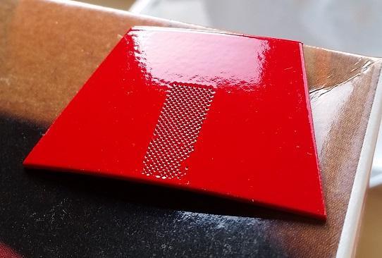

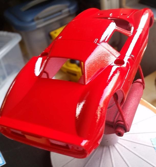

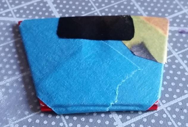

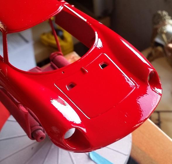

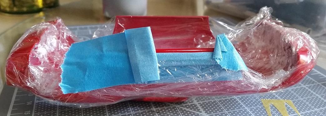

hanks for the kind comments!So the original reason this got shelved is that the paint work did not go so well. First time I had tried to use Zero Paints 2K clear. I was spraying over Tamiya Red from an aerosol can (it was left for 2 weeks to dry) It turns out that the recommended 15% thinner doesn't work, since I have used 40 to 50% thinner, and this stuff sprays really well. But it takes so long to spray, I find that the 2K starts to go-off in the airbrush after the 3rd coat. Anyway, the paint finish was awful, as seen in the photos, I spent (on & off) a couple of months sanding it out - which is where I am today, I have recently masked off a few areas to re-spray - I had some of that Tamiya red left in the can, they are in inconspicuous areas, so I will give it a light dusting... When it's dry, I'll start to finish up, I'm still undecided as to whether to cut out the door sides... Re-spay is here - where I had burned through the finish coats:
