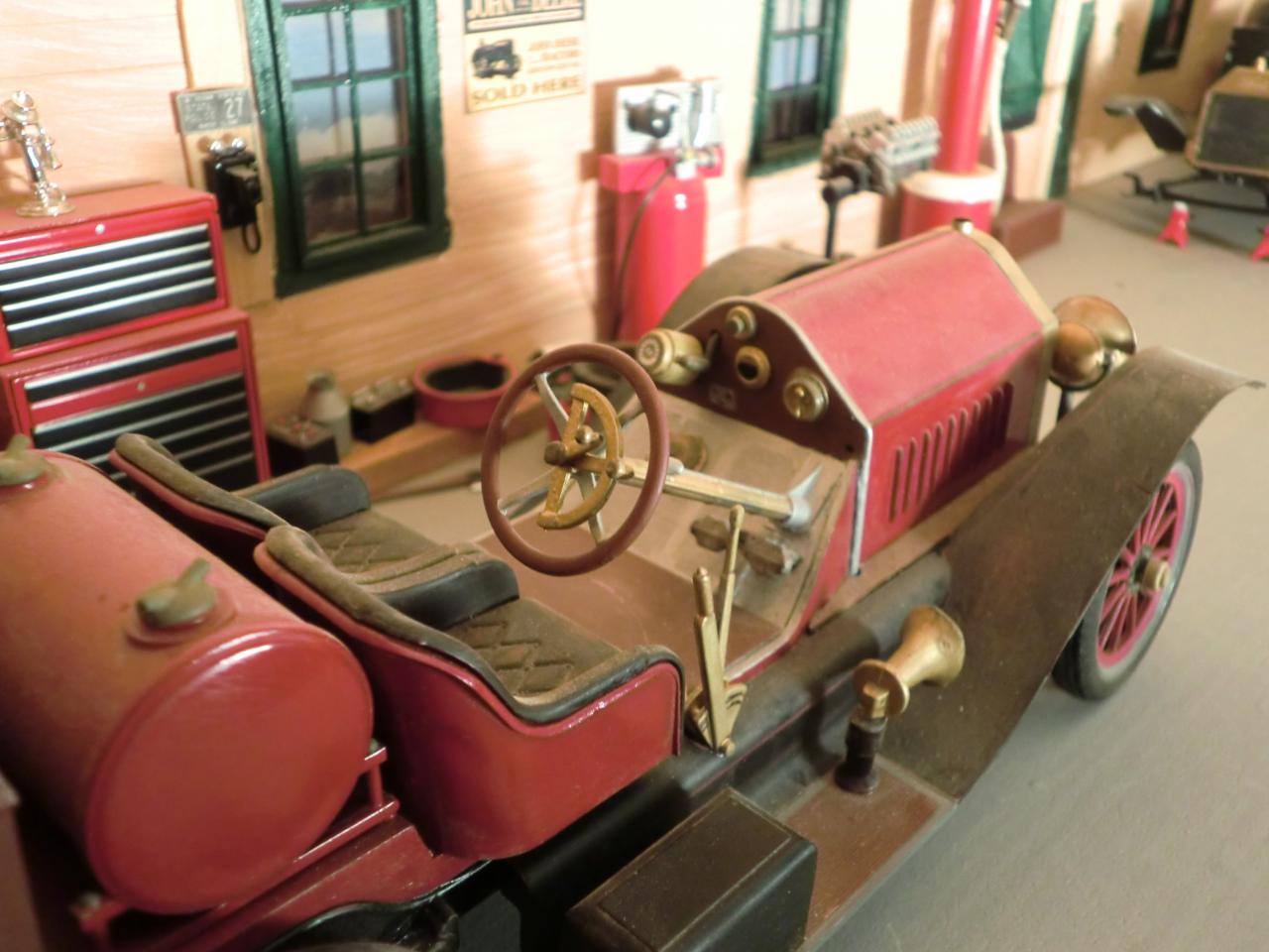

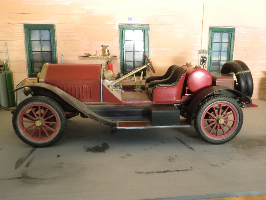

  1. Sorry to do this to you Harry. the first comment I had on this post was about the gas tank being too high. I dont know why Aurora put the step in the frame but the real car didnt have it.what I just did on mine was get rid of the base that tank and tool box mounts on.sawed it level to back of seats where the frame steps down] cut the lower part of the tool box down and the tank mounts should sit directly on the frame. on the real car you can see the gas caps are at the top of seat back level. you are probably going to boot me off your post for this but I think its important. [i feel like Columbo here] heres what I did to mine.......

  4. more progress..... #1-front crossmember made up. #2- radiator cap #3-temporary set up-showing hood top hinge and moulding around cowl. #4- louvers added and those massive exhaust ports-also undercarriage details such as flywheel and oil pan. #5-taken a bit earlier in the build-still a long way to go to look like the real thing.
  5. THANKS Fellows-for the nice comments-I am glad to find some people who appreciate this stuff! Now -piping going on bucket seats. and completed seat-once it was toned down with dull coat it turned out fine.

  8. I just noticed something else-the plate on the floor below throttle spoon. it actually is an indented casting to hold your heel because the throttle spoon is so close to the floor. heres a pic. Radiator looks great and is correct - most Bearcats had painted radiator shells but they were brass underneath.
