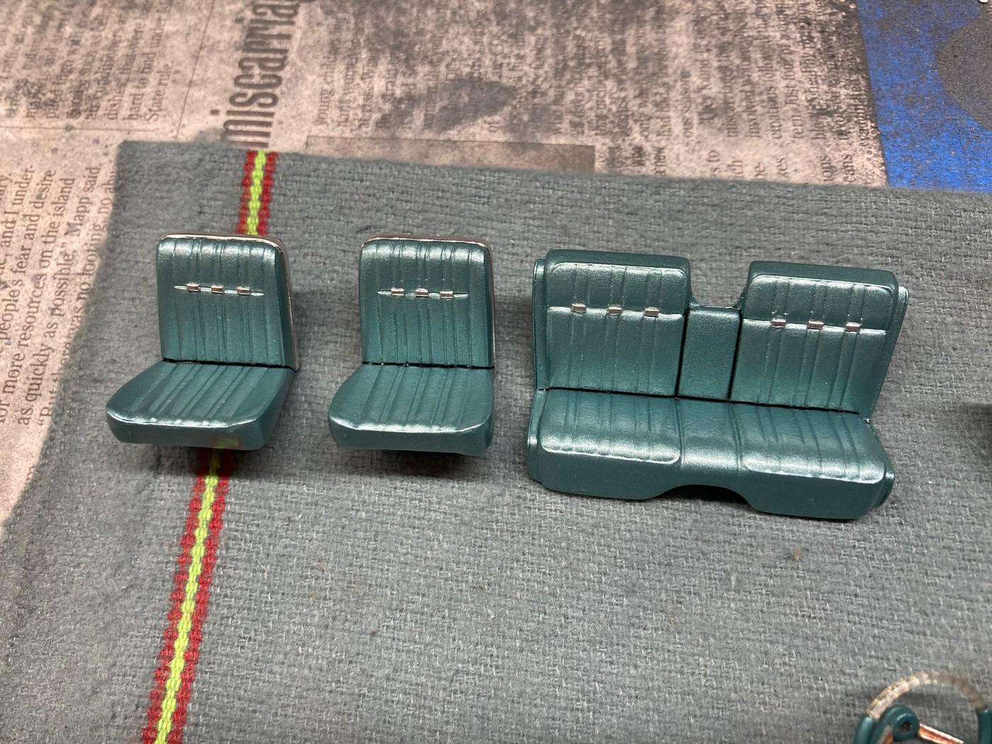

  1. If you're using good primer, (I use mainly Duplicolor) there won't be any excess thickness to speak of. Likewise, lacquer paints will go on much thinner than enamel, which is a small part of why I use lacquers. They dry so much faster and thinner, and the color availability is endless. Primer sealer is just what it says. It seals whatever is underneath it in place to prevent bleed through and it also helps with the gloss of the paint coats. There are many viable glues to adhere parts, whether they're clear or not. Personally, I use clear 2-part, 5 minute epoxy for nearly everything. The hobby has made great strides and advances since the days of tube glue and rattle can enamels, but I'm sorry to say that it can take years, or even decades, to find the right procedures that work for you. Just as an illustration about paint thickness, take as an example my current '64 Bonneville project. This model has 5 coats of lacquer primer/sealer, 5 or 6 coats of color, (lacquer) and another 5 coats of clear lacquer. There is no heavy paint build up or detail hide whatsoever. The materials you use are the true measure of whether or not you will have success. Just as much so as the techniques or processes that you use. Steve
