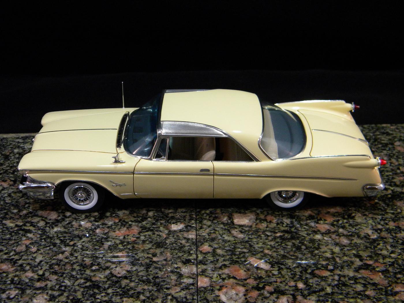

If you really want the machined surfaces of the rotor to look used, my suggestion would be to scuff some BMF with a fairly fine sand paper in whatever pattern you would like while it’s still on the backing and then apply the foil to the rotor surface. I’ve used this technique for the brushed stainless steel panels on the roof of a ‘60 Chrysler Imperial and it worked quite well. Steve -

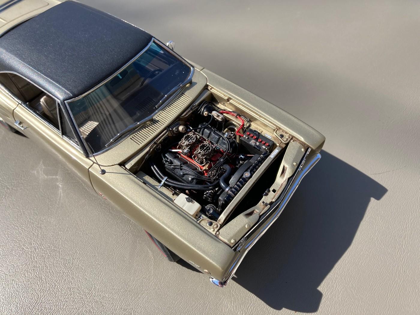

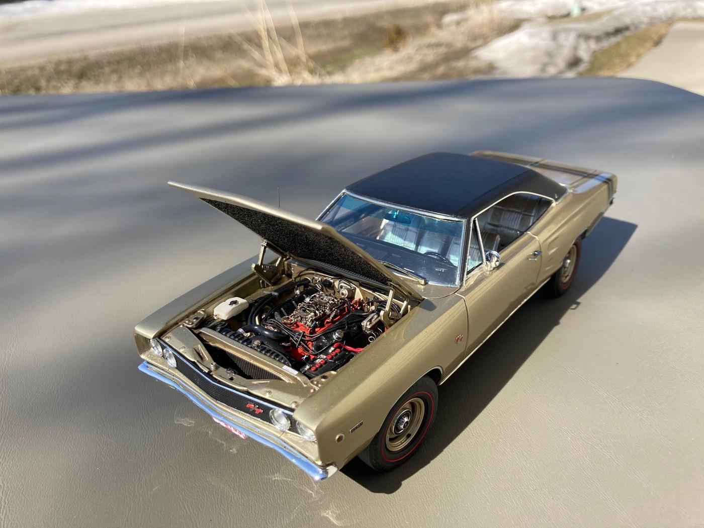

Well, as long as we’re adding new stuff to old threads, I can’t pass this one up without posting a few shots of the Hemi in my ‘68 Coronet. My favorite engine and engine compartment to date. Steve -

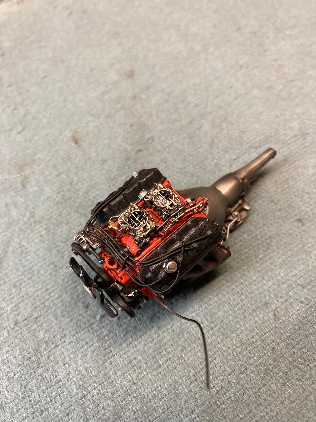

Thanks fellas! Well, the 4-speed, 4 barrel, 389 is finally finished and ready to install, (once the chassis is complete) Since the last engine update, I've installed the exhaust manifolds, transmission, fan belt, fan, breather cap and dip stick. I also added a little alternator wiring and some more road grime to the lower half of the engine. Chassis modifications have begun. Steve -
