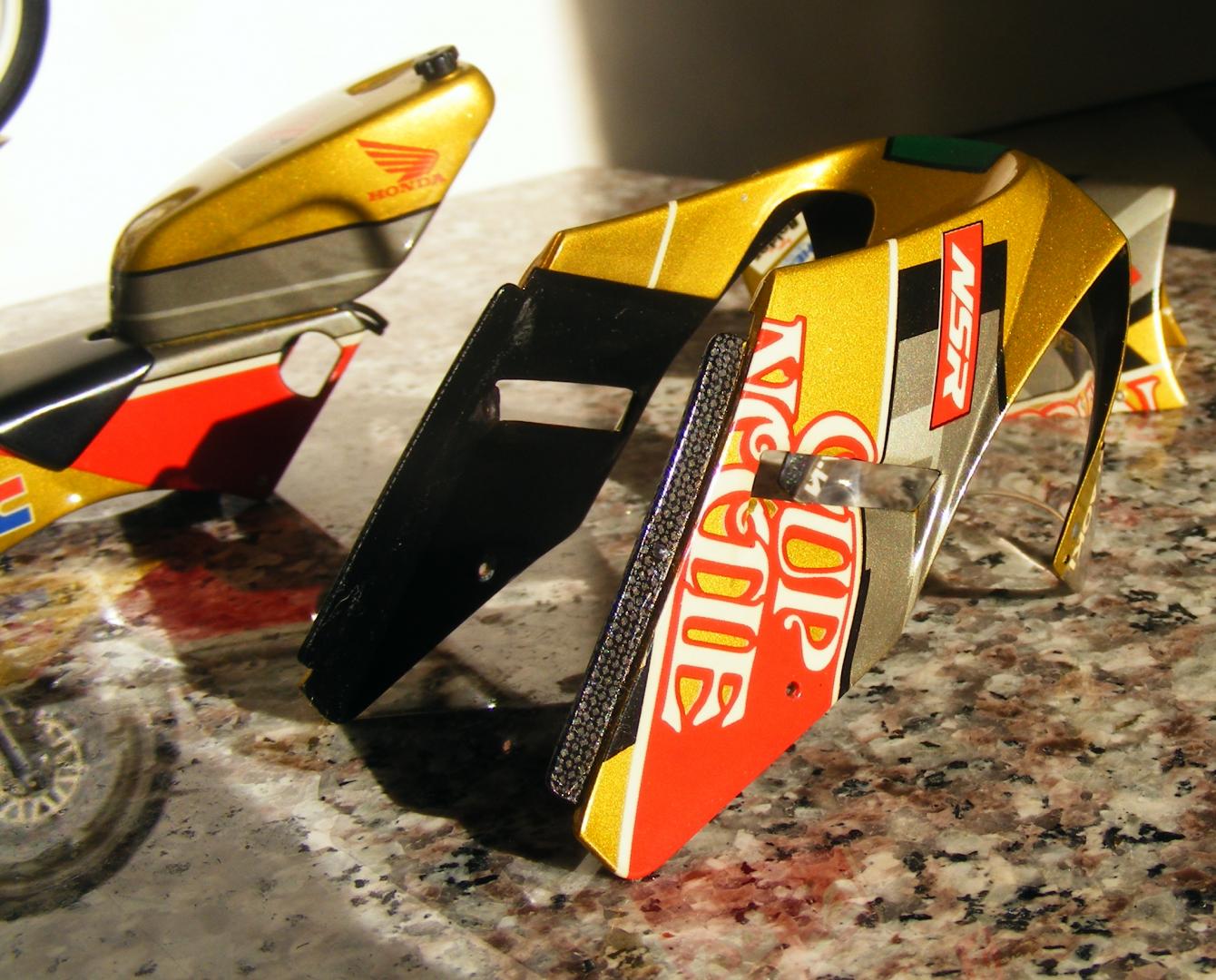

Turn Signal Amber for sure but as Snake said, play with the base color. I've used it over Copper, Gold, Brass and even Yellow. You want to play with the gold base to get that color because the Amber is a transparent candy metallic color. It likes the Gold because its the brightest of the list. Aluminum washes it out badly. I used the Amber and toned it with just a smidge of clear green off a 1/4oz bottle of Jade Green Metallic. This is all over Gold base and in direct afternoon sun through the window. Look through the Metalizer line also for some gold colors. It might help the tone but not the size of the fleck because my Gold laid down almost reflective but it was all lost through the larger flake in the Amber. There is a compliment to the Amber with their Stop Light Red metallic. I haven't tried it as a toner to bring more orange into the amber but I'm sure it would work okay

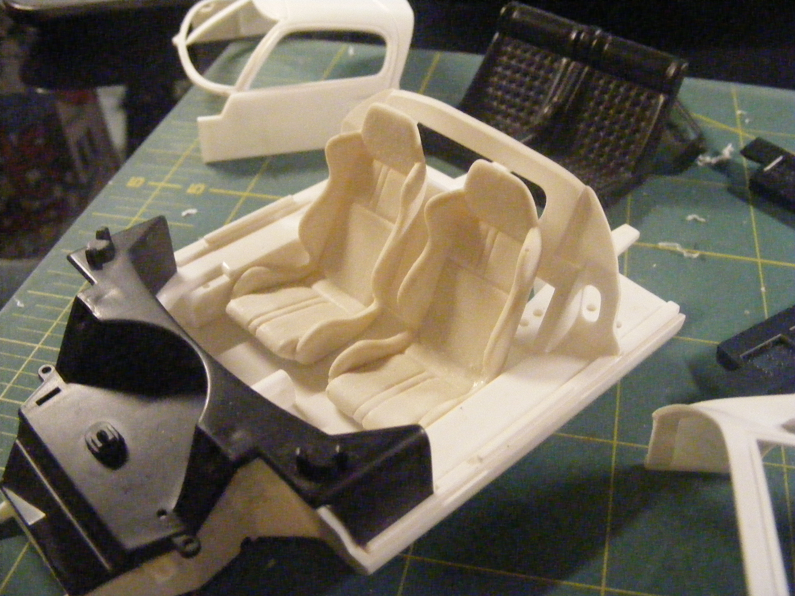

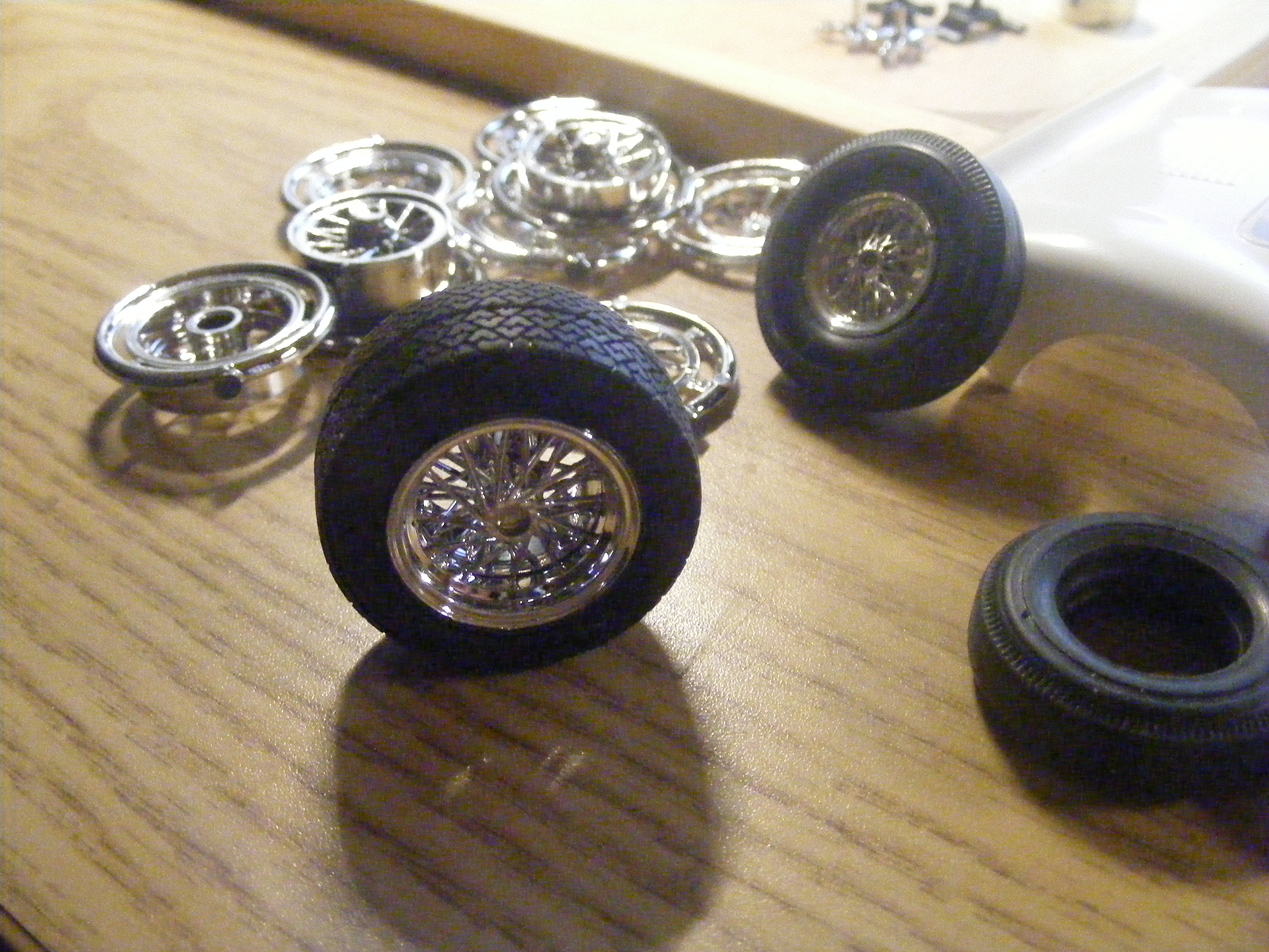

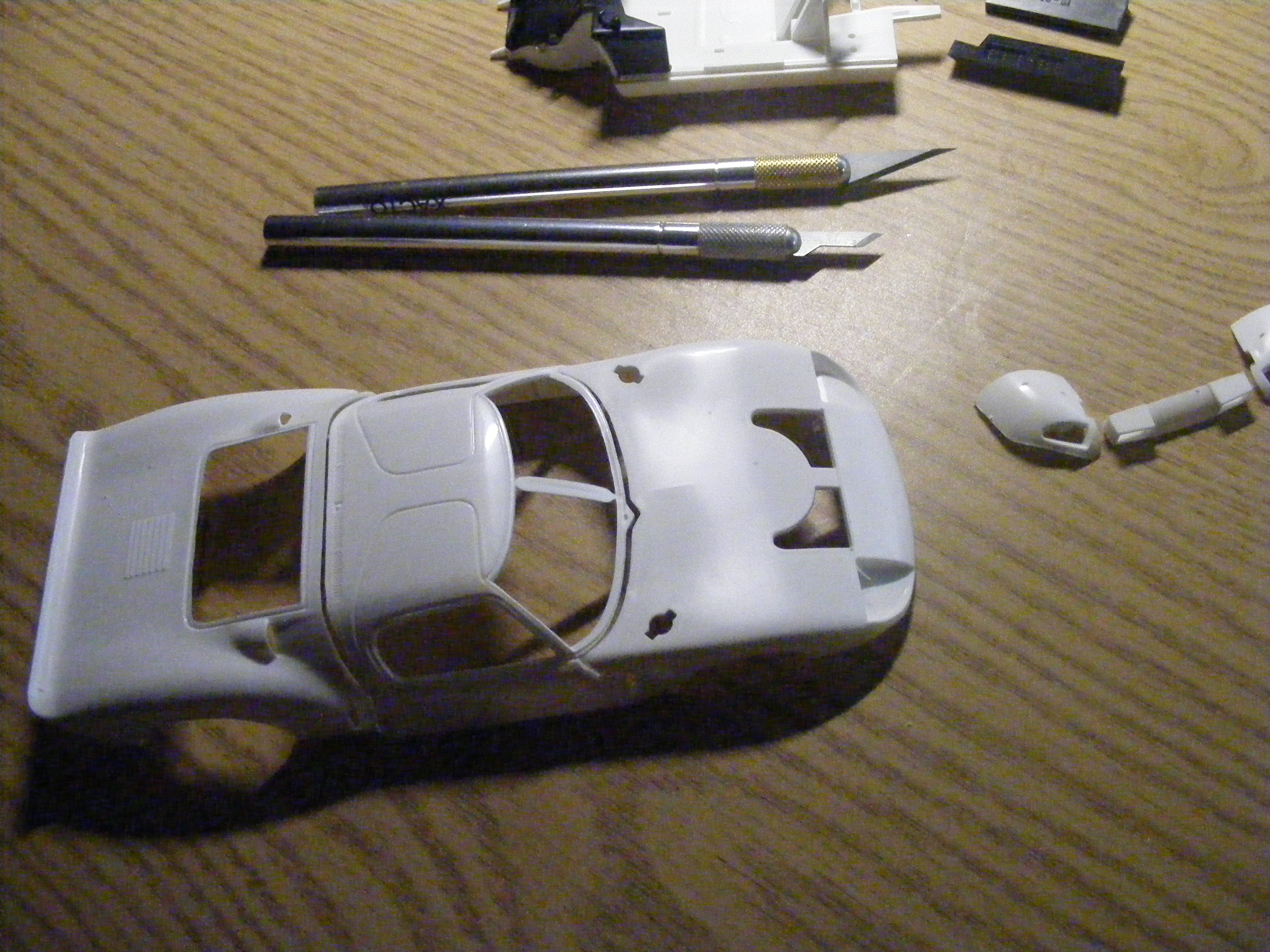

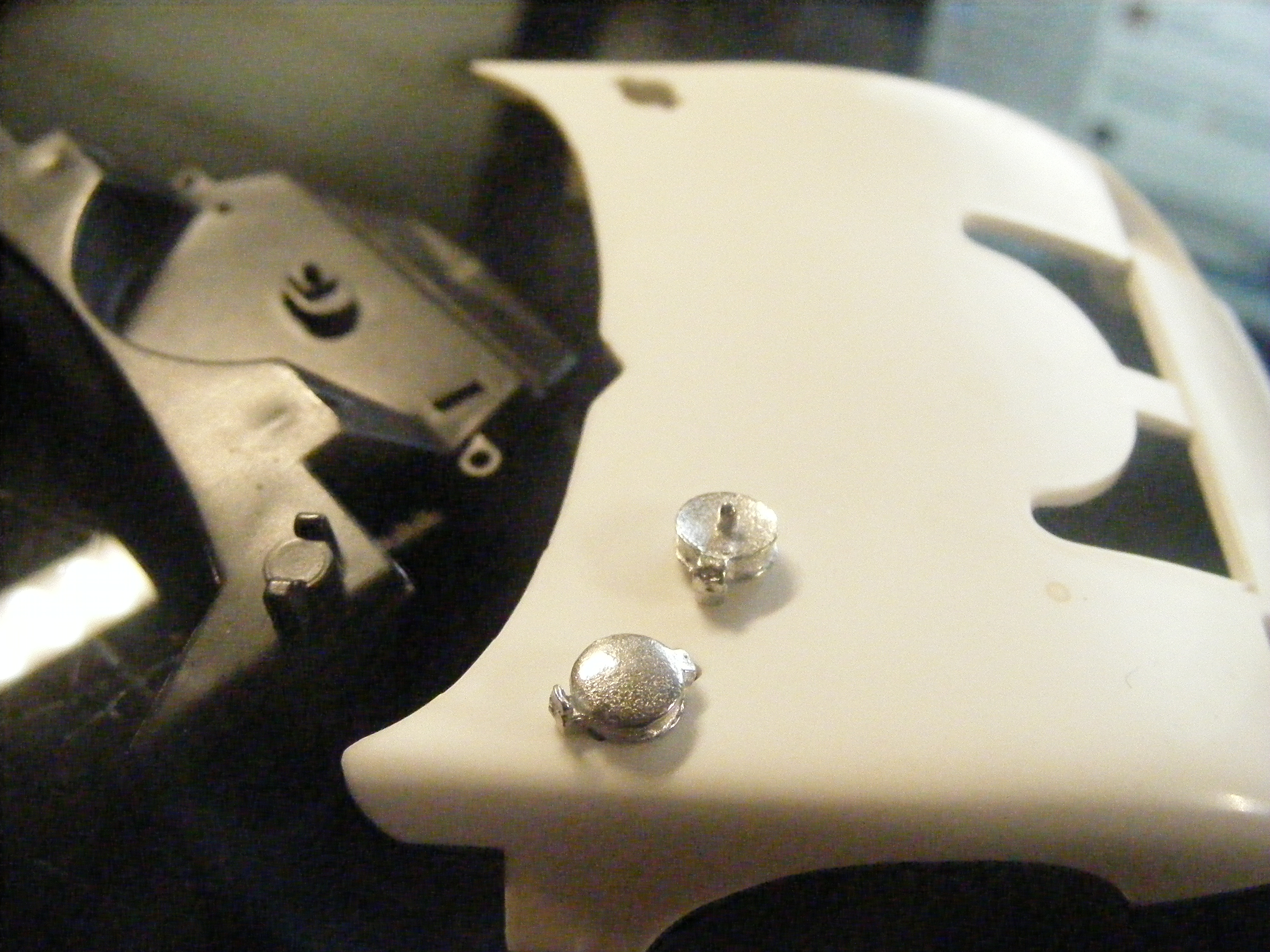

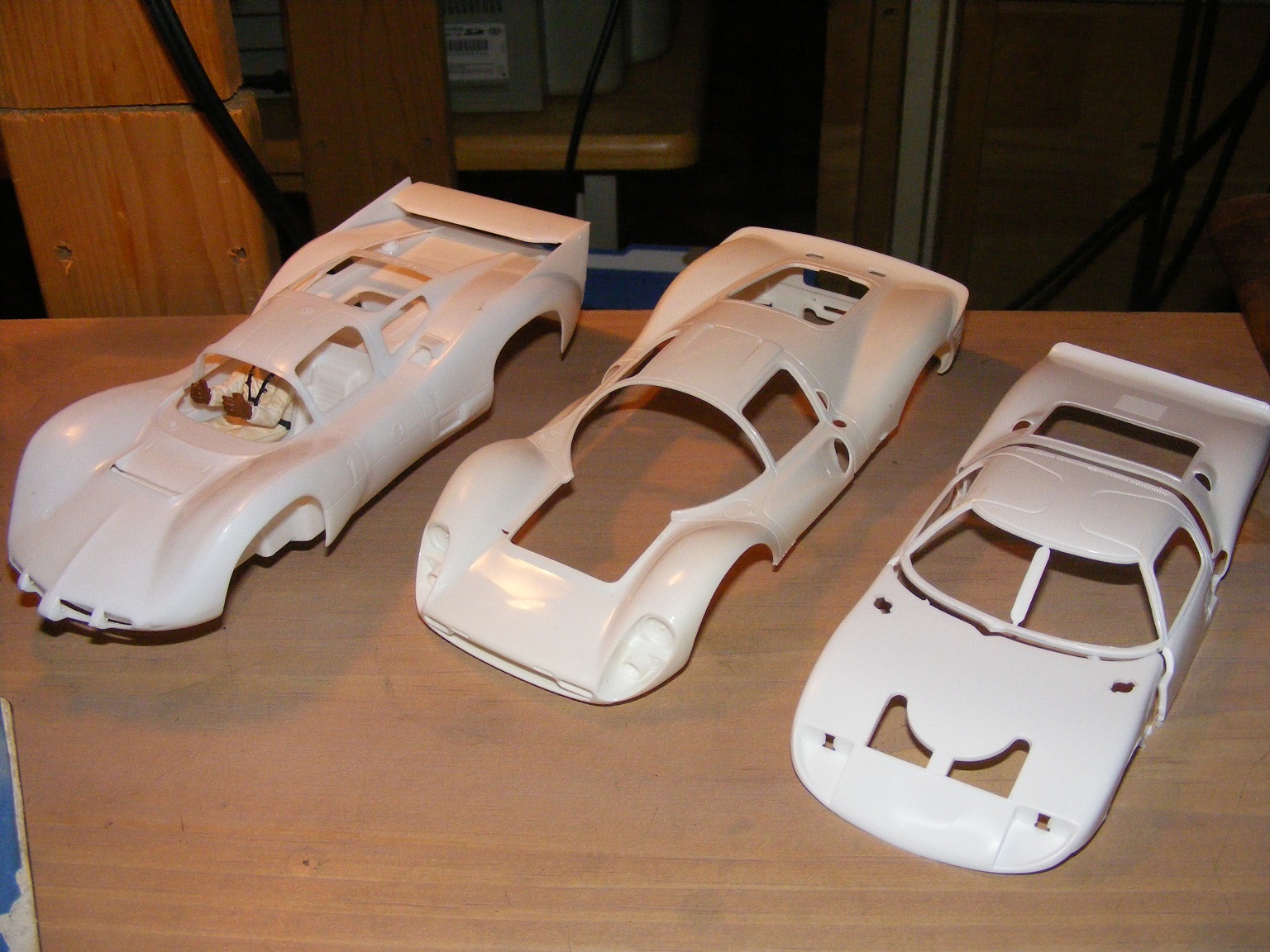

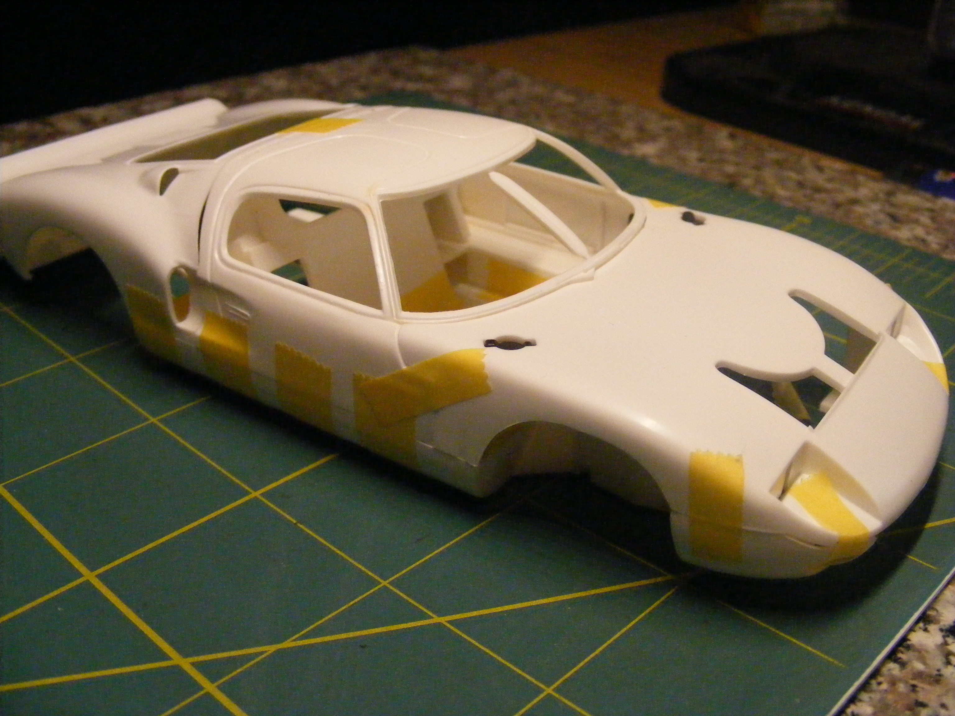

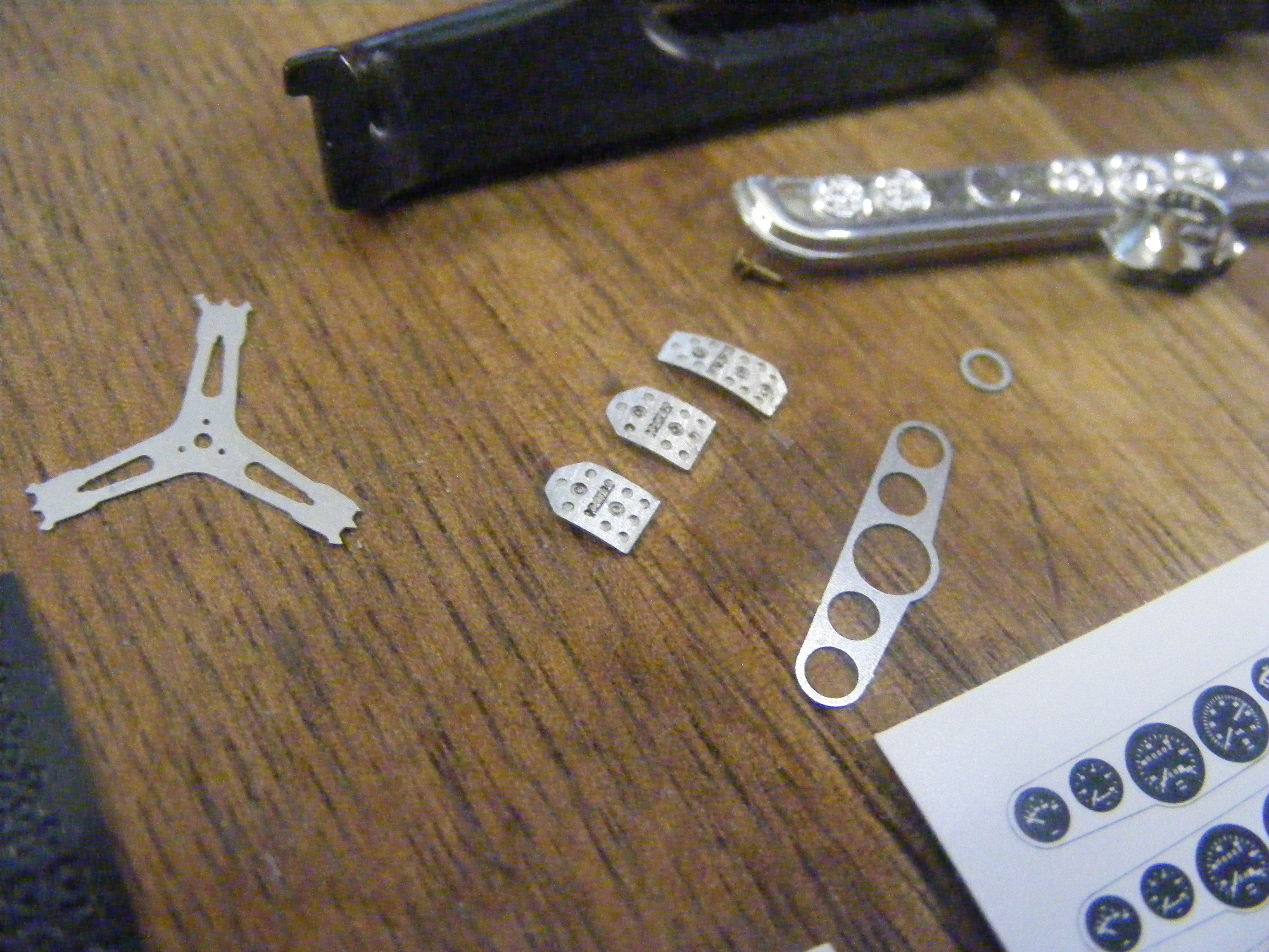

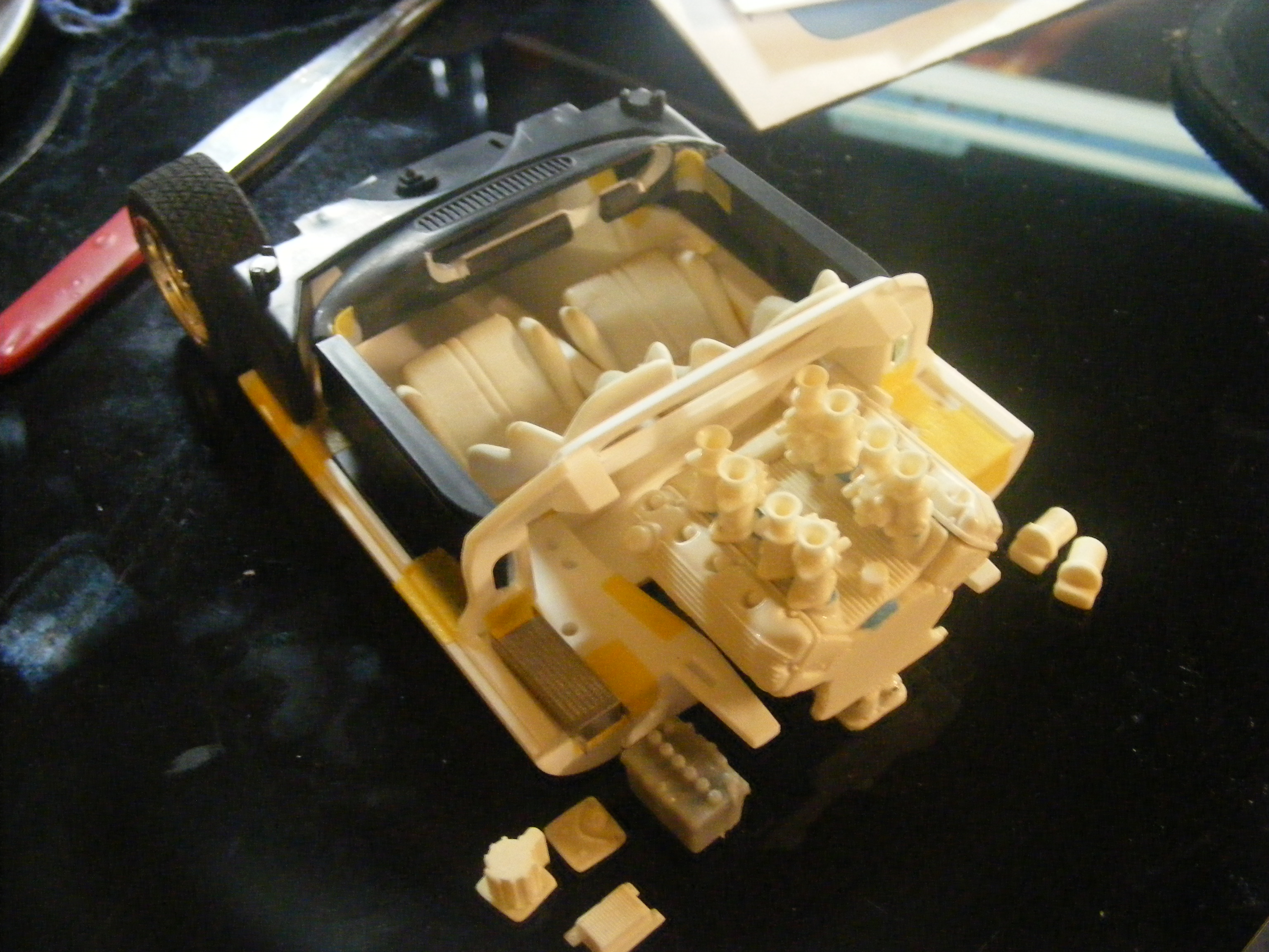

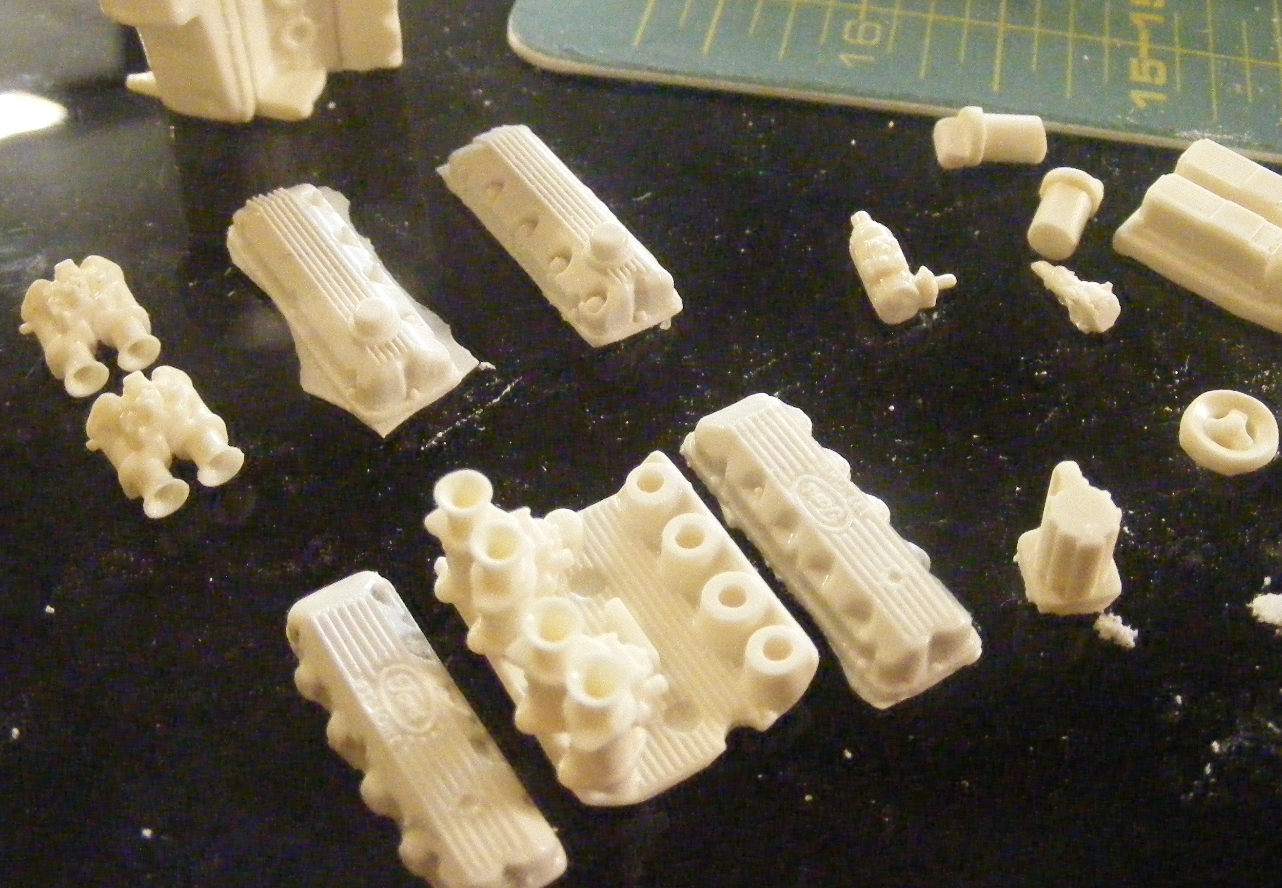

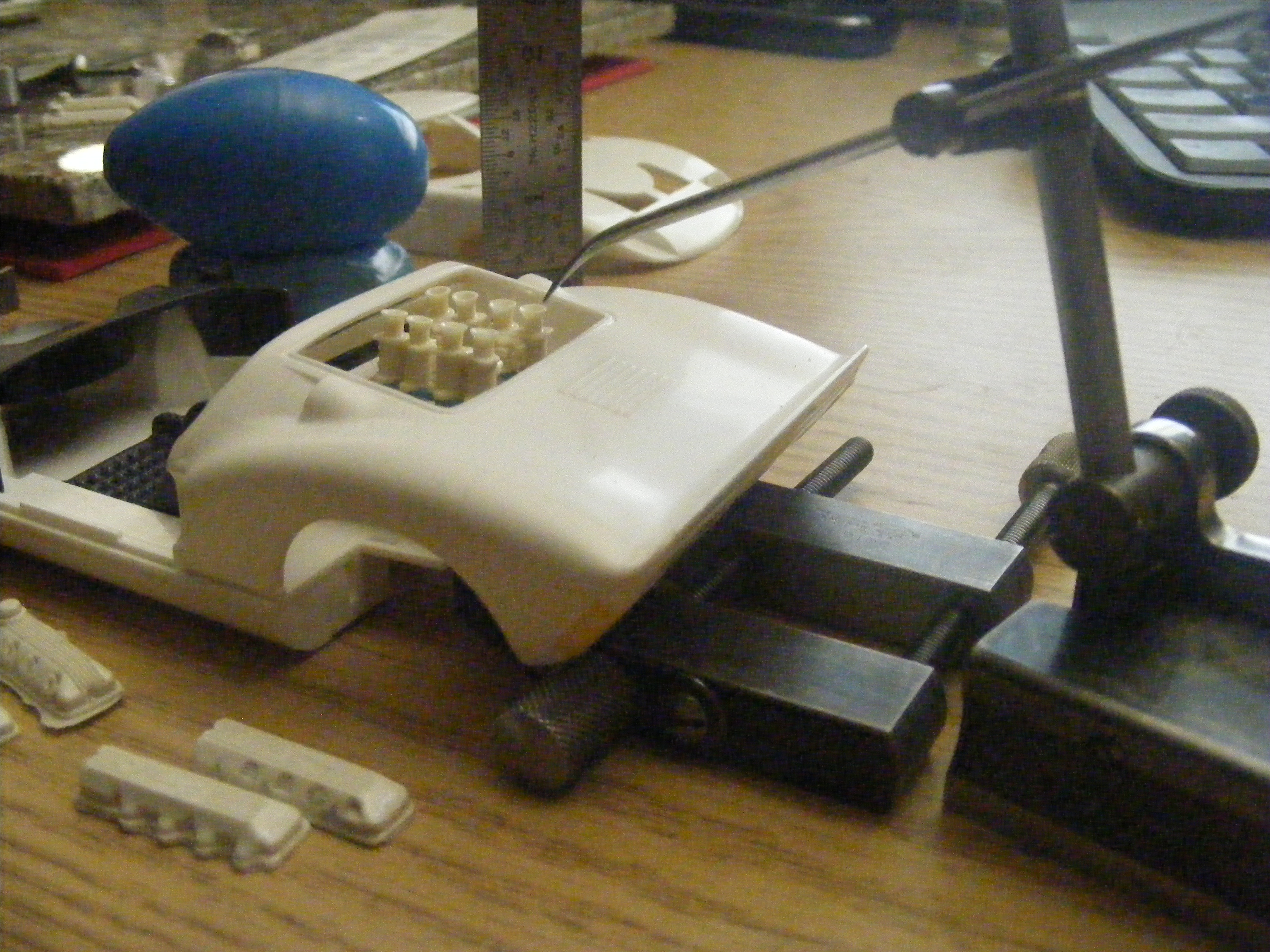

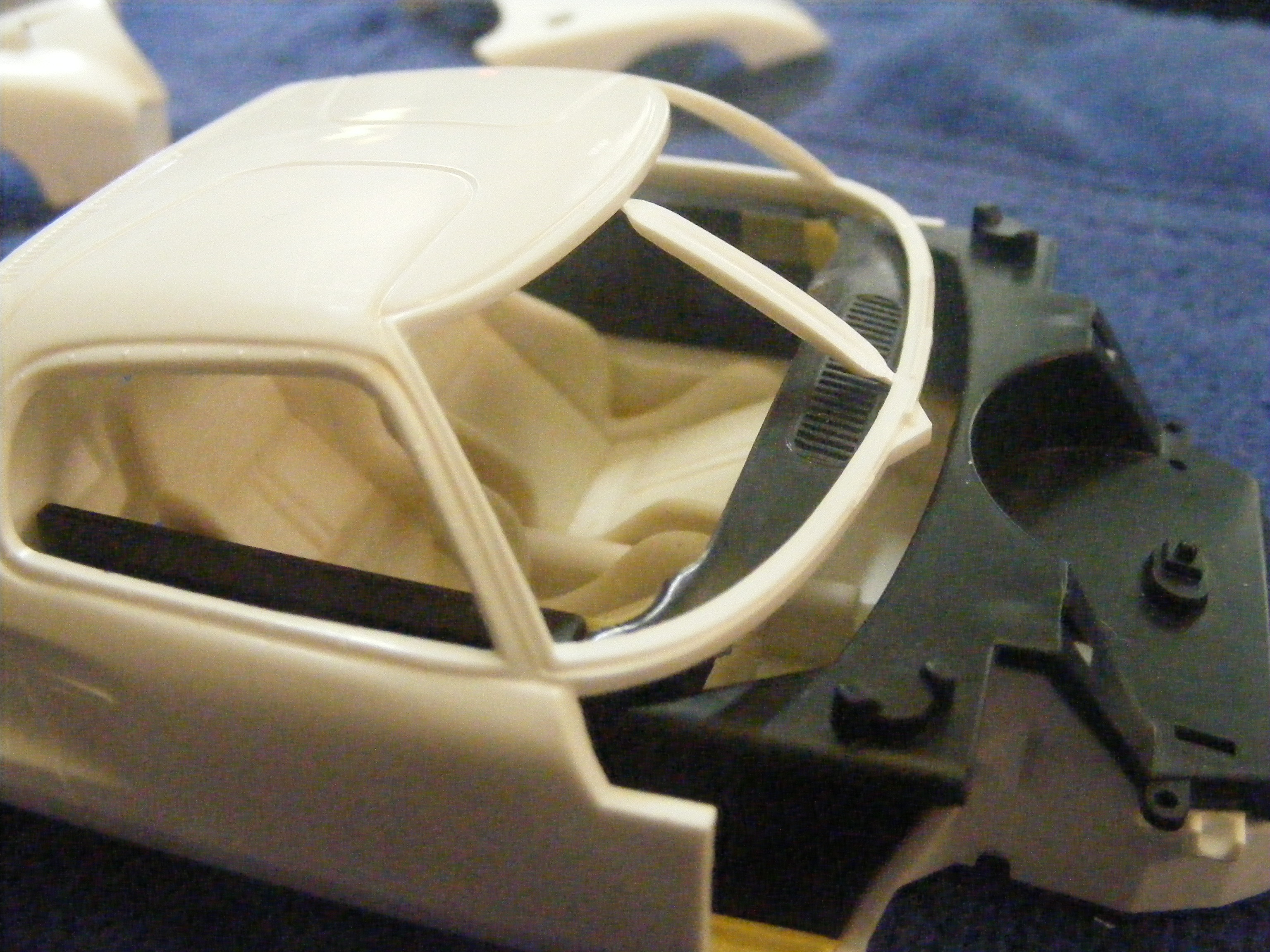

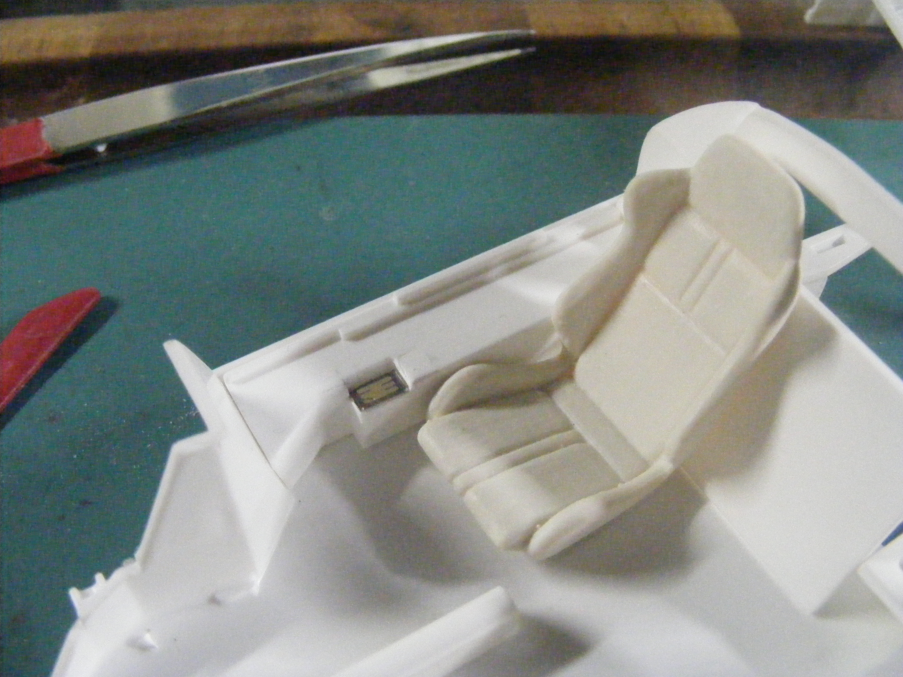

This car in real life is only 40" tall which makes this kit in 1/25 scale pretty small and using a large engine and in 1/24 scale, it is not a good match. The exhaust might have to be changed to a down and out instead of up and over type layout and the engine cylinders are laid down pretty flat so that doesn't help much either. I picked up some .015 clear styrene for the gauge project for today but that might change to leveling out the resin seats so they match. One was sanded too thin to work with so Im going to stick them to some fun tac, square them up and then pour some JB weld under them, let them set and sand the edges. They are too tall so I'm going to cut down the headrest some, put in some seat belt holes and separate the backs from the seat to lower them and then reglue the seat bottoms Plenty of room for a wiper motor to finish off the wiper PE kit. There's a resin one but too costly to order so I'm going to gather pics and scratch build. The first cut on the kit was to widen the shift gate area for PE The stock rear tires were a joke. The fronts were fine and the wire wheels weren't bad but I stepped it up with some Fujimi Narrow Wire Wheels 18" and a set of big and littles from the ancient parts box I've kept along. Arii BF Goodrich tires which might have to be cut for width as much as I hate the thought of it. I bought a Revell Shelby Cobra S/C kit for some small donor parts like a gas cap and mirror, maybe the wire wheels if the big boys dont work. I've sanded some detail off of the firewall already that will work nice on the GT. First time having to sand resin too. An 8 x 8 aluminum brownie pan and a thick glass picture frame which is all glass with some good 3M paper on it works. Other ways do not. I bought some brass rod ends on a PE sheet to help fab some suspension rods. Adding a PE oil cooler in back, nice small unit. I really want to see my trio of 60's cars built.

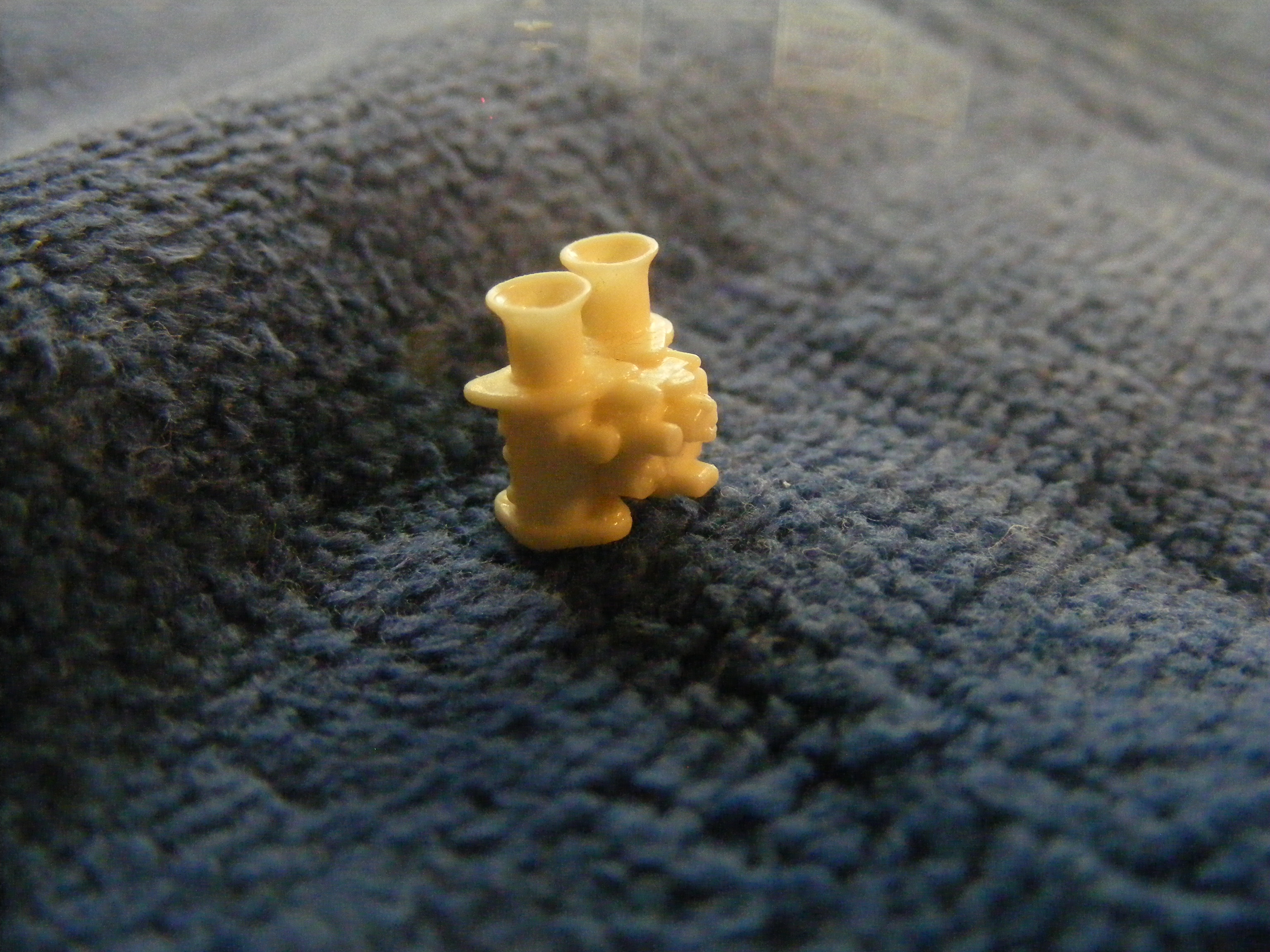

My first custom and it is a challenge. Aurora Ford GT with Outlaw Resin Ford 427 big block with Weber carbs.
