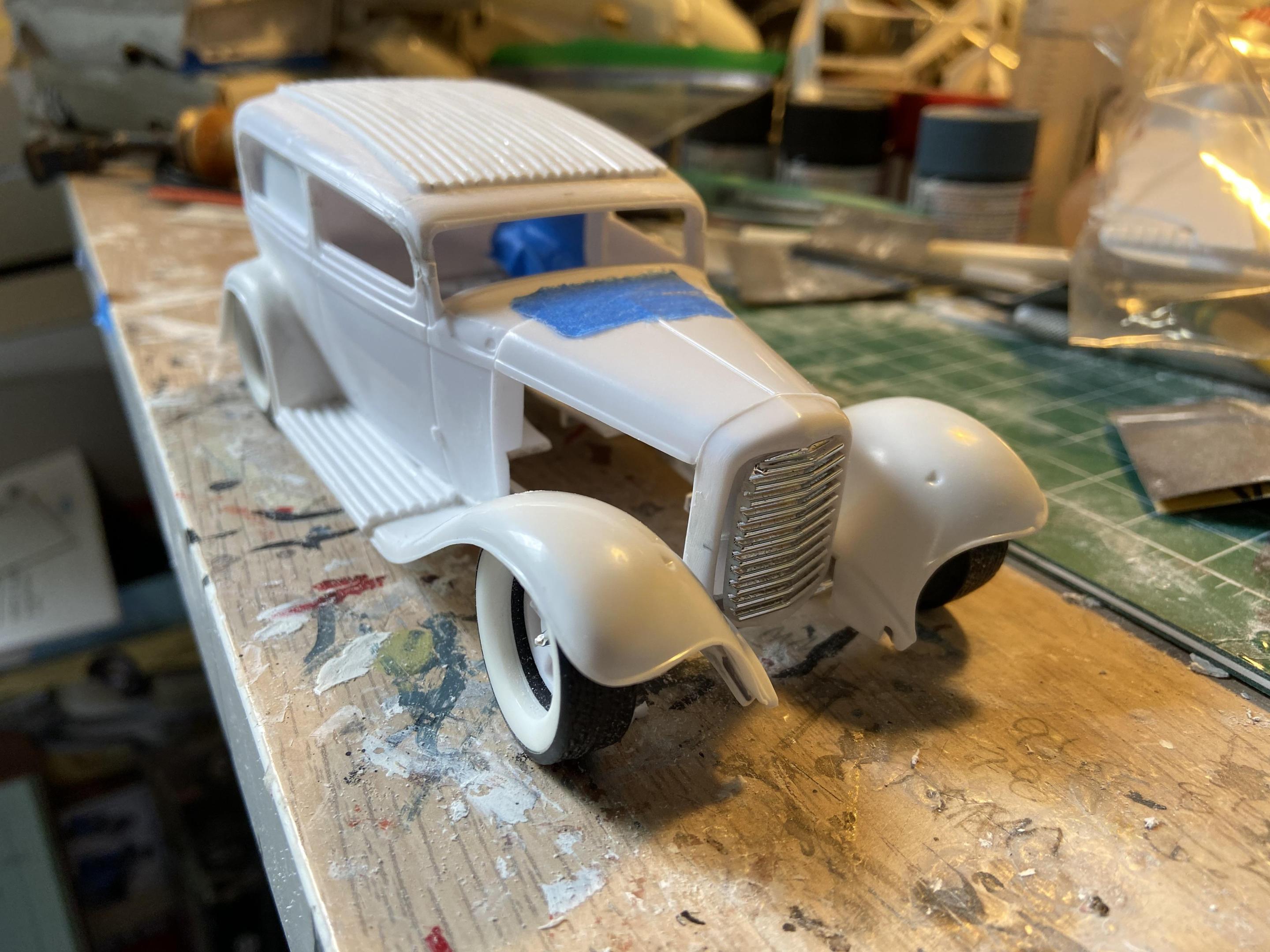

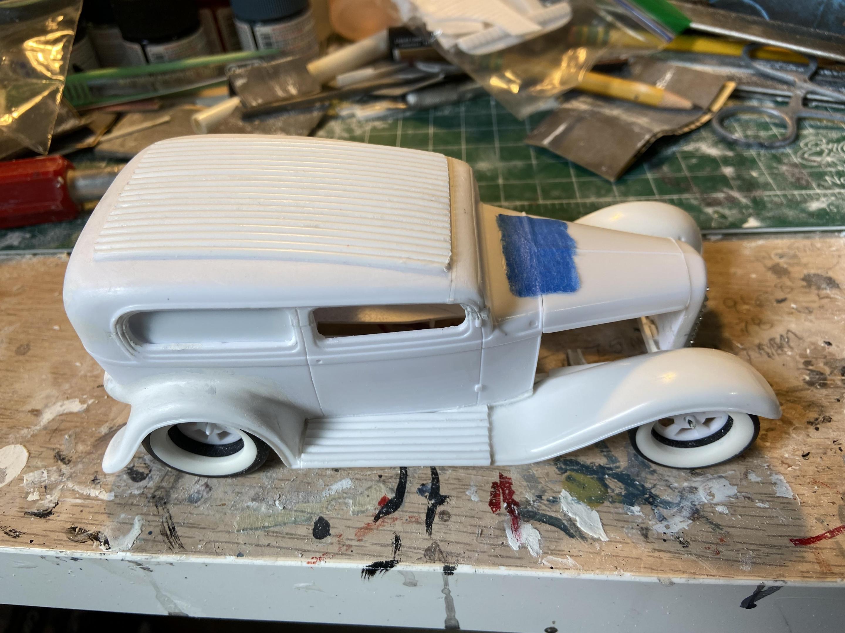

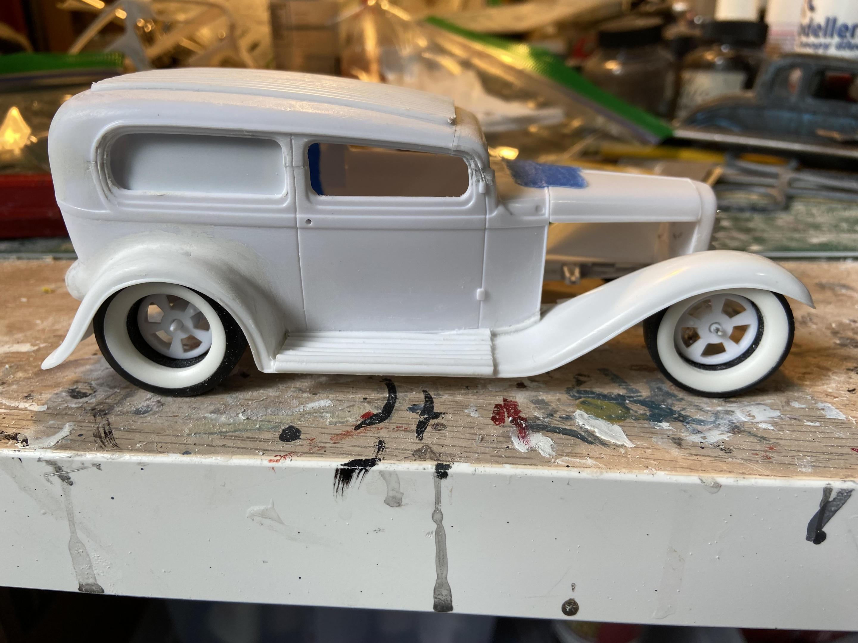

  1. I finally found a good tire wheel combination set up for this. So naturally, I have to mock this up to see how it looks, excuse all the blue tape. Keep smiling.
  2. That is looking great.

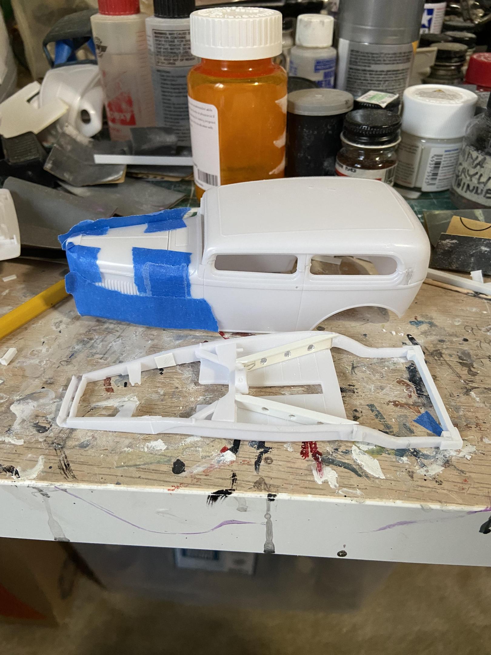

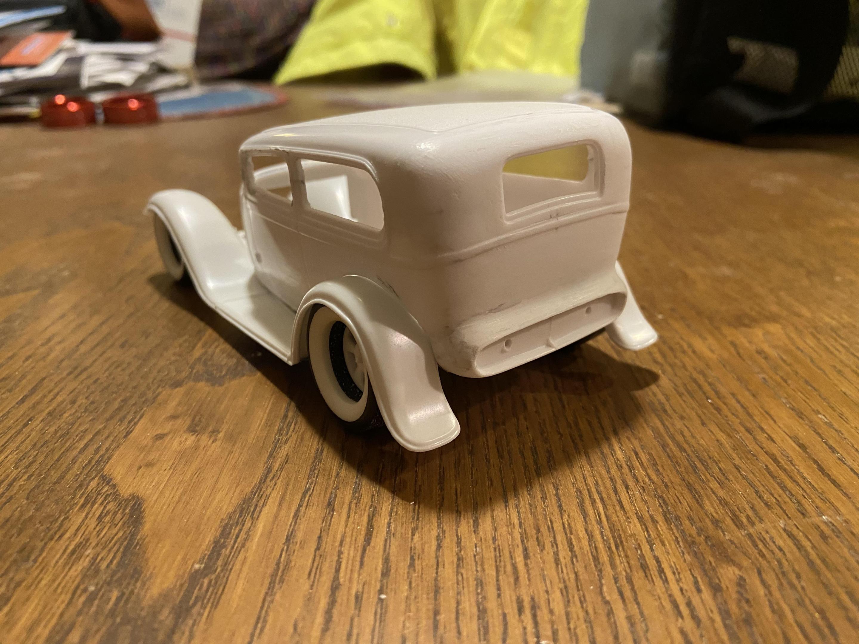

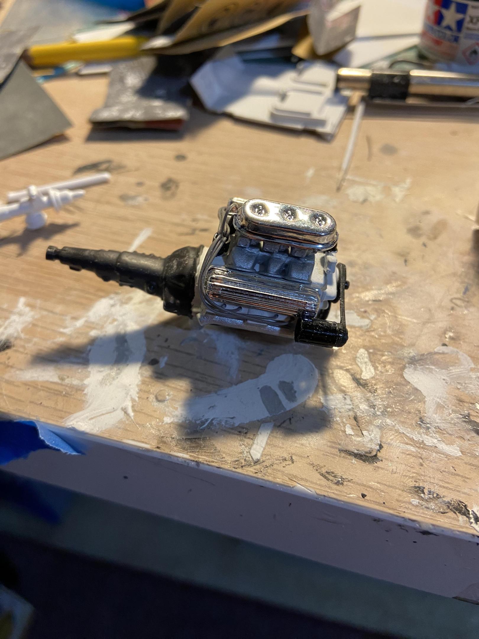

  3. Here is my update on my 32 Ford Tudor sedan build. After trying all kinds of different engine combinations, like someone else on this thread, I have decided to use the flathead V8 from this kit. I did try one last modification to this engine and it’s not working either so it looks like it’s predestined to be the tri carb Set up straight out the kit, oh well that’s how it goes. Other updates include the floorboard has been filled in on the chassis-frame but I need to make a crossmember for the shock mounts and the airbag suspension. Also filled in the last little gaps in the body, and soon it will be time to clean up the body and smear a little bit of glazing potty. i’m really enjoying the builds on this thread. Thanks for looking and keeping this thread going. Thanks also for the encouraging comments, Cheers.

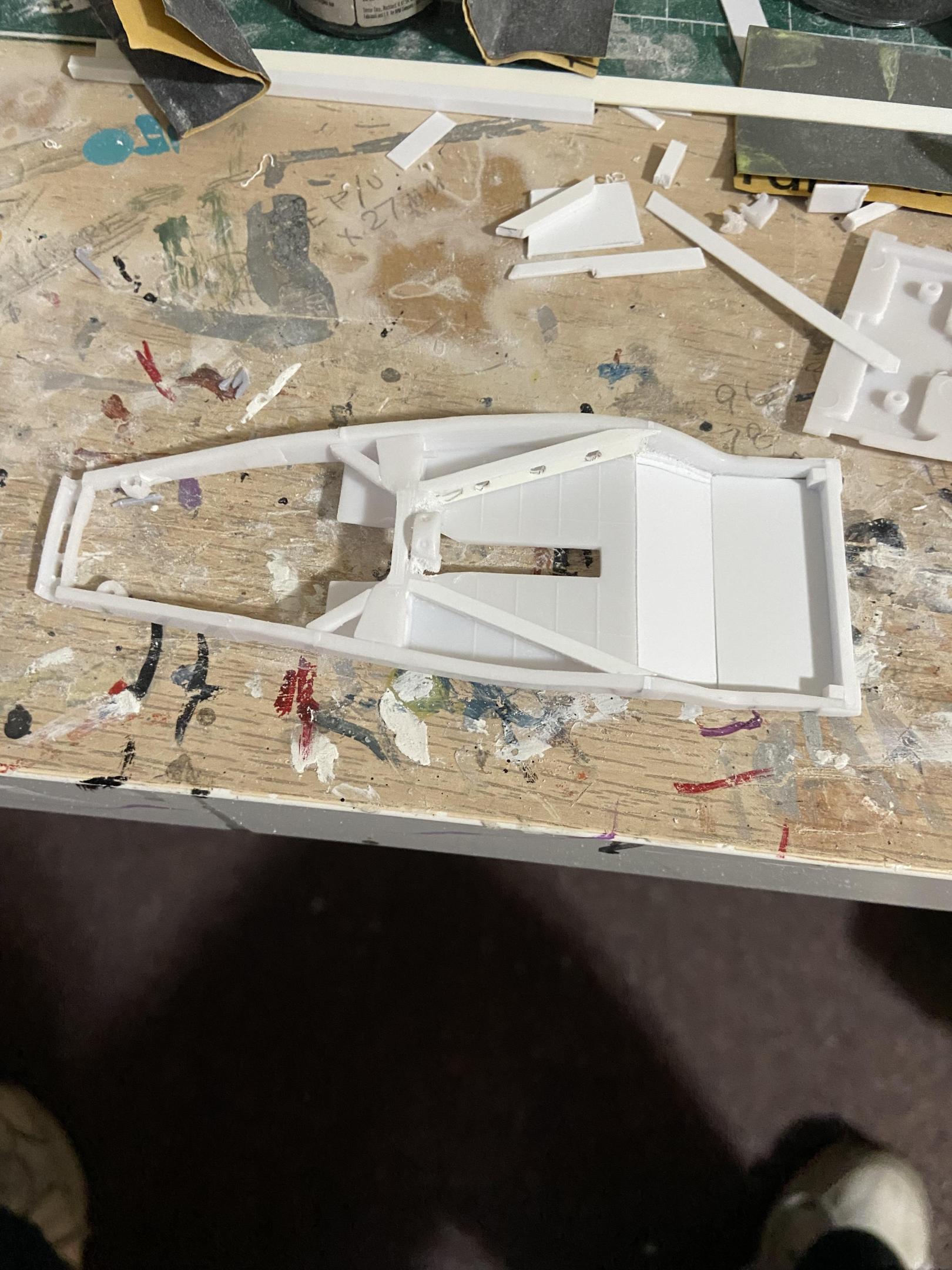

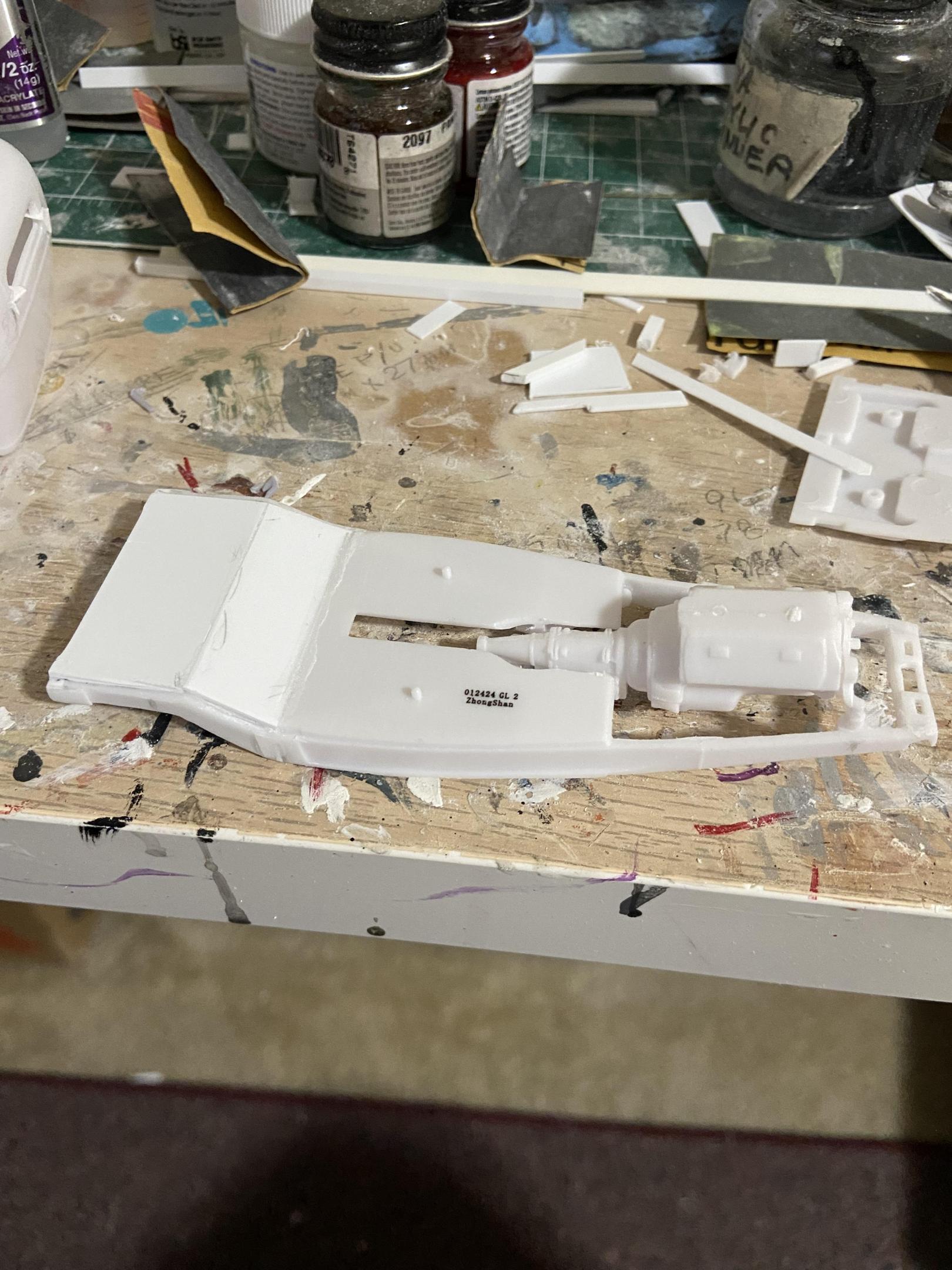

  4. Work continues on my second version 32 Ford Tudor. The roof has been glued on finally. I have a little bit more work to do, but I But I will tackle that later. The frame, as I’ve stated earlier has been modified. I’ve pinched the front frame rails and clipped off the frame horns. The rear has been kicked up and then the backend of the frame straightened out as you can see from the second photo and rear most crossmember has been added. Today I added on some back, bracing to the back half of the frame. I do find that part a little on the weak side as far as how the frame was molded from the kit. I still have more to go on the rear part of the frame like location of the rear end and crossmember to support the rear suspension. I’m considering going with the kit’s air bagged 9 inch rear end. I think it would lend itself to a good roadworthy car. Thanks for keeping this thread going and thank you for looking and your comments are always welcome. Cheers.

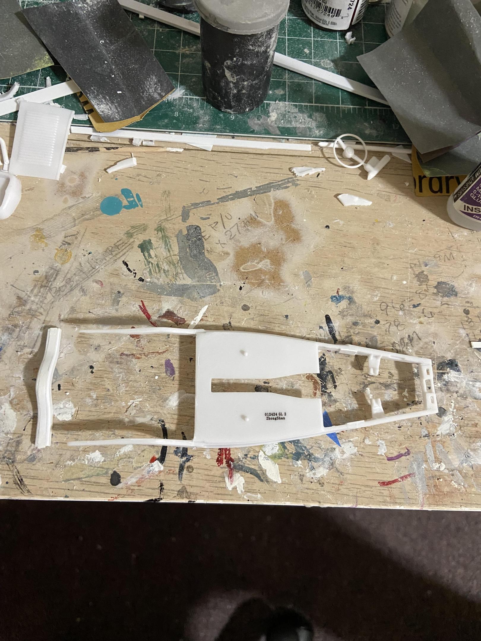

  5. Thanks Chris for the offer, with this build I will not be building an exact replica. I’ll will take some liberties.

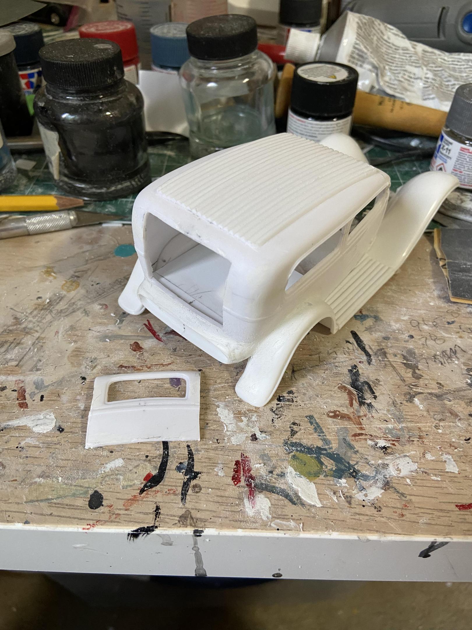

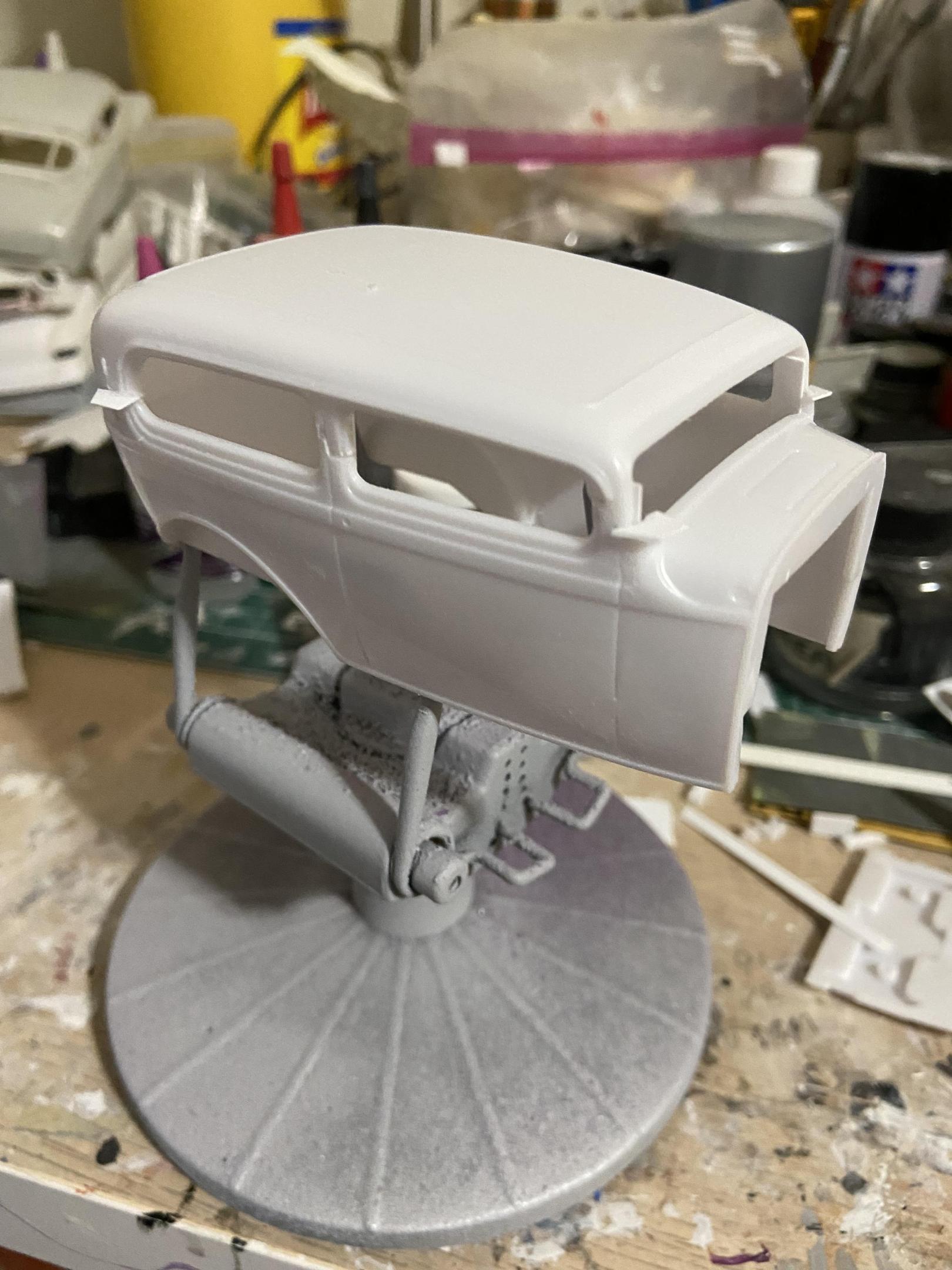

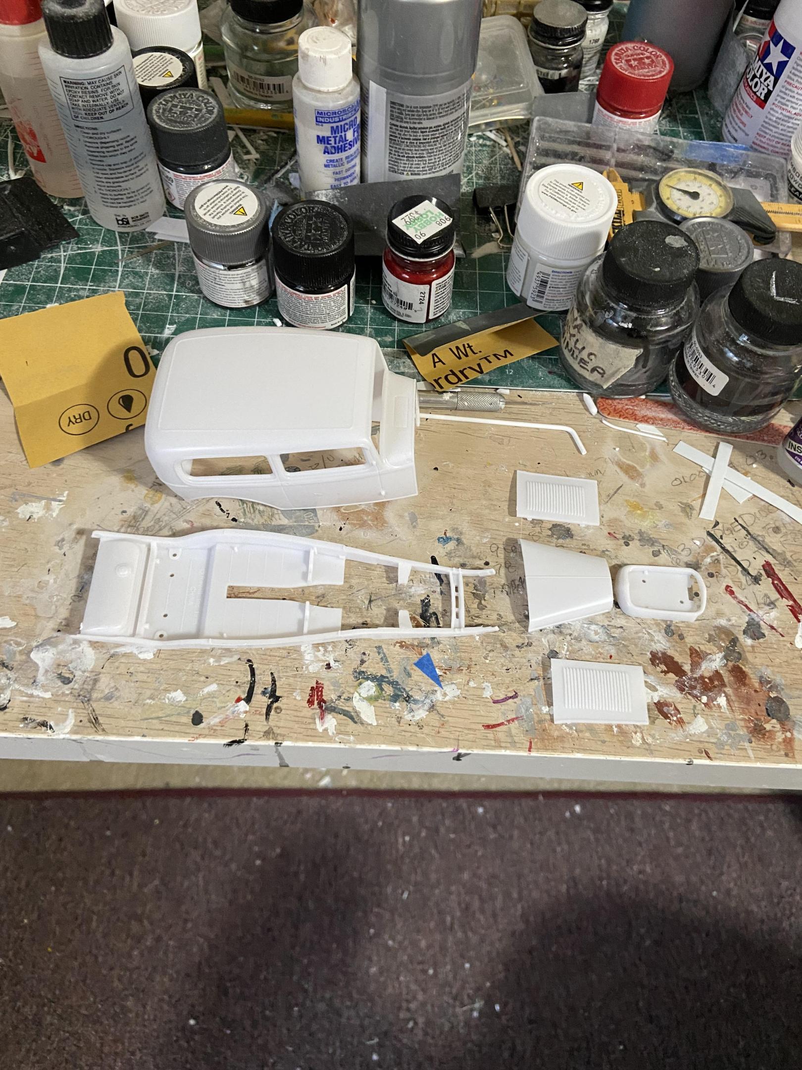

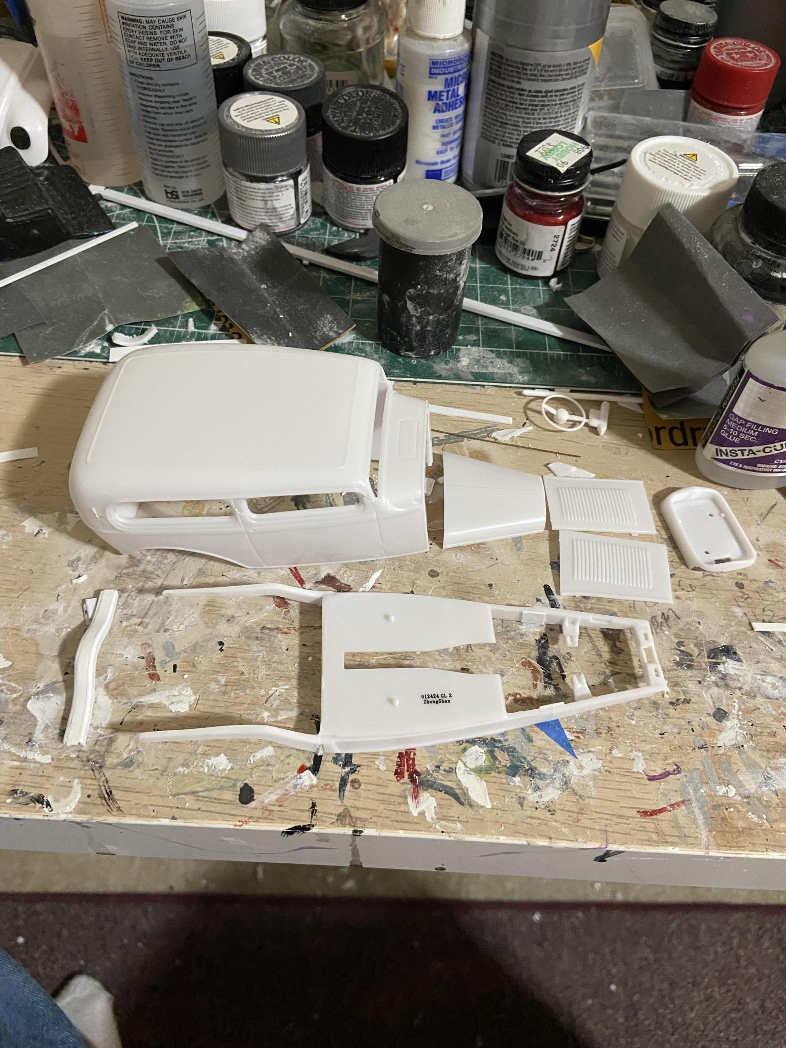

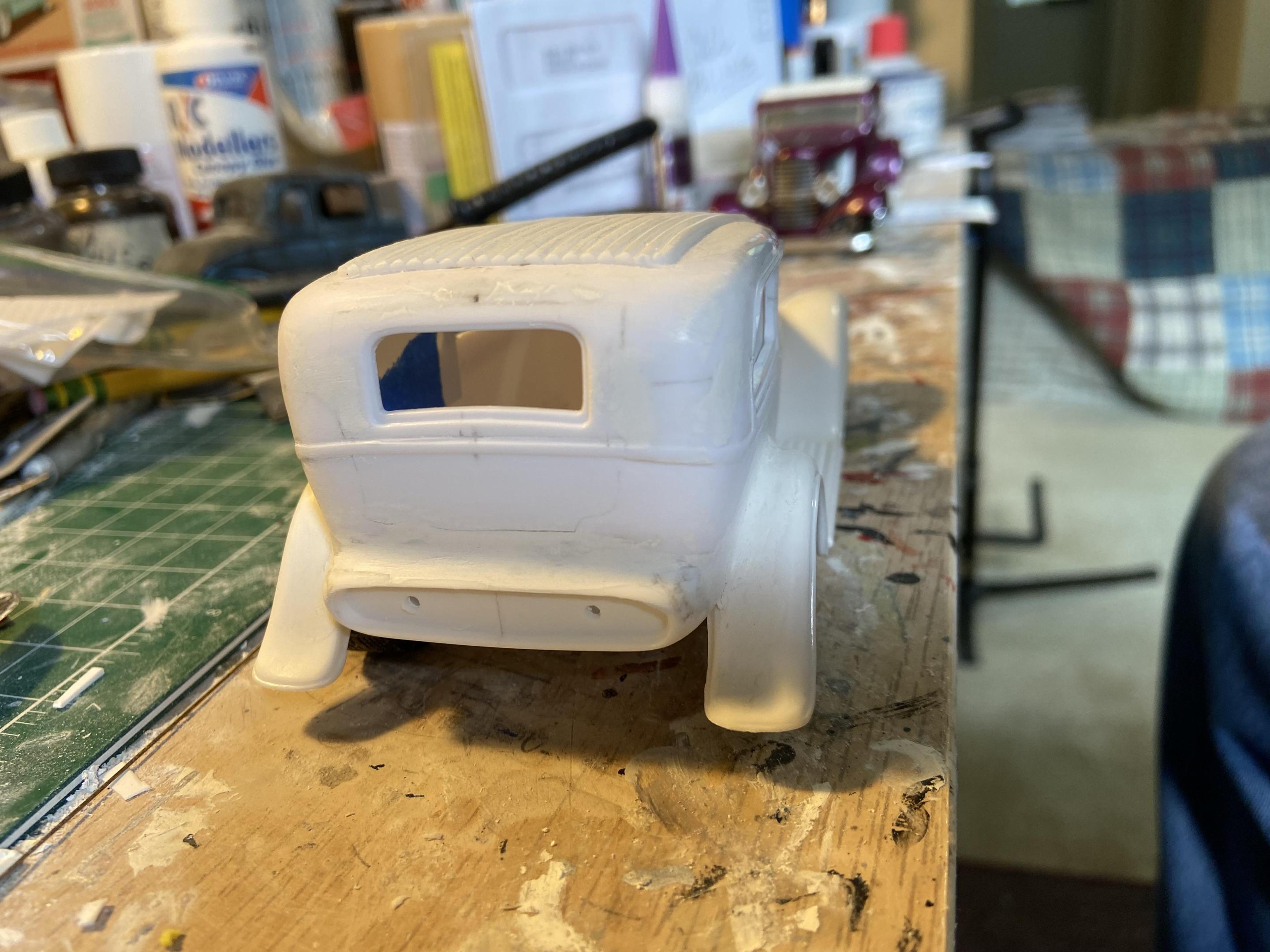

  6. Update: some significant progress has been made on my 32. I have been working on filling some of the gaps in the roof, A, B and C pillars so when I do glue the roof on, there will be no gaps at all. Also, the frame has been modified more to my liking as you can see, I’ve cut the frame horns off the front at the and I’ve pinched the front frame rails. The rear frame rails I have made some cuts and kicked up the rear frame rails.. Lastly, I had to scratch build a 29 Model A rear crossmember because I don’t have any around anymore. More cleanup is scheduled.

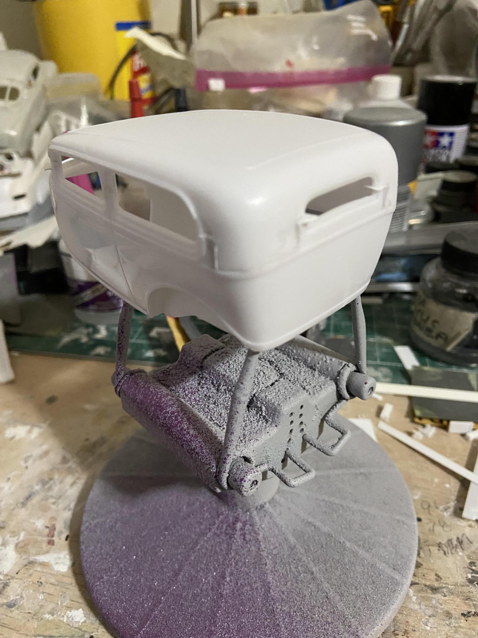

  10. Phase 2 has begun. This is the result of a late night chopping session from last night. Chop has been done in the Rolling Bones style with 5 scale inches out of the back and 5 1/2 scale inches out of the front. Some cleanup is necessary to do, but it’s there. Stay tuned.

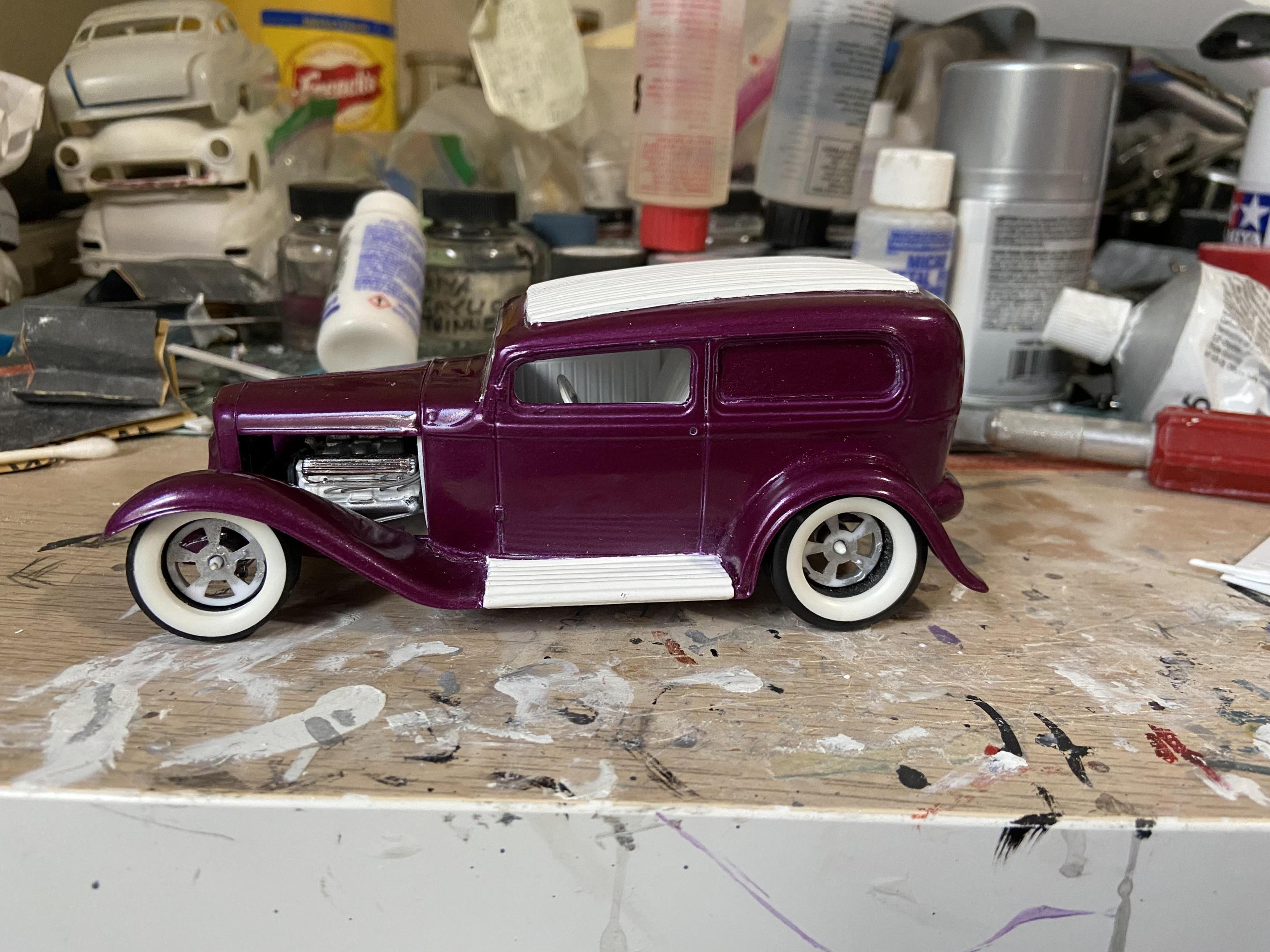

  11. I love it, I’m glad to see somebody else willing to cut these up besides myself.

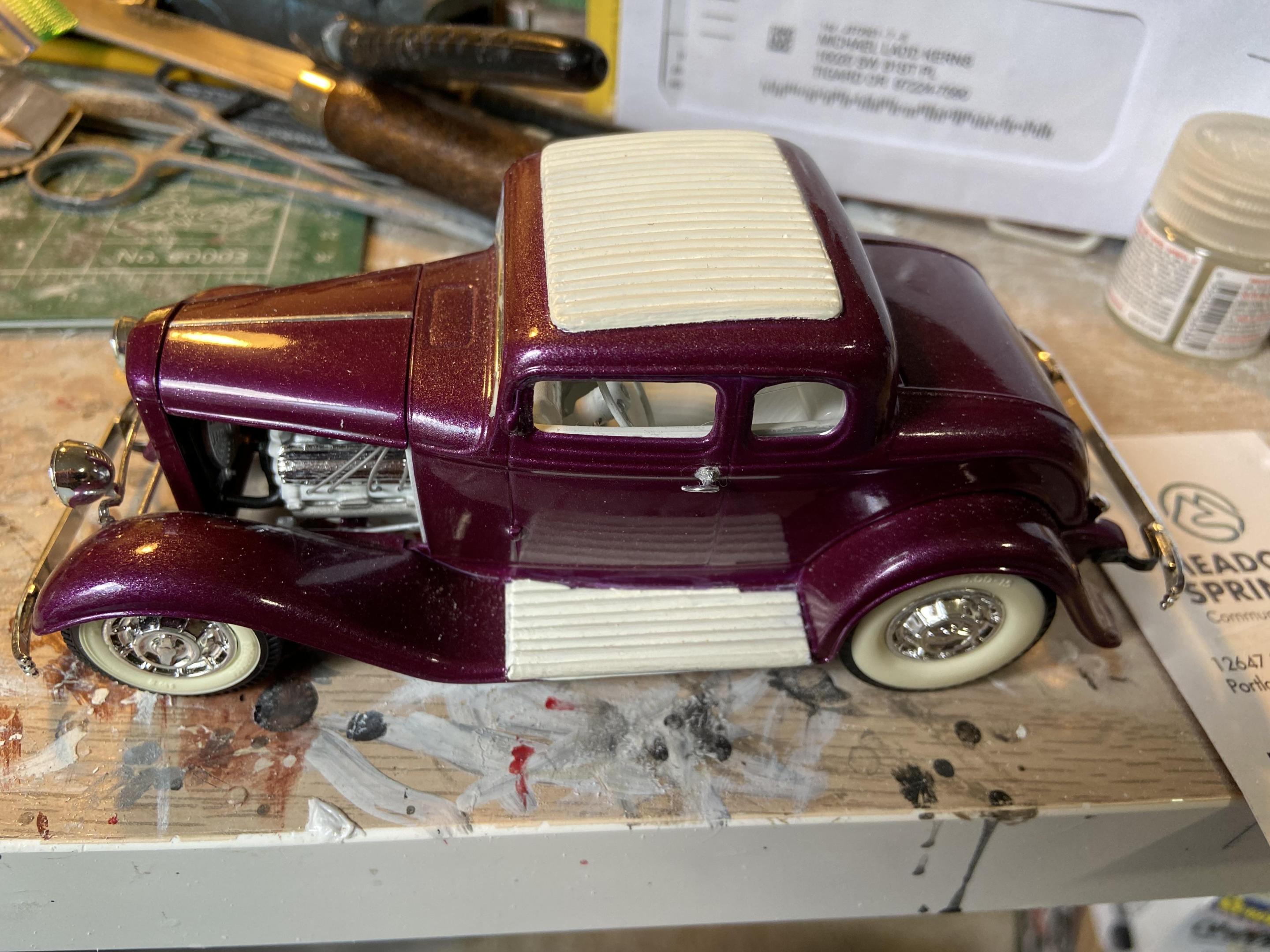

  13. OK guys, getting ready here for round two. I wasn’t trying to cause any kind of trouble. i’ve started my parts gathering. Also my inspiration for this build. The second photo is a 32 Ford Tudor that was built by the Rolling Bones Hot Rod Shop. But I’m not going to try to replicate the 241 louvers in the roof insert. Mine will be build along these lines. we will see how this goes, keep smiling.

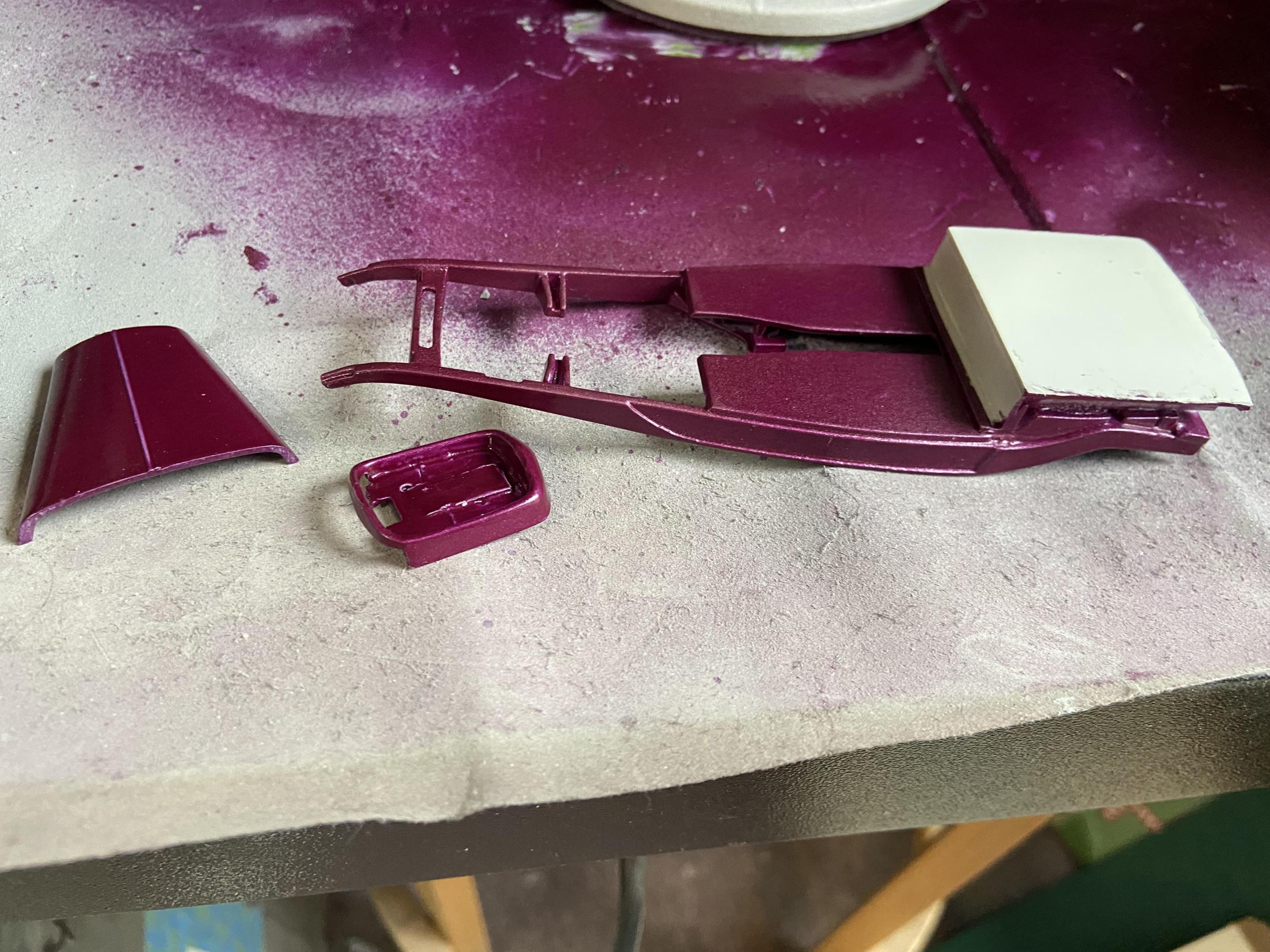

  15. Happy Sunday everyone, I got home from church this morning and decided it’s time to glue up the frame into the body and fender assembly. I just had to mock this up. The stance is right where I want it. Enjoy.? cheers?

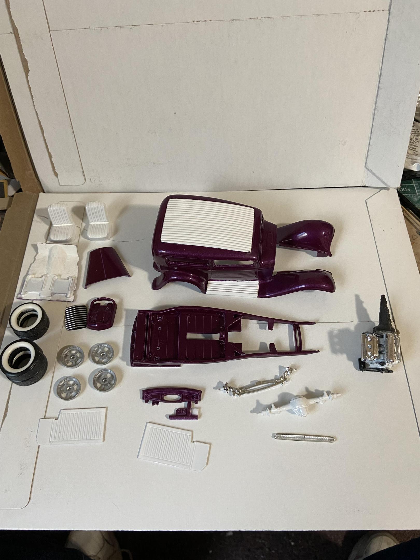

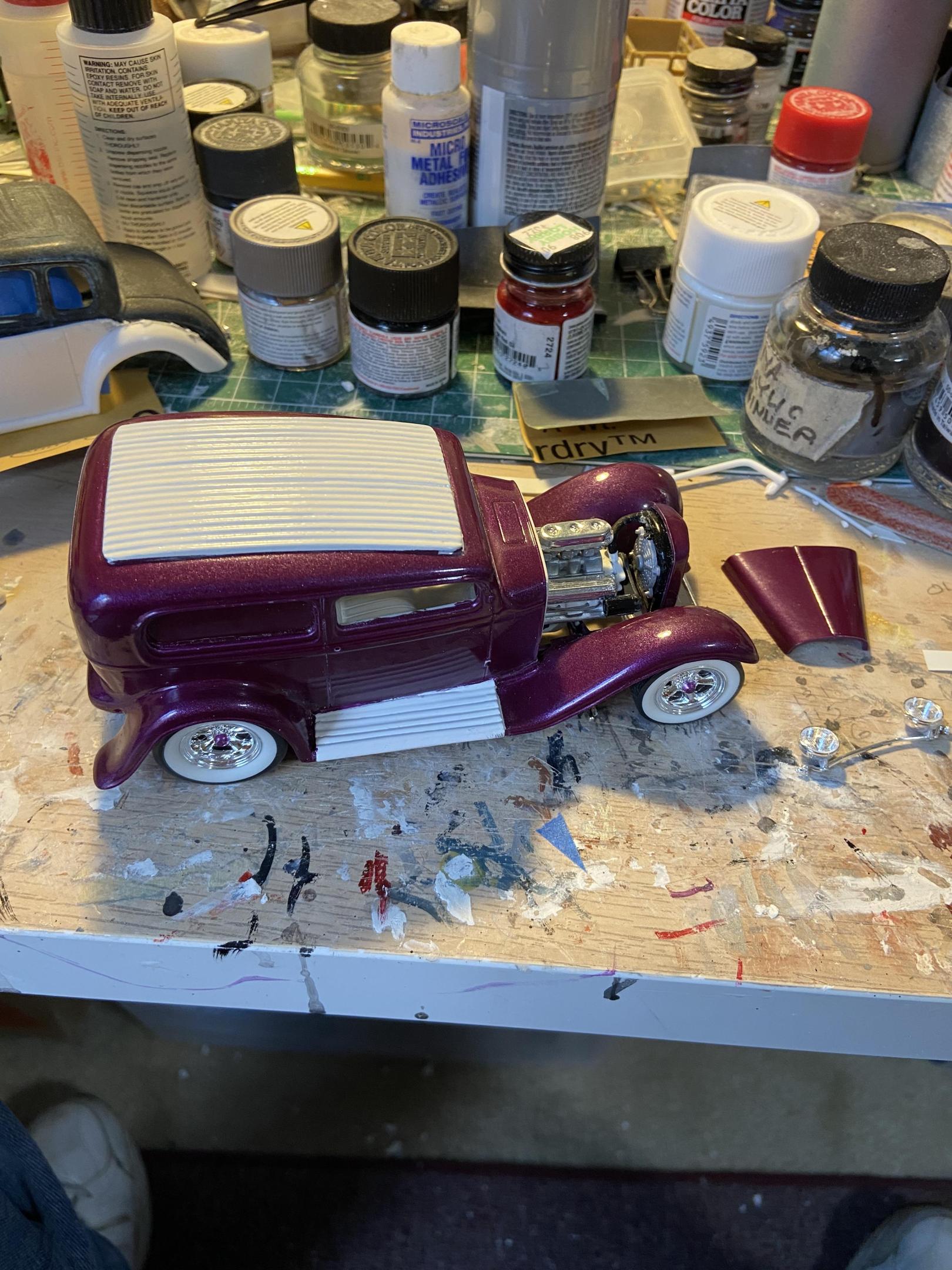

  16. Paint is practically complete except for a few minor bits to touch up, like instrument insert and steering wheel trim. I still need to foil the windshield frame. Soon the assembly process will begin. Cheers

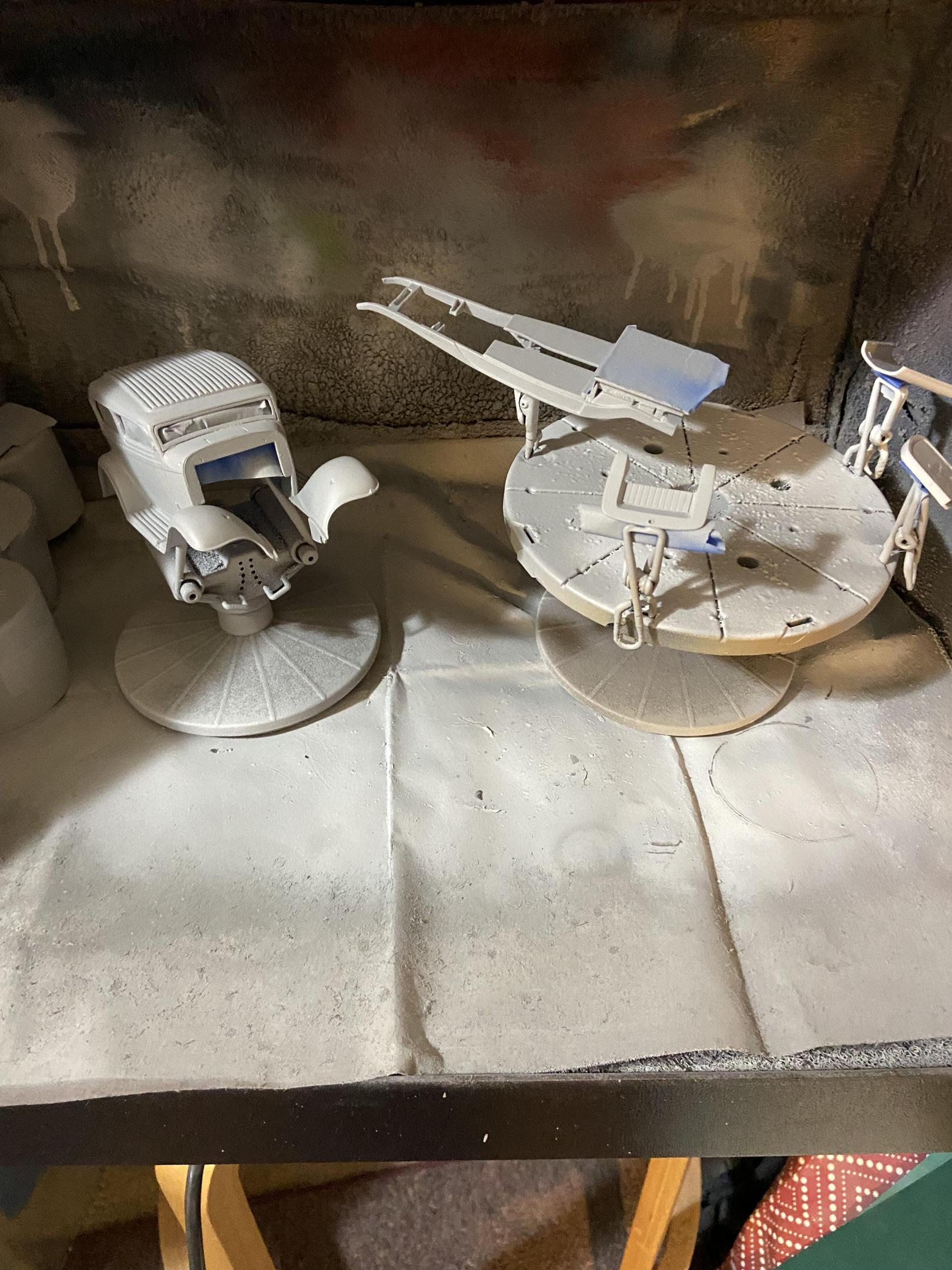

  17. please let us know if this is going to happen, that is - letting the deadline slide on the 15th. It would certainly help me out in my build. This last weekend I was able to finally shoot some collar & Clear on my 32 Ford sedan build. I’m letting gas out now so I can polish it out.

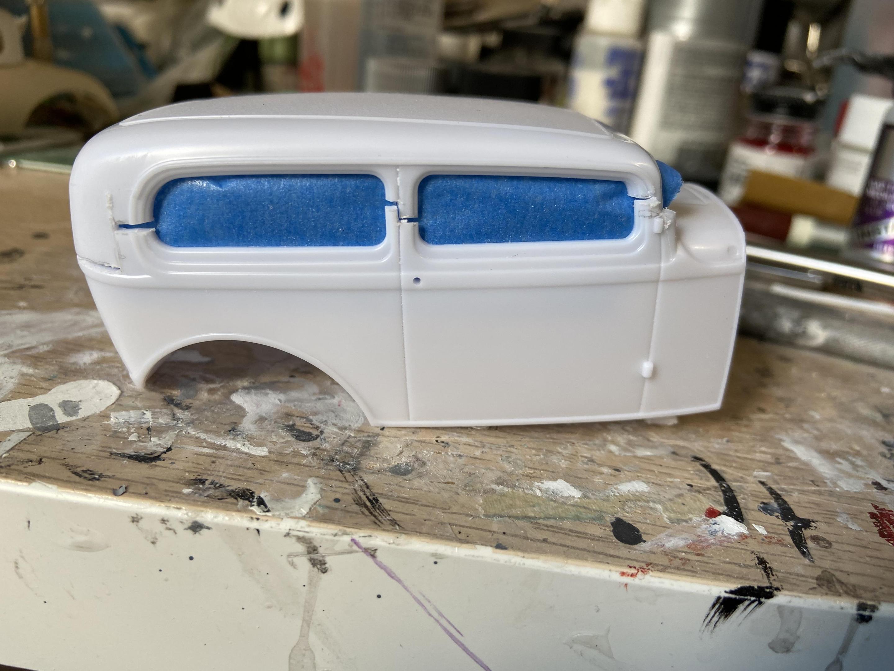

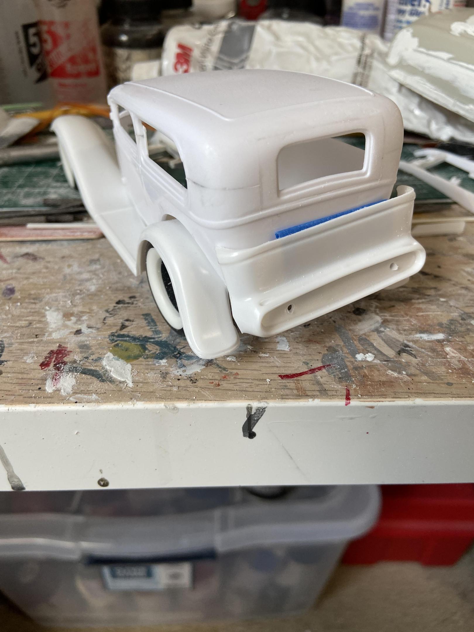

  23. Update: I’ve been working on the interior and rear half of the body. I scribbled out the rear door last night. There is some cleanup to do, but it all looks good. I have the side windows set to be filled with sheet styrene to make my sedan delivery. And I found a Cadillac engine out of the AMT 49 Ford kit to use.

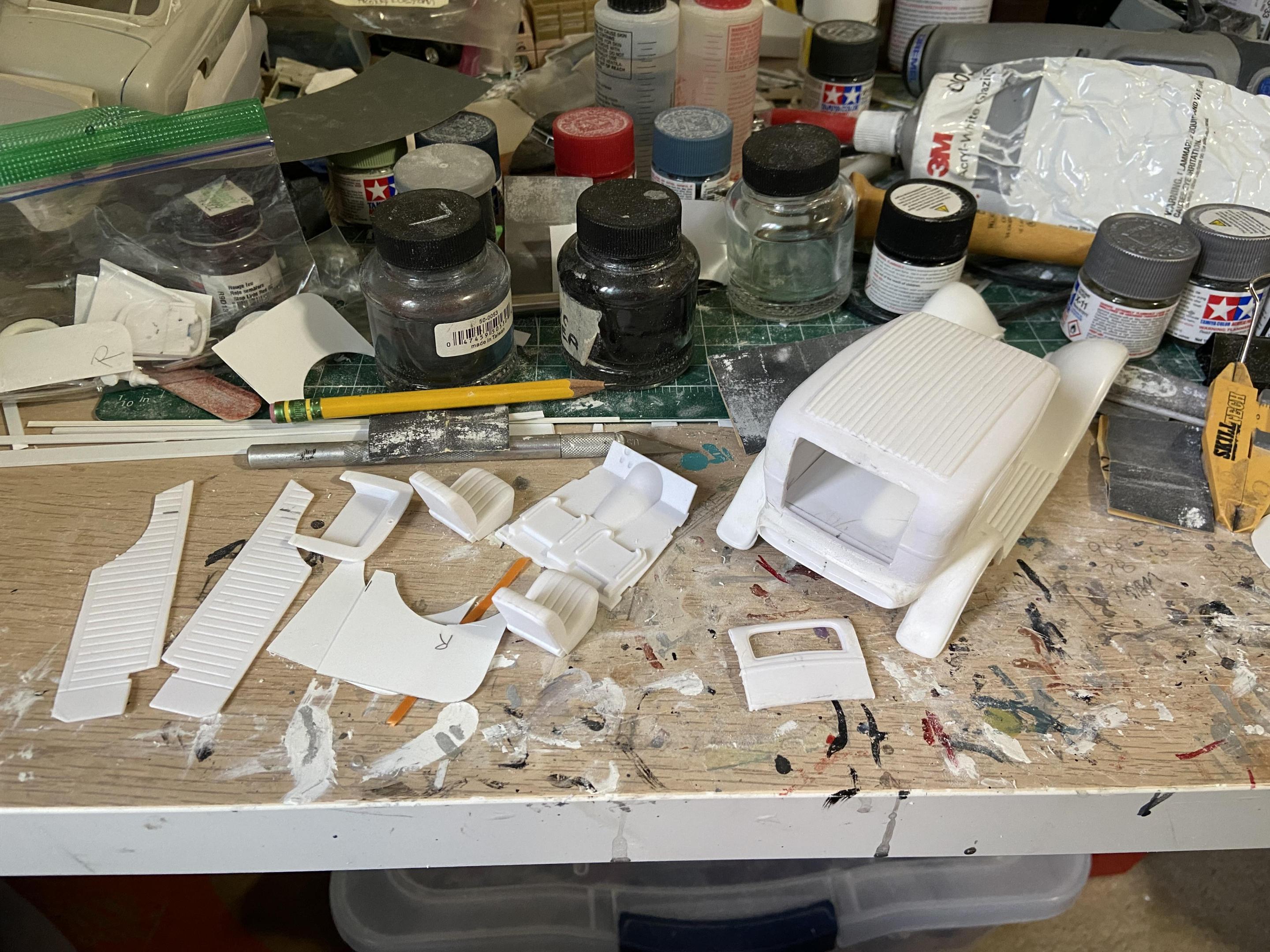

  24. Here is my update : I finally got some time at the workbench today. I went ahead forward and I’ve got my padded roof insert done and my padded running boards done as well. The last photo is the inspiration for this build. And as you can tell, I’m building this as a sedan delivery. Thanks for looking cheers

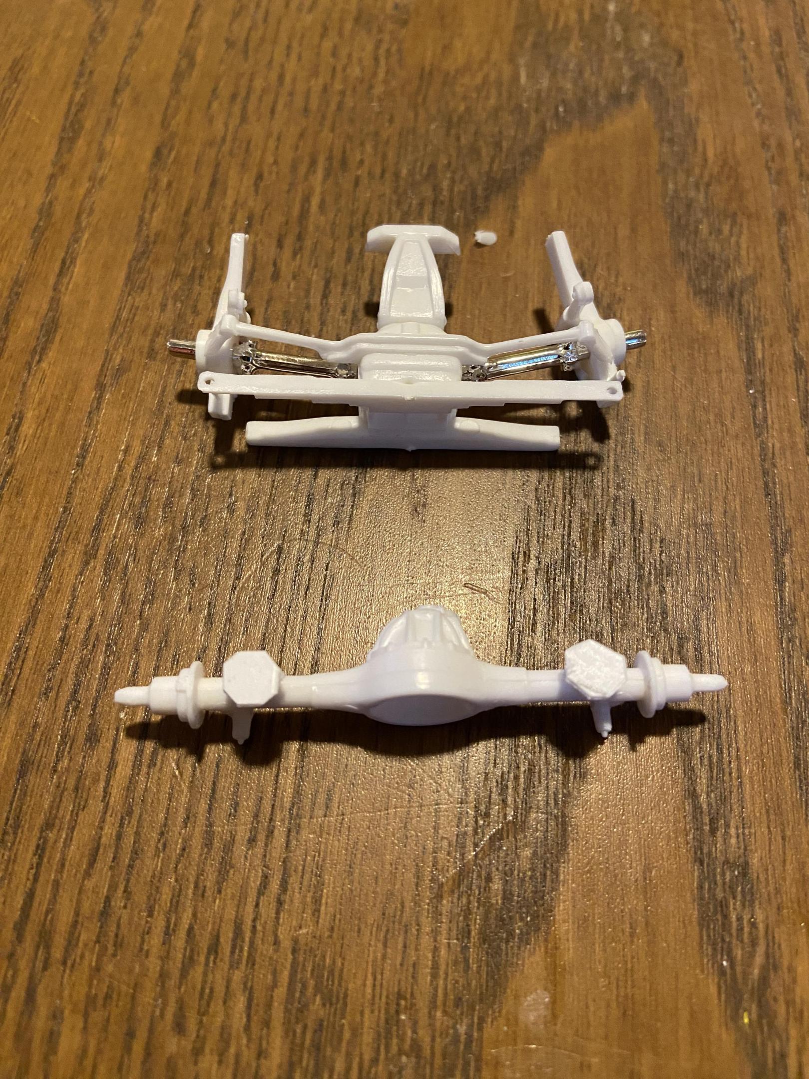

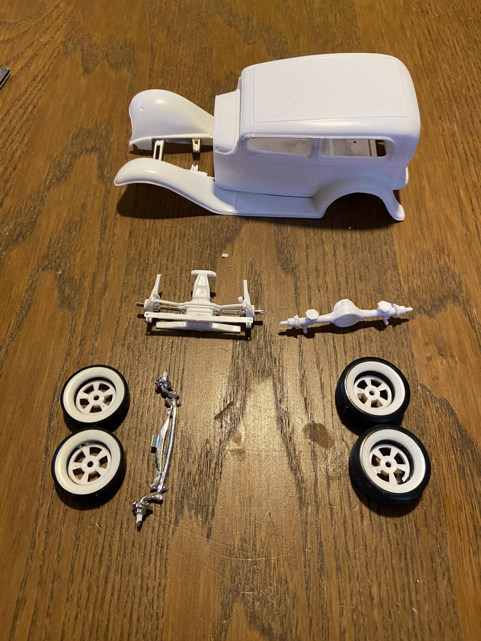

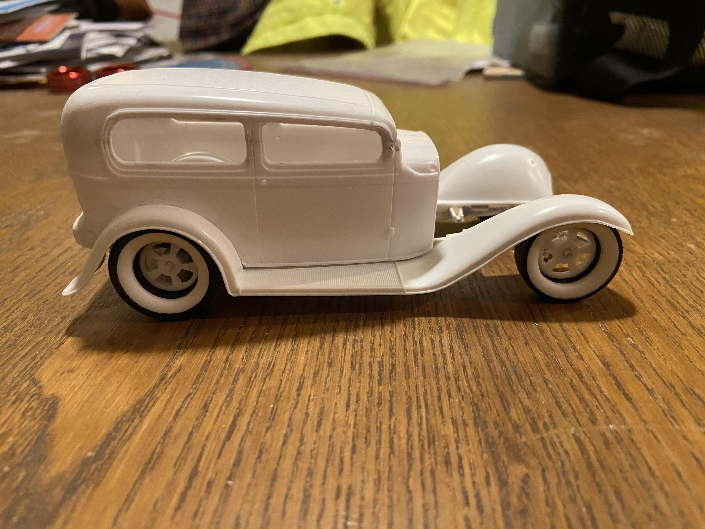

  25. Things are moving along well for the body modifications. Now it’s time for me to turn to the suspension. my plans are to use the drop front axle modified from the 32 Ford kit and I do want to use the big and little white walls from Replicas and Miniatures of Maryland. The rear end right now is from the Revell 32 Ford, 9 inch Ford rear end modified, but now I’ve managed to find a Corvette 1970s vintage rear end diff set up so which to choose?
