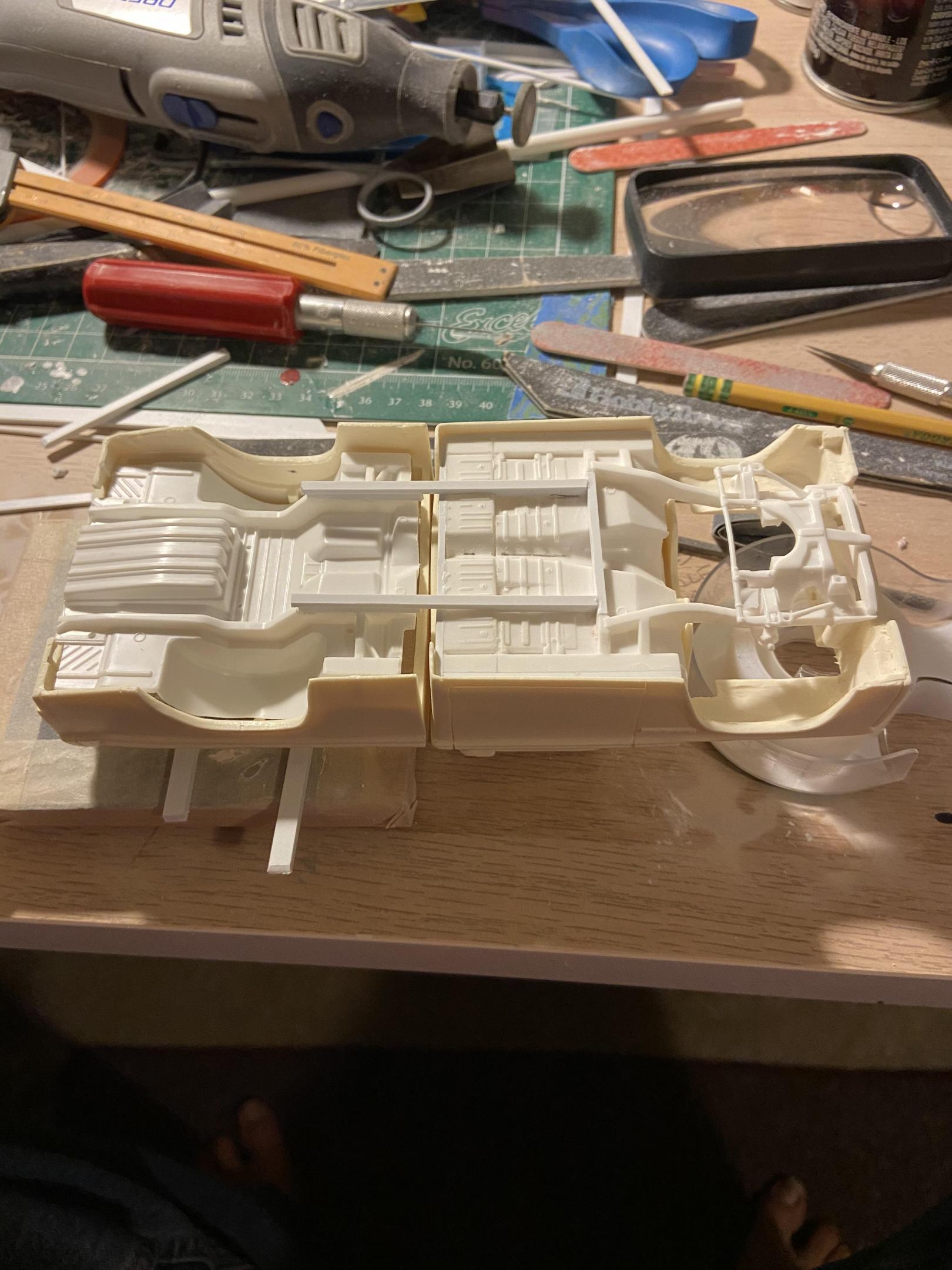

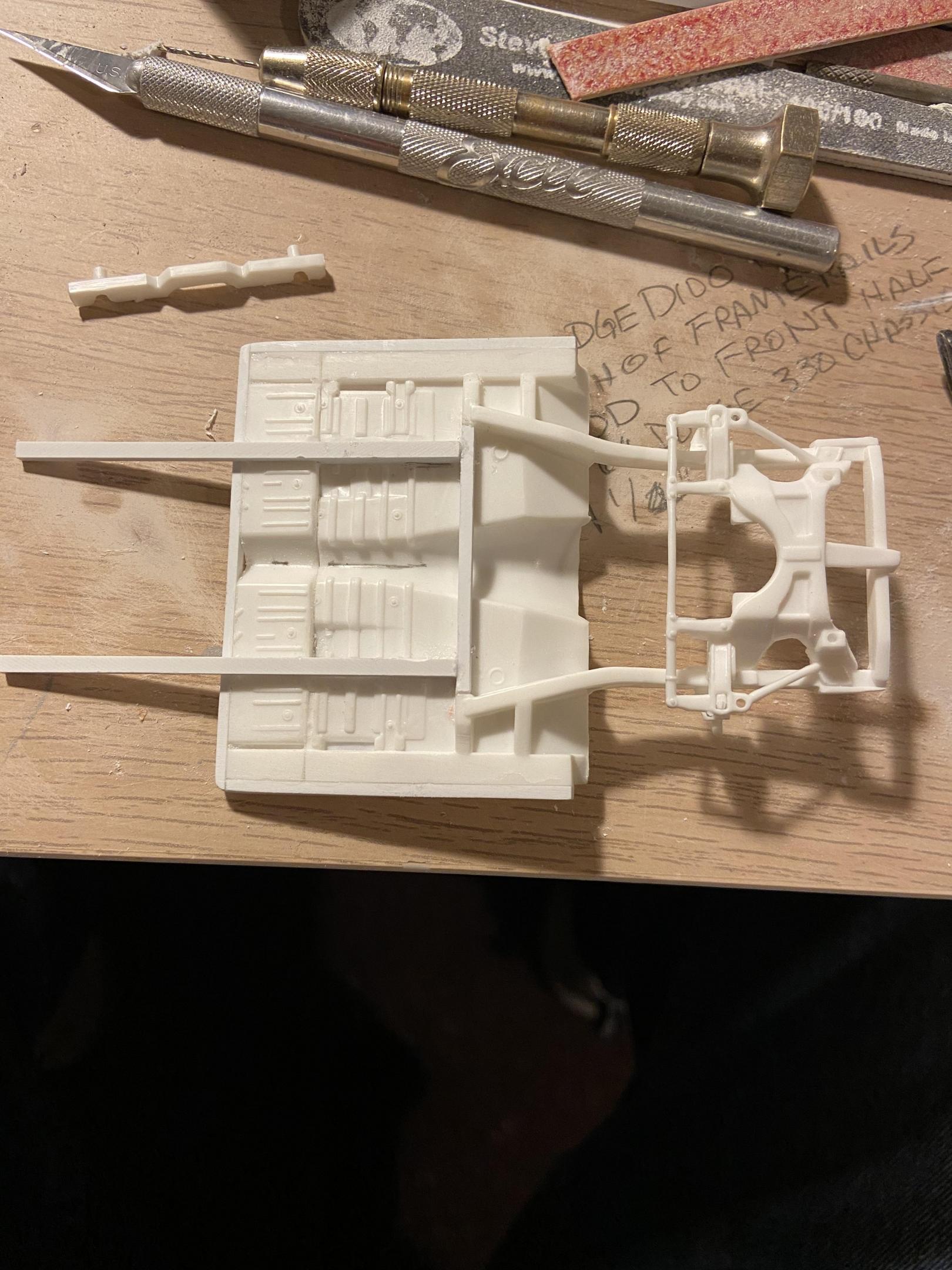

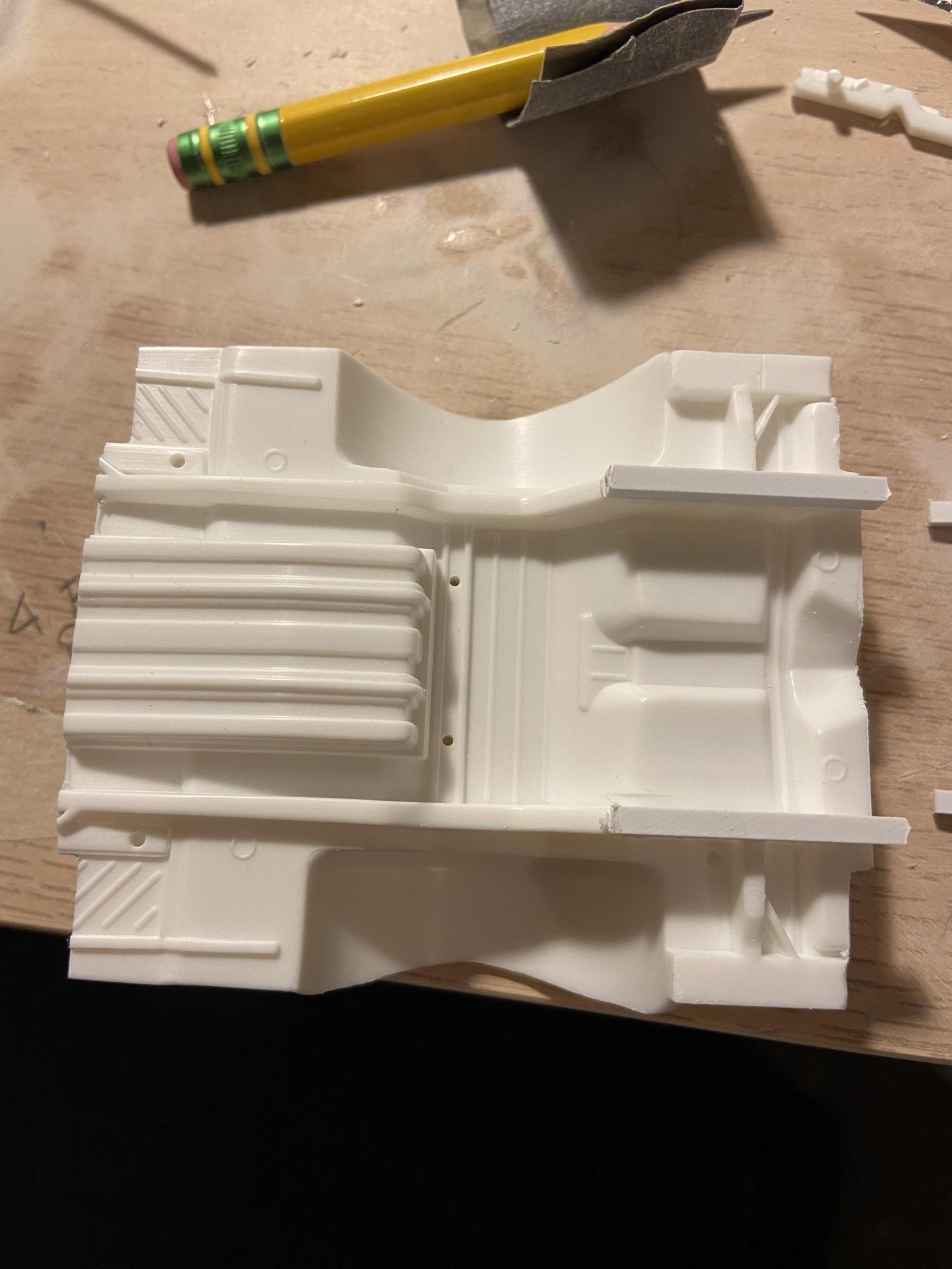

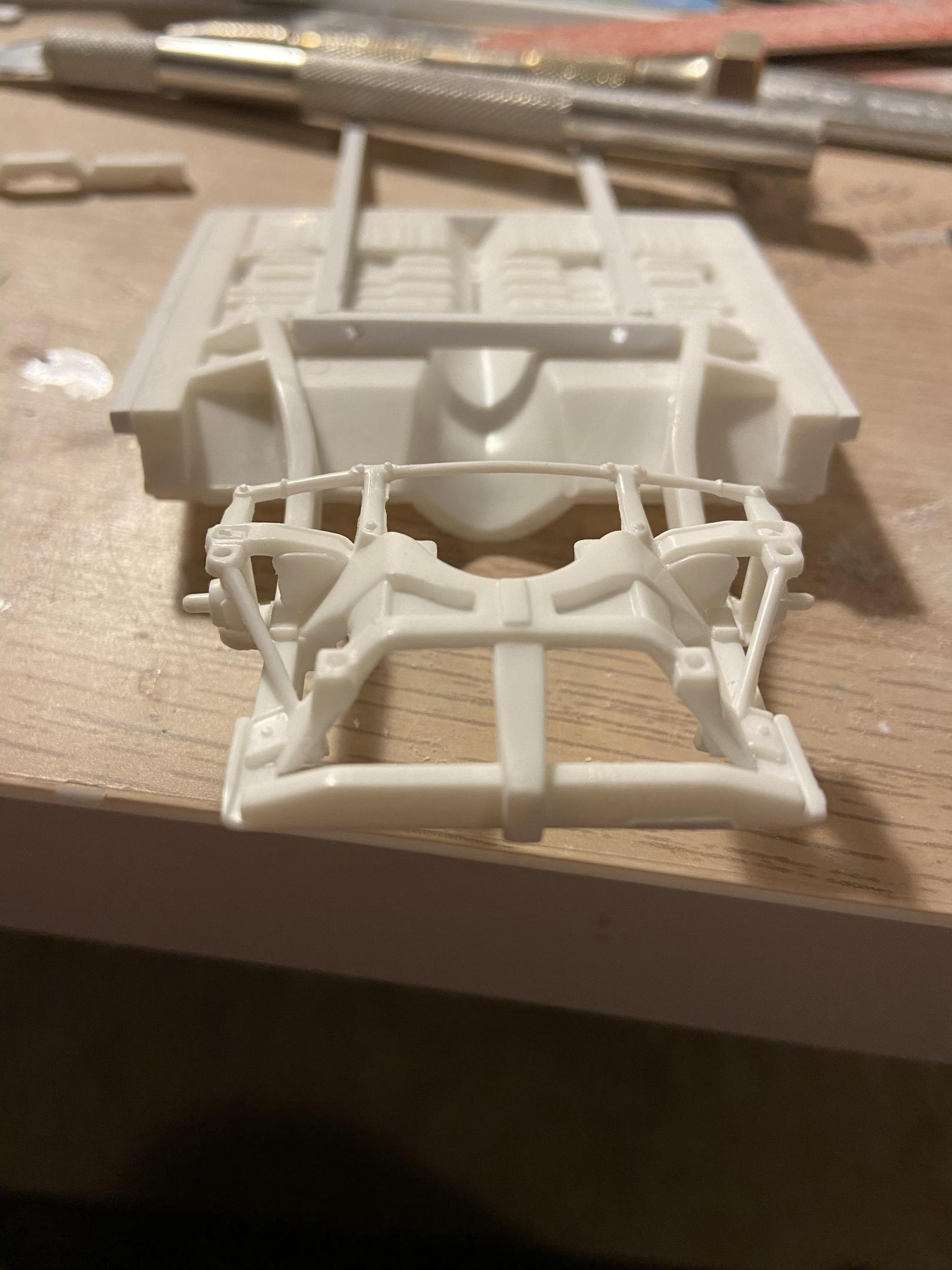

Update: I have been working on the chassis for a bit and I am surprised as to how well the Dodge 330 chassis fits up in the cab, with a bit of work. I measured the cab space and lined up everything and cut the chassis in half almost. The chassis width is a little smaller than the cab. So I added Evergreen strip styrene around the edges and everything looks good. I also cut out the inside well wells, but I’ll rebuild them later. I did make a goof, I went online and found out that the 330 is a unibody with subframes so I made frame extenders to tie it all in. I forgot about the torsion bars - so I drilled holes for those to mount up in the crossmember. I’ll redo the tranny mount later. Enjoy the photos, and keep smiling. -
It has been quite awhile since I posted any builds so here goes. I picked up this Modelhaus 64 Dodge D100 SWB pickup a few months before they announced their retirement. The resin kit is ok, there will be some cleanup on this. It is inspired by Gas Monkey’s build from a few years ago - I want to keep mine all Mopar, the donor kit is the Lindberg 64 Dodge 330. What do you think? More to follow. Cheers

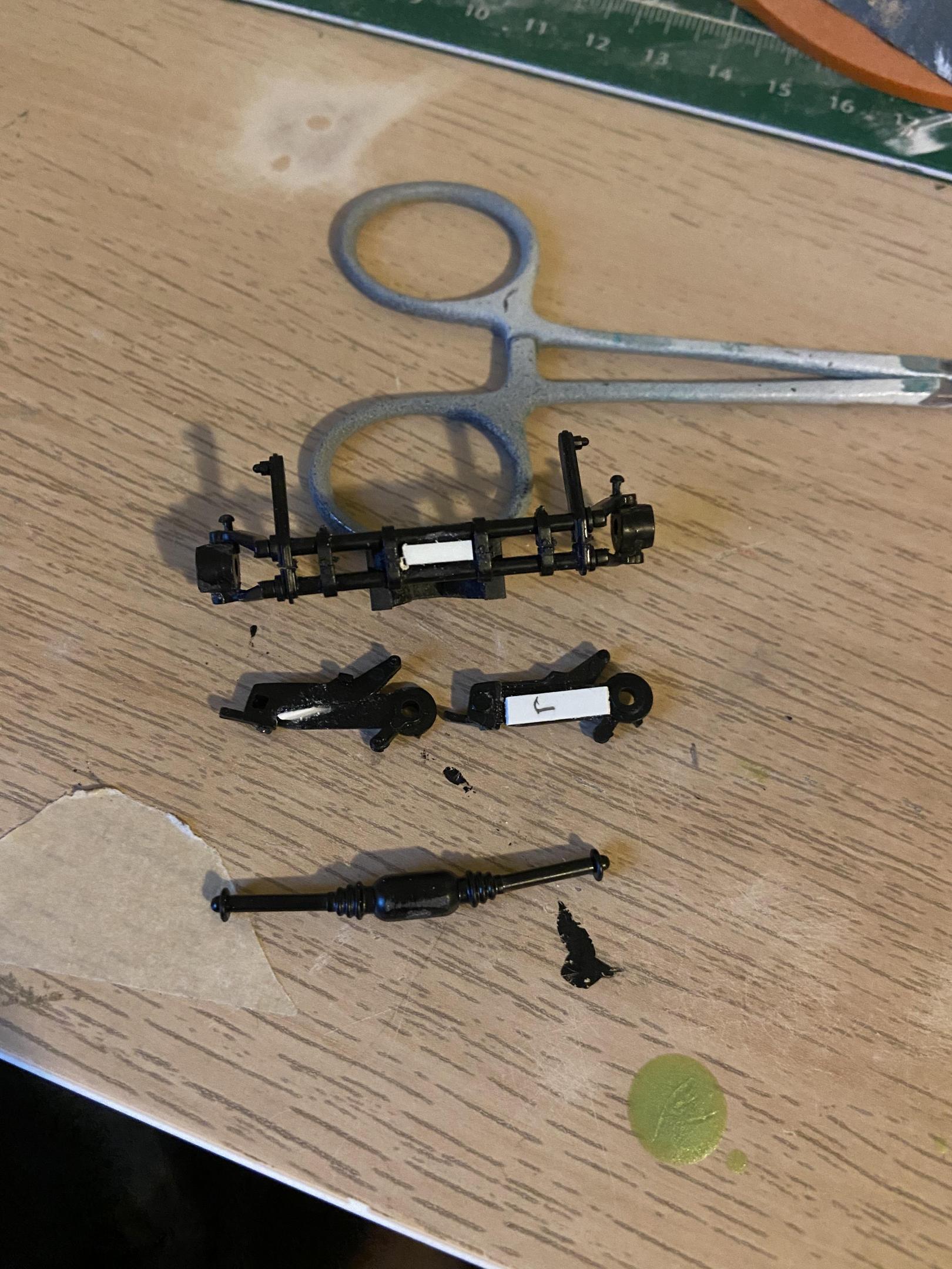

Here is what I did on my Tamiya 66 VW. I wanted my VDub to stupid low, so on the front end I cut the front axle horizontally down the middle and then cut 1 mm from each piece and then glued it back together. Next I cut up in the mounting box so the axle is really moved up. The rear end I cut notches on the suspension arm and then pushed it up and glued it in place. Evergreen styrene was used to re-enforce the glue joints.

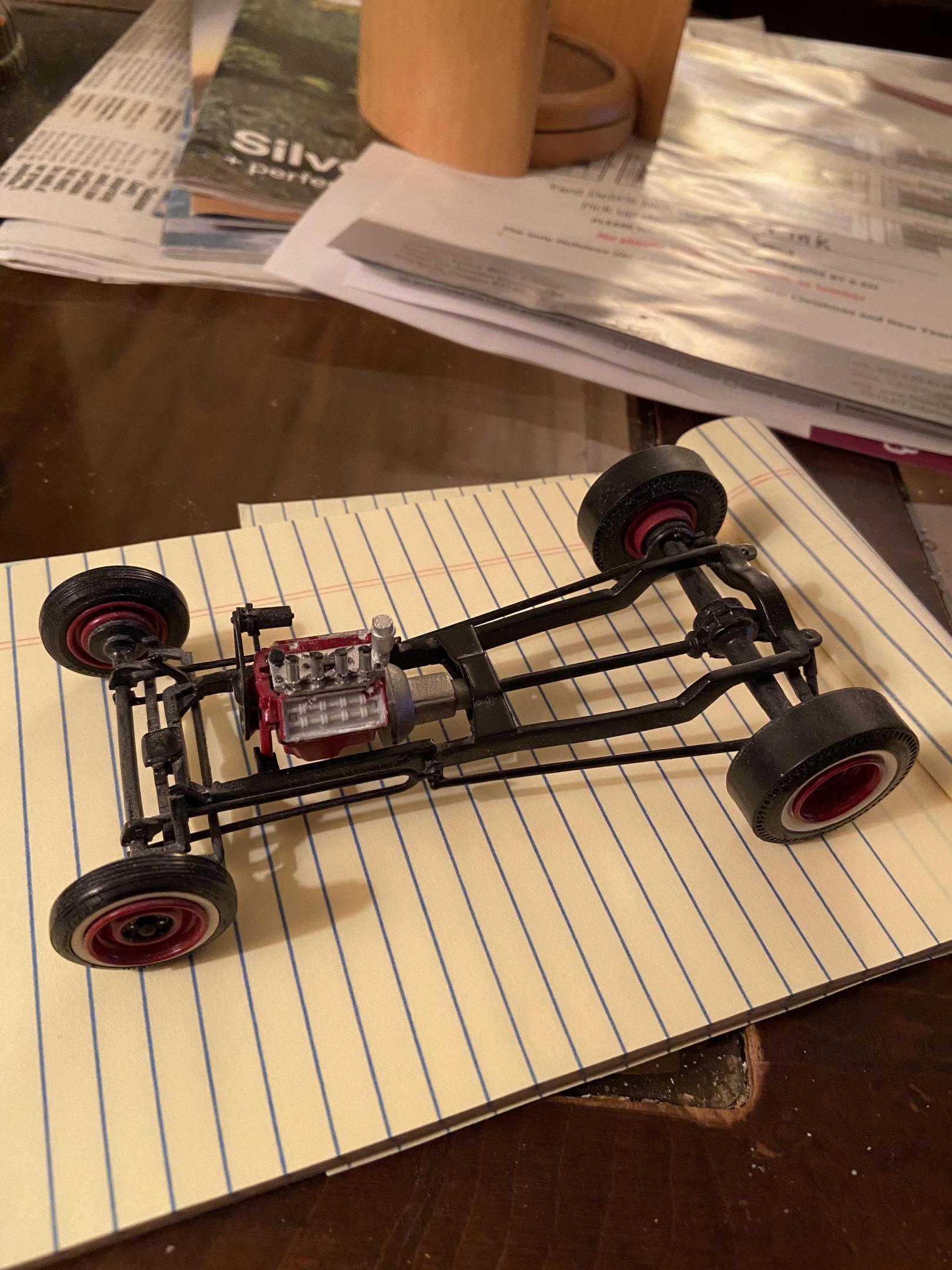

I’ve got one of the AMT 25 T’s going, I never thought that I would like it until I got into it. An excellent boxed Model T frame and the suspension is great to modify. Mine shown has had the frame Z’d and the much maligned 241 Red Ram out of the newer Ala Kart. Hope that y’all enjoy.

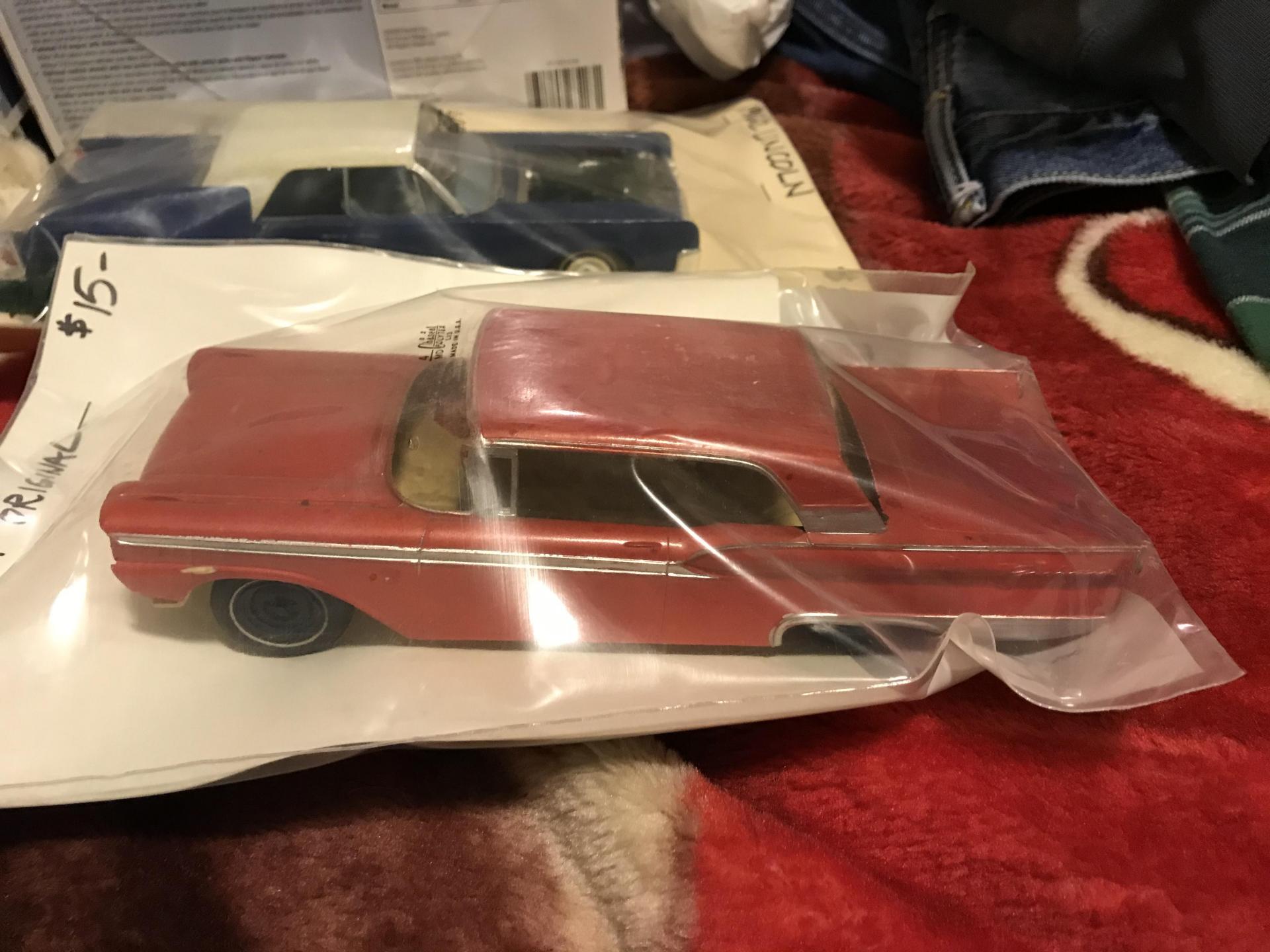

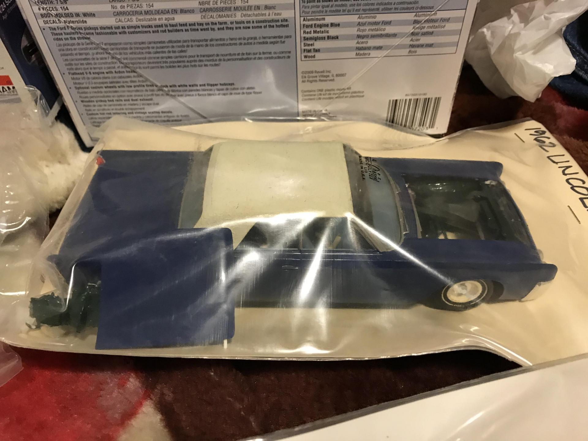

Well I didn’t get this today, but I attended a model show this last Saturday in Clackamas Oregon and among the things I got was an AMT 1959 Fairlane Hardtop body and a complete built up of a 1962 Lincoln Continental Hardtop. Time for some Superclean.
