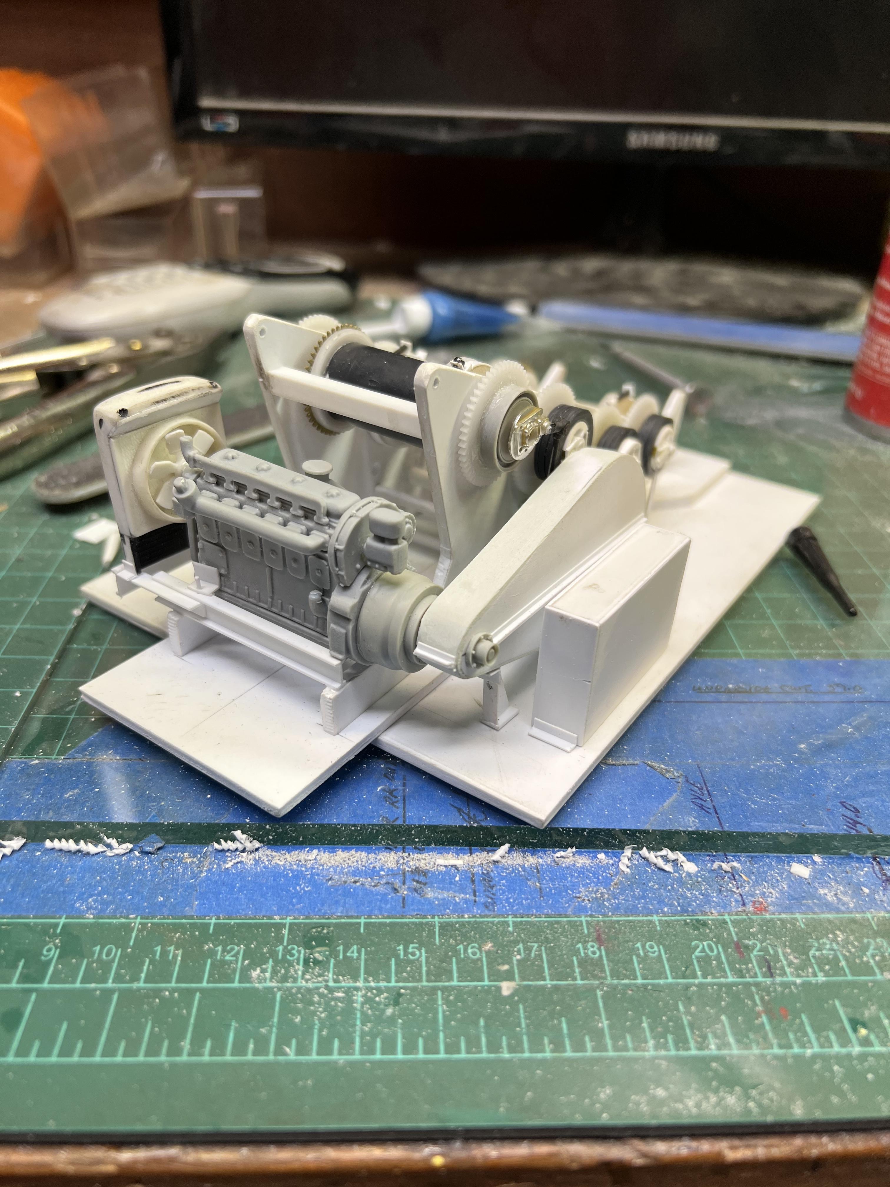

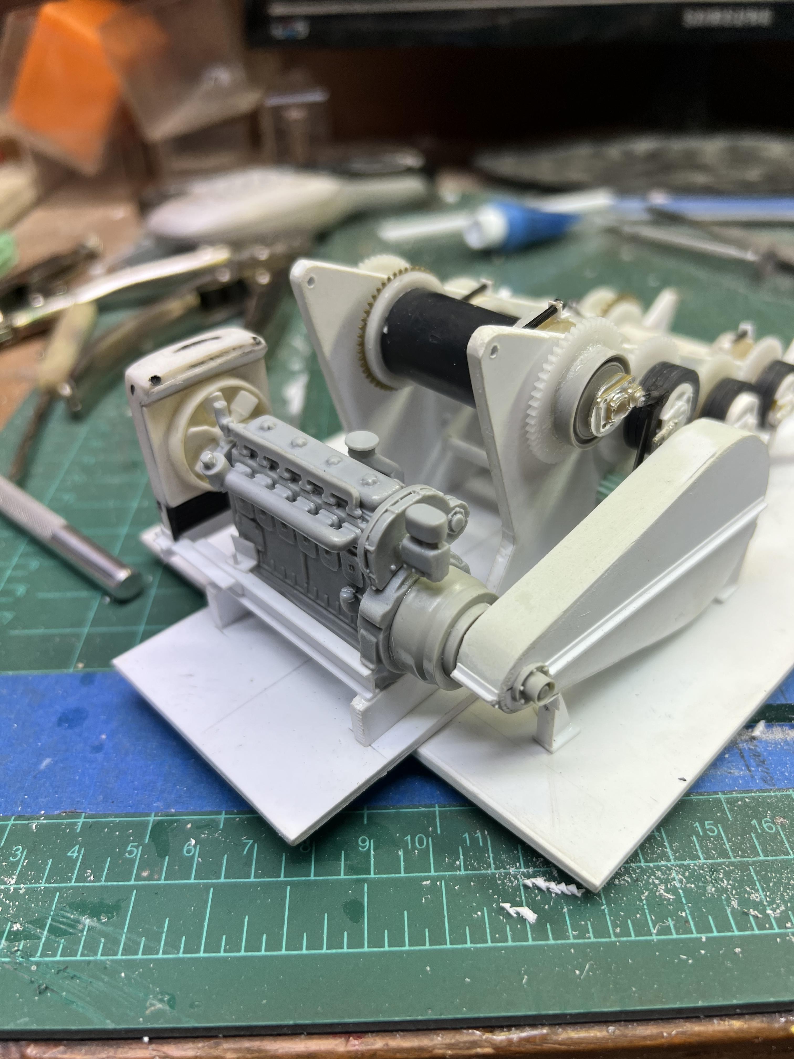

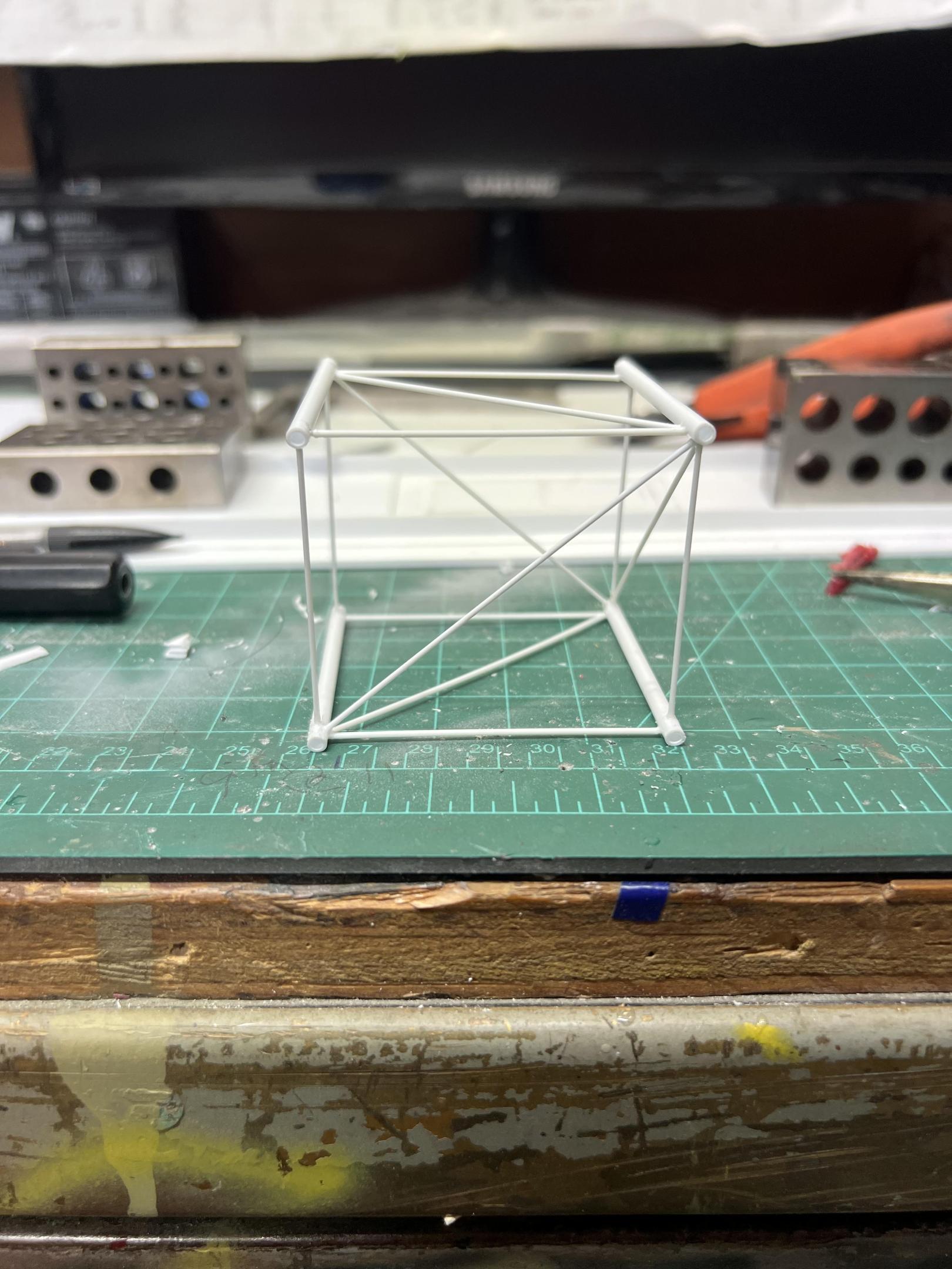

  1. Appreciate the good words sir! It’s only cutting and gluing pieces of plastic that is assisted by having all the manuals and being intimately familiar with the real machine. And it helps to have a background of being a fabricator as one of my former jobs. Got the drive covers fine turned today so at this point this part of the build needs some final gizmos and then all of the wiring and air and hydraulic lines and the counterweights, but those will be done later. Now the next step is perhaps the most straightforward but also most likely the most difficult to get right. The boom assembly is next. I asked for guidance from the best modeler I know, Charlie Rowley, on how to work with brass. He gave some superb pointers. So I figured what the boom would weigh and decided to go with styrene instead. I plan on making a scale 100’ of boom, which will be 4 feet long. In brass it would be way too heavy, so on to cutting and fitting a LOT of Evergreen tubing!

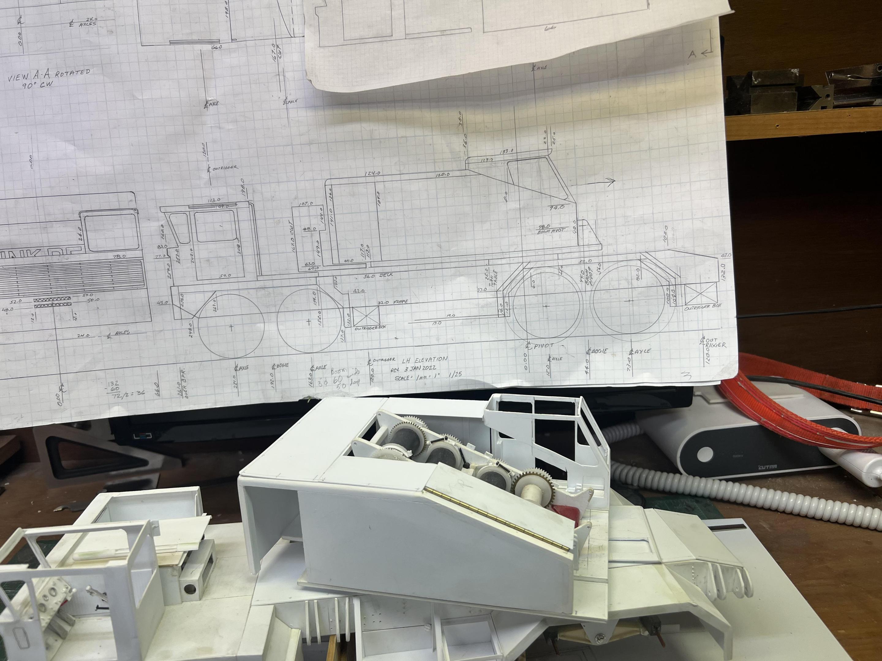

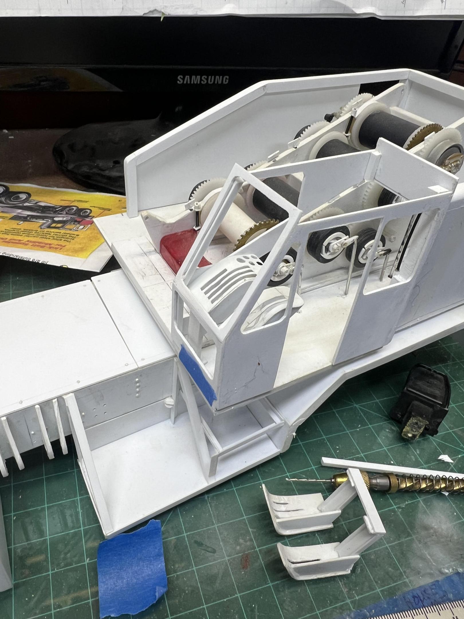

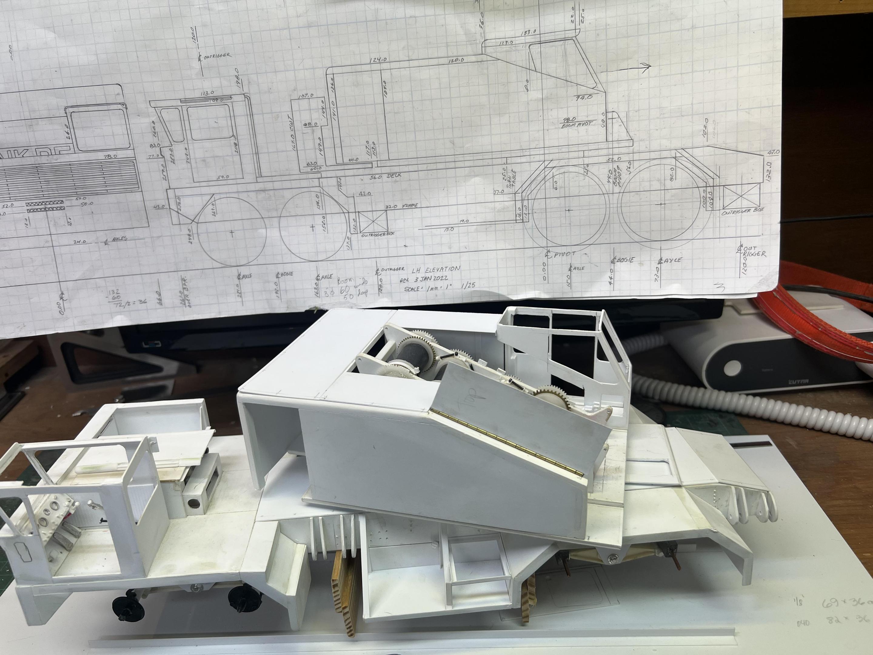

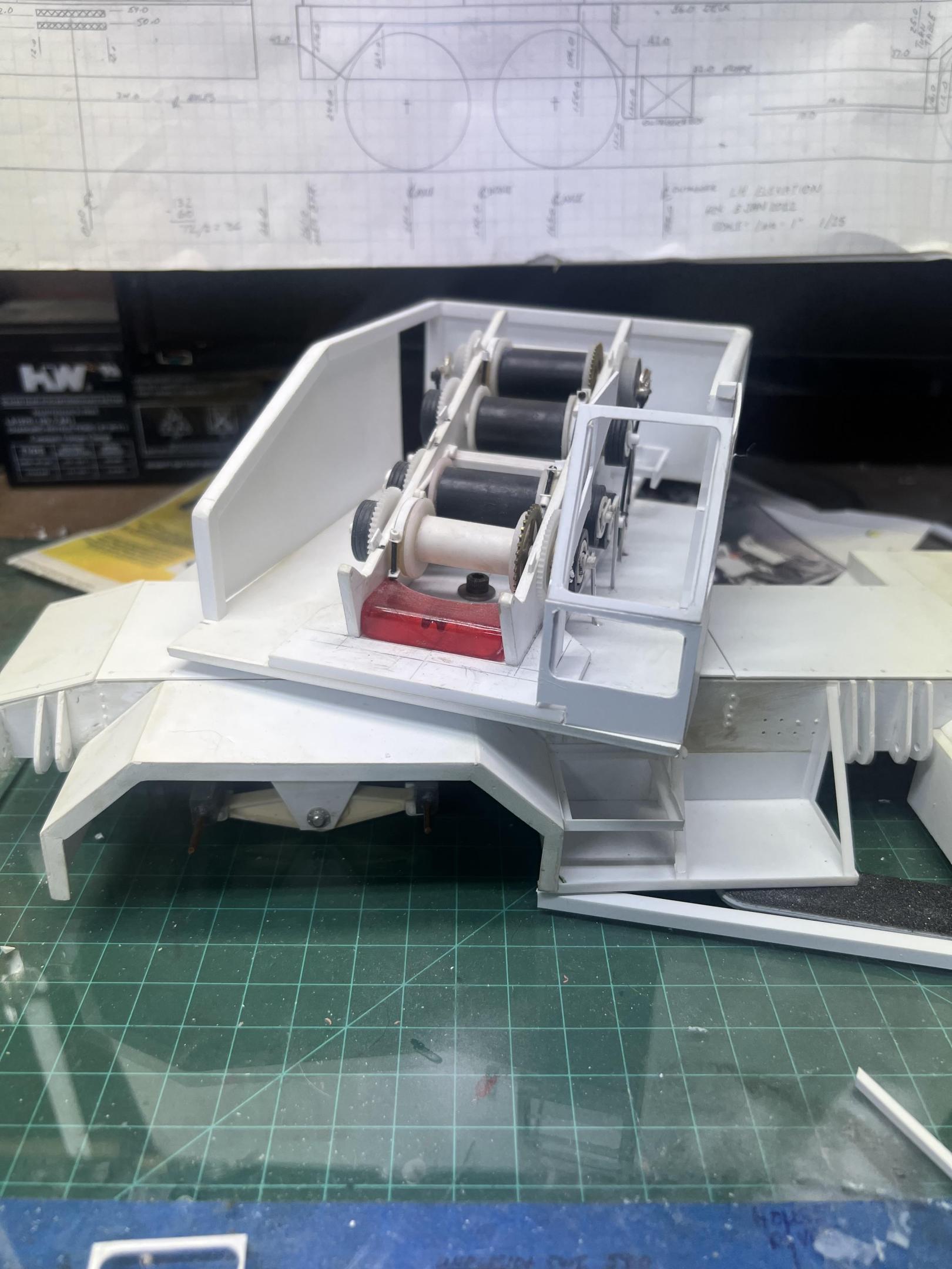

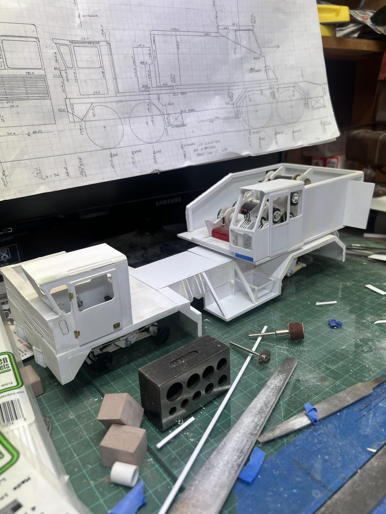

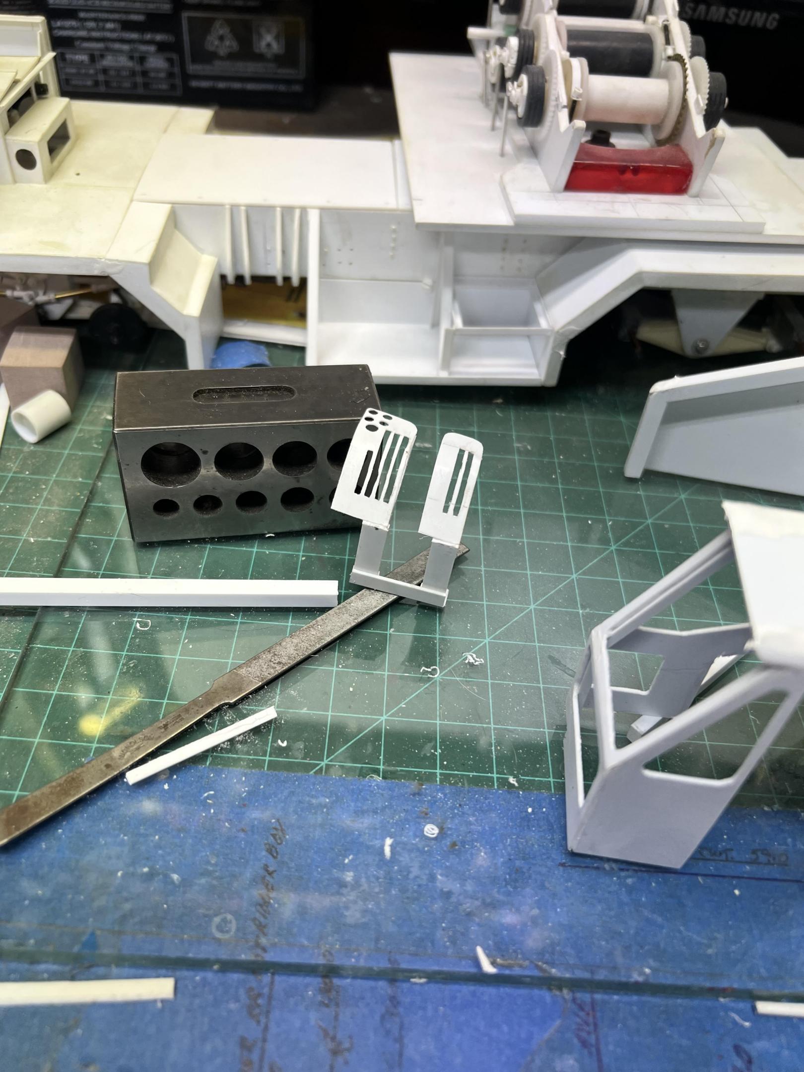

  2. Got a few more things done. Fabricated the swing control lever. Added the rest of the controls to the upper cab. Made up the counterweight support structure and installed it to the rear of the upper house. Will make up the counterweight removal linkage next. Made the counterweight removal hydraulic power unit. Added dunnage to the carrier trays. I put a leash on the radiator so it doesn’t wander away again! Added the step to the carrier for the driver and the hexagonal hub extensions on the drivers side front axles that are used as a step to get into the cab. Still have to do some fine tuning to the drive guard covers and make the counterweight removal linkages. Have all of the recently added pieces held to the build with museum wax so the final assembly after paint will allow final alignment. Then unless my OCD finds something else to do before I get the boom under construction.

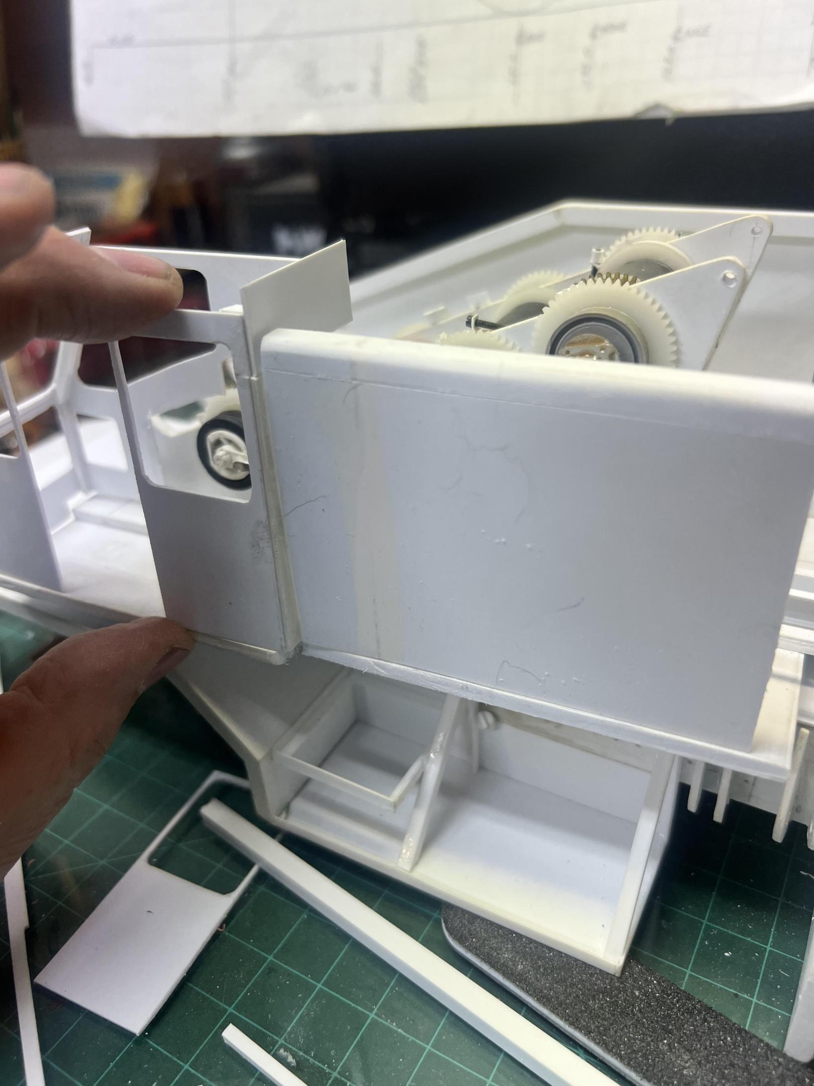

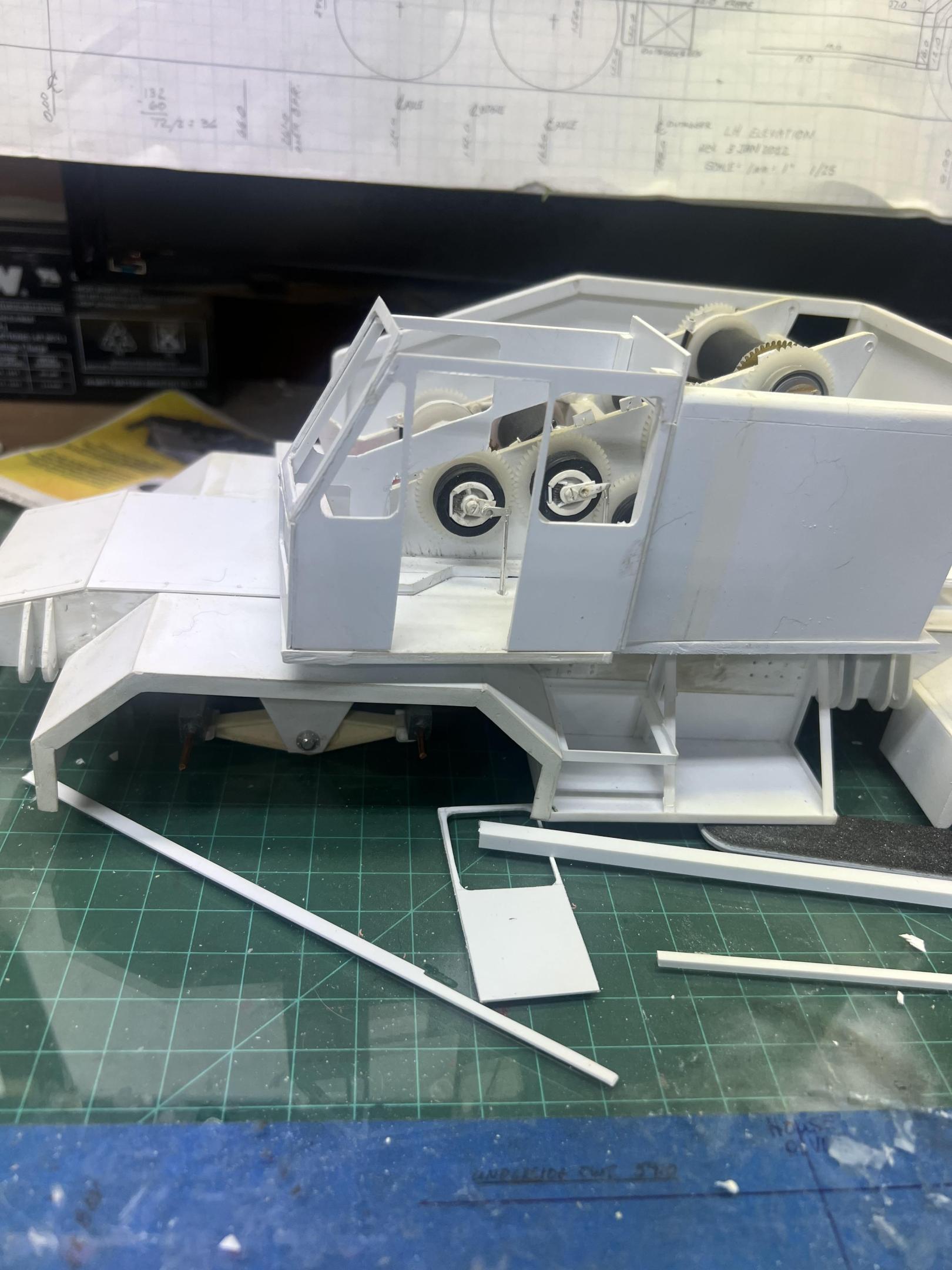

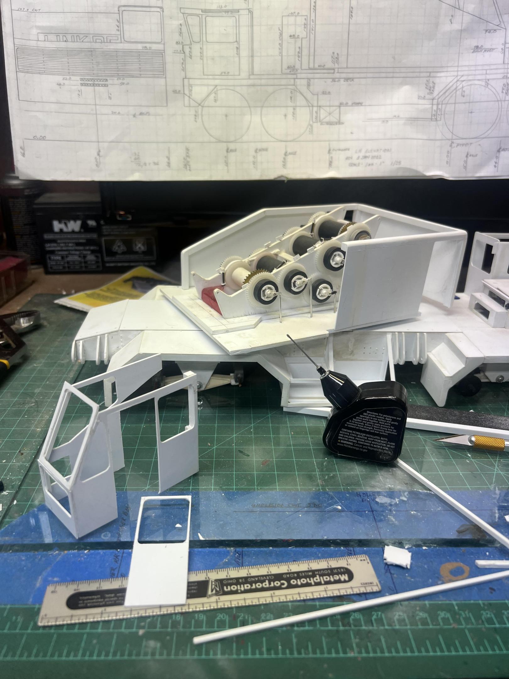

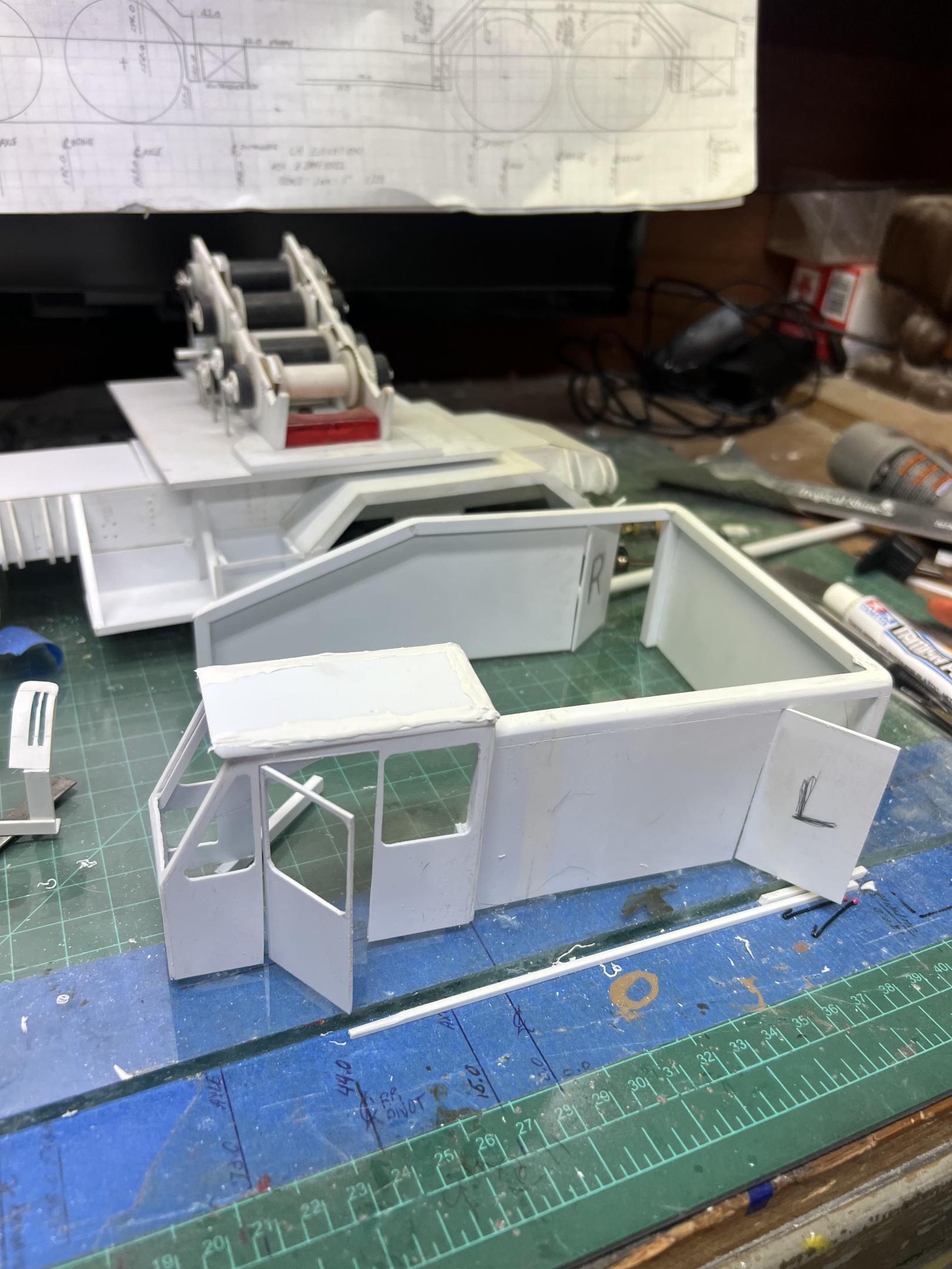

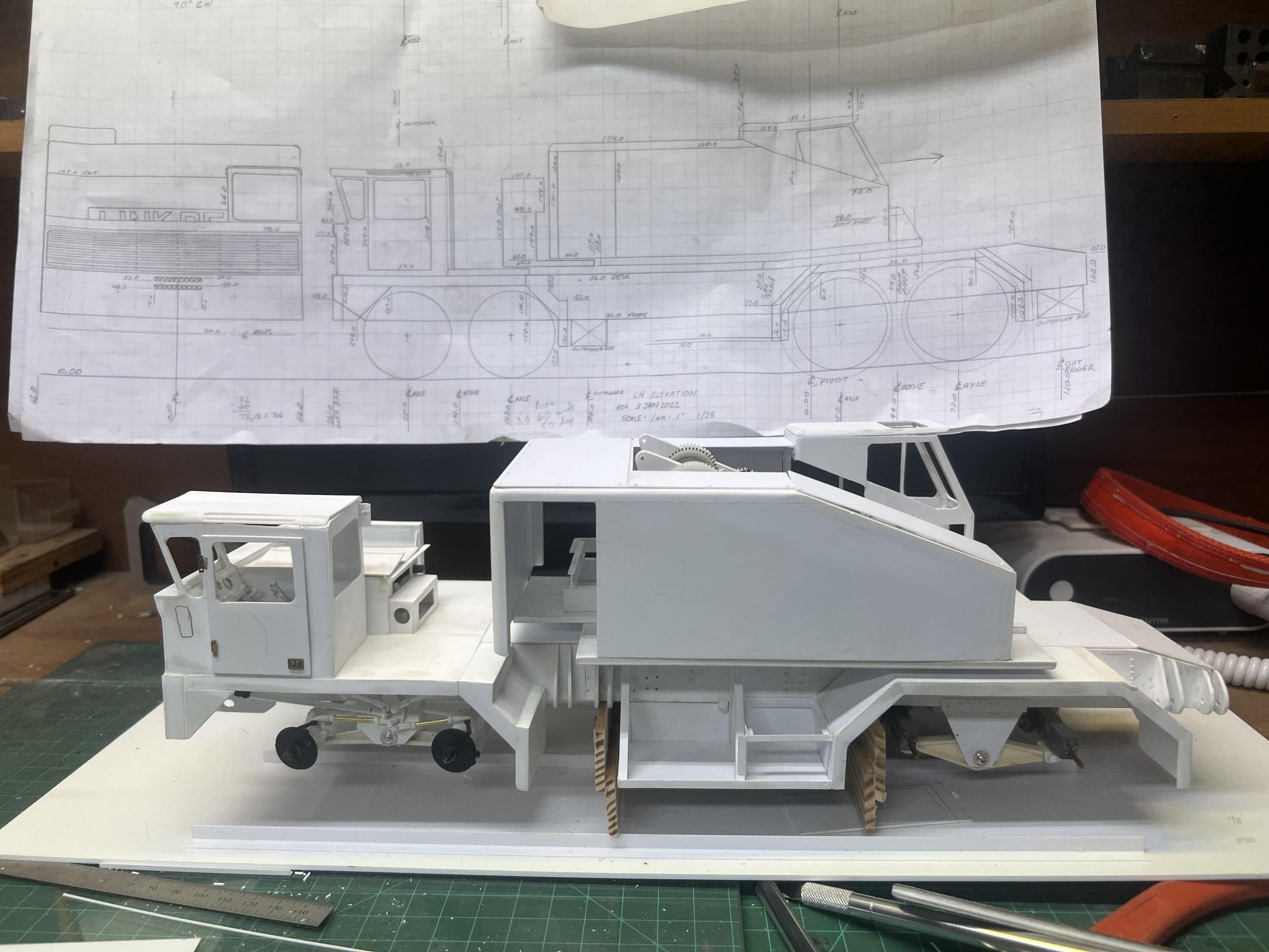

  6. Installed the carrier and operators cab doors, both rear side doors on the upper house, the rear sliding access doors on the house and all of the top covers. Added the outrigger control cabinets on both sides along with the outrigger hydraulic tank, and the hydraulic power pack for the counterweight removal system. Added upper and carrier battery boxes. Added the upper exhaust and air cleaner. Changed the bifold carrier engine cover to a one piece side hinge. It is all mocked together in these photos to check fit. And in the process of fitting it together I discovered that I misplaced the carrier radiator and presently have zero idea where it is! Oh well! Now have to fabricate the counterweight removal mechanism. It’s coming along! Maybe the radiator will show up…….maybe not! EDIT....And ten minutes after I wrote the post……I found the radiator!

  9. Just did these hinges last evening. The two side access doors on the upper house are the #15259. They come assembled. The ones on the carrier cab and the upper house operators doors are #15256, and the long one on the upper winch cover is #85816. The #15256 have to be assembled, which for an old guy with arthritic fingers can be a challenge. Do it in a box so when the parts go flying they don’t disappear!

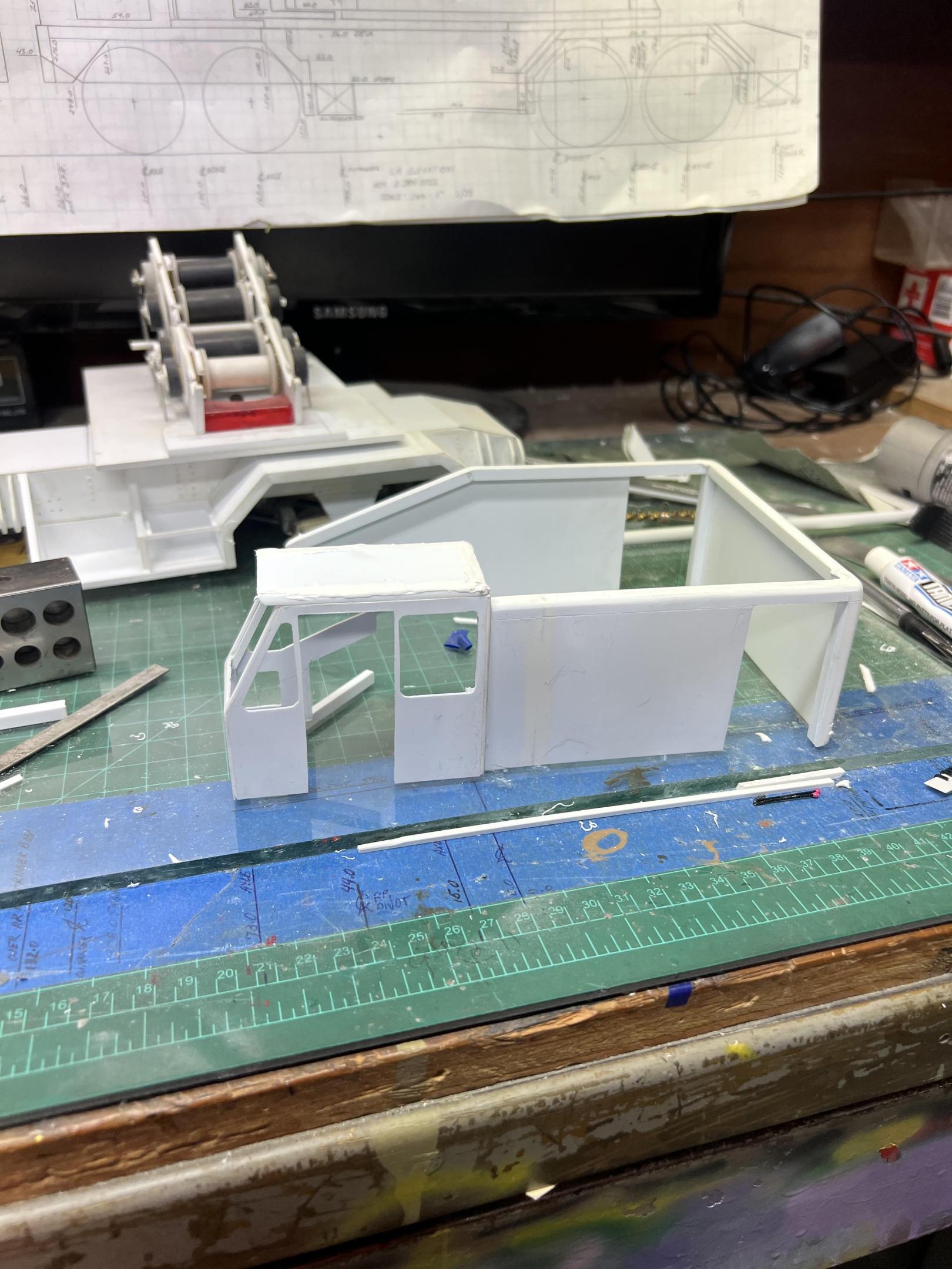

  16. Well, got back home on 1 April from our winter trip south and then west to Texas, weather was nice so even got my Corvette out for a ride. The next day it snowed and almost every day since then at least enough to stifle Corvette fun. So…….got some much missed and needed bench time. Worked on the upper crane works. Made a jig with false sides to allow me to make the guards so they all lined up with the house sides when I put them on. It also lets me rotate the house to work on it without being attached to the carrier. Makes it easier to work on house and carrier. Was able to get the house and all guards, covers, and upper doors figured out. Also got the operators cab all roughed in. Lots of detailing to do now. After the last year of being so busy trying to sell my business, which fell through about 9 days from closing, we decided to get on with retirement and liquidate it in pieces instead of selling as a going business. Couple that with TRYING to retire, and didn’t get much time at the bench. But working on that now! Cleaned my bench off, for the second time in two weeks, holy cow it gets cluttered FAST! Now more details for the upper works, then boom time! Oh boy!

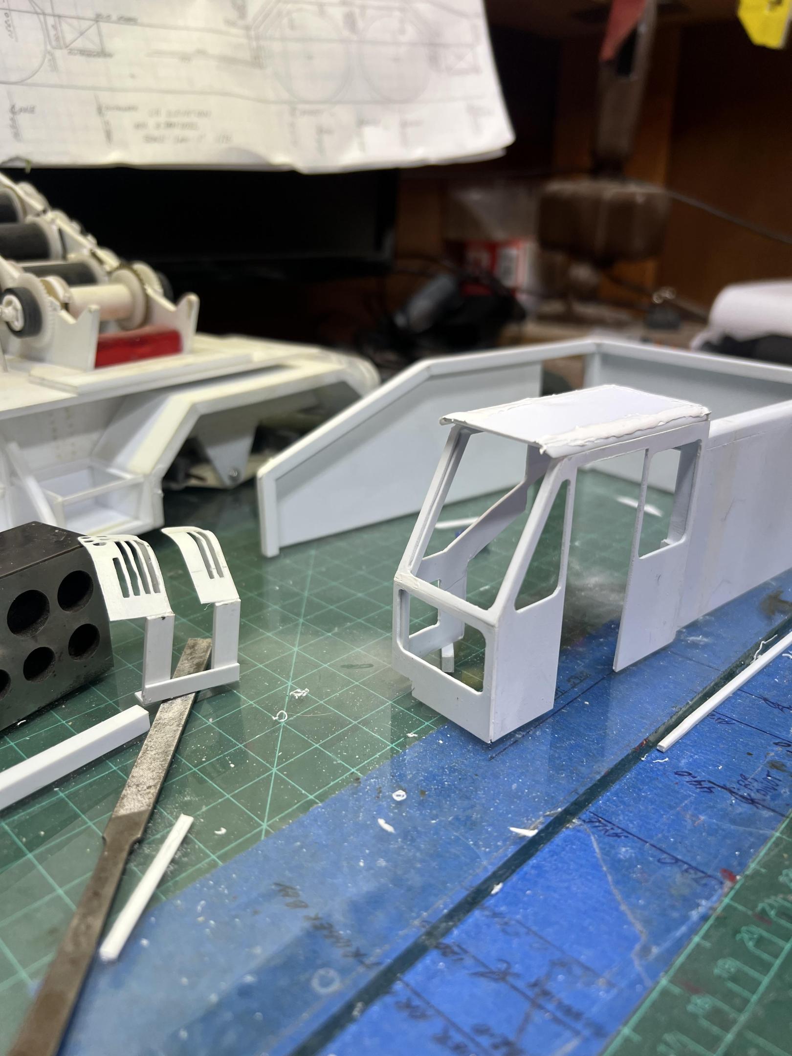

  19. Yeah you’re probably right! Not like it hasn’t been keeping my mind occupied already! Most likely this will be still on my bench when my ticket is punched, but it is getting closer!

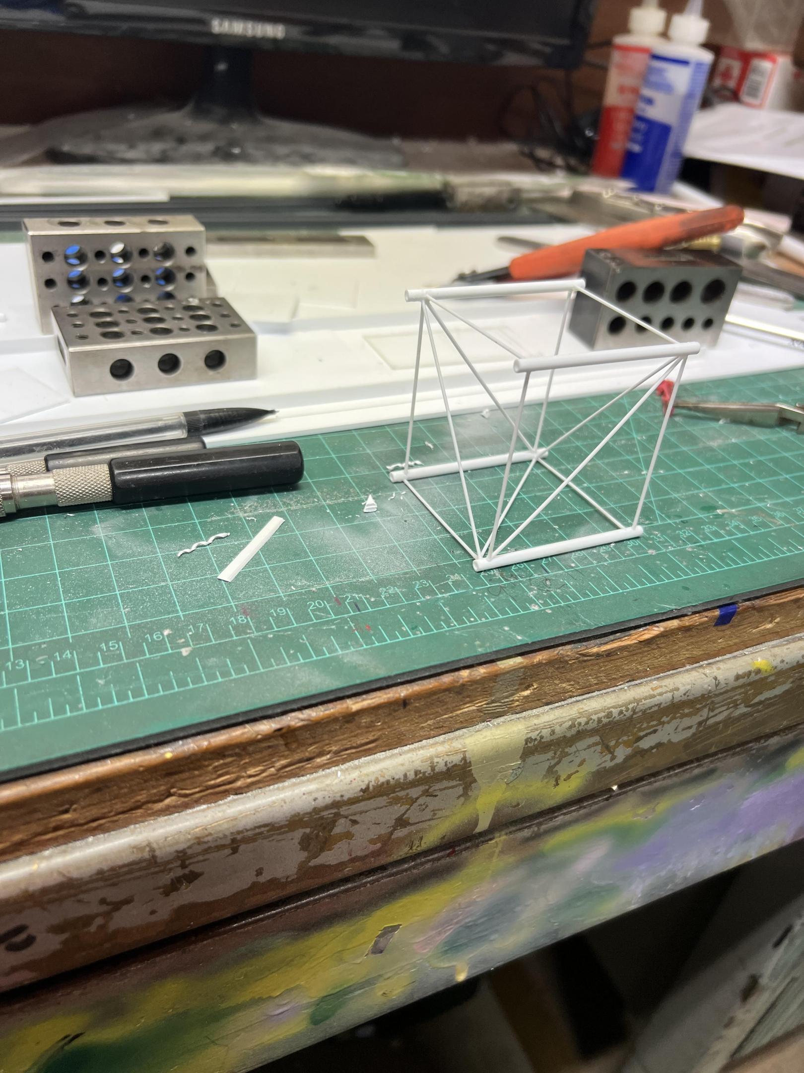

  20. Yes sir, the engineering always works. I have no concerns with using styrene either, as this is not being built to handle a load. But as a proof of concept to try out the assembly method, I’m quite pleased.

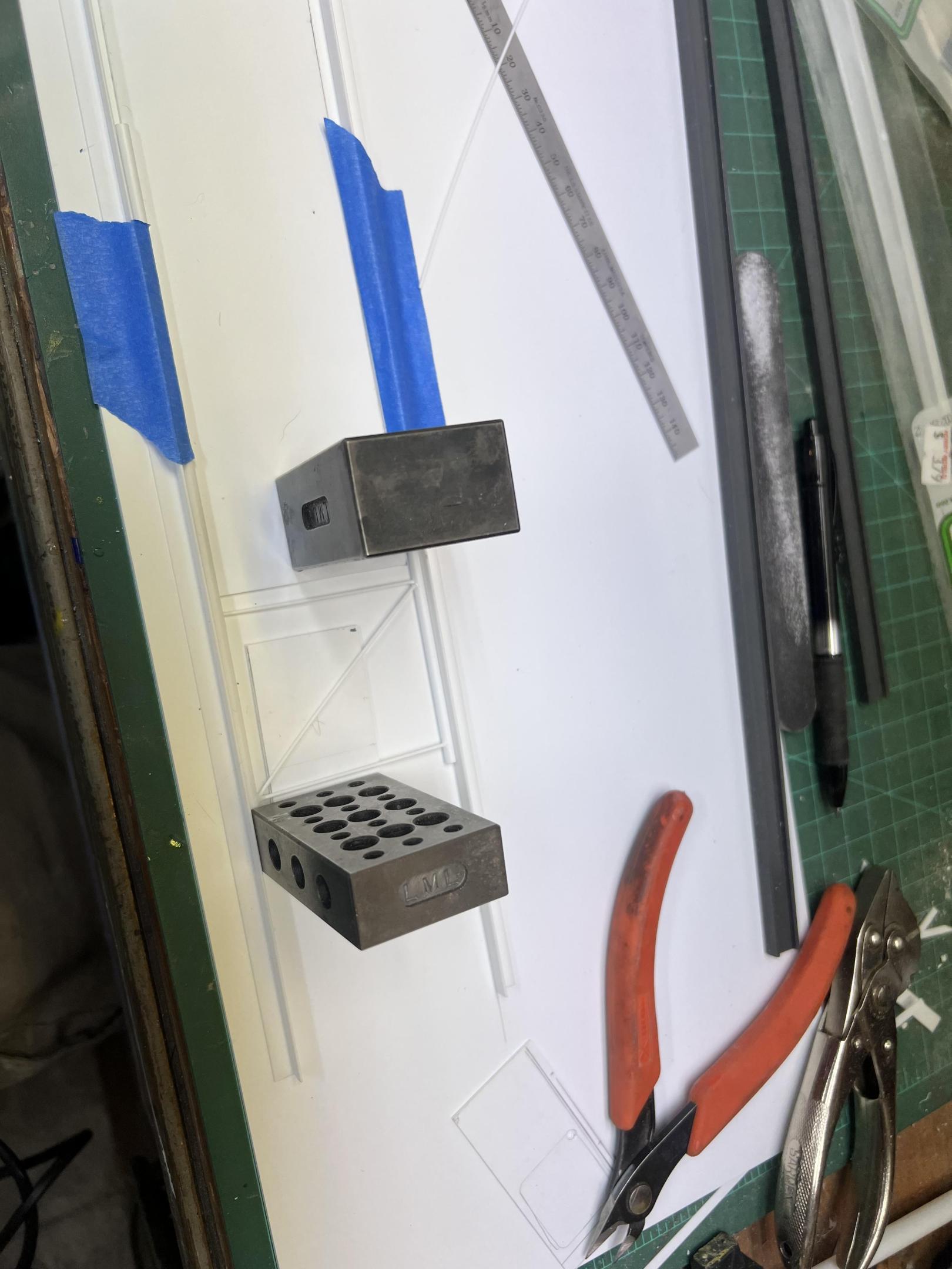

  21. The one thing in this whole project, now going on 5 years, that was daunting, is the boom. I don’t know how to work with brass, nor do I have the knowledge to make it in 3D, so it is old school for me, lots of Evergreen shapes. So, it is about the time to start at least the butt end of the boom and its associated parts. So……I just jumped in with both feet and made a trial piece to see how it would go together. The actual lattice boom is 60” wide and 50” deep, made of 3” tube for the chords, and 1” tube for the lattice. I made a jig to hold the parts as they get assembled. And what you see in the photo is the result. It actually is quite rigid, and light. I hope to build 90 to 100 feet of boom. So far so good!

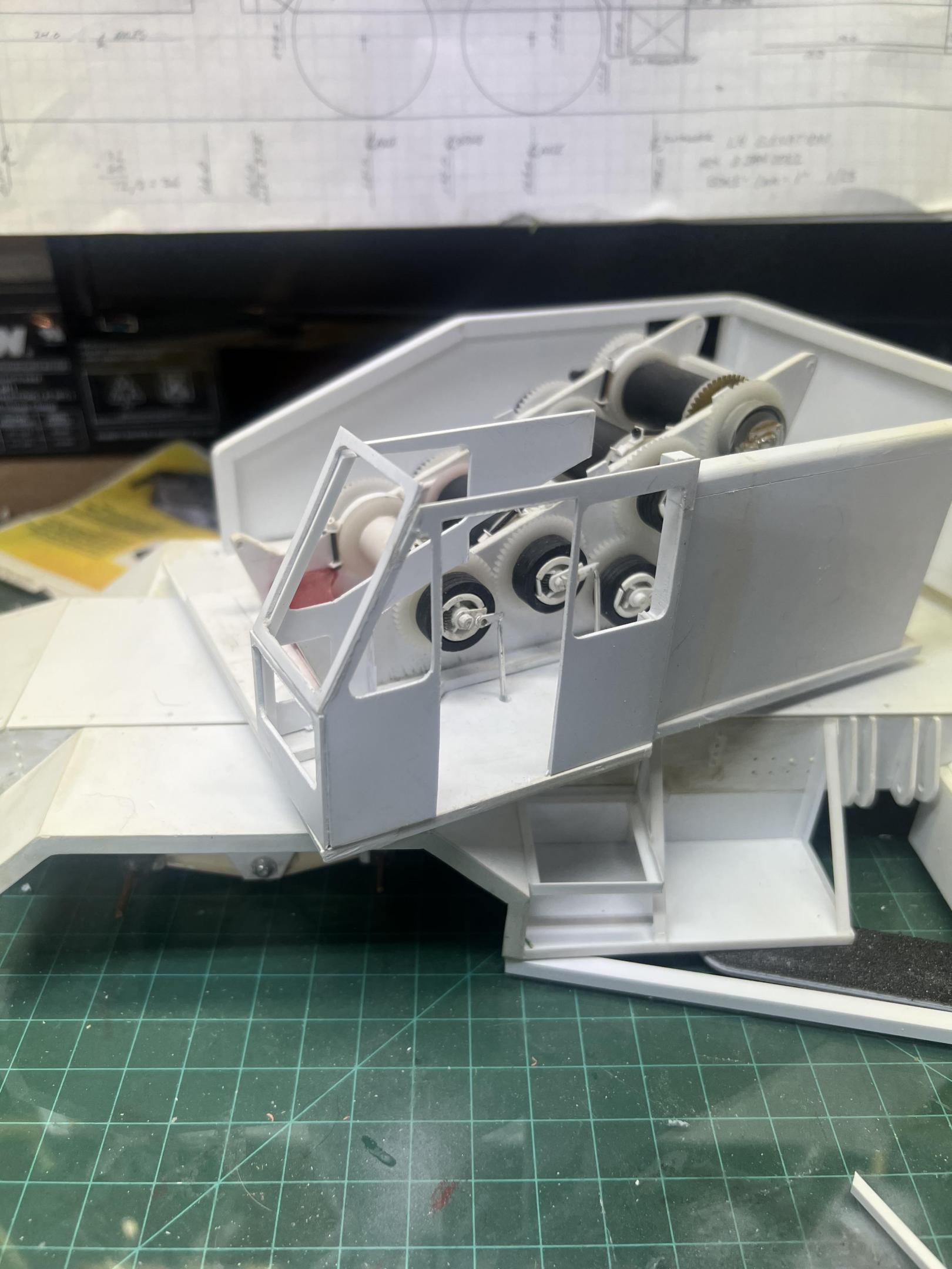

  22. May not ever finish this monster, but am sure gonna give it a good effort. Haven’t had lots of time to work on it with the last 2 1/2 months spent deer hunting. But the freezer is full. Have gotten a few more things done on the upper house. Built the operators cab and the control pedestal. Found that my wife’s junk hair curler has bristles that make perfect control handles with knobs. This thing is such an involved build, it is extremely daunting. But I started it to be super detailed, and I simply cannot deviate from that path. The way I figure it I’ve only got about 1500 - 2000 individual pieces to fabricate and assemble, and endless rough edges to clean up still to go! I am leaving to head south for three months after New Years but will be back at the bench right after that. I had thought that I would be getting lots of build time after I retired. I am getting lots of traveling with my wife, lots more hunting than ever and just getting back to this build in between everything else. Still wouldn’t trade it back for working!!!
