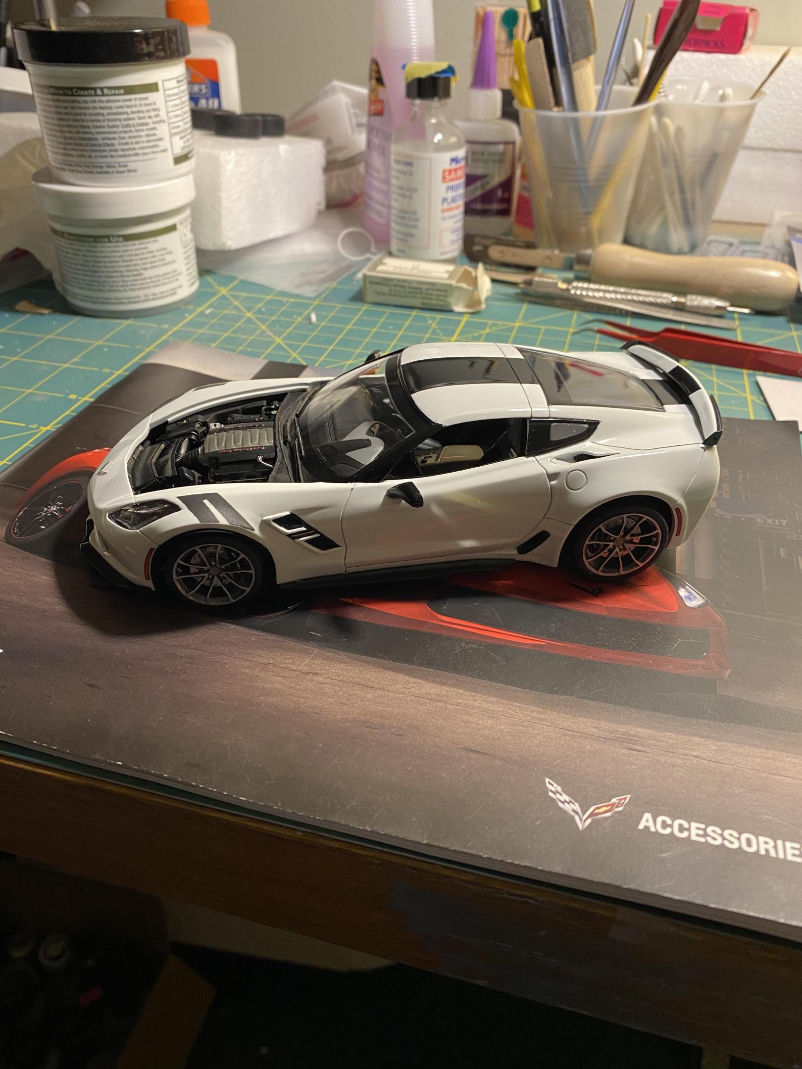

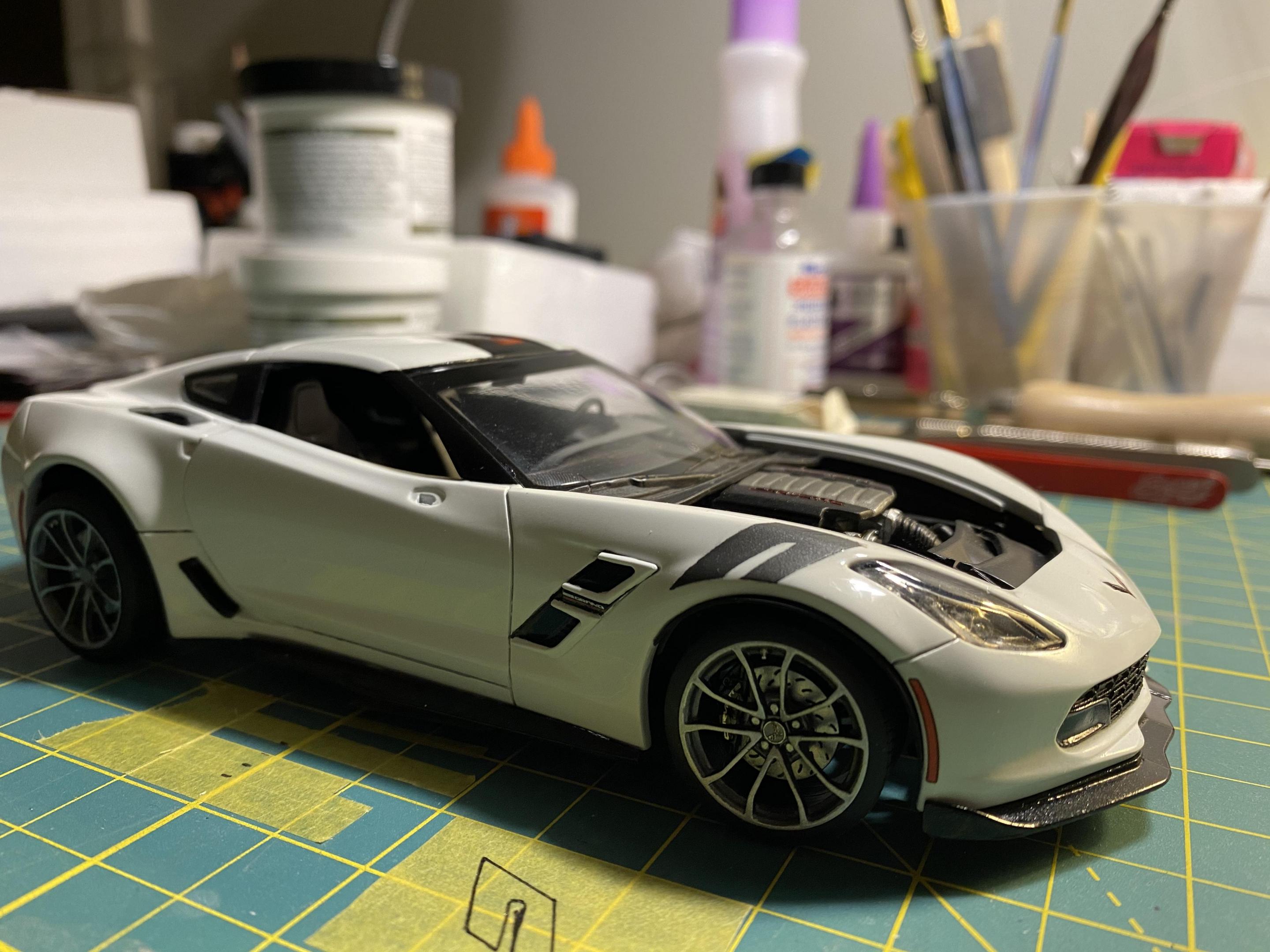

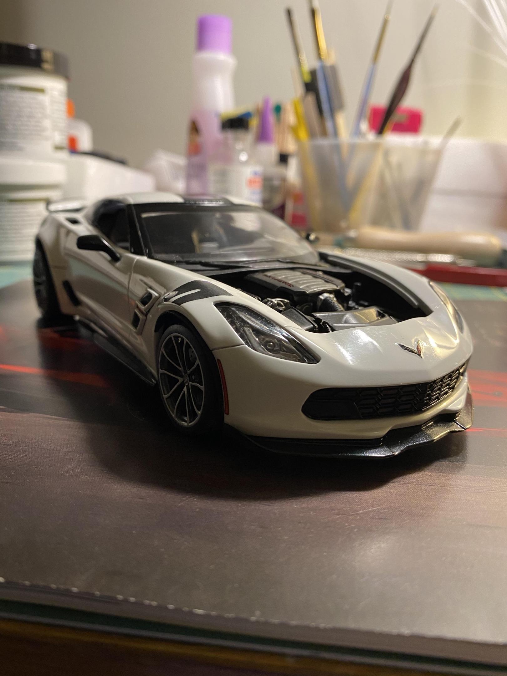

Finally completed !! After almost 1 year on the bench. Next stop is 'under Glass' , where I'll post more and hopefully a little better pictures of the GS --Thx for viewing.

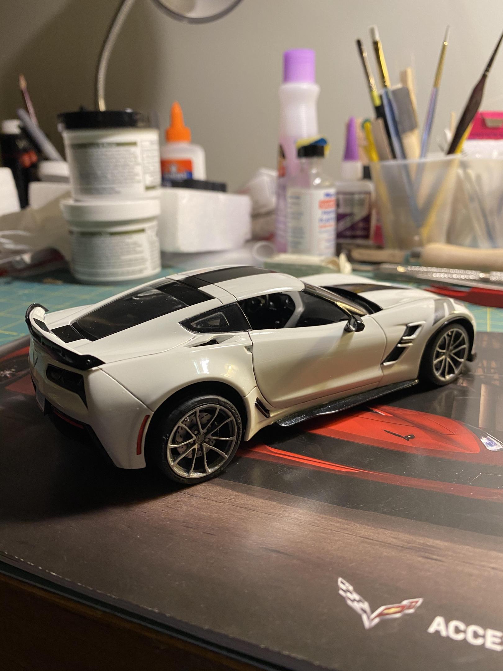

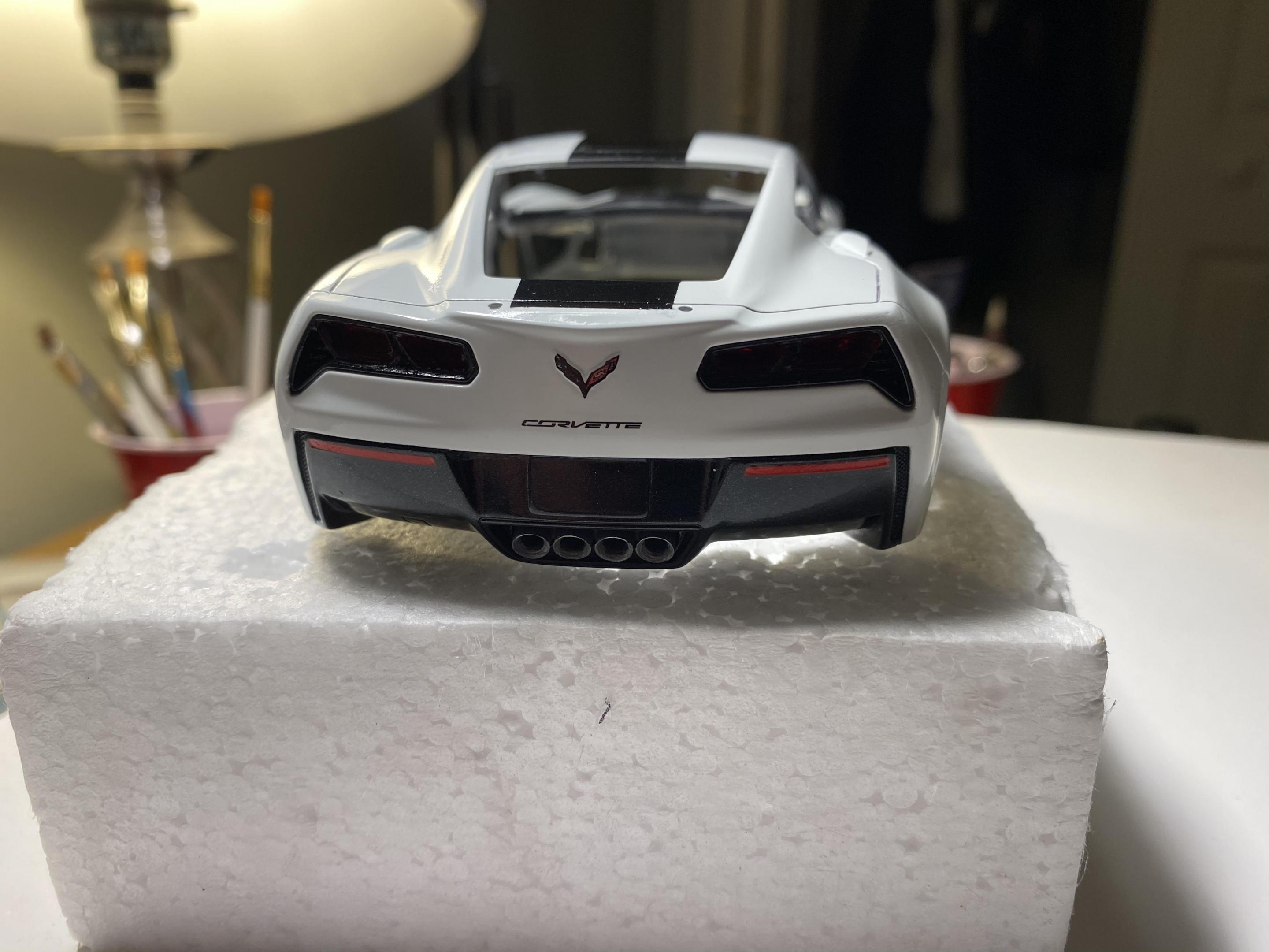

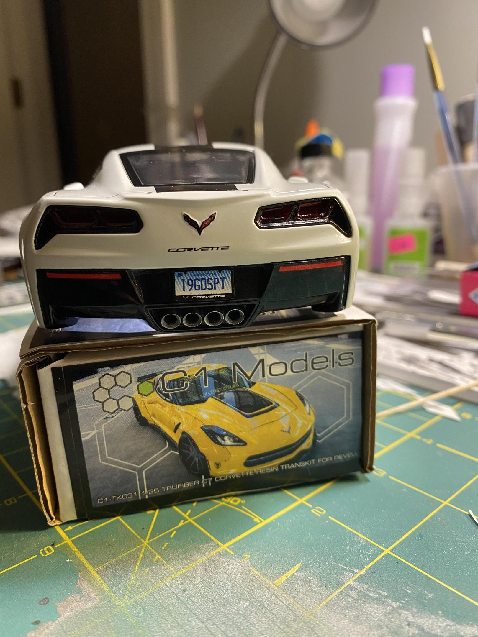

A quick update -- Front , Rear and side windows in place. Also added the license plate on the rear. Almost ready to be mated to the chassis and interior, stay tuned!

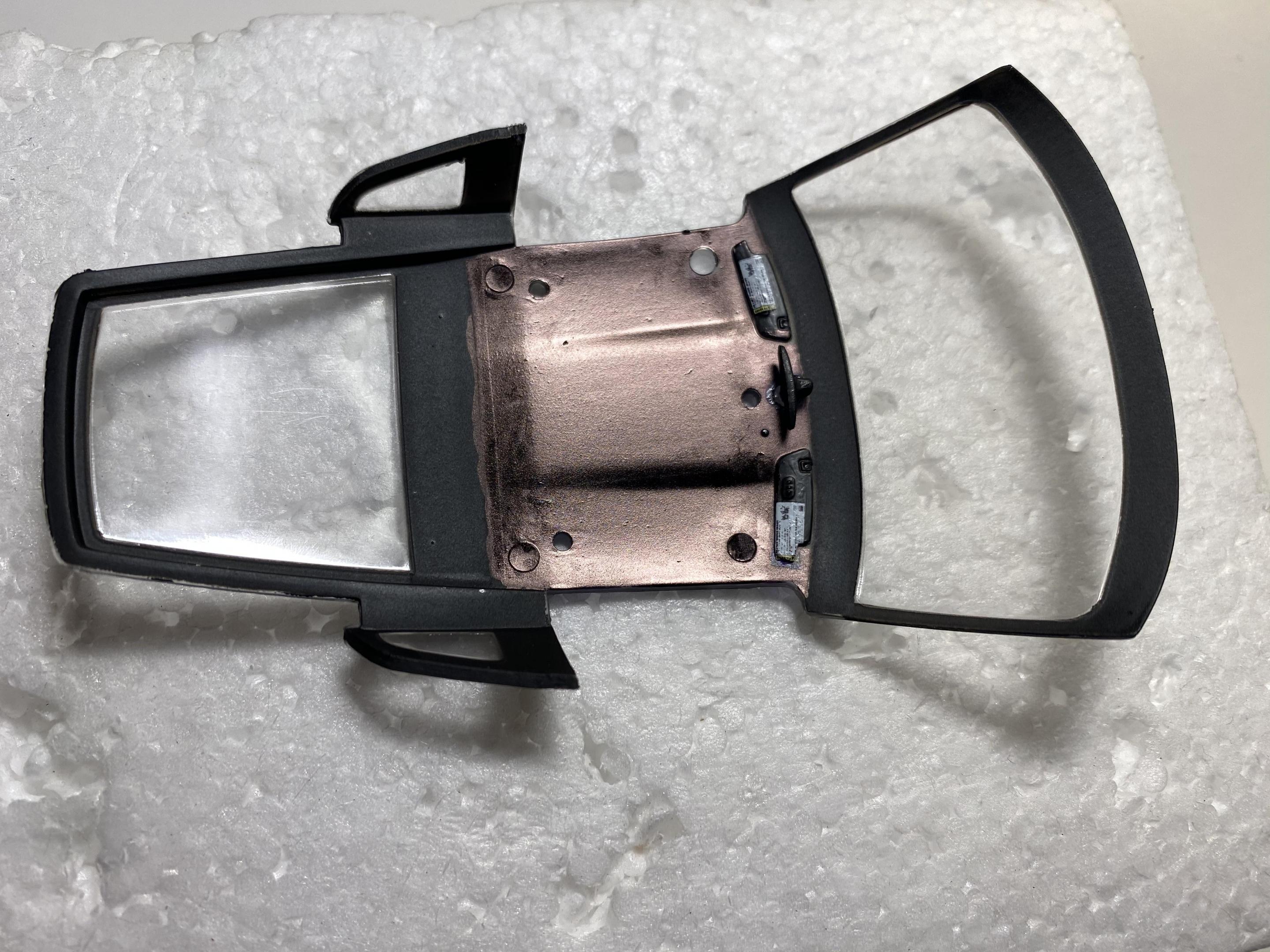

Rear view mirror from the Maisto diecast attached to the front windshield(the R kit does not come w one); decals placed on visors and also have a decal for the rear view mirror put it cannot be seen -- the visor decals probably won't be seen either --oh well...

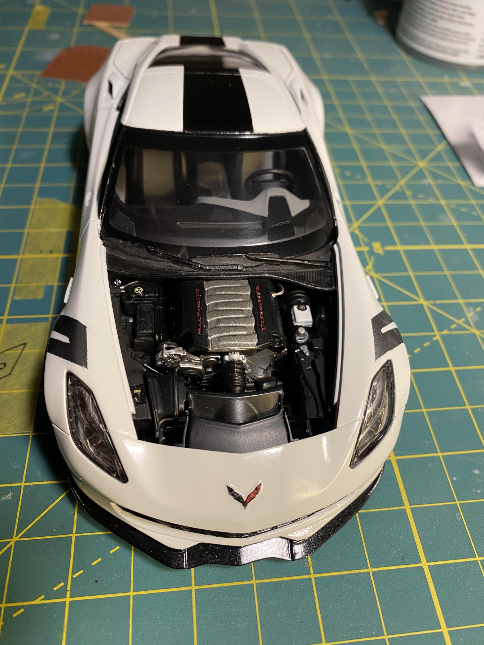

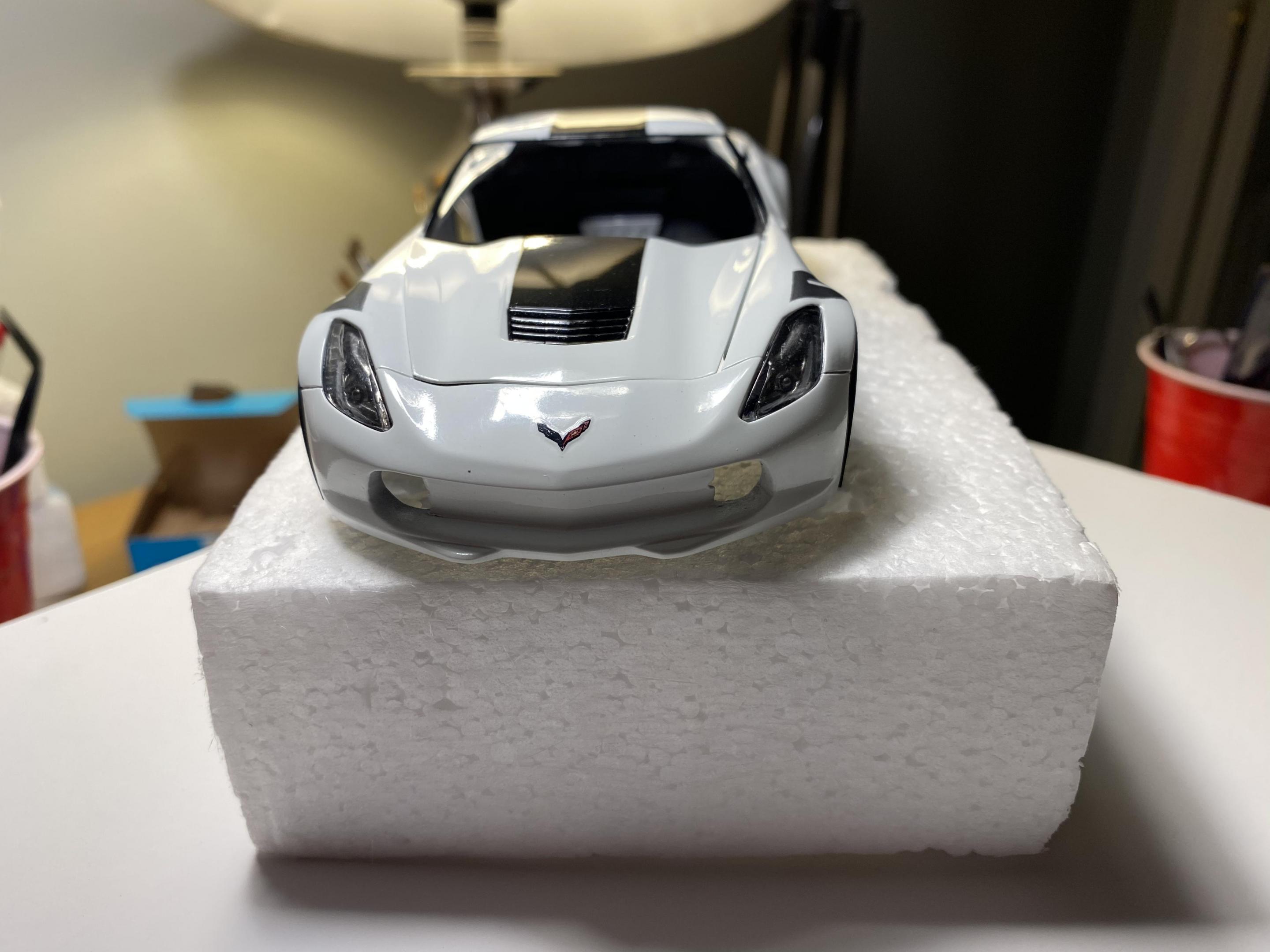

Front view of the C7 -- still need to put the side cove trim pieces on, install the front and rear windows and the front grill. Getting closer --

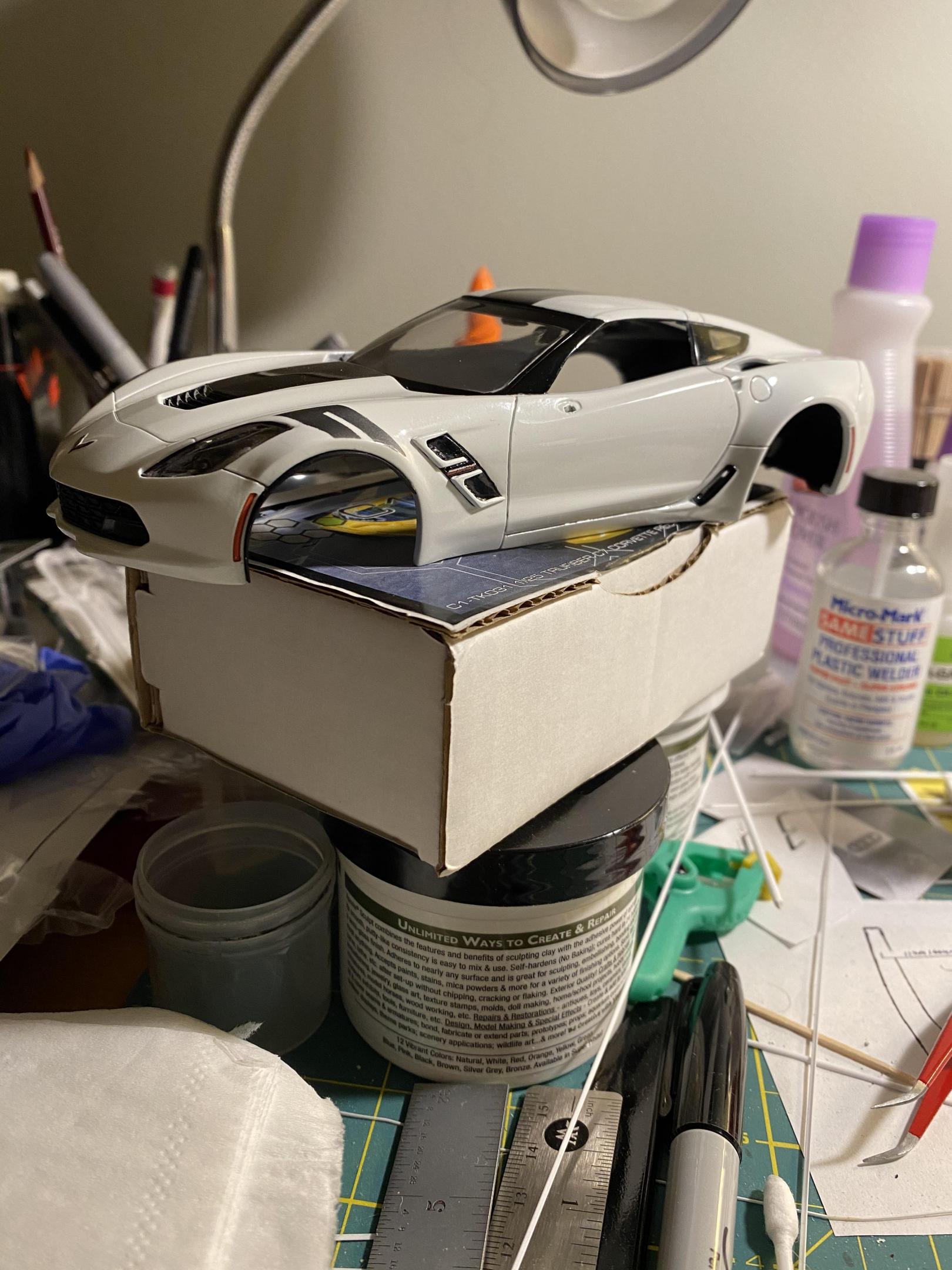

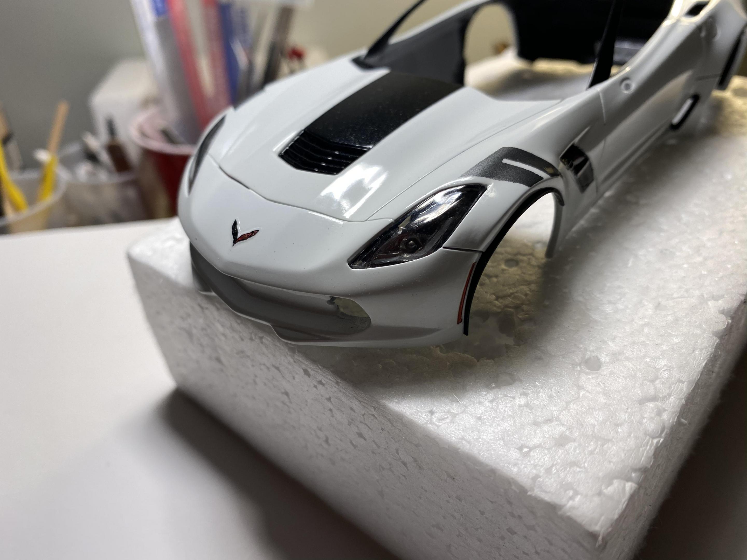

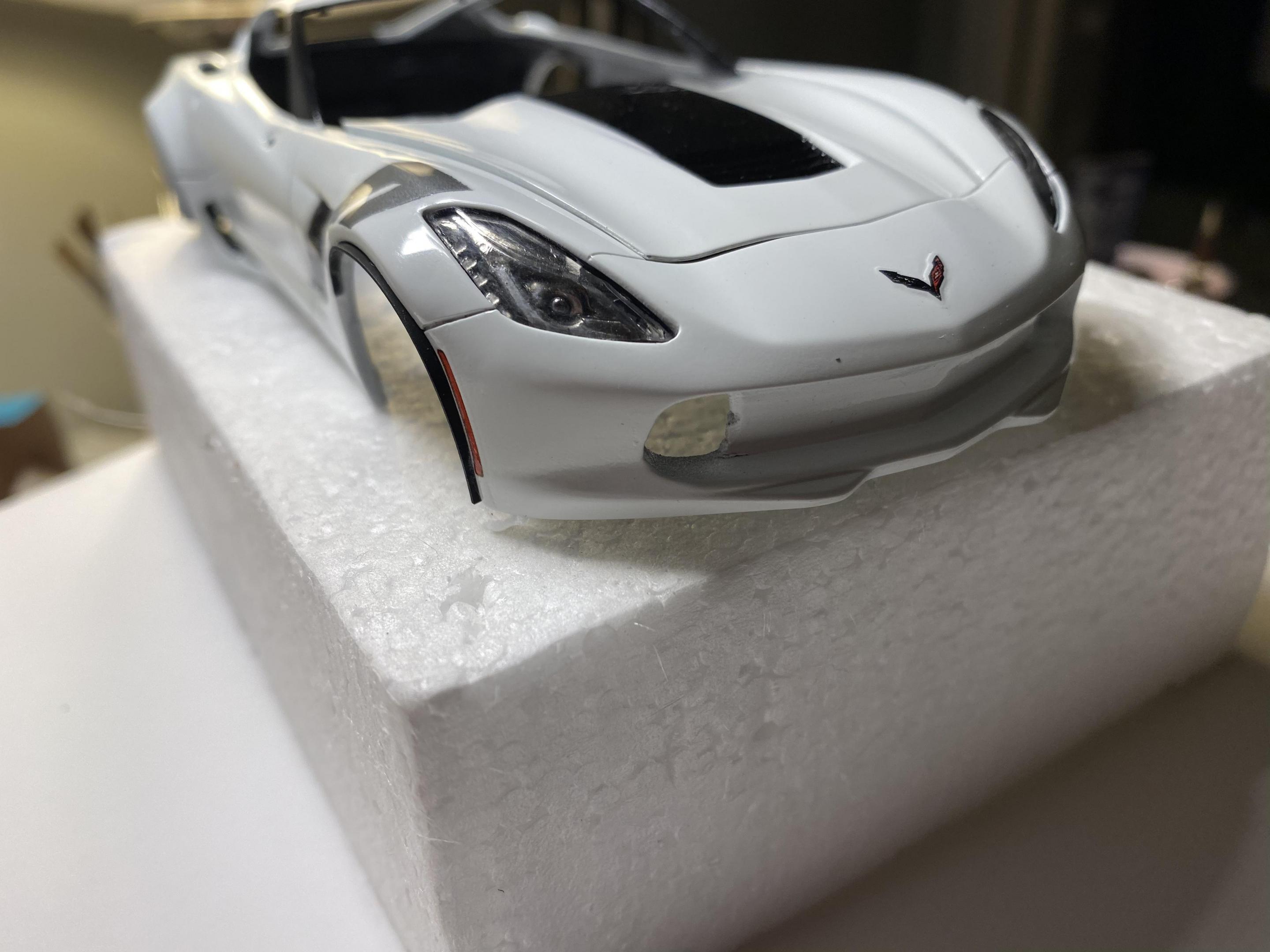

A little more progress on the C7 GS -- body is cleared and polished, taillights and front headlights attached as well as the front wheel arch 'stone guards'. The headlight bezels were painted Tamiya 'Smoke' with flat aluminum accents for the LED strip, headlight covers were accented with a Sharpie for the 'gaskets'. The 'stone guards' were ,4x2mm strip, painted flat black and tapered to the leading edge of the wheel arch. Some pictures below:

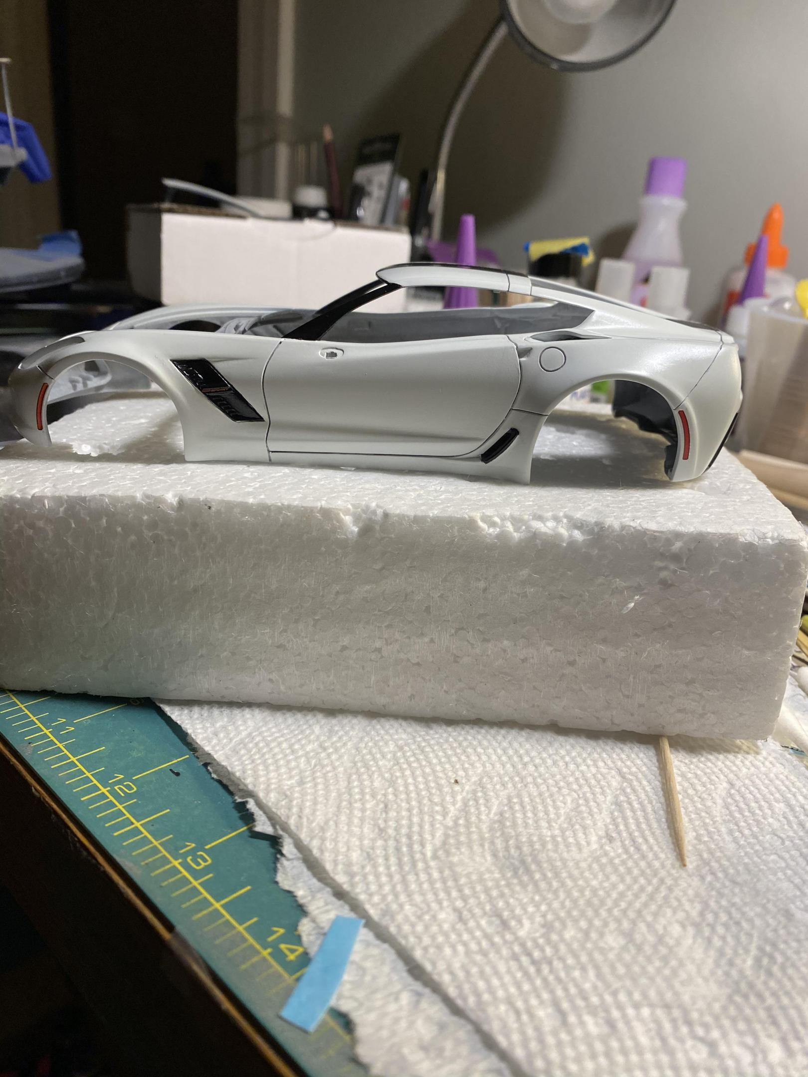

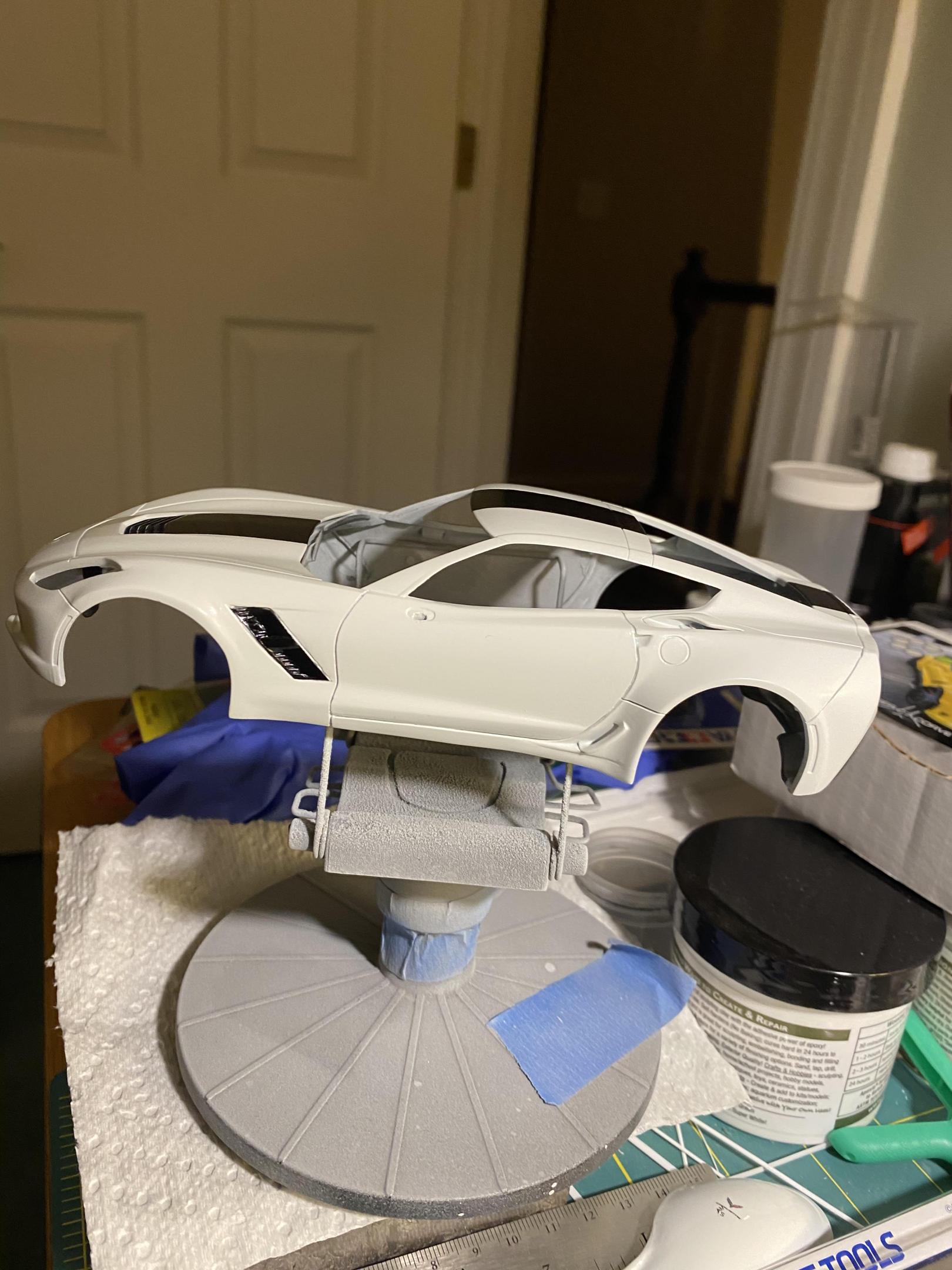

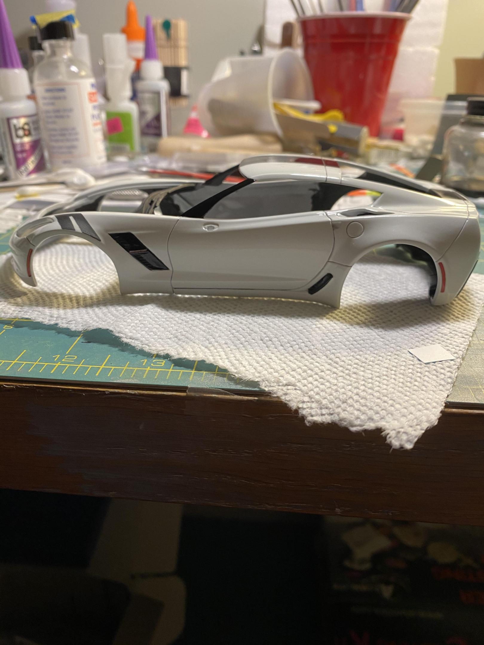

Side view of GS, still need to put side cove trim and front wheel arch 'stone guard' on. Also, I'm going to clear the fender hash stipes, so they will hold up to some polishing. Used the kit decals for the side marker lights -- getting closer to the finish line -- thanx for looking, appreciate any comments. Al

Front fender hash marks, painted acrylic Gunmetal, after car was cleared with AT Clear and rubbed out. flat and semi-gloss black was applied to underbody and to windshield wipers.

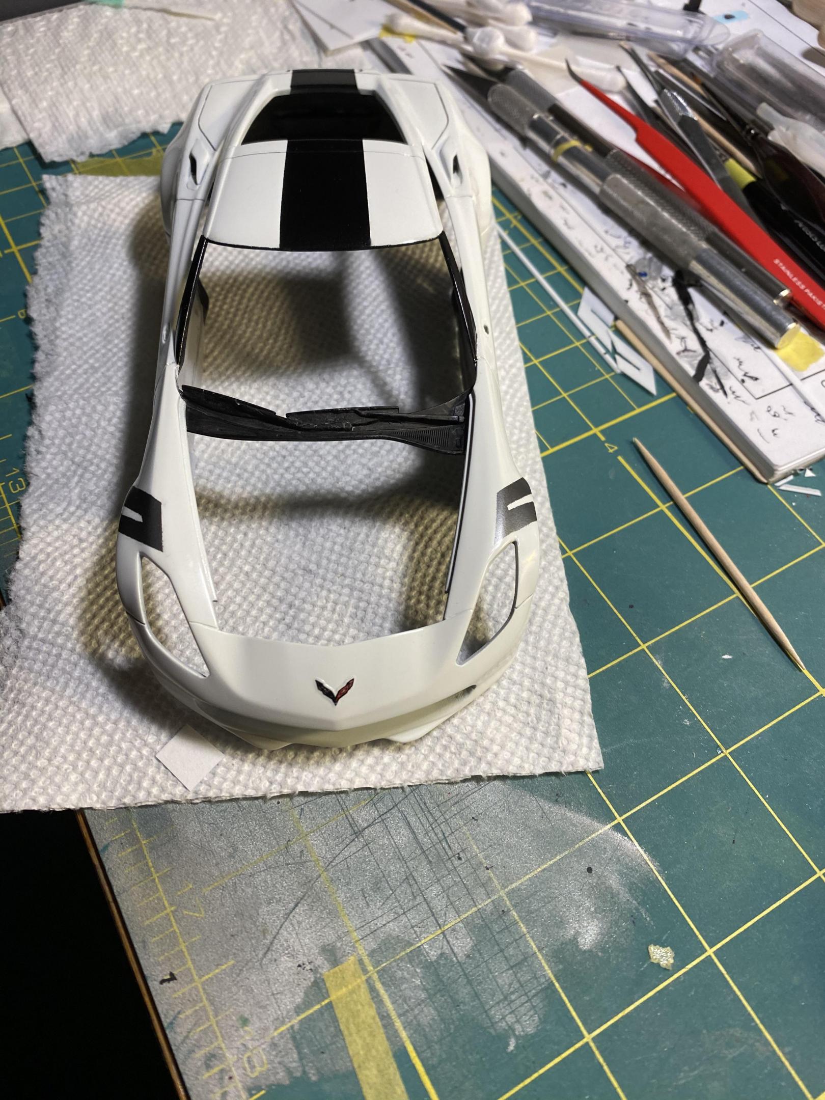

A little more progress on the C7 GS, detail painting completed, added panel line detail with the 'The Detailer' grey and completed the decals. Next is clear coat, and I'm thinking of painting the fender hash stripes after clear coat with Valejo Acrylic Gunmetal --the decals I have don't look quit correct --coming down the home stretch.... Thx for looking

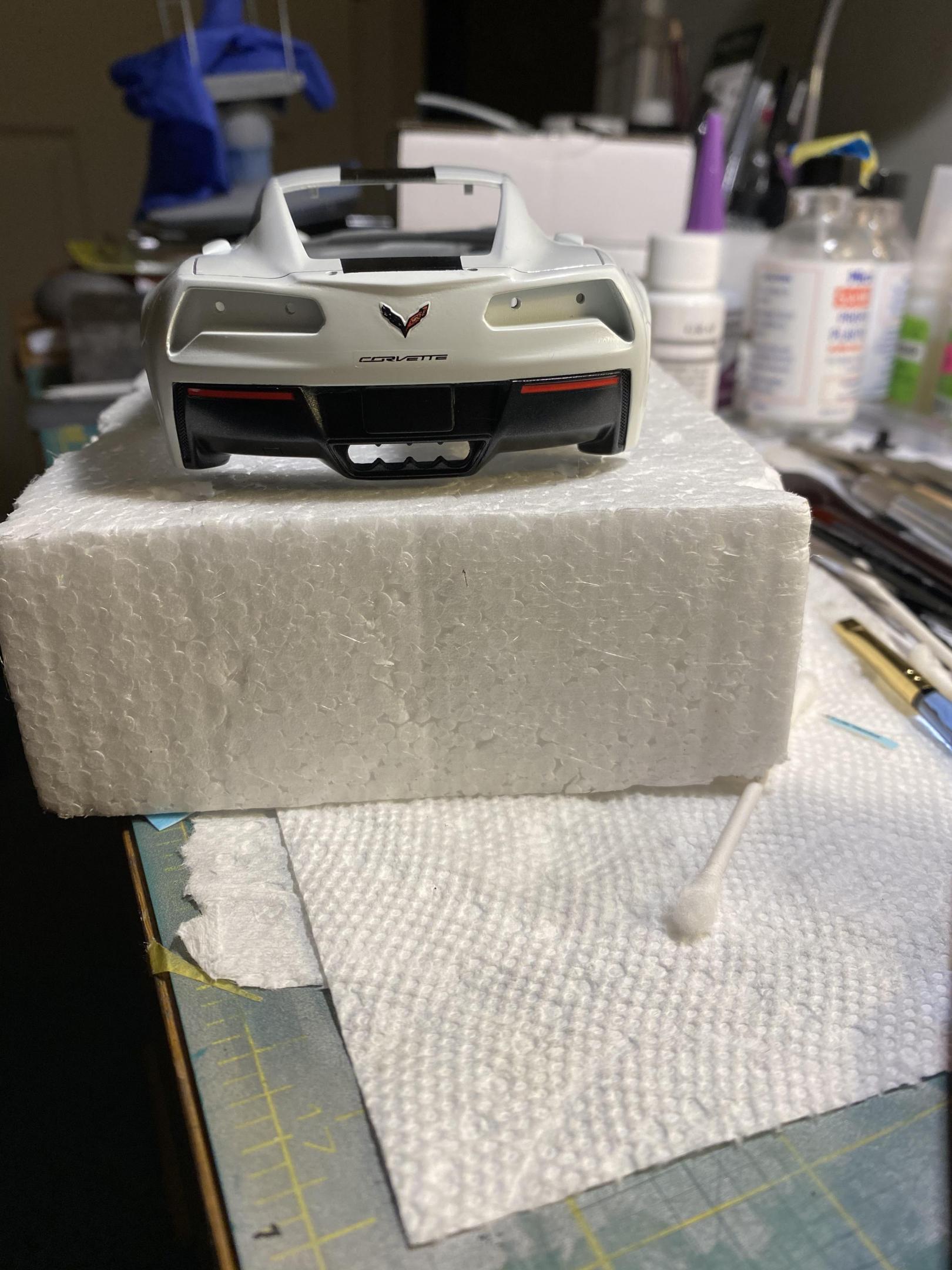

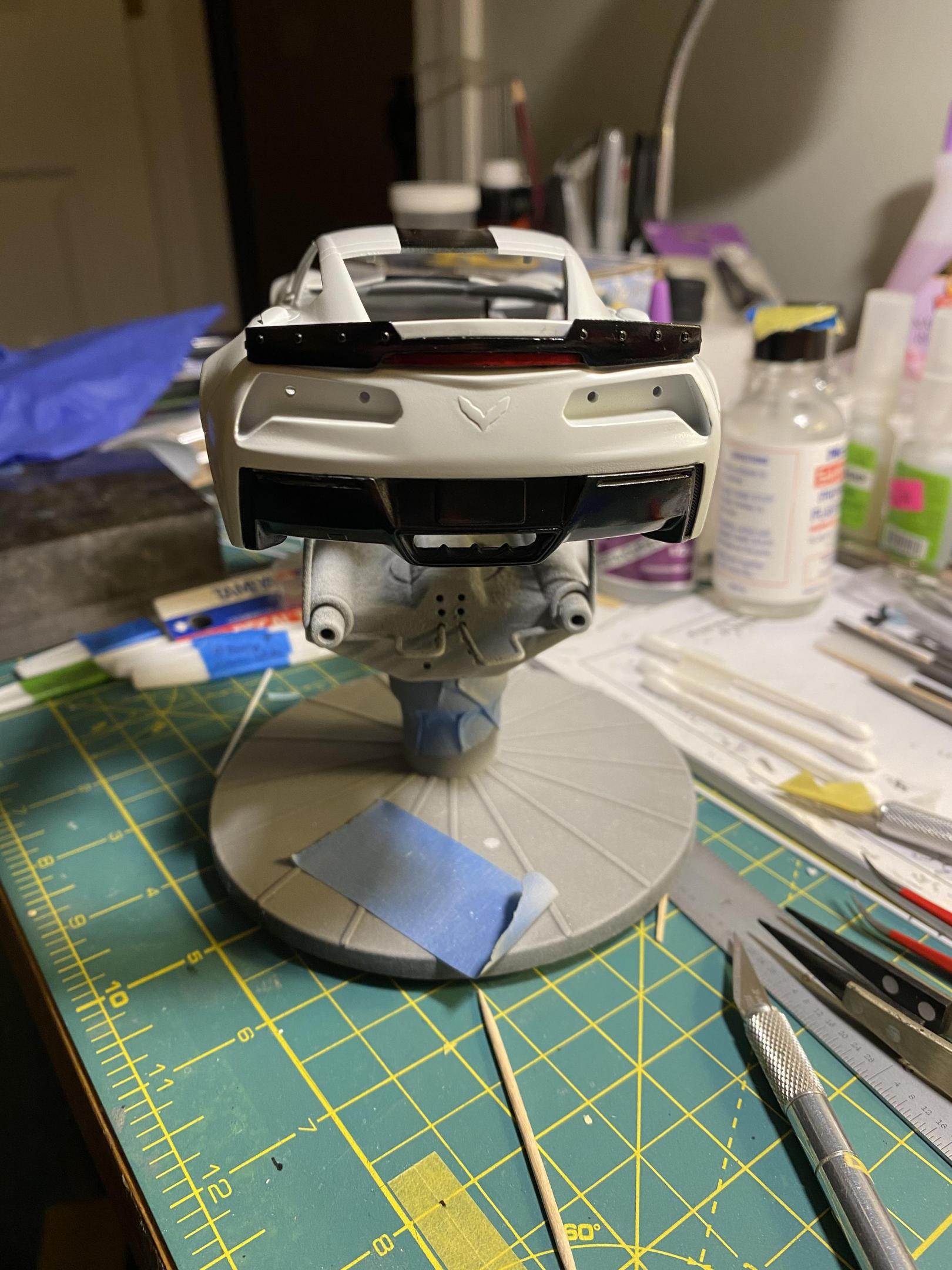

Also painted the rear valence and the side coves, AT Carbon Flash, getting closer to the end --still need to paint the 'A' pillars, the rear brake scoop trim, then add the decals and clear coat. It's starting to come alive!! thanx for following!

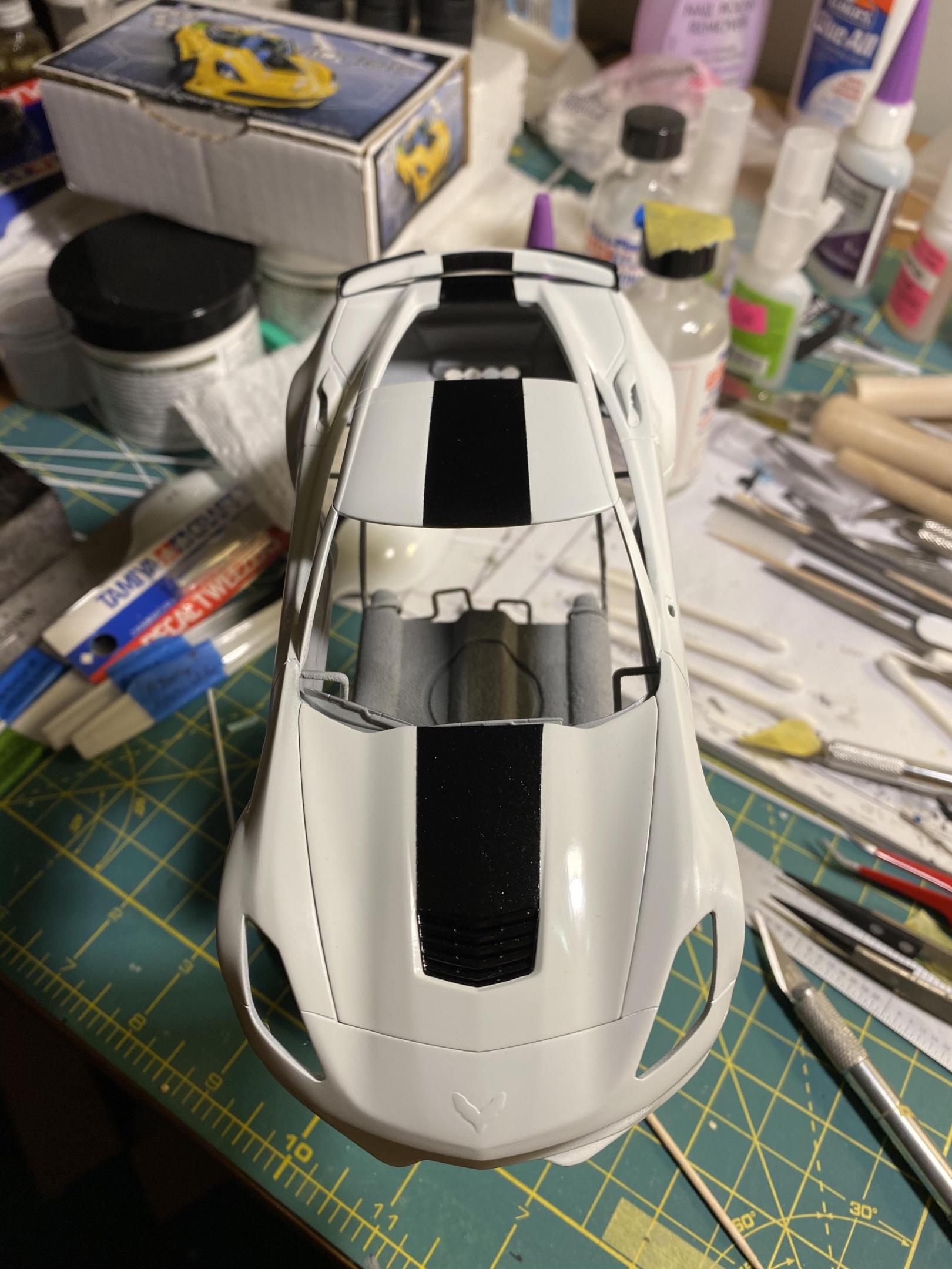

A little more progress on the C7 Grand Sport, measured and centered the hood and rear deck carbon Flash stripe -- added the hood and rear spoiler which i had painted separately to ensure that the stripes aligned, looks pretty close,
