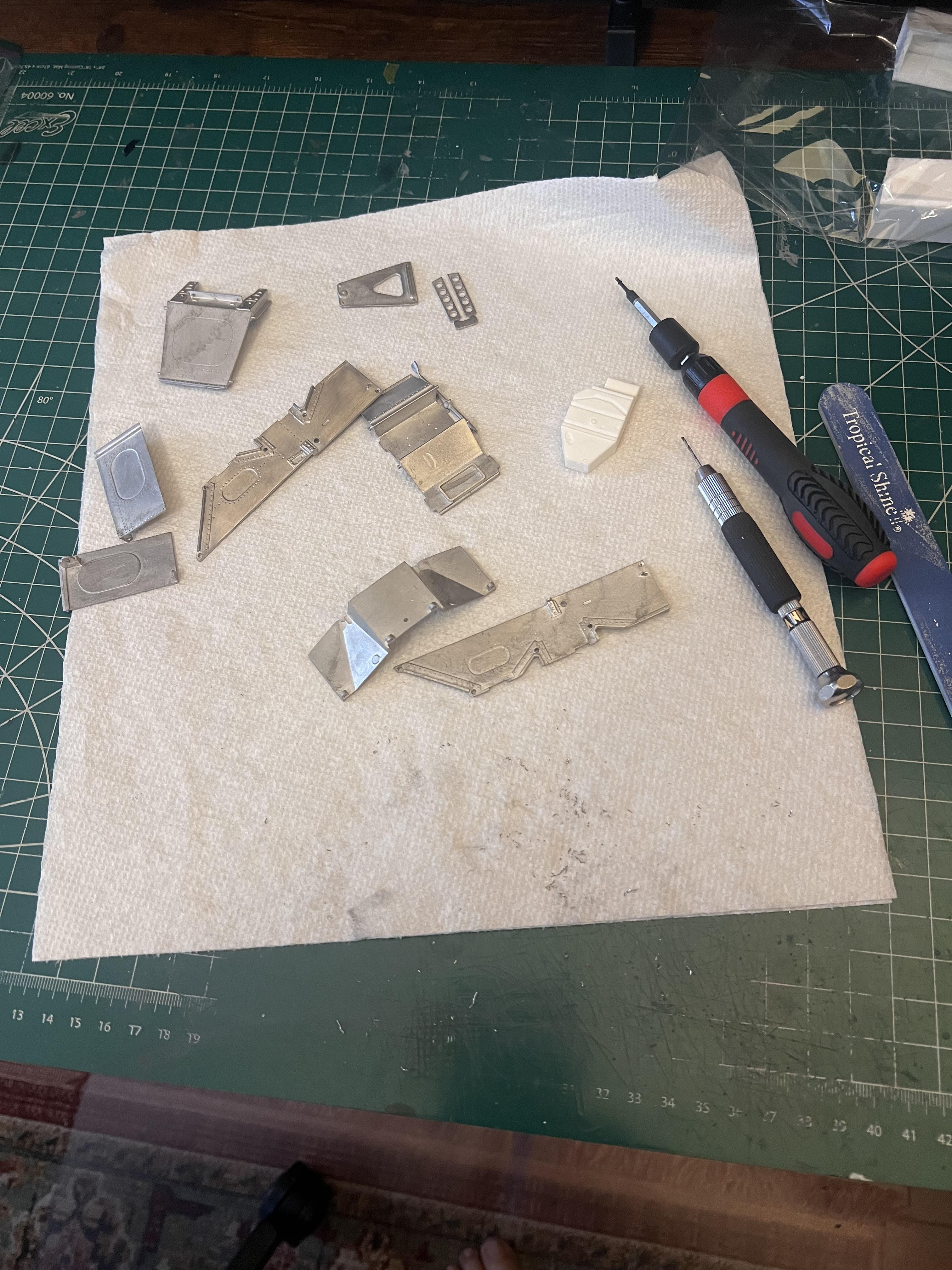

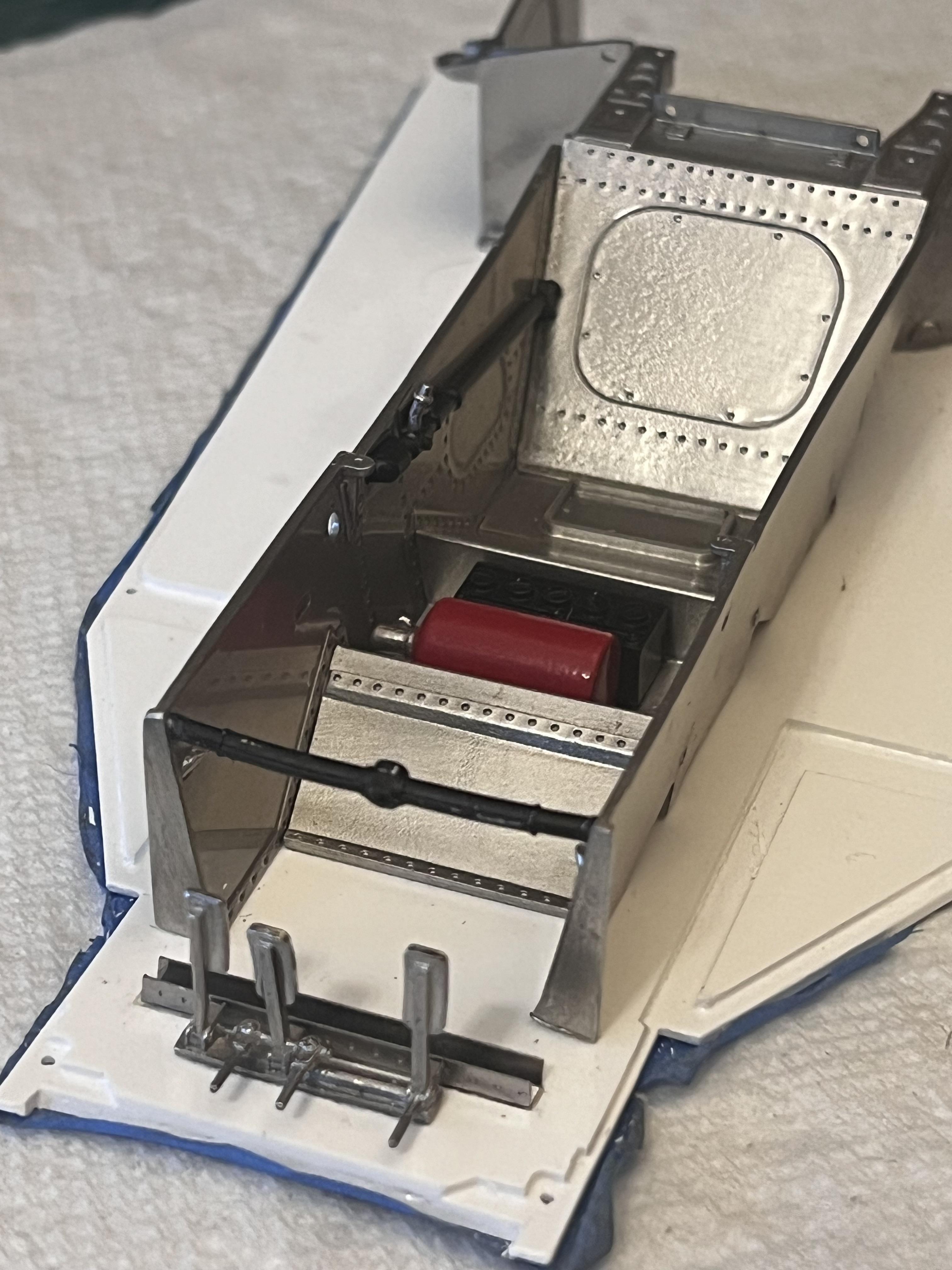

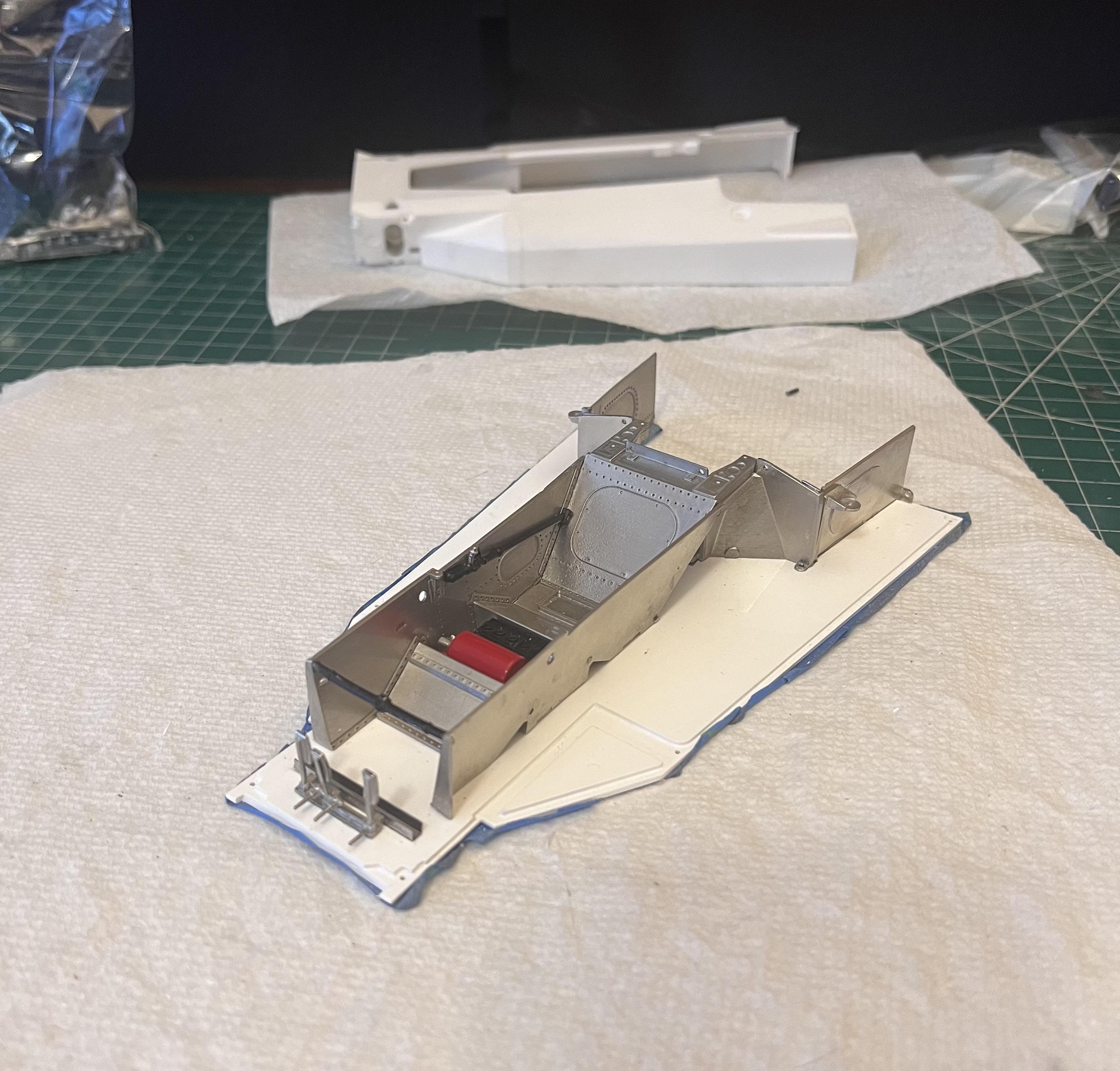

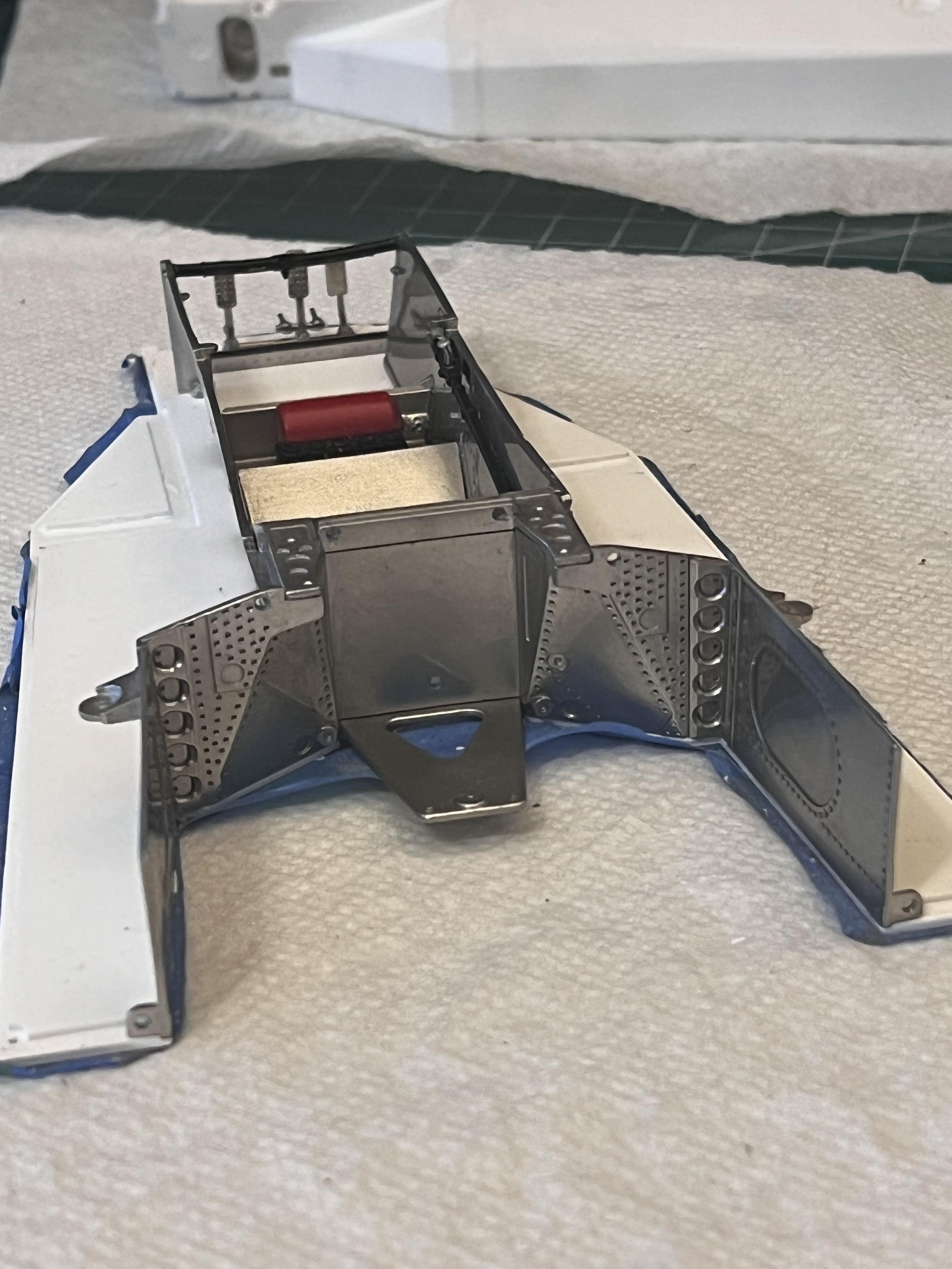

As per usual, this kit needs a lot of dry fitting to make sure everything lines up. Or I will be wondering why things don’t line up correctly later on down the line. I must have spent 5 hours yesterday just to double check everything before I start painting the monocoque cover, I’m almost there. I have some bodywork to do then hopefully I can get some paint on it. I do have a good portion of the cockpit polished and installed, so this is a positive sign. I have to remember, it’s not a sprint, it’s a marathon ?? thanks for looking…. -
Off onto another large scale project ? I will be working on the Model Factory Hiro 1/12 Brabham BT45 press release version. Hopefully you will join me in on this and enjoy what I hope will be a great project. I decided to start on the monocoque first, instead of the engine and gearbox. As usual lots of drilling and dry fitting. I probably have a few hours of polishing some white metal. thank you all as always. Chris

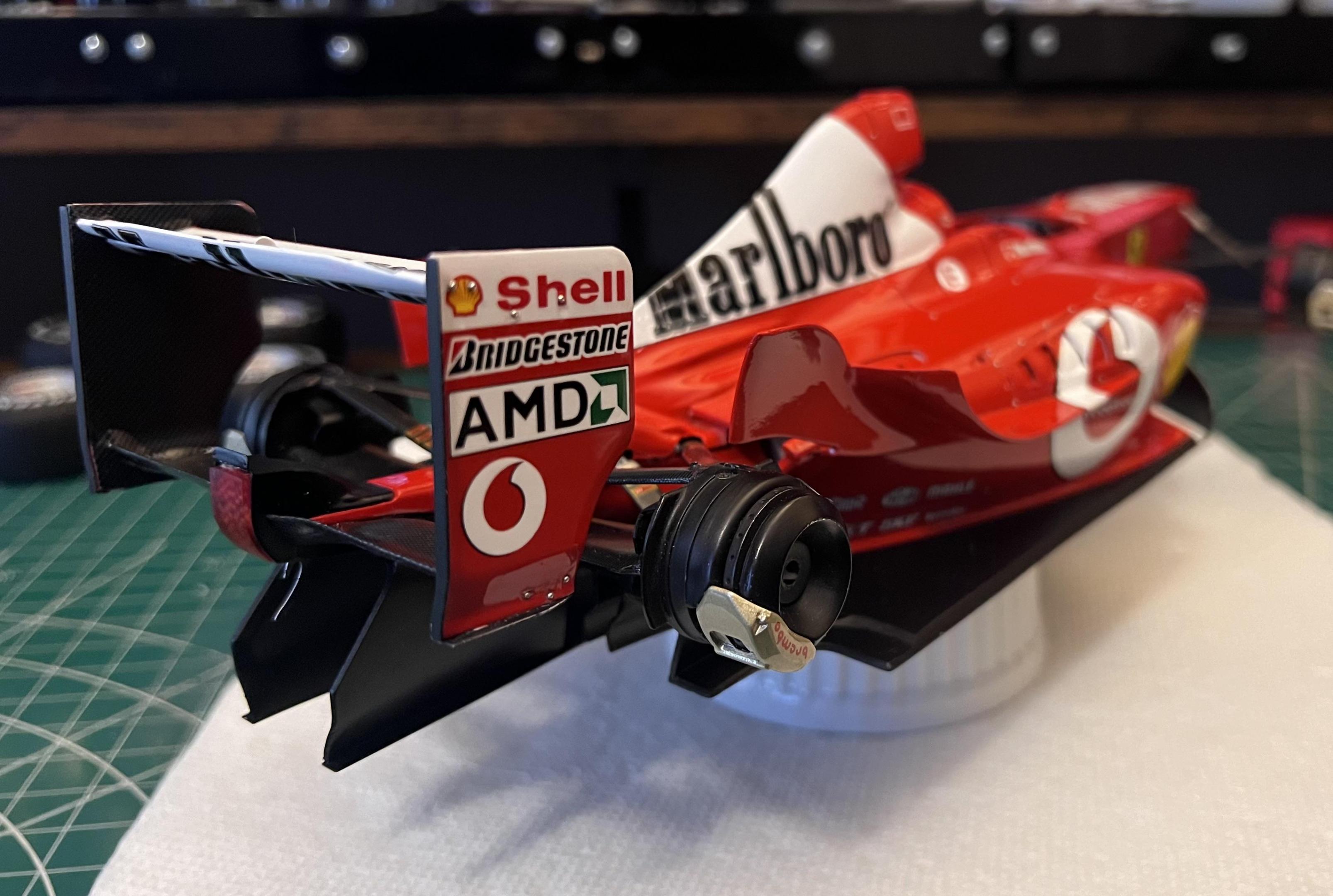

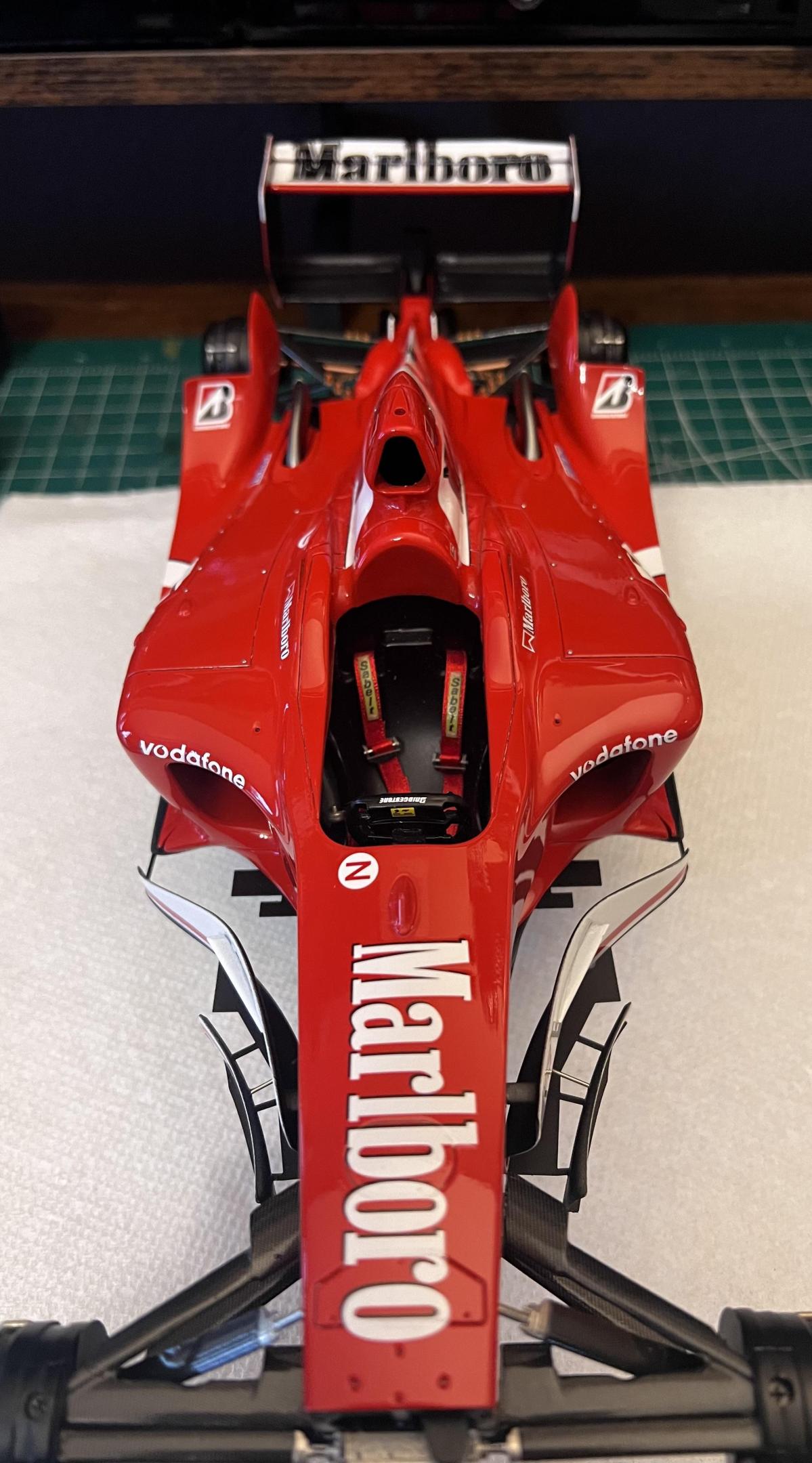

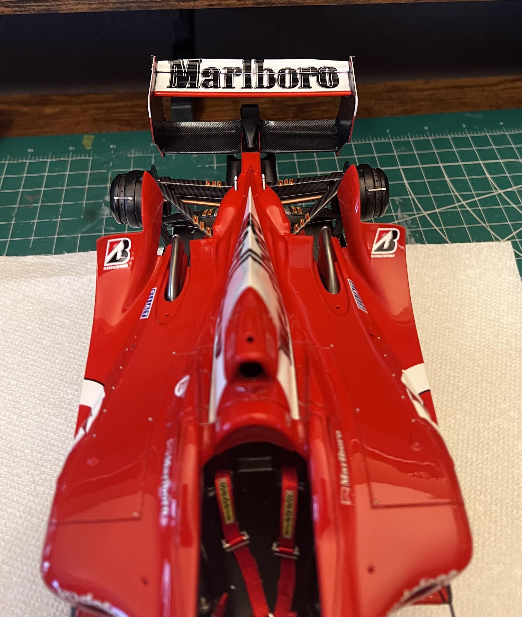

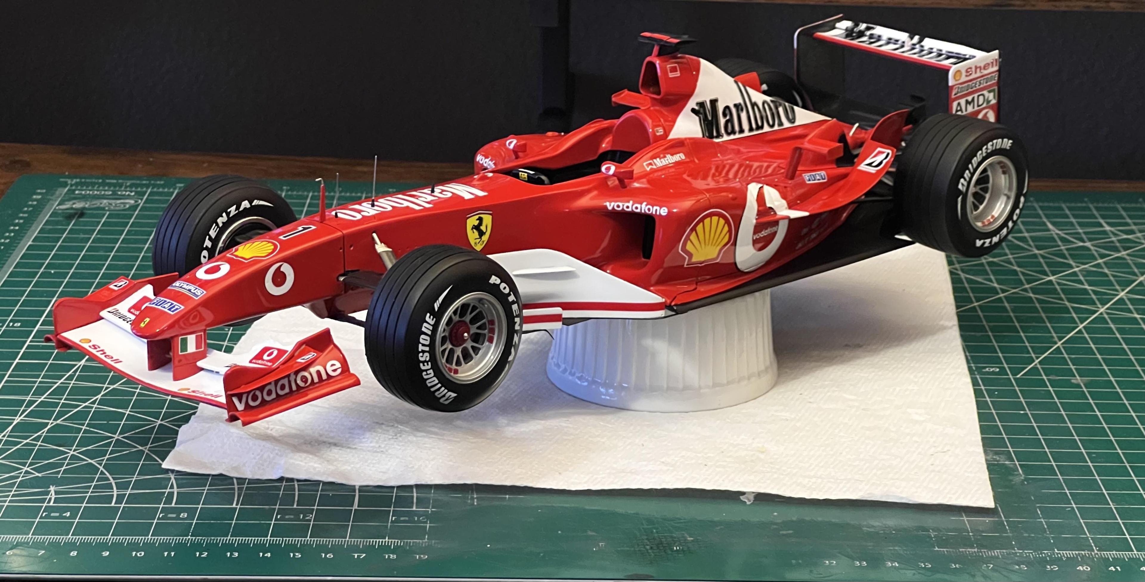

Pretty much done with this one! Hopefully you guys will like it. I also couldn’t resist taking a couple of pictures outside ? -

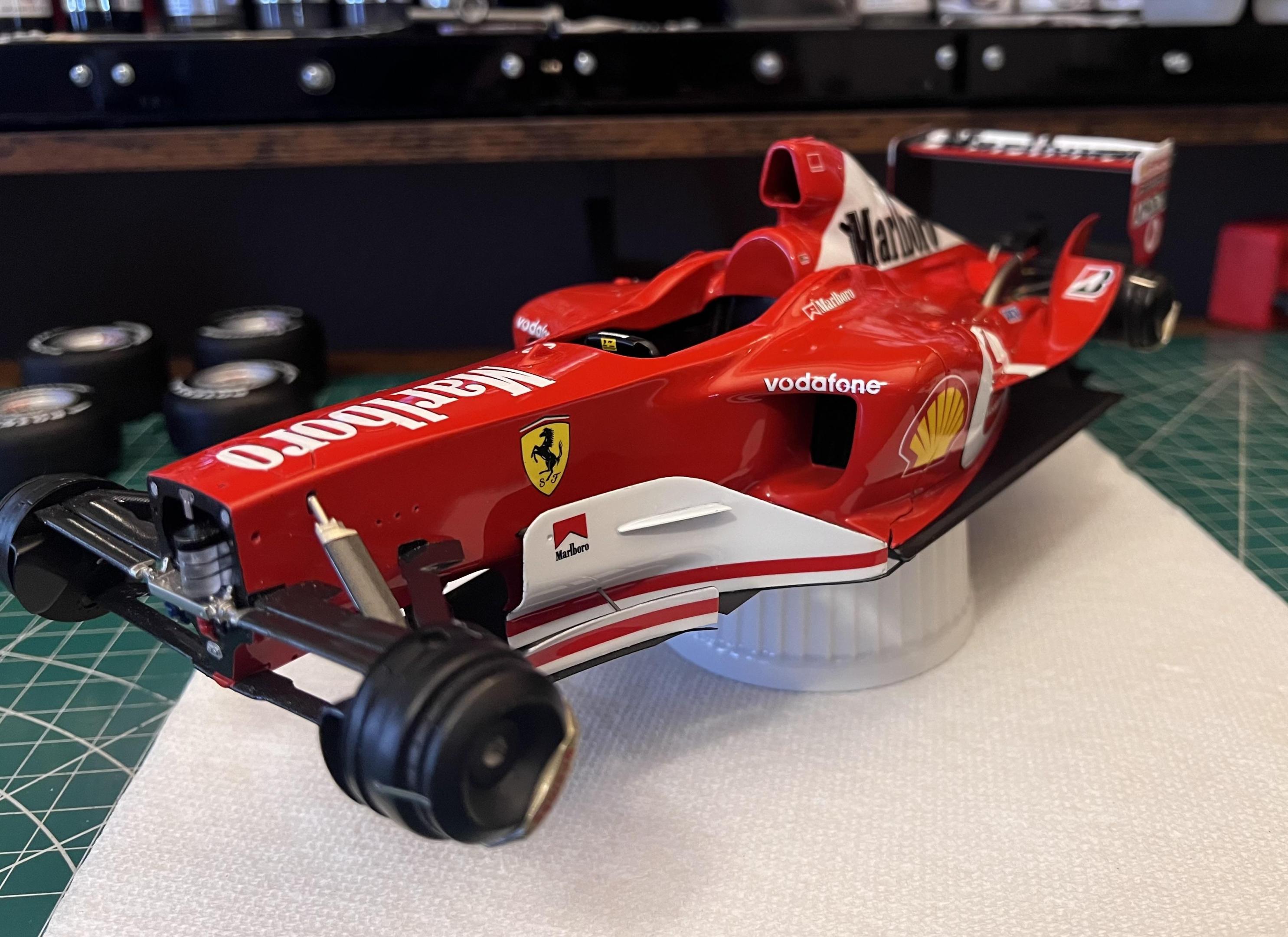

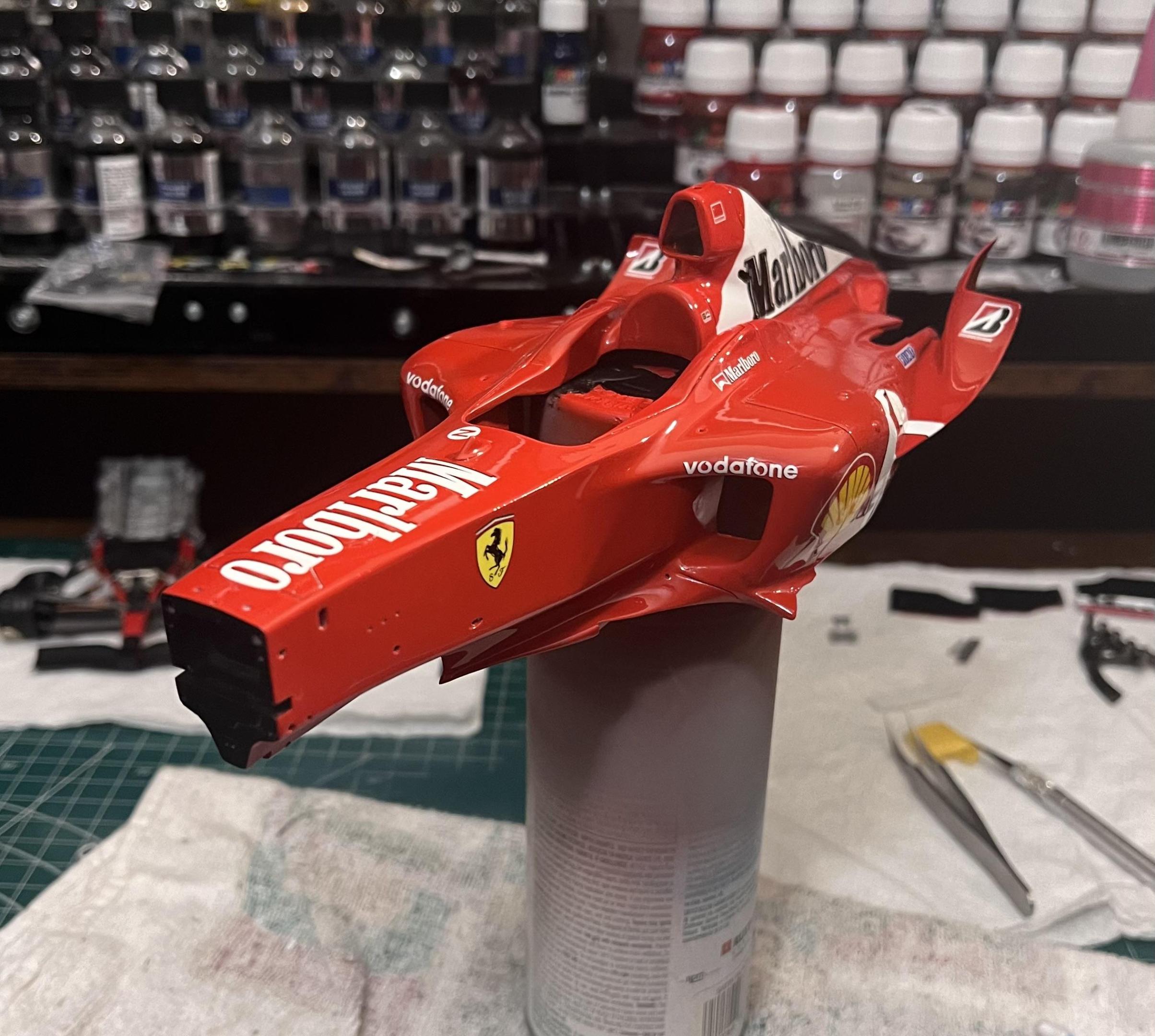

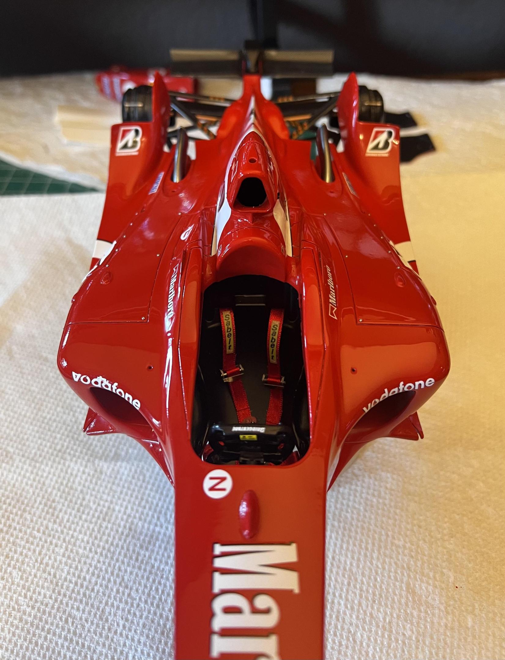

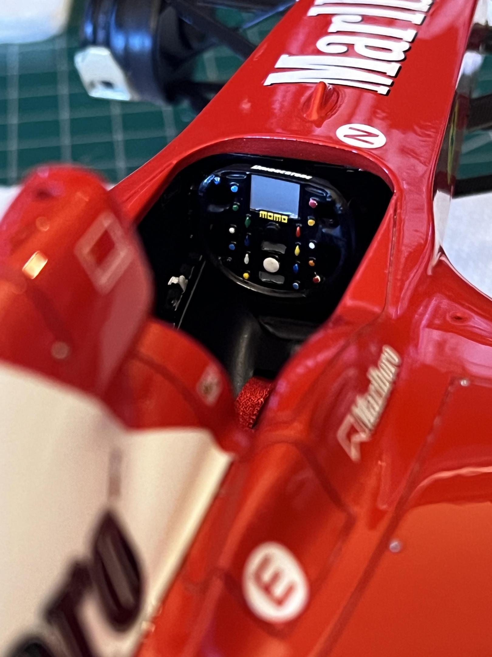

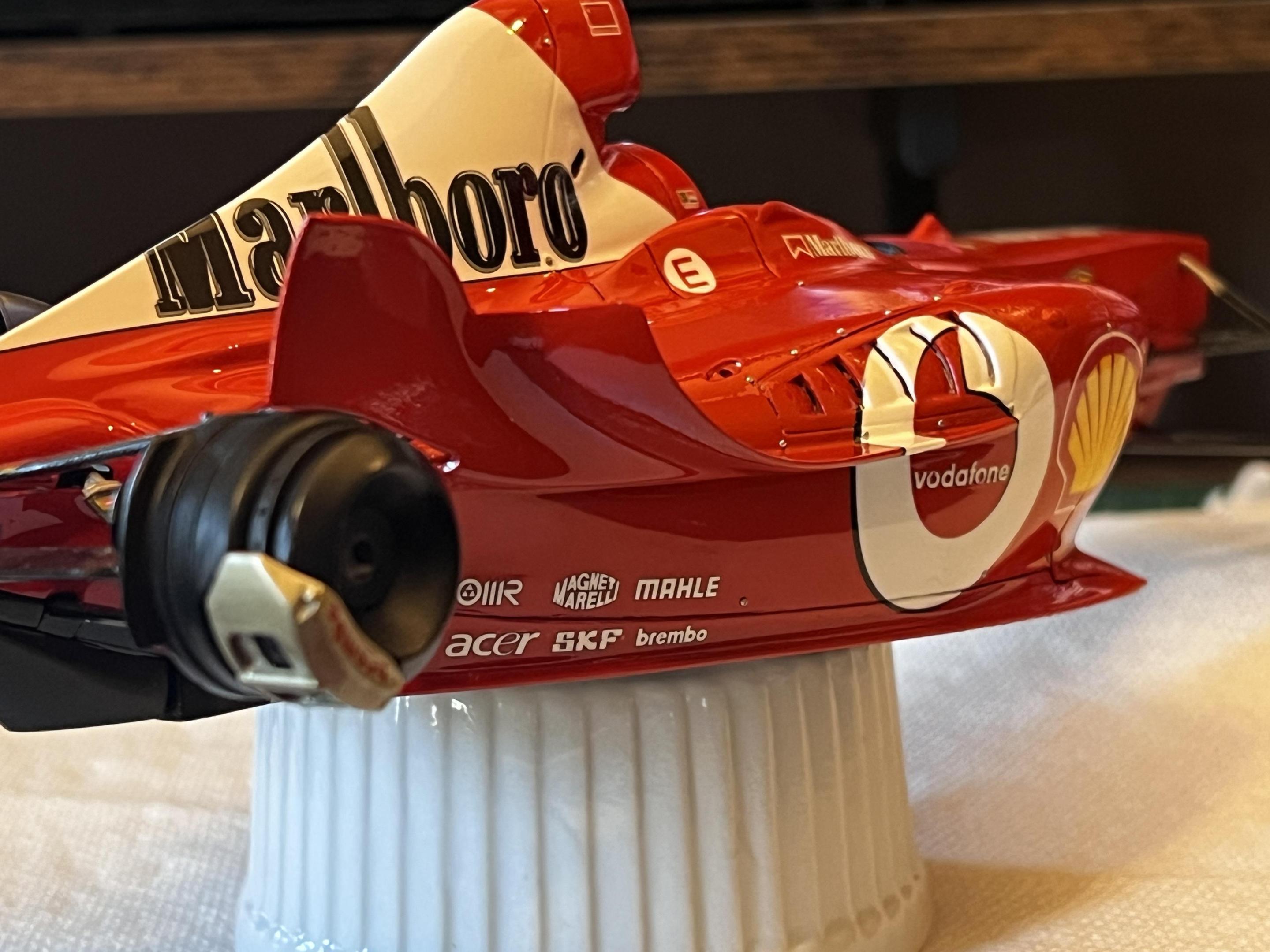

I could not sleep last night so I worked into early this morning. I was able in stall the seat and engine and also the lower body panels. During the week I worked on the cockpit surround and added carbon decals for a little more realistic look and also built the seat belts. Feeling pretty good about it at this point. -

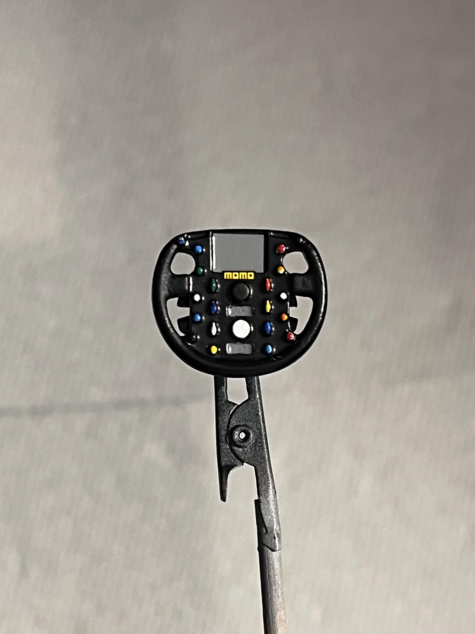

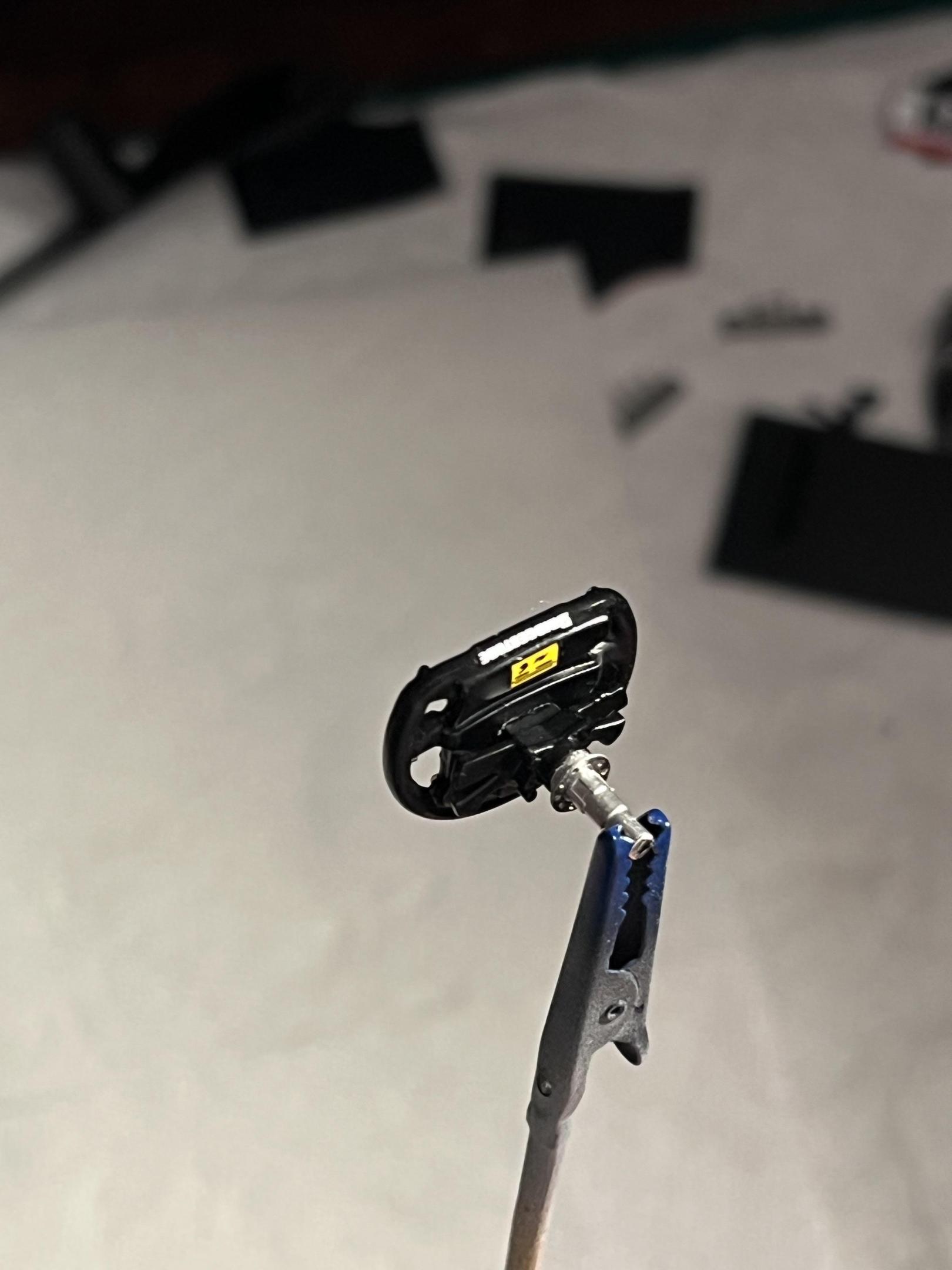

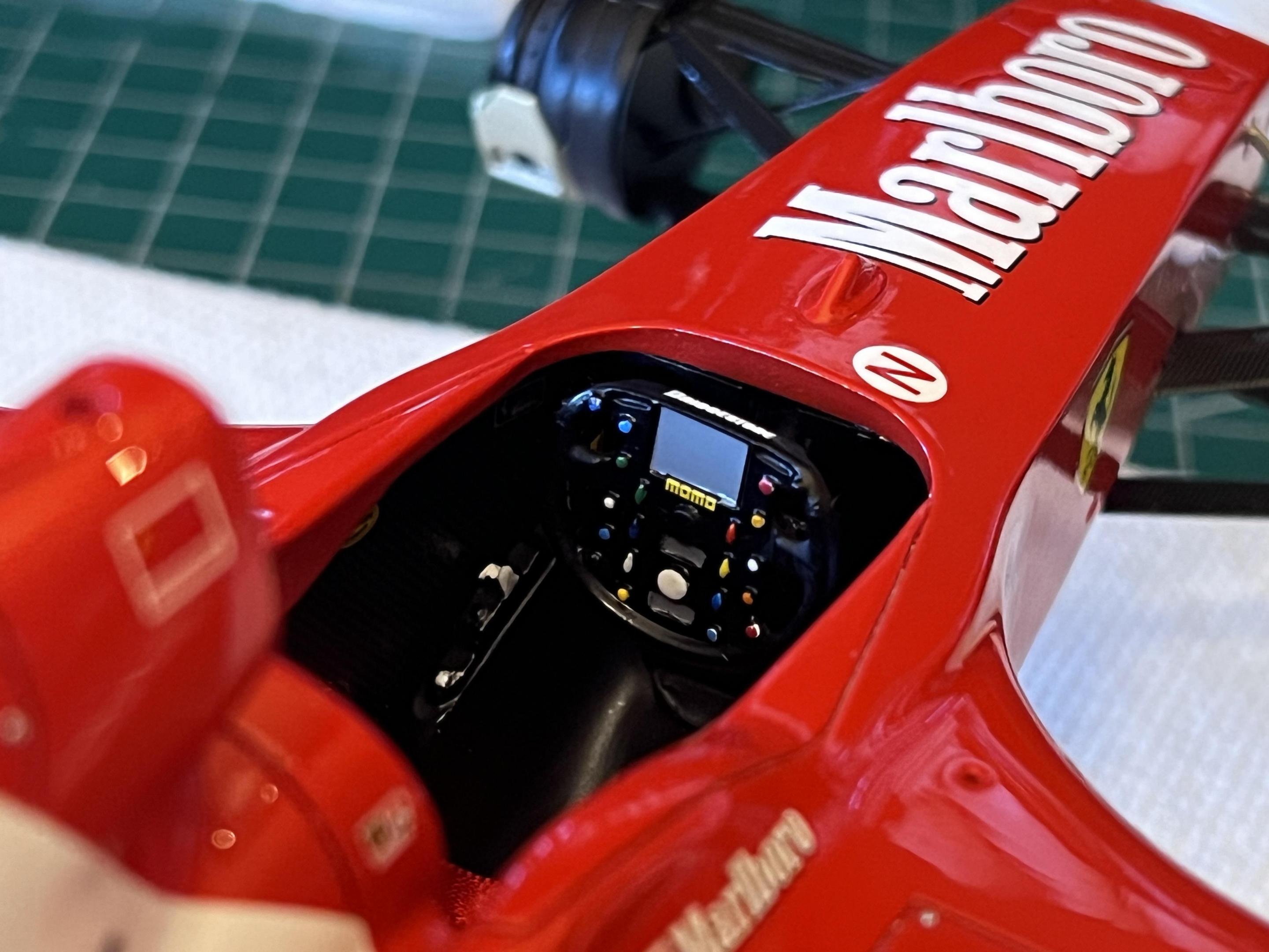

Steering wheel…I did the best I could, the wheel is white metal and all the knobs and buttons are molded in and not very crisp. -

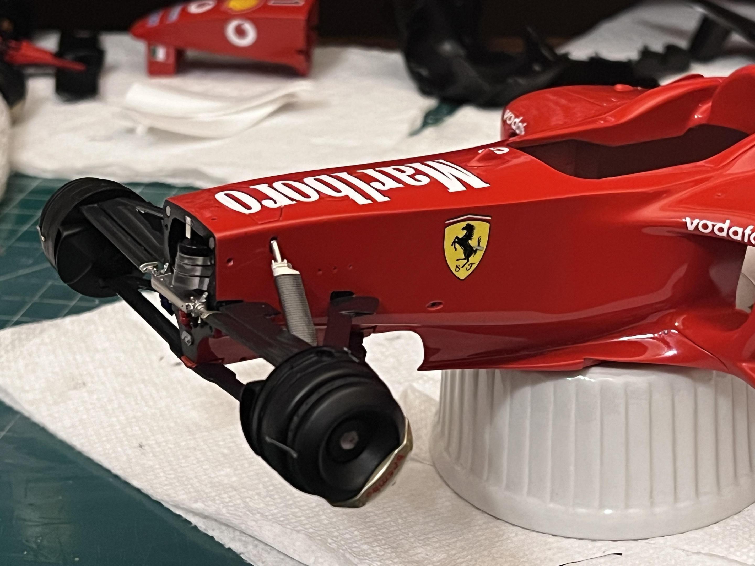

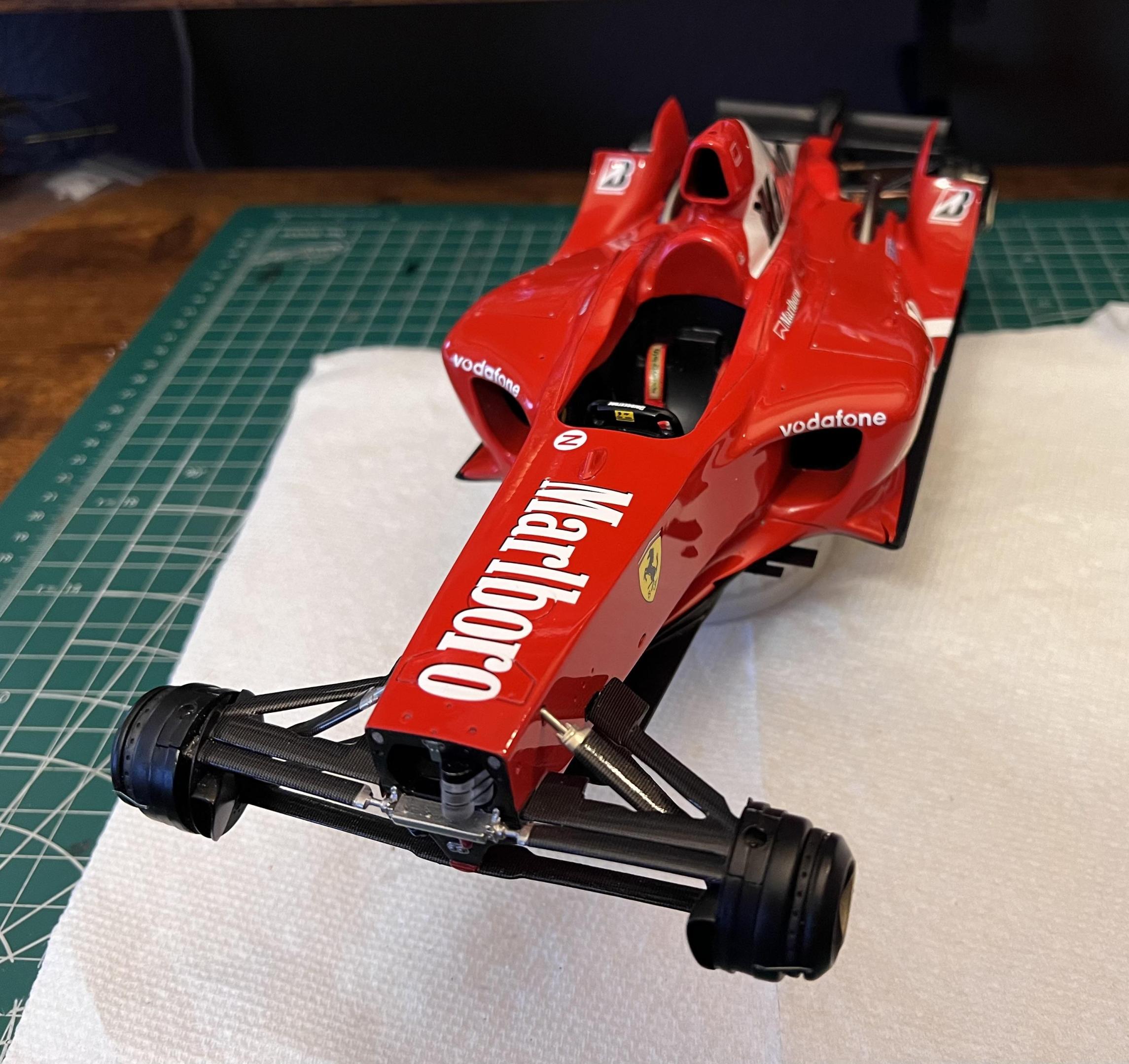

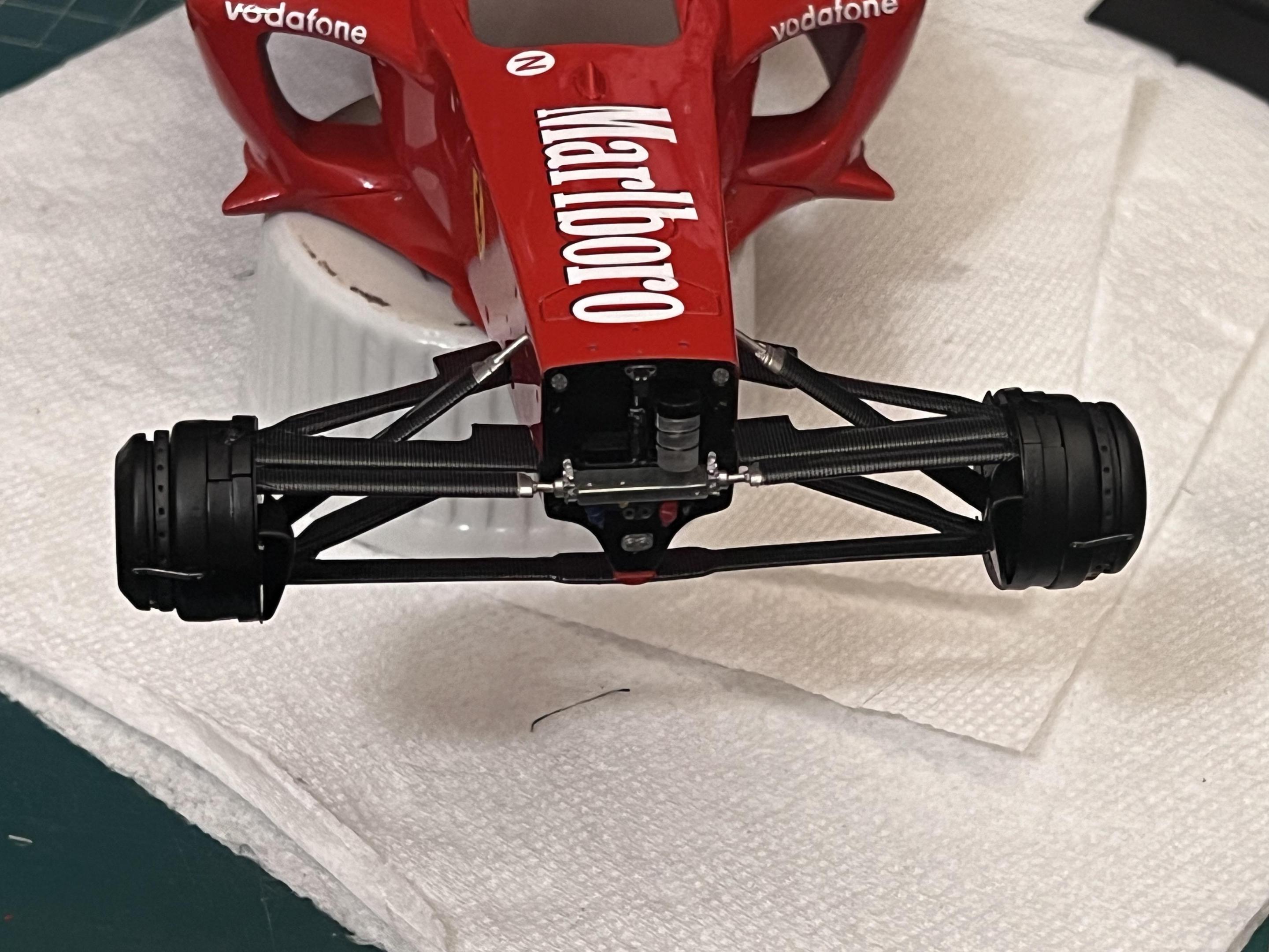

Front suspension and brakes installed, it took a lot of patience to get all the carbon decals installed and it seemed like it took forever to get everything painted just to be at this stage. Hope you like -

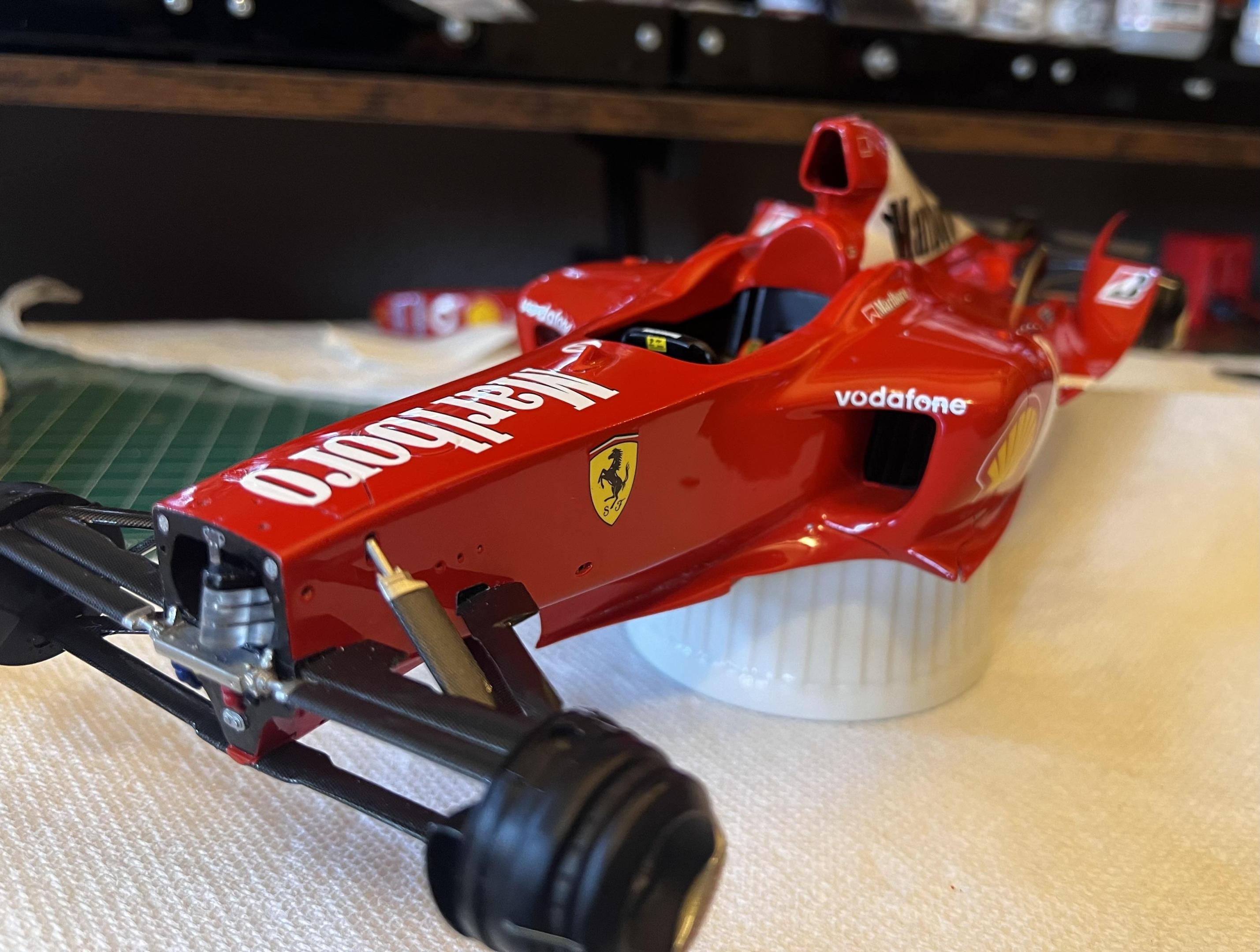

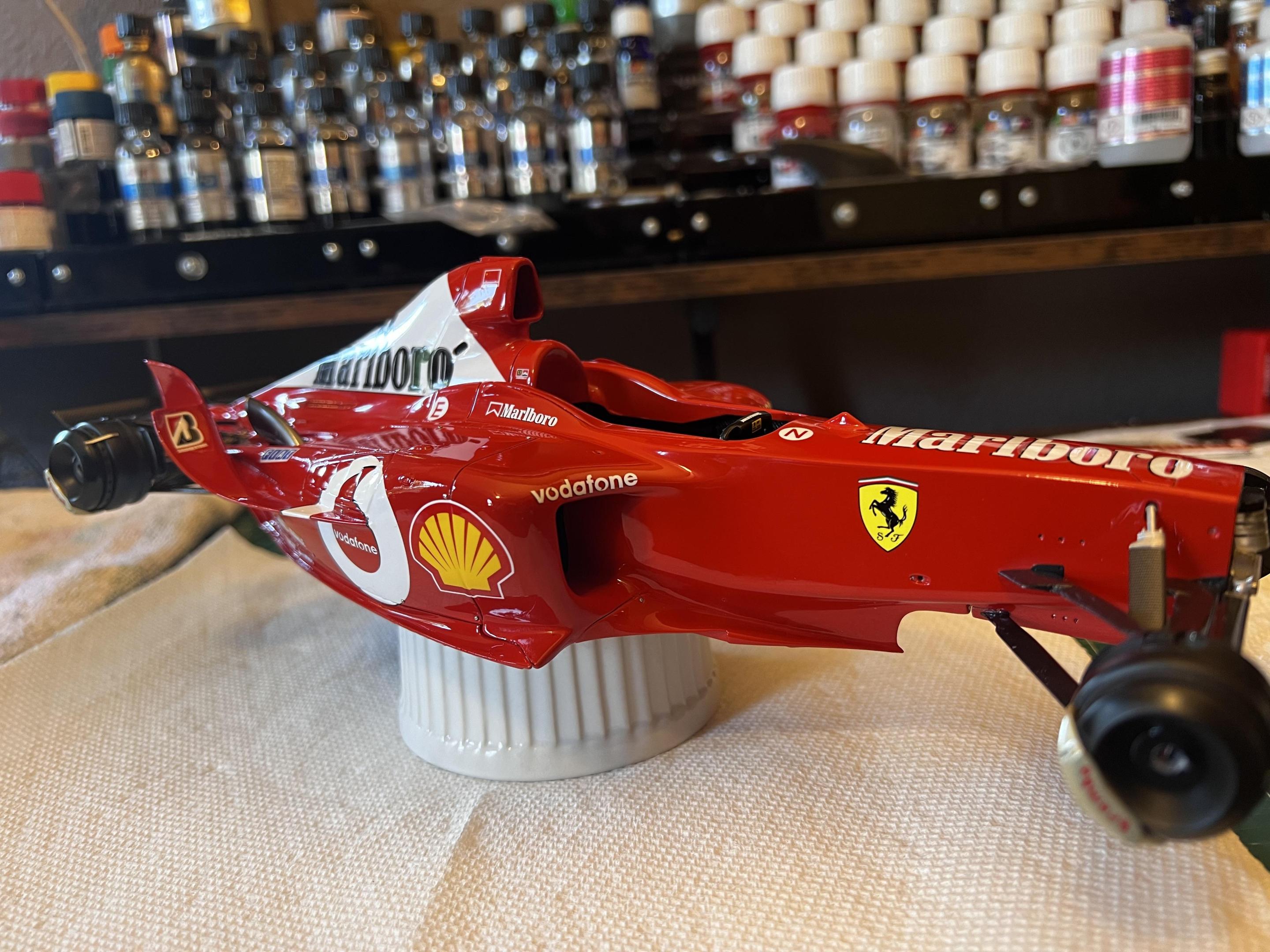

Chris Smith replied to Chris Smith's topic in WIP: Other Racing: Road Racing, Land Speed Racers

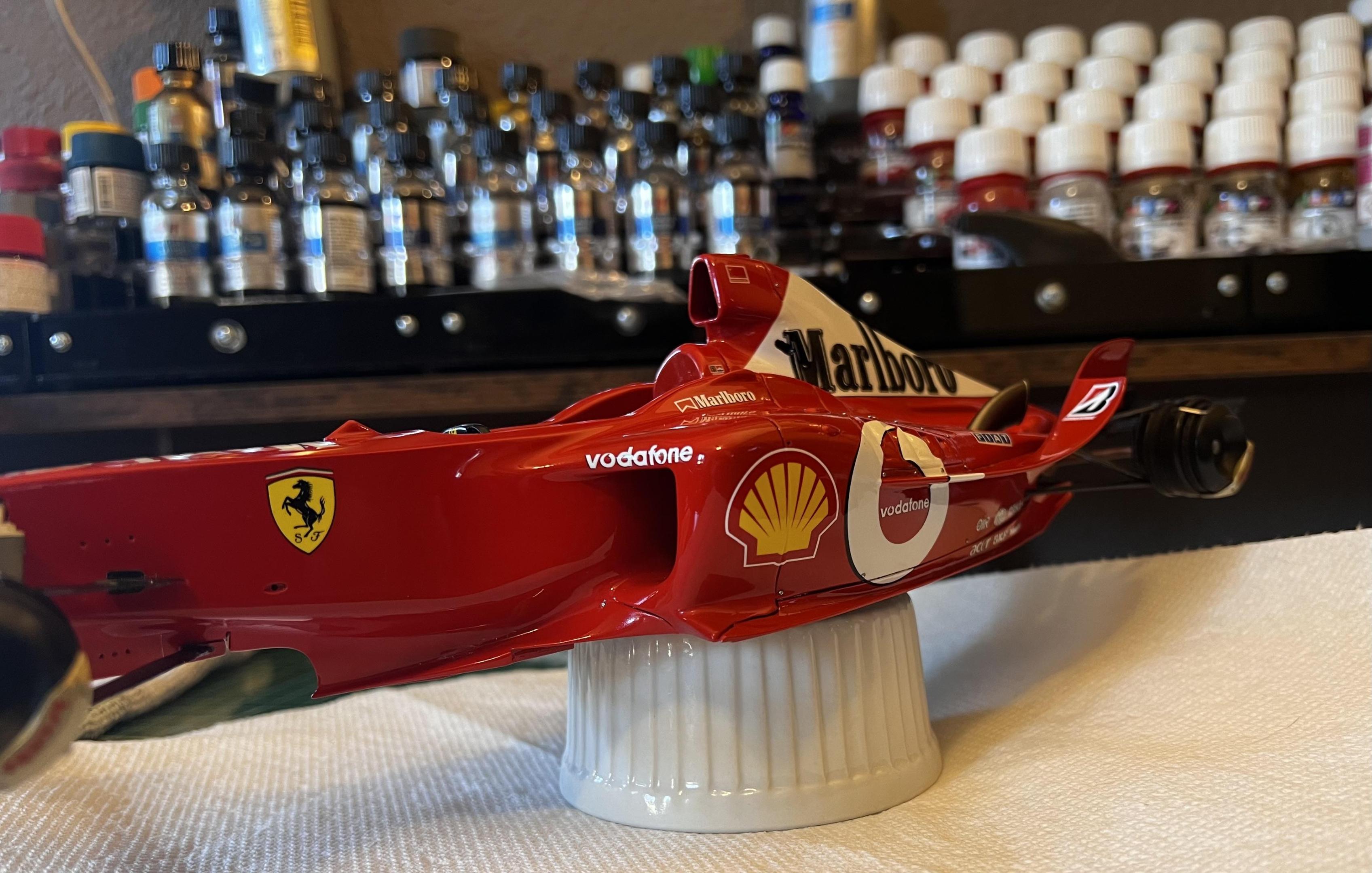

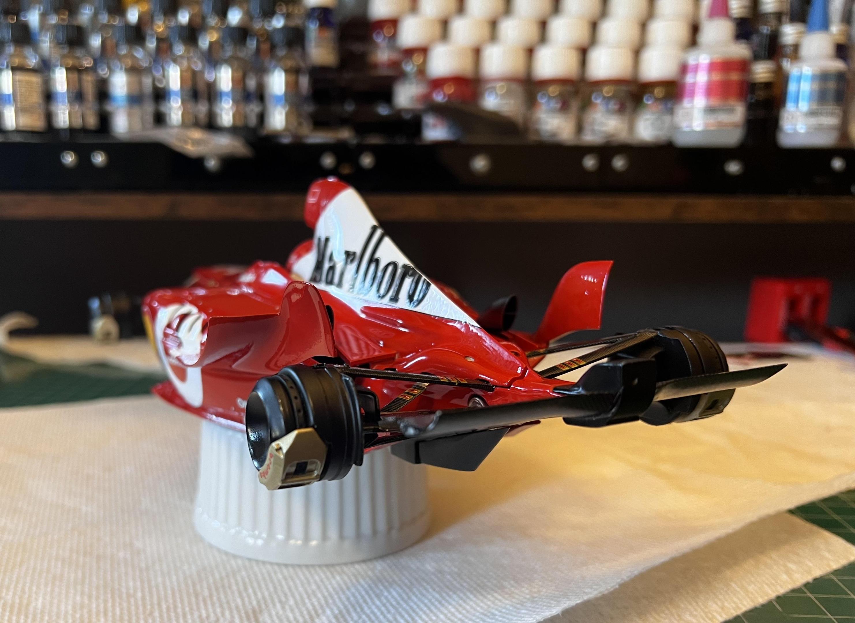

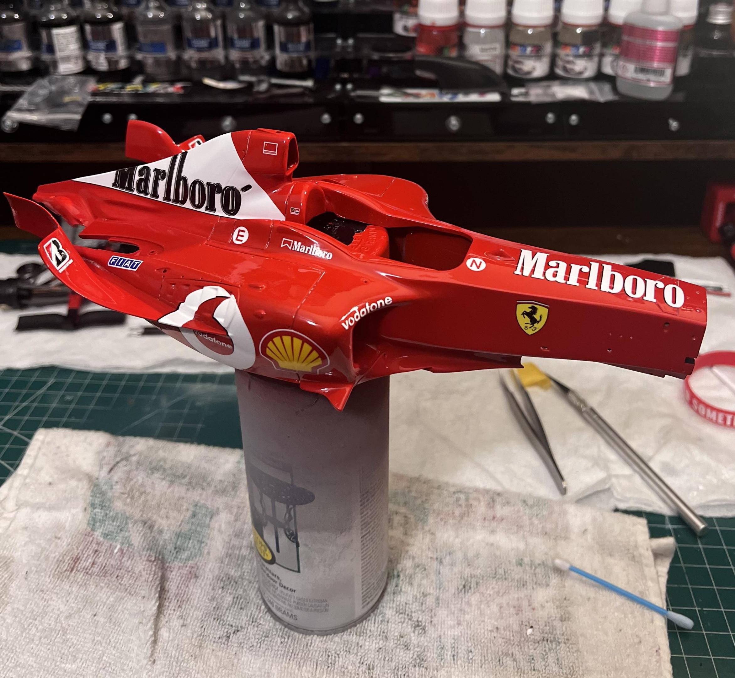

After 3 coats of clear , some massaging with some 3000 grit and 5000 grit. Then I used 3 different polishing compounds , here we are. A few more small details then I’ll put a couple coats of wax on it. -

I cleaned up the white metal parts by sanding the burrs and drilled the holes for the control arms. Cleaned the resin parts with dawn , hot water and an old toothbrush. Put the metal parts into the magnetic tumbler. primed the parts and painted the brake rotor with Tamiya flat black and then used Tamiya graphite powder for give it a carbon effect. Painted the rest of the parts with Tamiya semi gloss black, assembled as per instructions, then added the PE brace as per instructions. the control arms are covered with carbon fiber decals. Hope this helps -
