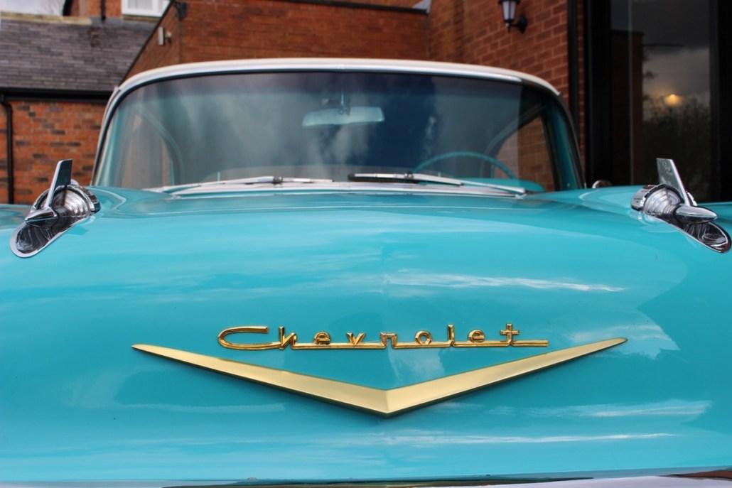

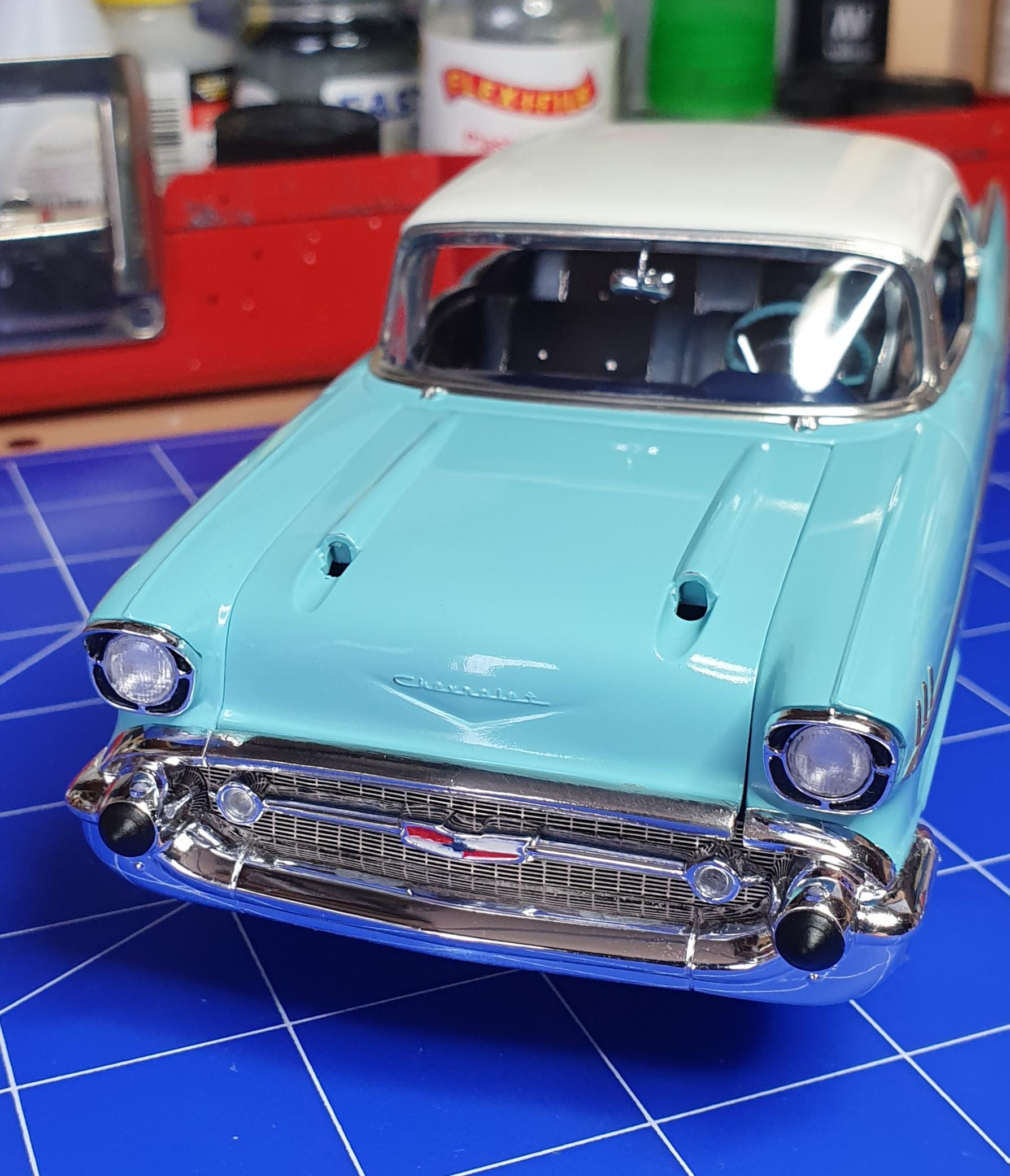

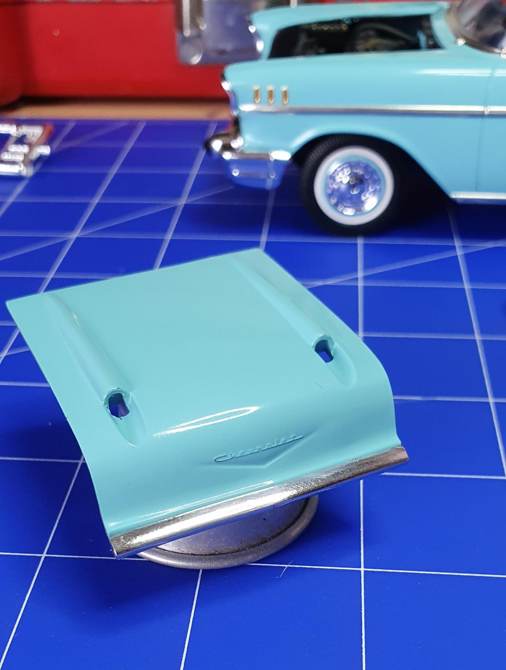

  5. Hood rockets fitted, they were cut off the parts tree, after sanding the ends smooth and rounded off slightly, they were rechromed using Molotow liquid chrome and fitted to the hood using 5 minutes epoxy resin.

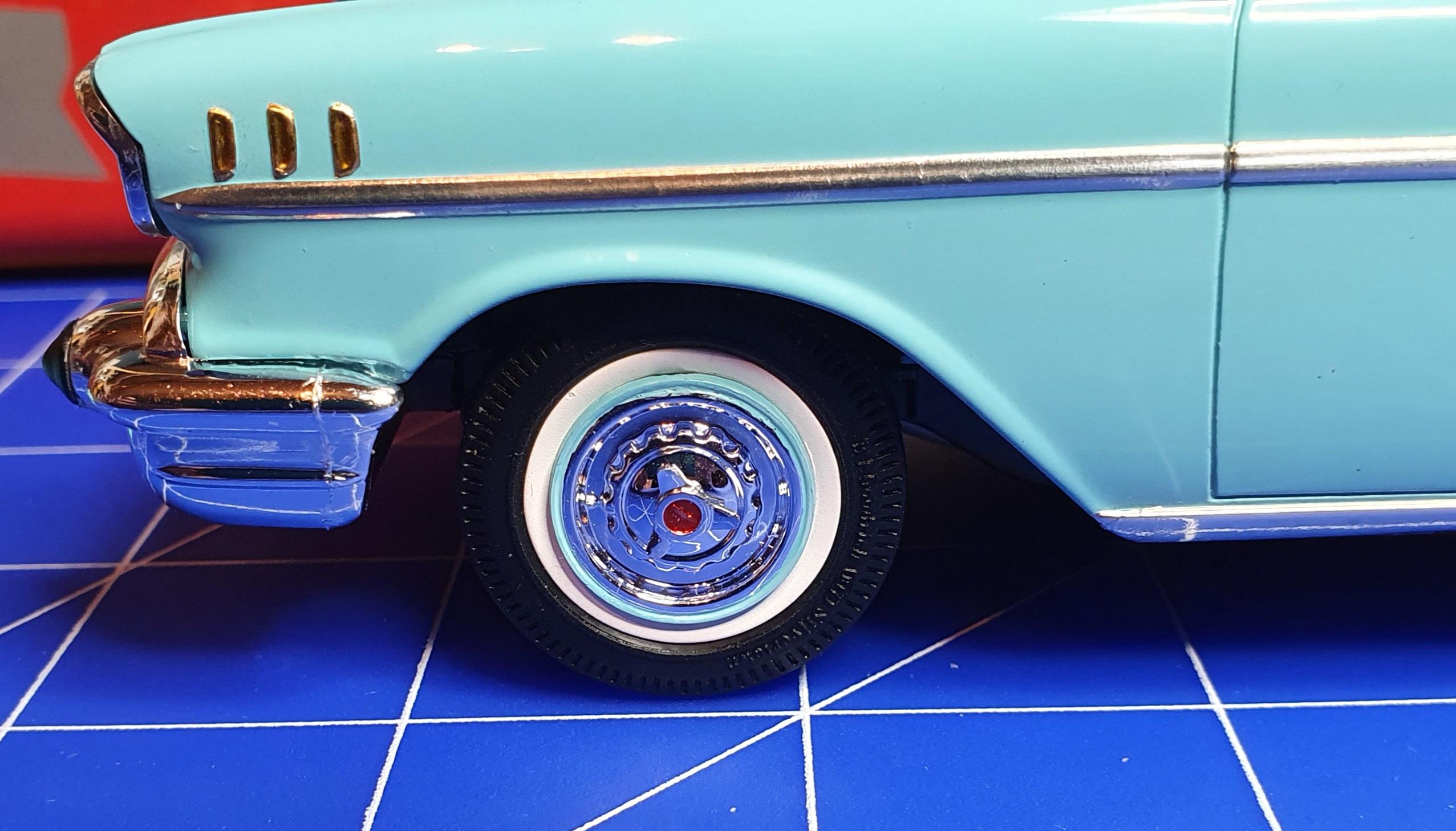

  12. Business got in the way of modelling today, although I did get chance to fit the wheel centres, and prepared the rest of the small chrome parts and touched up the cut off points with Molotow liquid chrome, the Chevrolet V's and Chevrolet scripts need airbrushing in gold, I'll be using Mr Color gold paint, the radio aerial didn't look good, so I cut the mast off, drilled the base and inserted a cut down dressmaking pin.

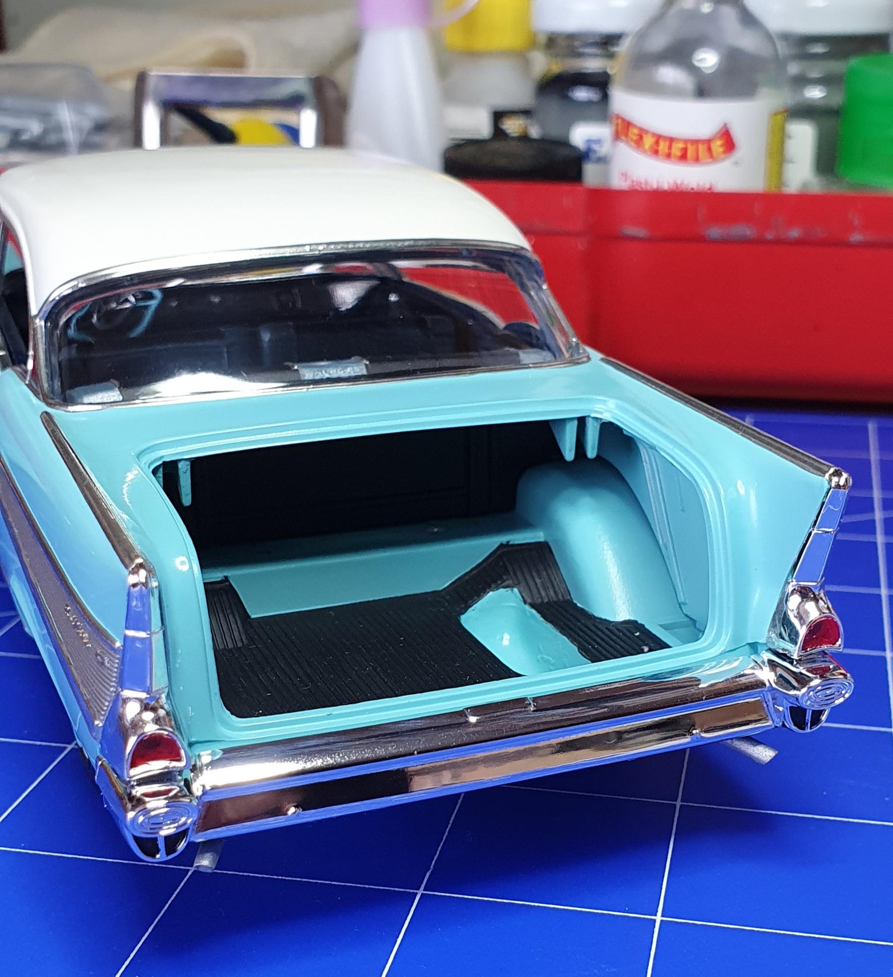

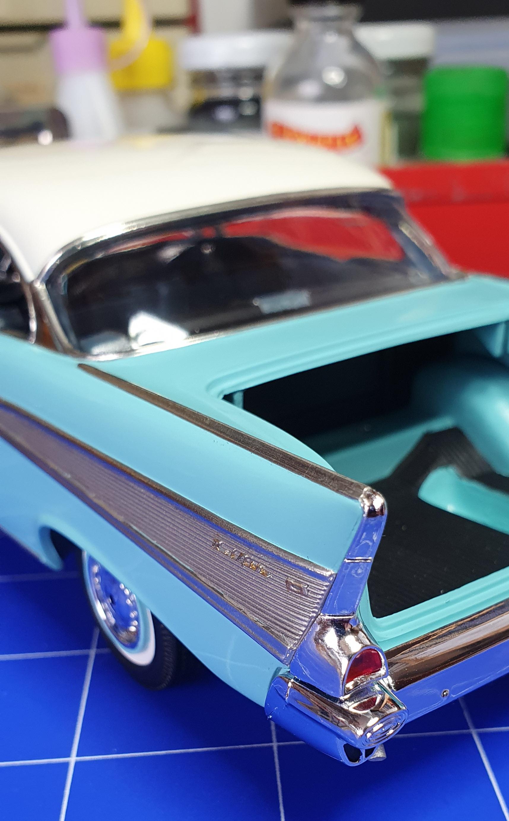

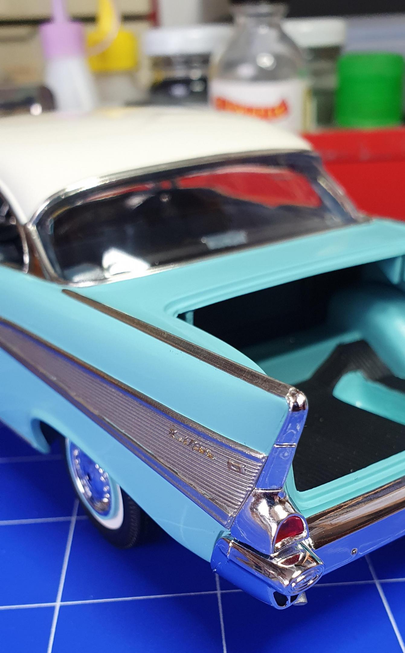

  13. Rear end built up, no problem here with parts fit

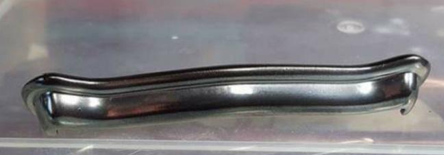

  14. I've had it before on AMT kits, the rear bumper on the 57 Chrysler 300 had the cut off points right on the top, ended up stripping the chrome off and redoing it using K Colors chrome, the build would have been so much easier if they had just put the cut off points on the bottom of the part.
  15. It's tight, but it fits....

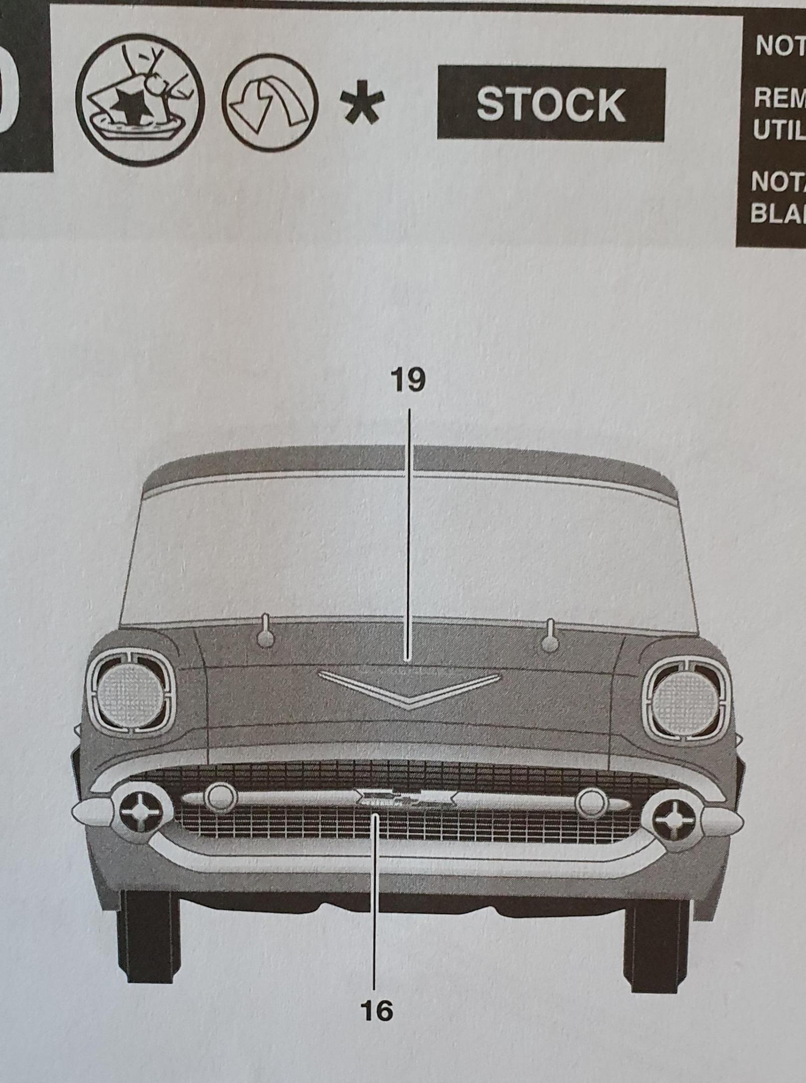

  16. The V emblems are supplied on the chrome sprue, but they need to be stripped and done in gold, I'm still thinking on how I'm going to do that, the Chevrolet script is supplied on the photoetched sheet, but still needs painting gold.

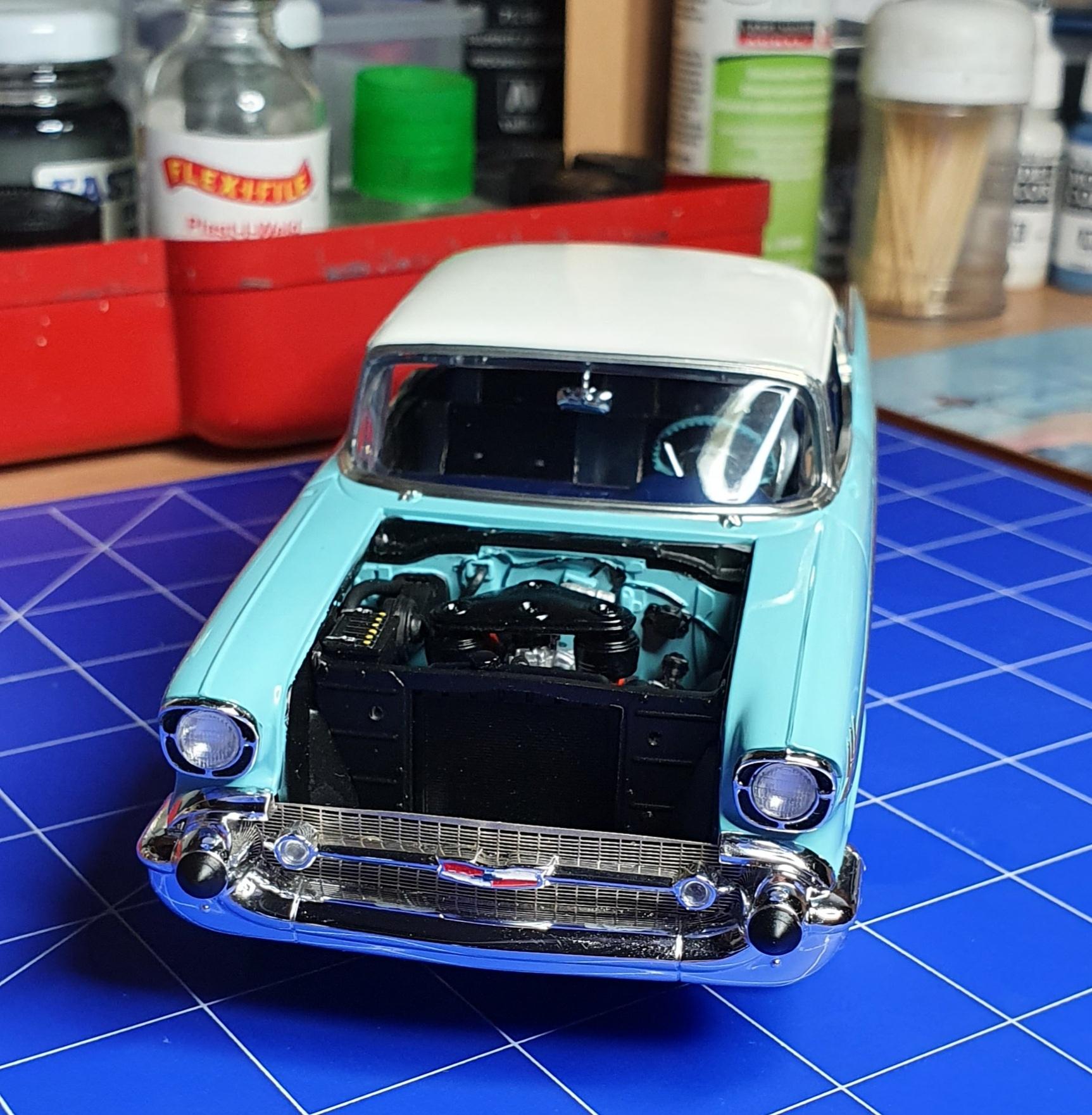

  18. I've just done a dry fit, now the front bumper and grille has been fitted, it's tight, but it fits and looks OK
  19. I had to drill out the mounting holes on the trim, nothing too major, the worst thing is that AMT put the cut off points on the parts tree on the top of the part, so the part was sanded smooth and covered in Bare Metal foil and then polished, and then fitted to the bonnet using 5 minute clear epoxy.

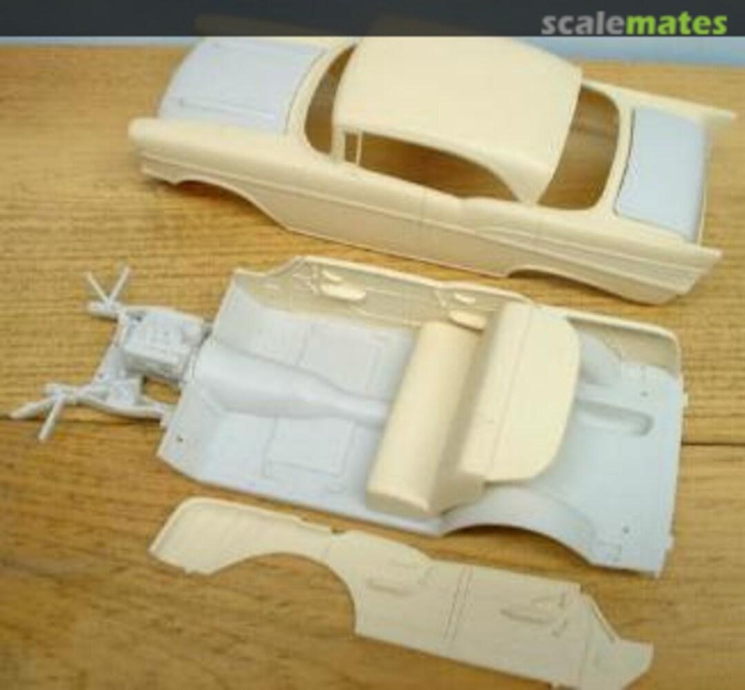

  20. So far, so good, I'll find out tomorrow when I get to fit the chrome trim to the front edge of the bonnet, (Sorry,Hood), I've got another one in the stash that I want to turn into a four door, I'm not sure I'm skilled enough to try the conversion myself, I've been after the resin transkit without any luck.
  21. I'm not 100% happy with the front emblem which I hand painted, but even with a 10/0 brush and my magnifying lamp, it's the best these old eye's and hands can achieve, the fit of the bumper was pretty good, a little 5 minute epoxy soon had it permanently fitted in place

  24. To do a proper conversion you need to cut the front and rear wings complete with the valances off the convertible and graft them onto the saloon, as the bumper hight was higher and they deleted the air intake grills on the wings, The bonnet and bootlid are slightly different to clear the higher bumper, I started this conversion but it went onto the back-burner
