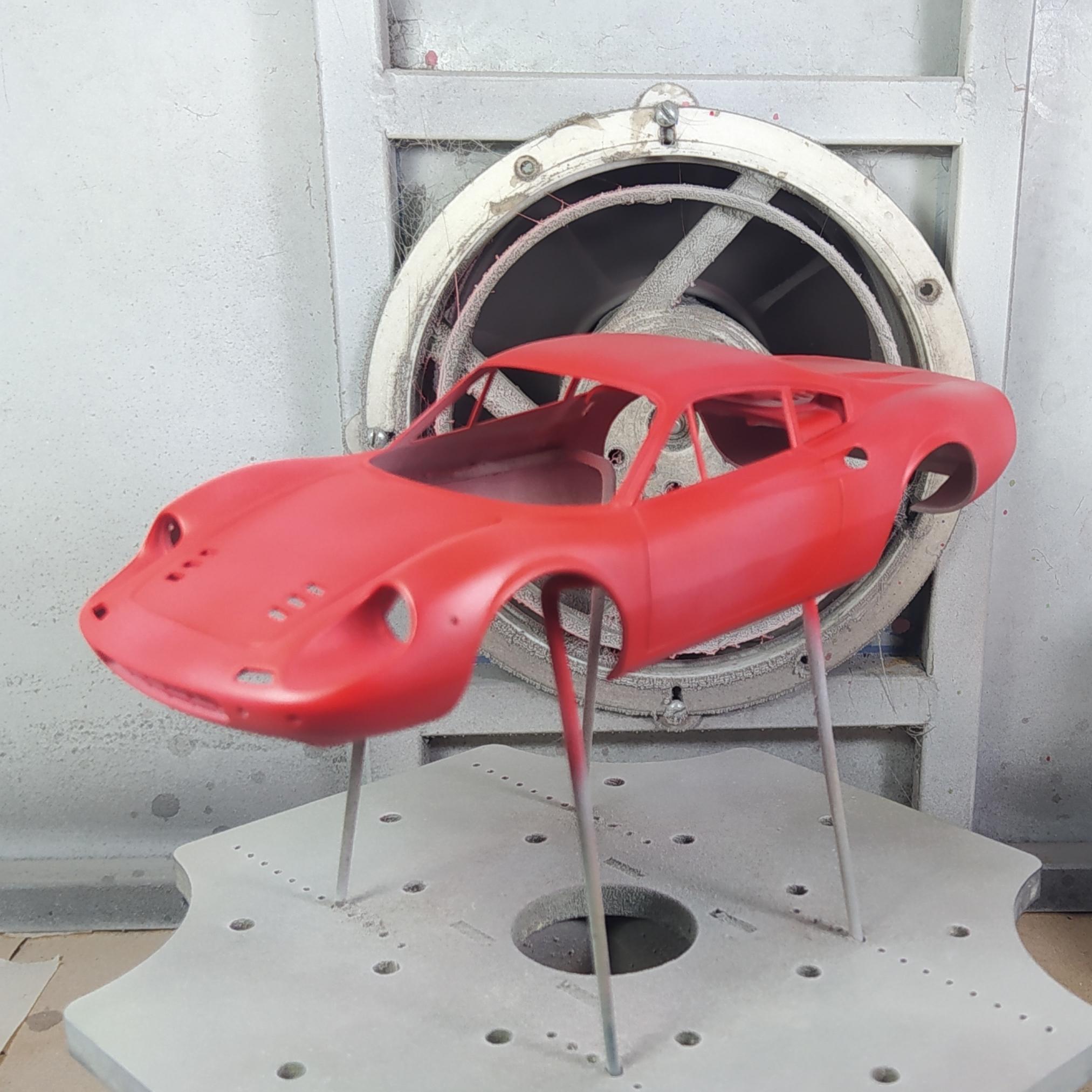

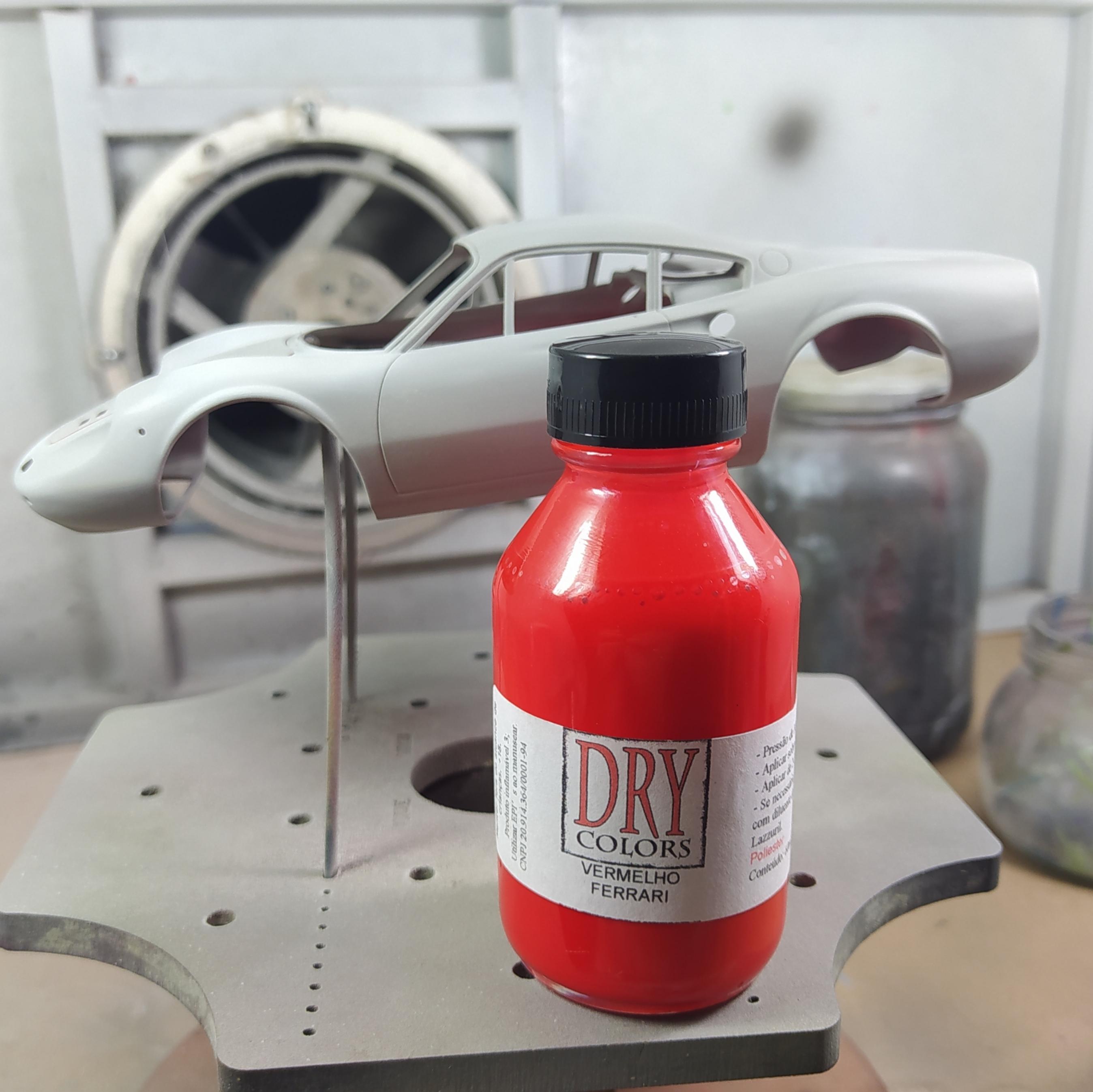

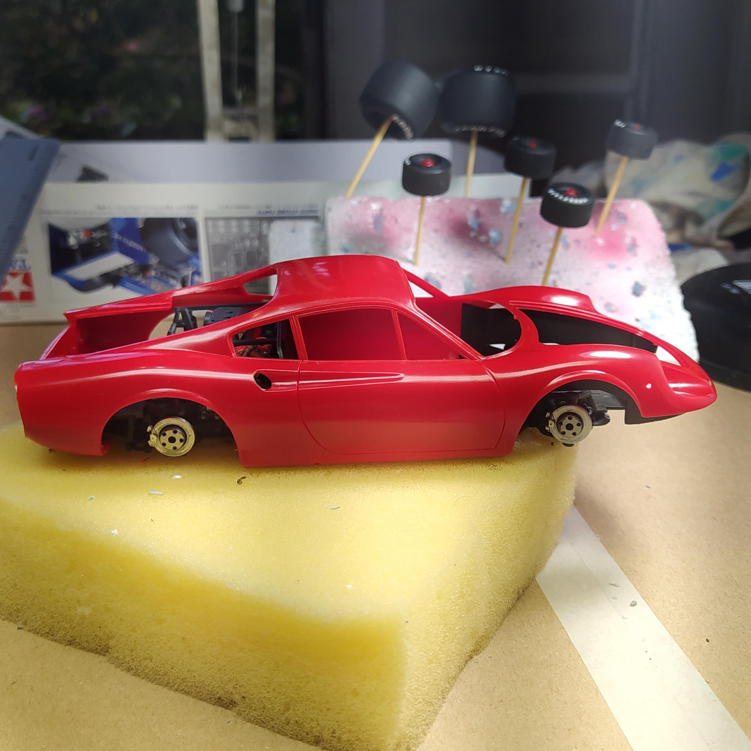

First coat of paint. Dry coat. Another dry coat. This time with more coverage. Sanded with 3000 sponge. Then washed. After it dries, I'll do the wet coats.
Nice to know that! I also sand between coats of paint.

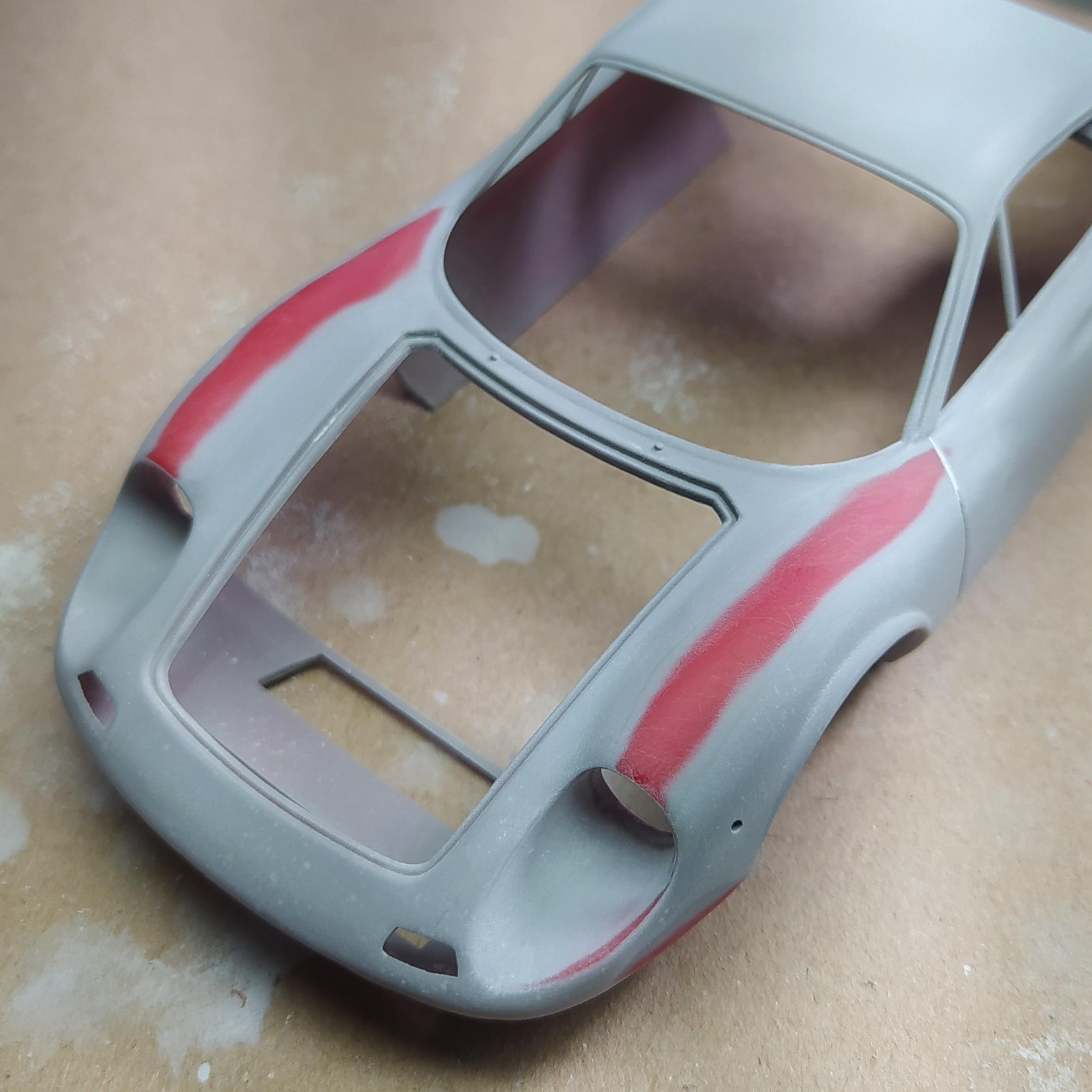

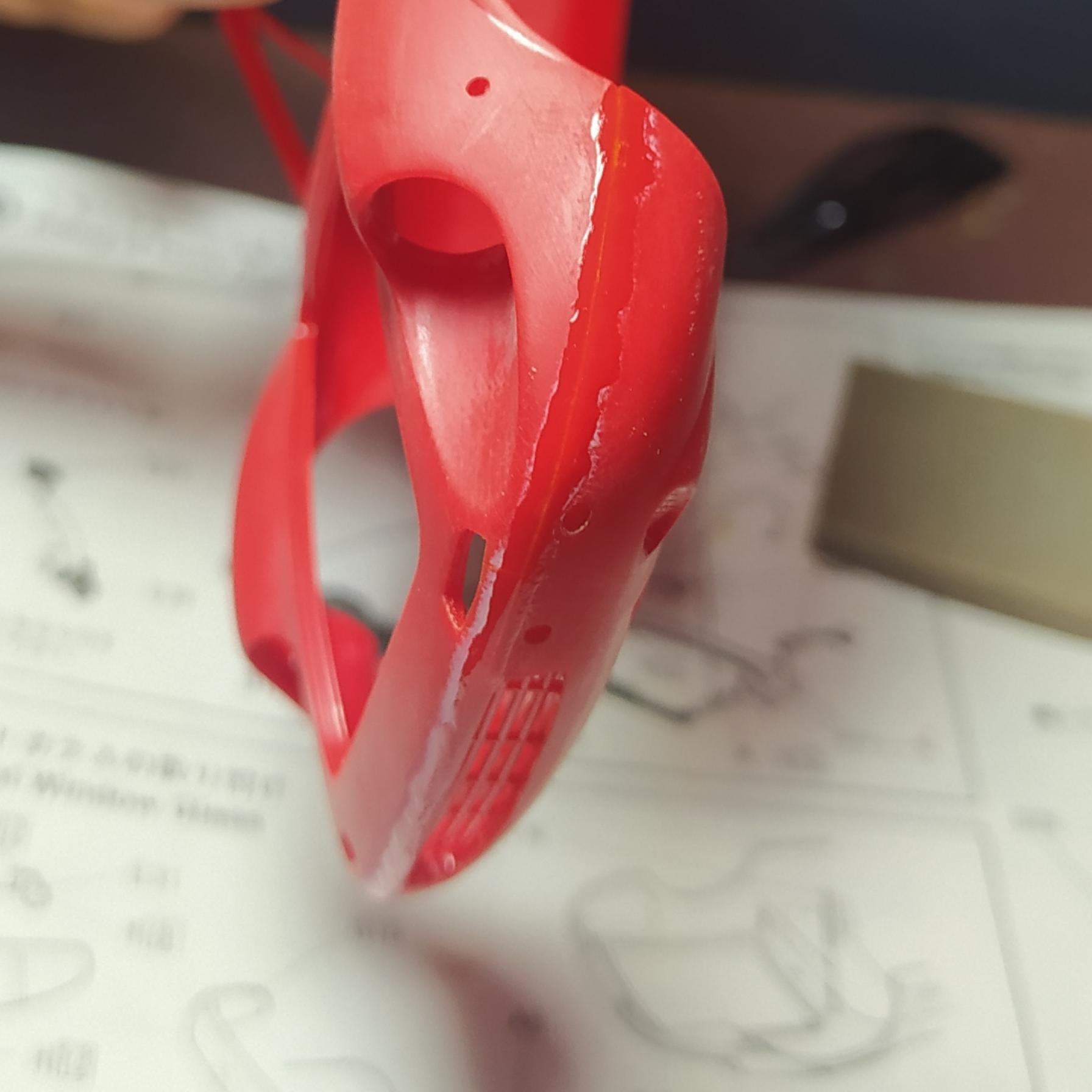

I tackled the mold lines with a tip I got on Facebook. Sanded the area again. Put extra thin cement over where the lines were. And they popped up again. Let it dry, and then sanded again. Now they seem to be gone forever.

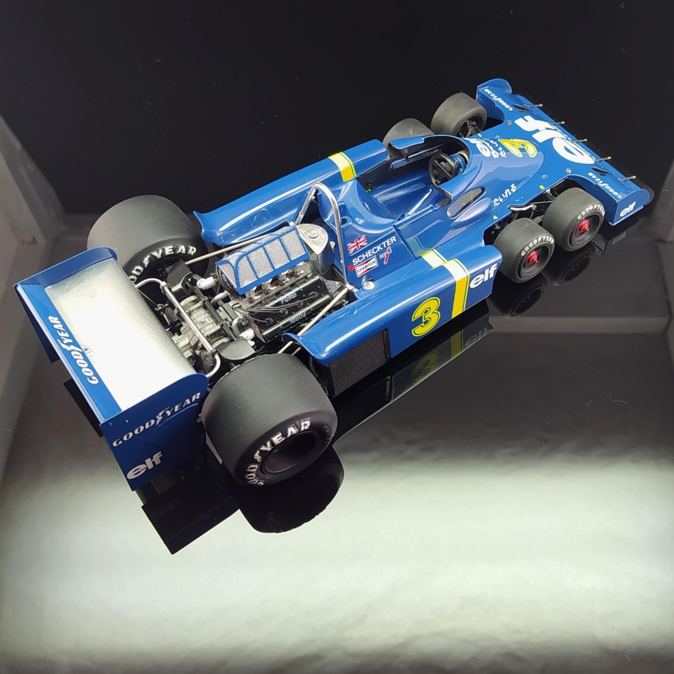

I put the tire on my Dremel (with a makeshift axle) and spun it over sandpaper. Not too fast to avoid excessive heating and melting the rubber. -

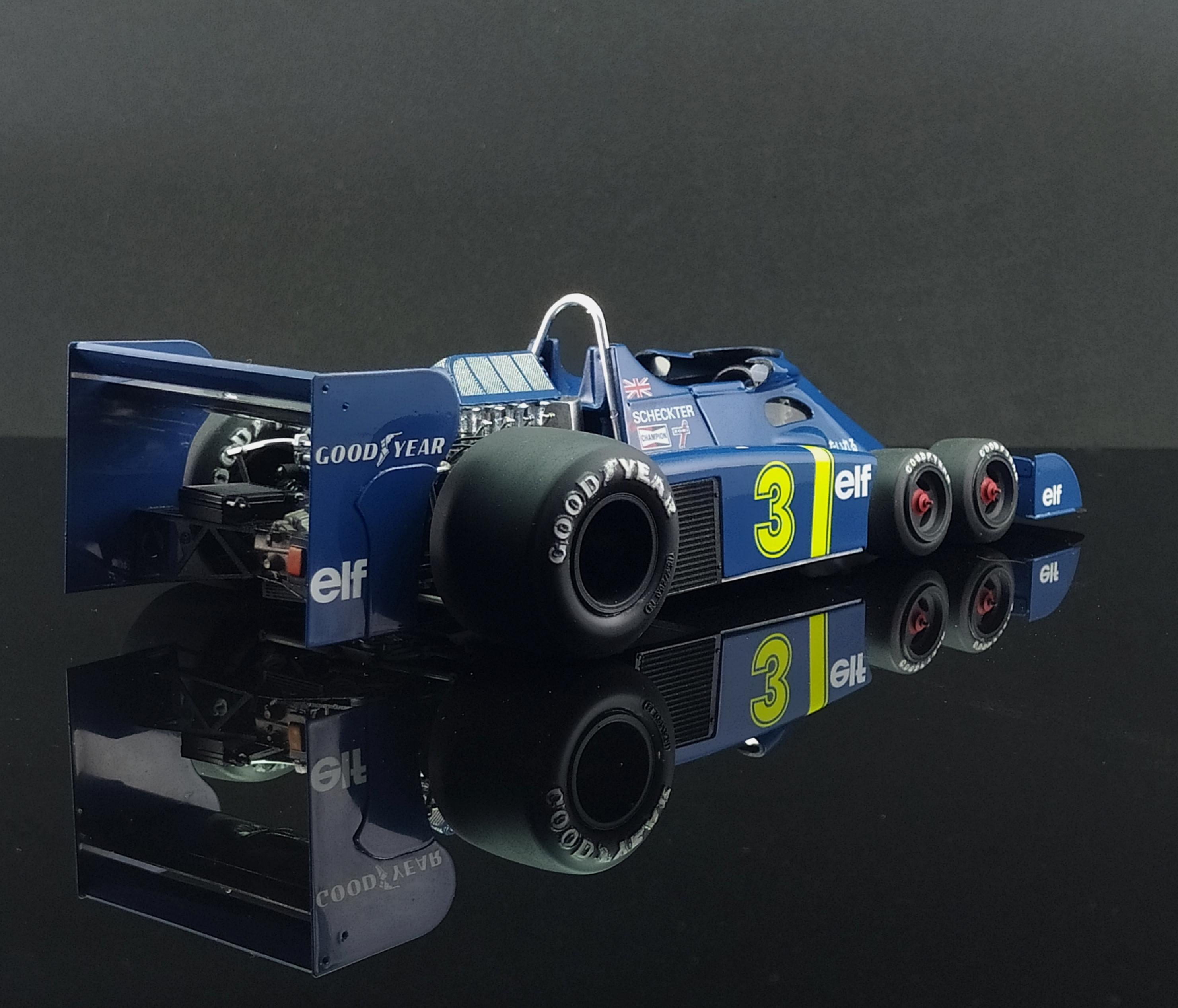

A good kit but I had to work a lot on the tires to make them smooth. -

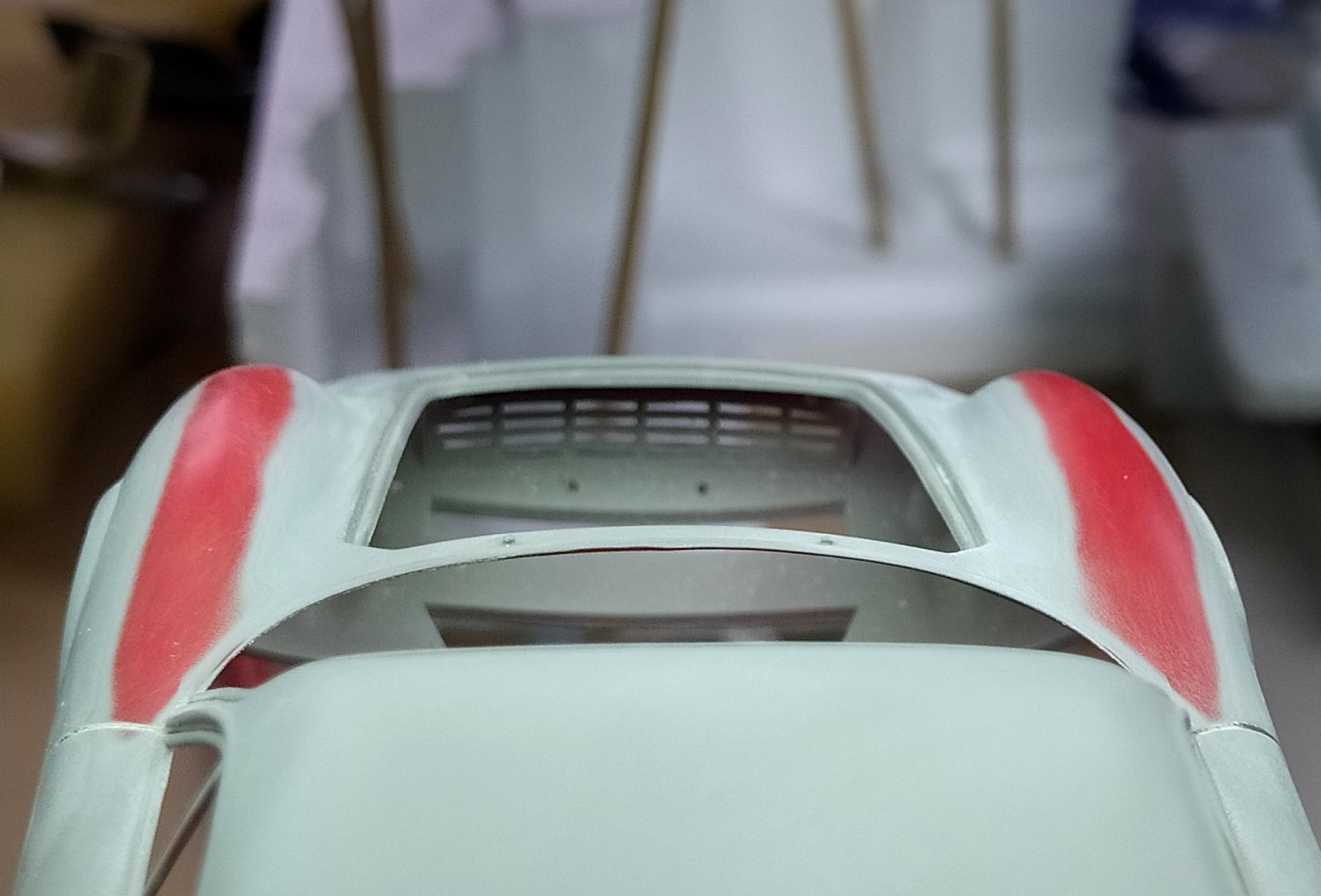

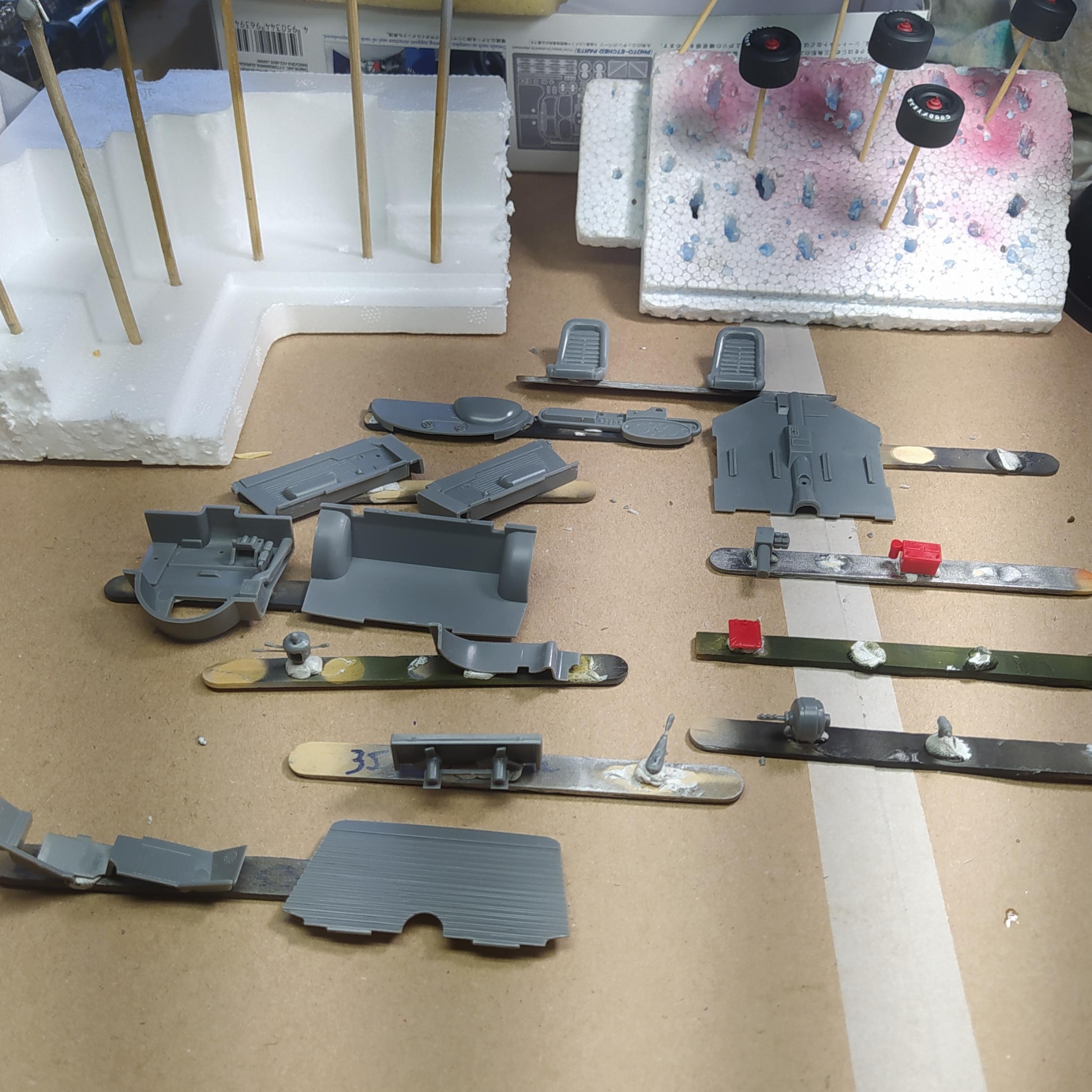

2k primer time. I love the way this primer goes on. Still some sanding to do. Stubborn mold lines. Primer reveals everything. But that's OK. Better see these lines now than after the paint.?

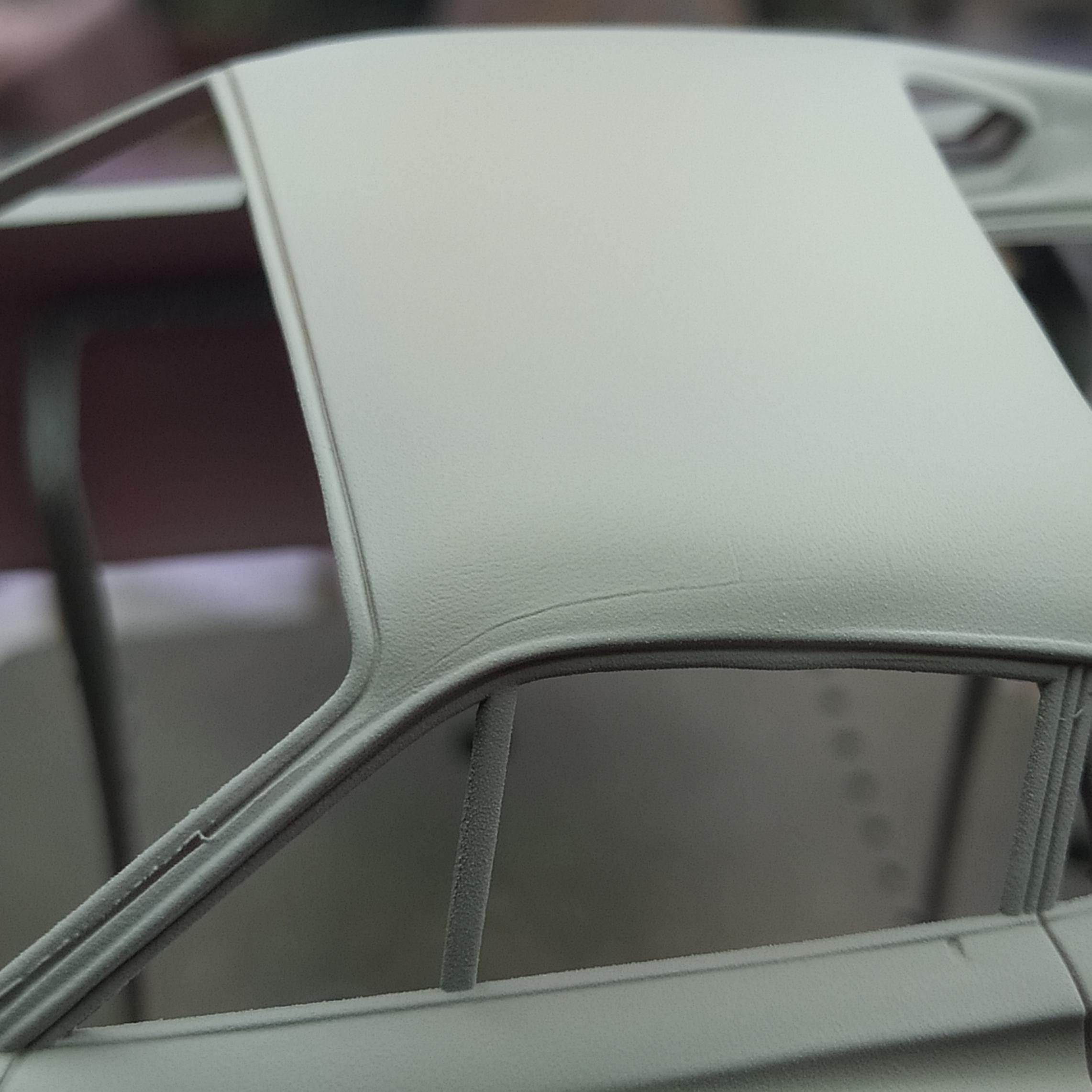

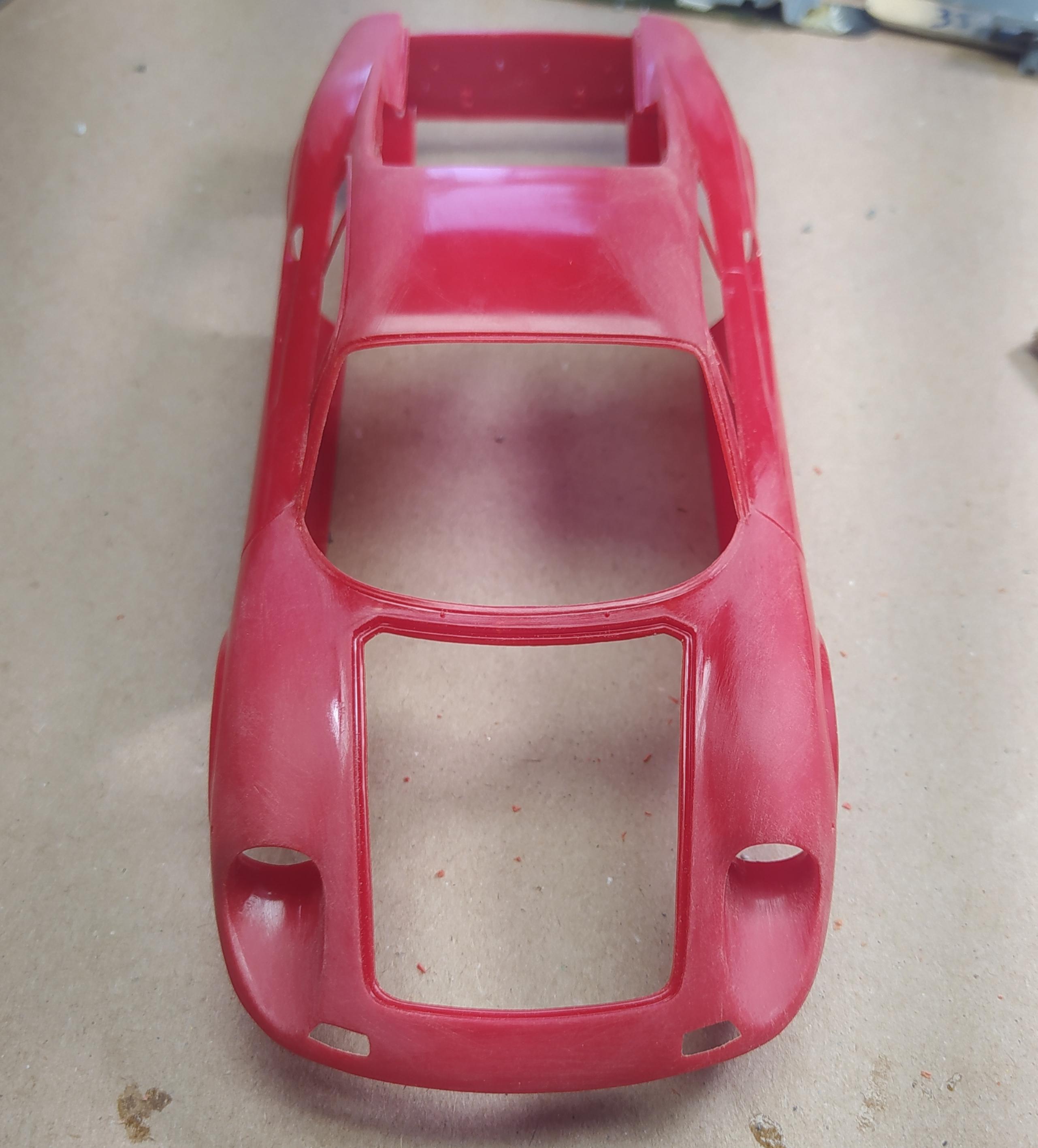

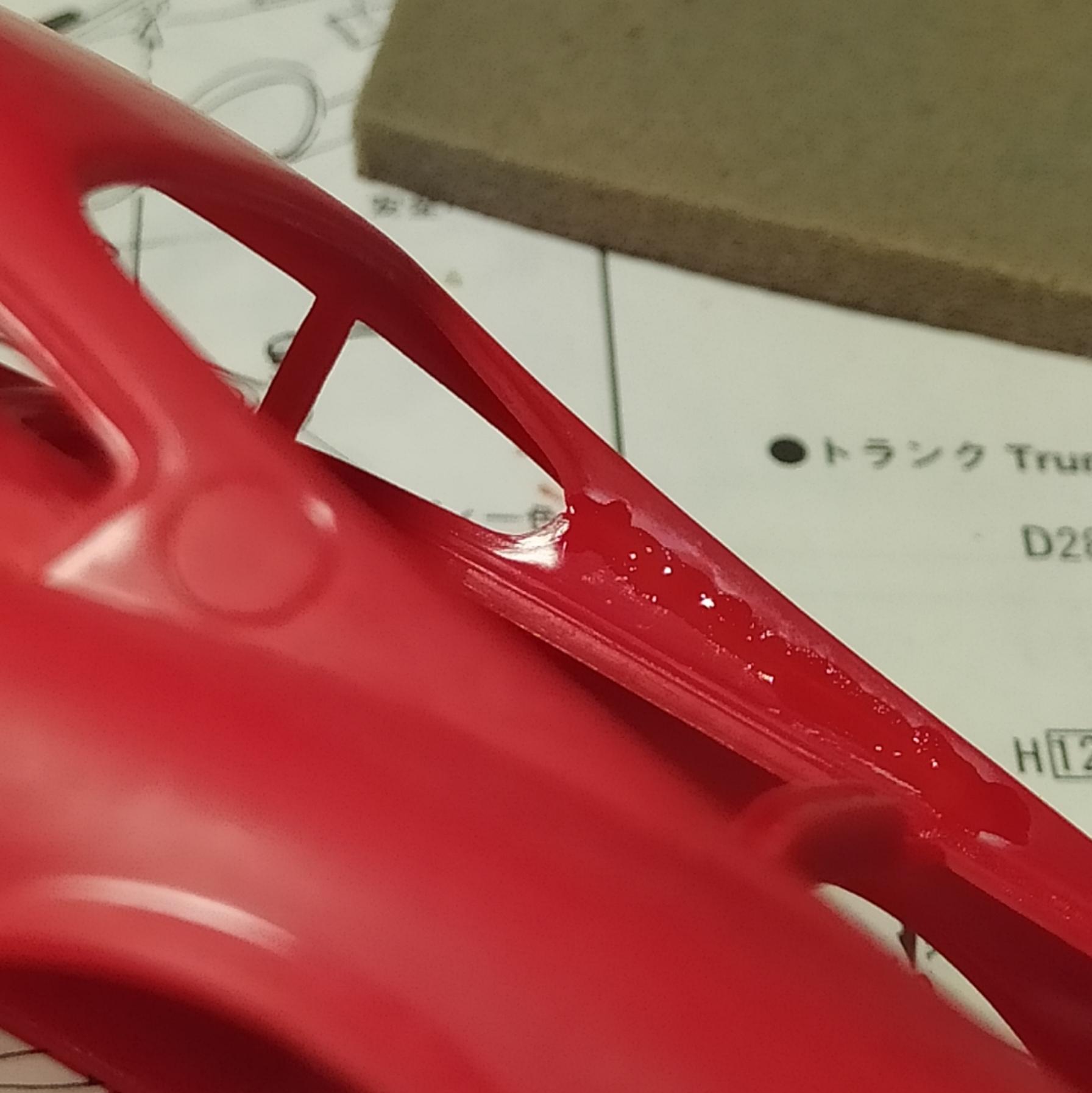

Sanded down the superglue. Looks good. Washed the kit to remove the dust and residues. Ready for priming!

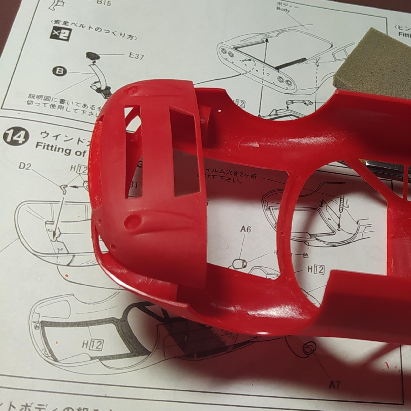

Sanded the mold lines This one was ugly Got it off All the covers fit nicely. The whole body was sanded down to 1000 grit. I find this way best for primer anchoring. Tricky part. Stick it and covered the gap with superglue. Did the same on the front

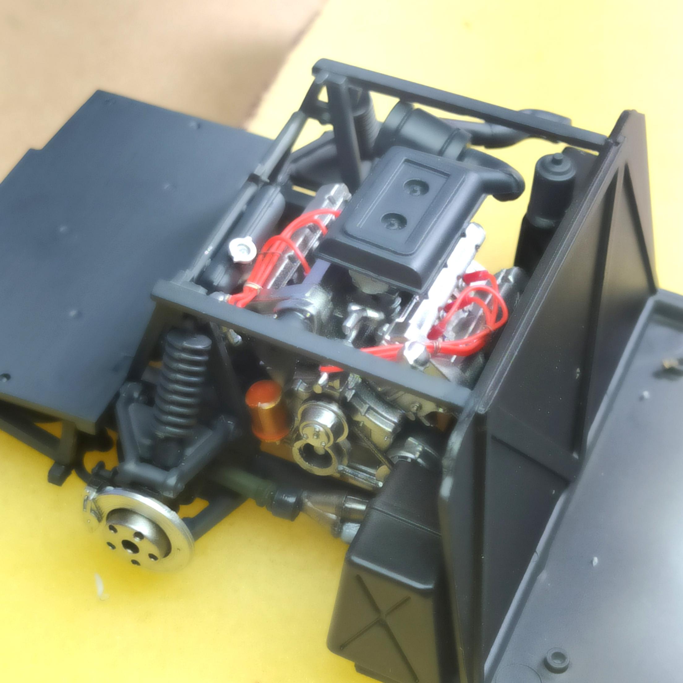

Did some engine detailing. Got these nice accessories: added larger wire sleeves on the distribuir The red wire fits nicely More details On the other end I added a red sleeve. Also from a larger gauge wire I liked the effect Now I have to rest my eyes ???
