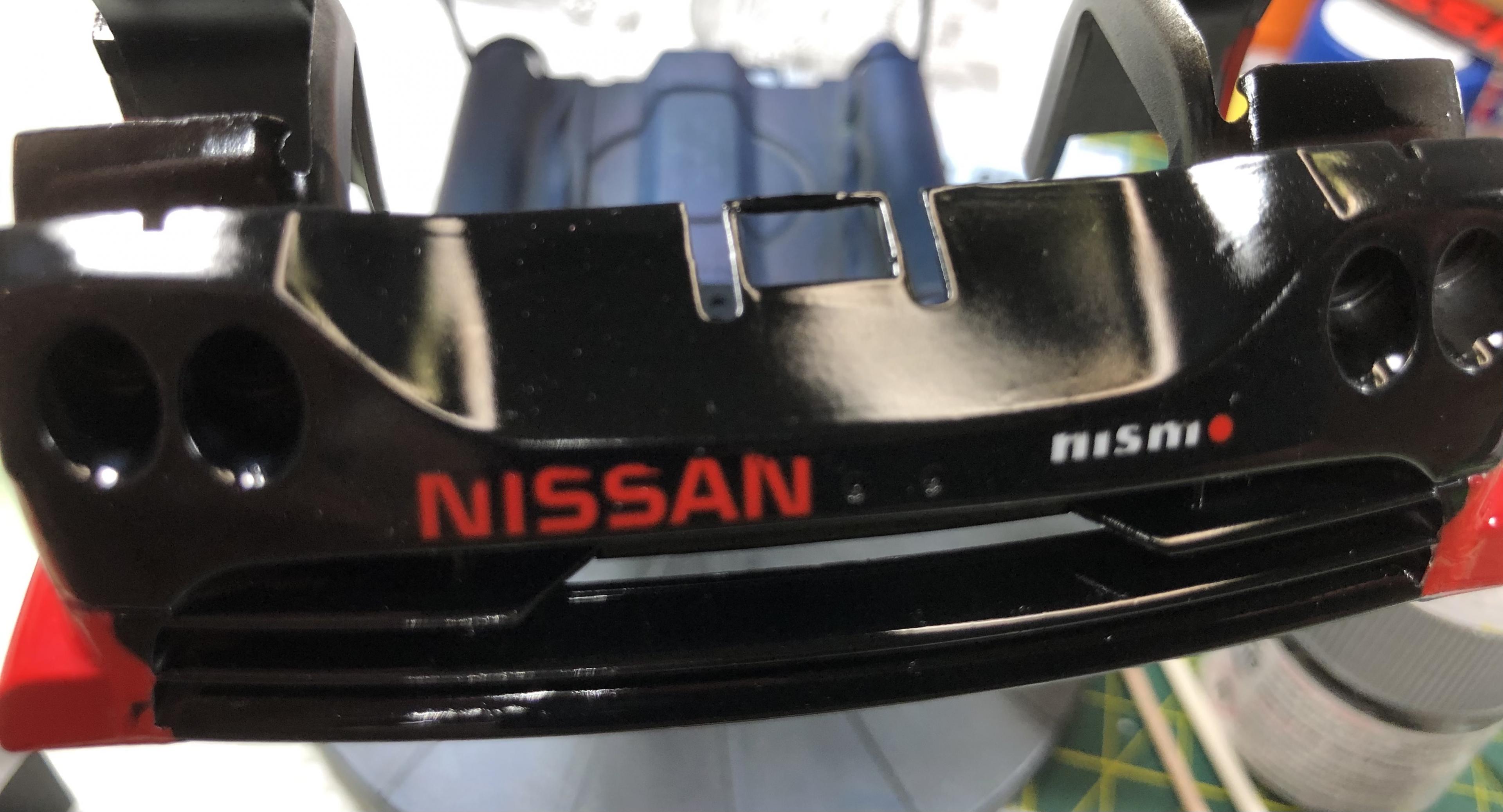

Thanks Jim. I had a couple of specks that needed to be sanded out. The finish was great otherwise. I started with wet 4000 grit Tamiya sanding pad then 8000 and then to Tamiya polish. I burned through on the 4000. I think it was a combination of things that went wrong. My 2k was probably too thin, I didn't pay enough attention to what I was doing and I got too close to the sharp edge. My next build will be a simple inexpensive kit with no decals to try to get the technique down. With no decals I can strip itmif needed. I also picked up a set of Micro Mesh sanding pads to try. -

Not perfect but it's fixed. I sprayed the whole panel with the original black then hit it with some clear gloss lacquer (MRP). I may just leave it as is and not polish it. -

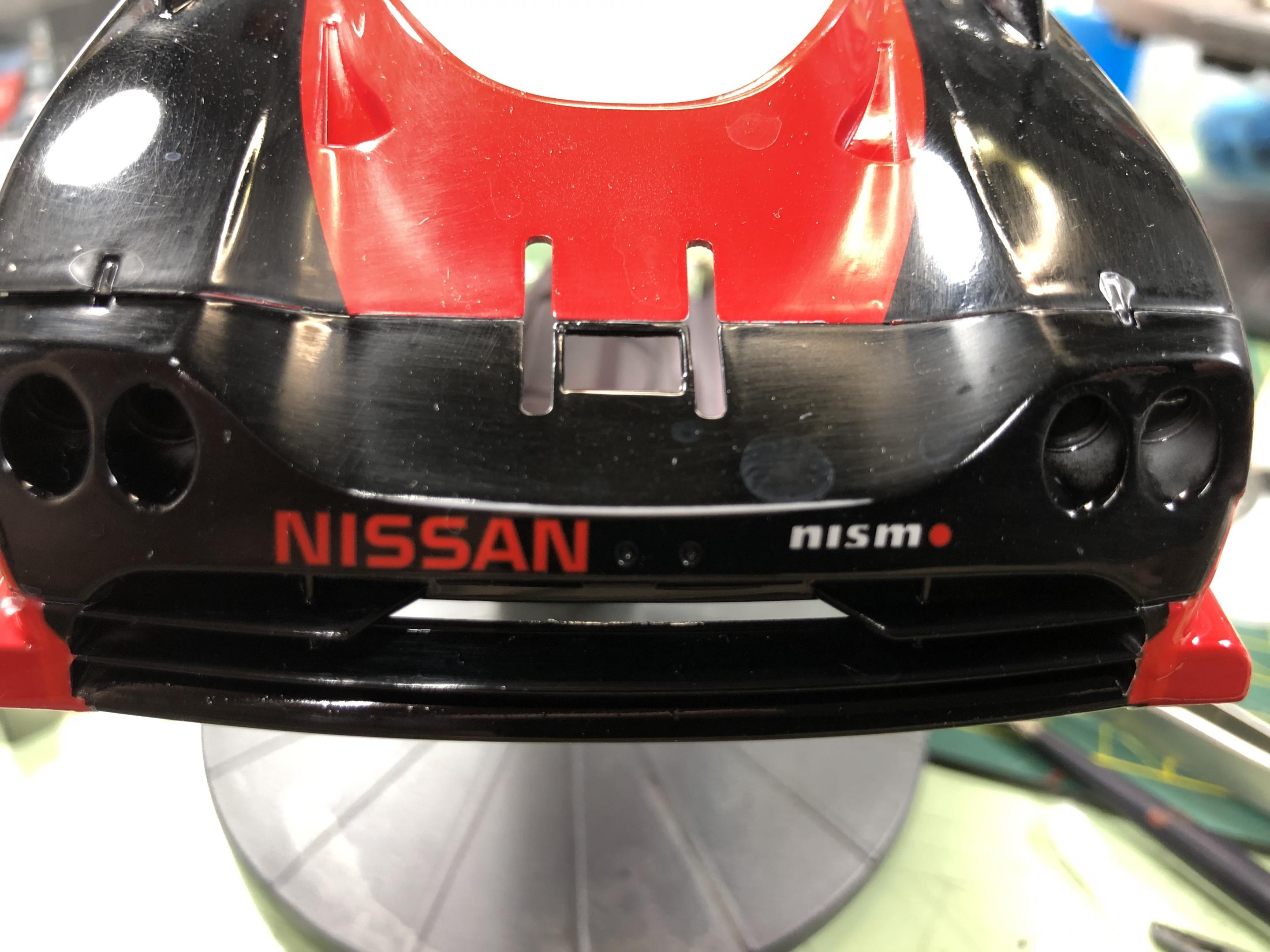

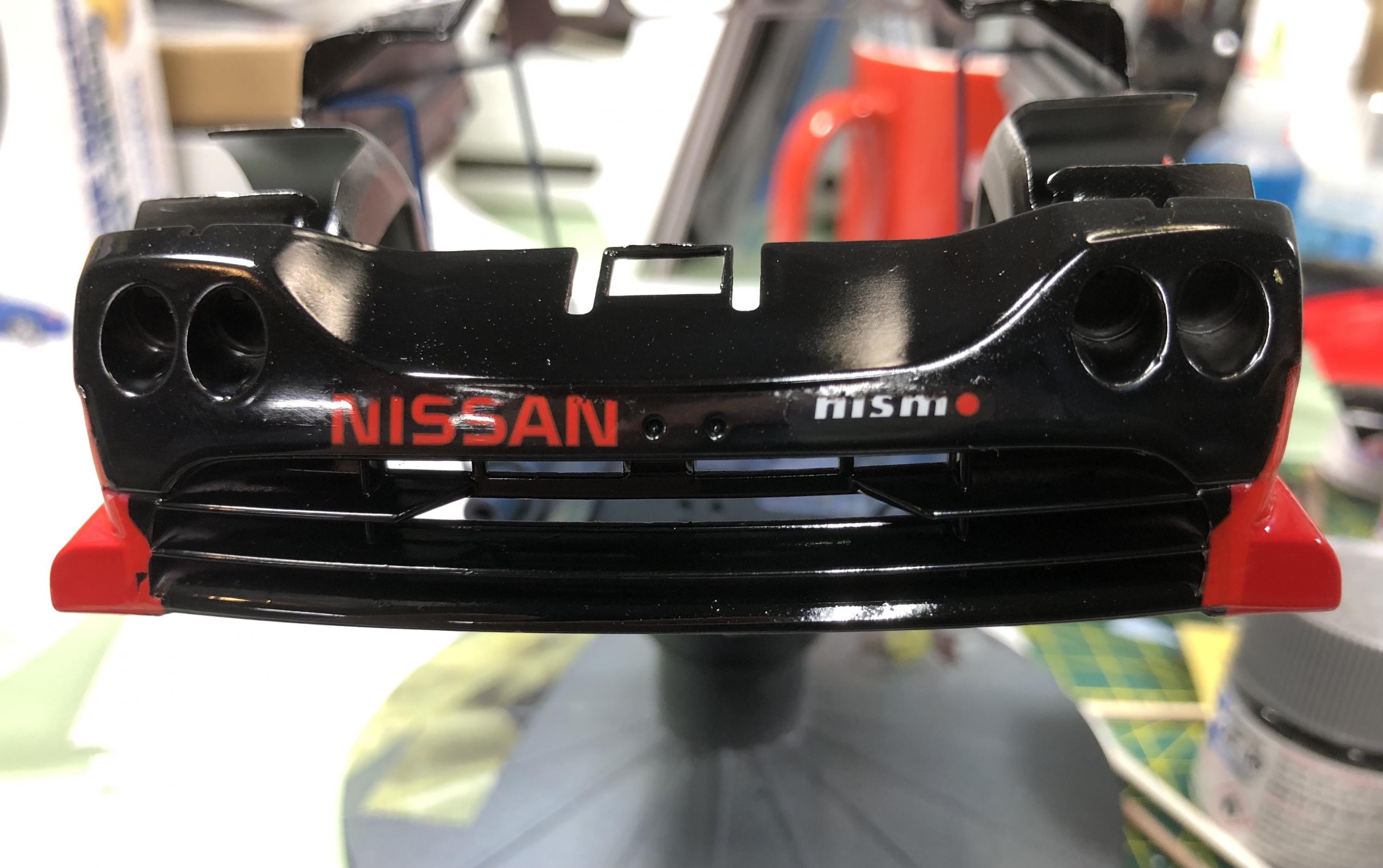

This was primed with Gravity primer, painted with Gravity Anthracite Black and 2K'd with MRP gloss 2k. I was sanding out a couple of dust specks and got carried away. Can I mask the decals off and spray some new paint then blend in some new 2k? Will it stick to the old stuff? Any suggestions would be greatly appreciated. -
