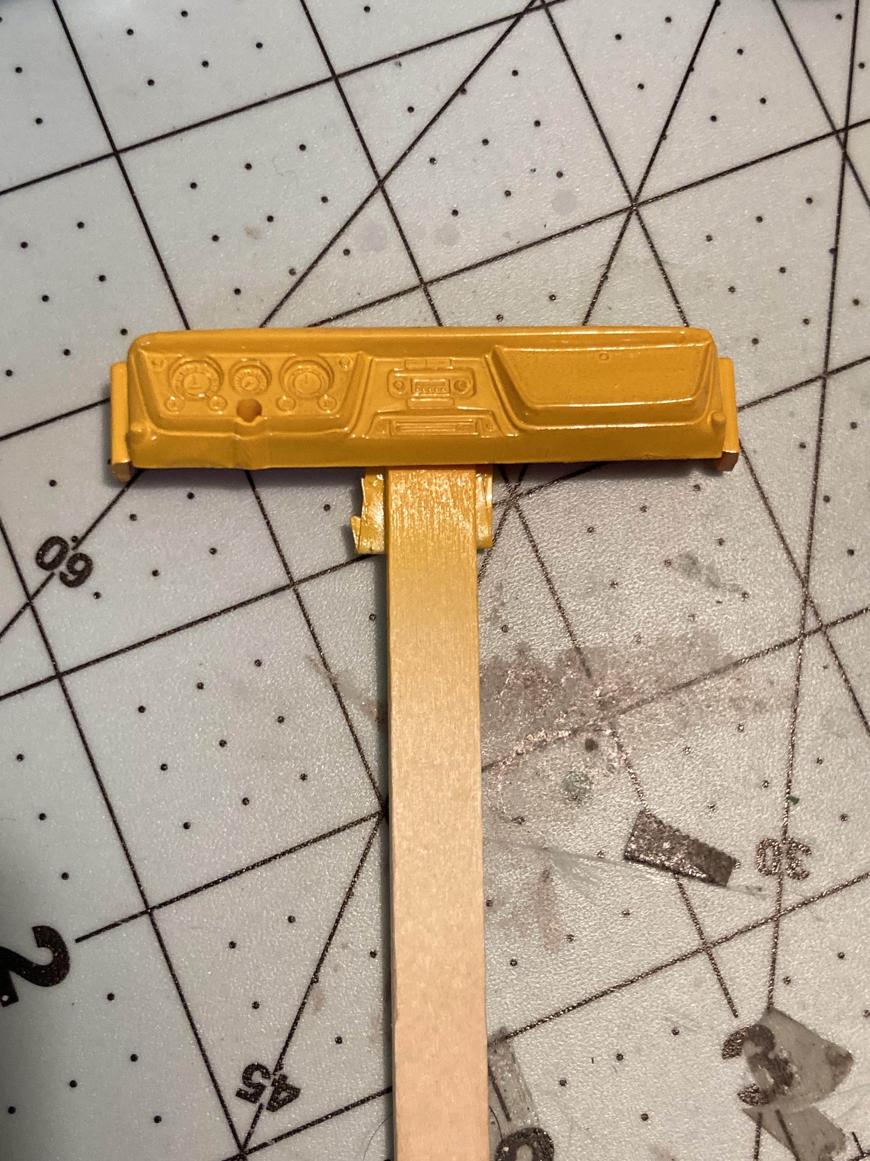

A little more work... The seats are officially done! I put a coat of Tamiya's Semi-Gloss Clear on the flat paint to make it look more like vinyl upholstery. I also did the same to the interior tub but I foolishly masked the tub to paint the package shelf before I remembered to take any pictures. The dash is also pretty much done, just need to paint the gauges. I'm not entirely happy with how the silver was masked but I needed to use silly putty because I couldn't figure out any other way to do it. All things being said, it won't look too bad when installed. (Is it just me or does it seem odd that it appears that Chevy painted the dashboards in these cars with gloss paint?) I also painted the steering wheel to the best of my abilities. I really dislike the wheel that AMT includes in this thing, I think it looks more like a pool floatie than a Chevrolet steering wheel.

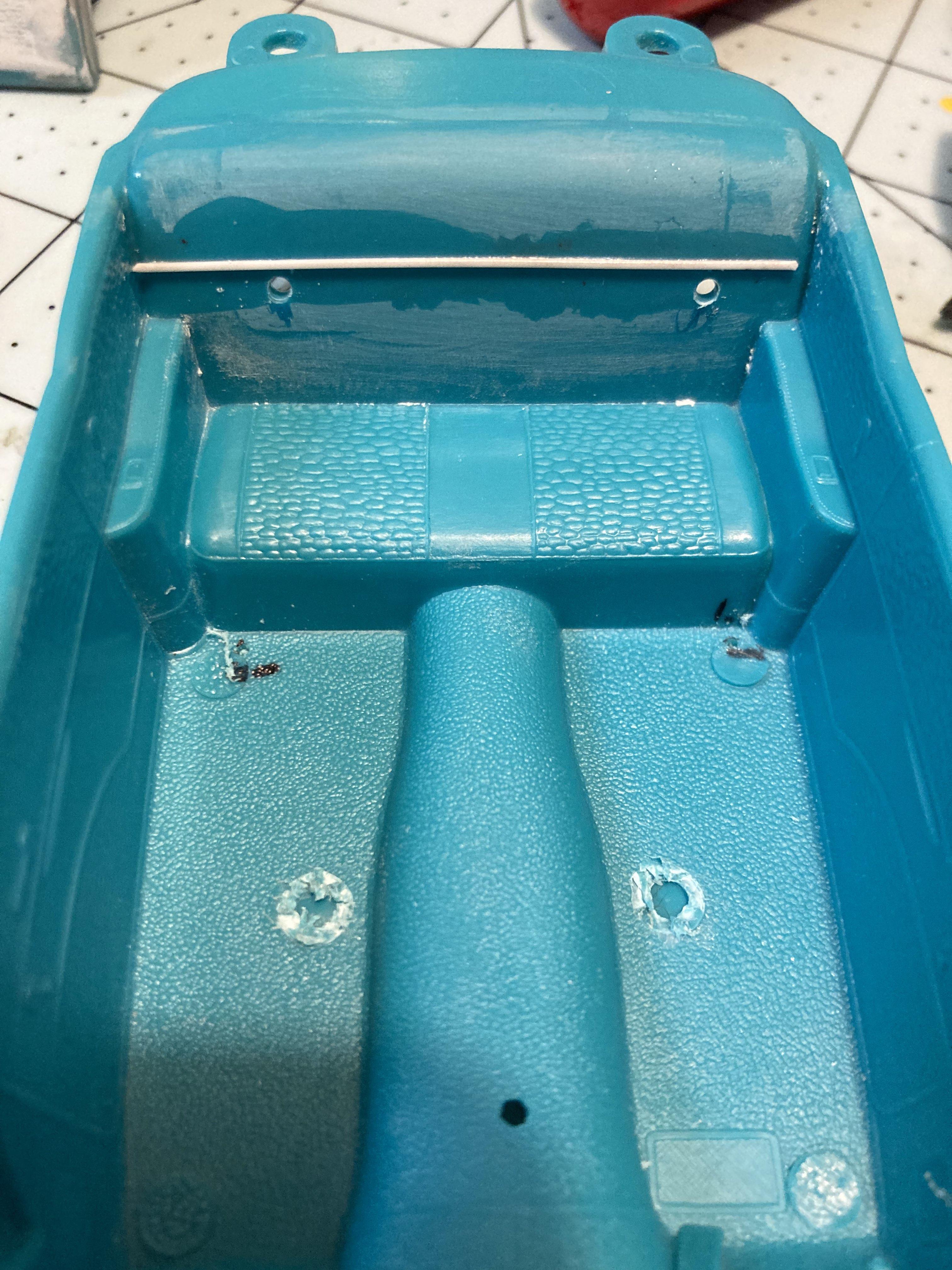

I was busy for the past couple weekends but I managed to get some work done. I've painted the front seat and the interior tub. I will be honest, the interior is not accurate to a 210. It's still got the Bel Air side panels but I went through so much effort to sand down the gator skin on the seats that I could not bring myself to do the interior tub as well. So I painted the Bel Air ones in the same scheme as the 210 would have been. It's not accurate but I figure that you won't really see it or be looking for it anyway. Unrelated, a weird problem I had with the primer I was using (decanted Rustoleum 2X white primer) and it peeling off, I think that may have been what happened with the body. I had it happen on the interior tub but since it wasn't on anything you could really see and that only the white paint came off in a few small spots, leaving the white primer, I left it. Lastly, I put down a coat of silver for the dash and steering wheel. If you notice, I added a column shifter as well.

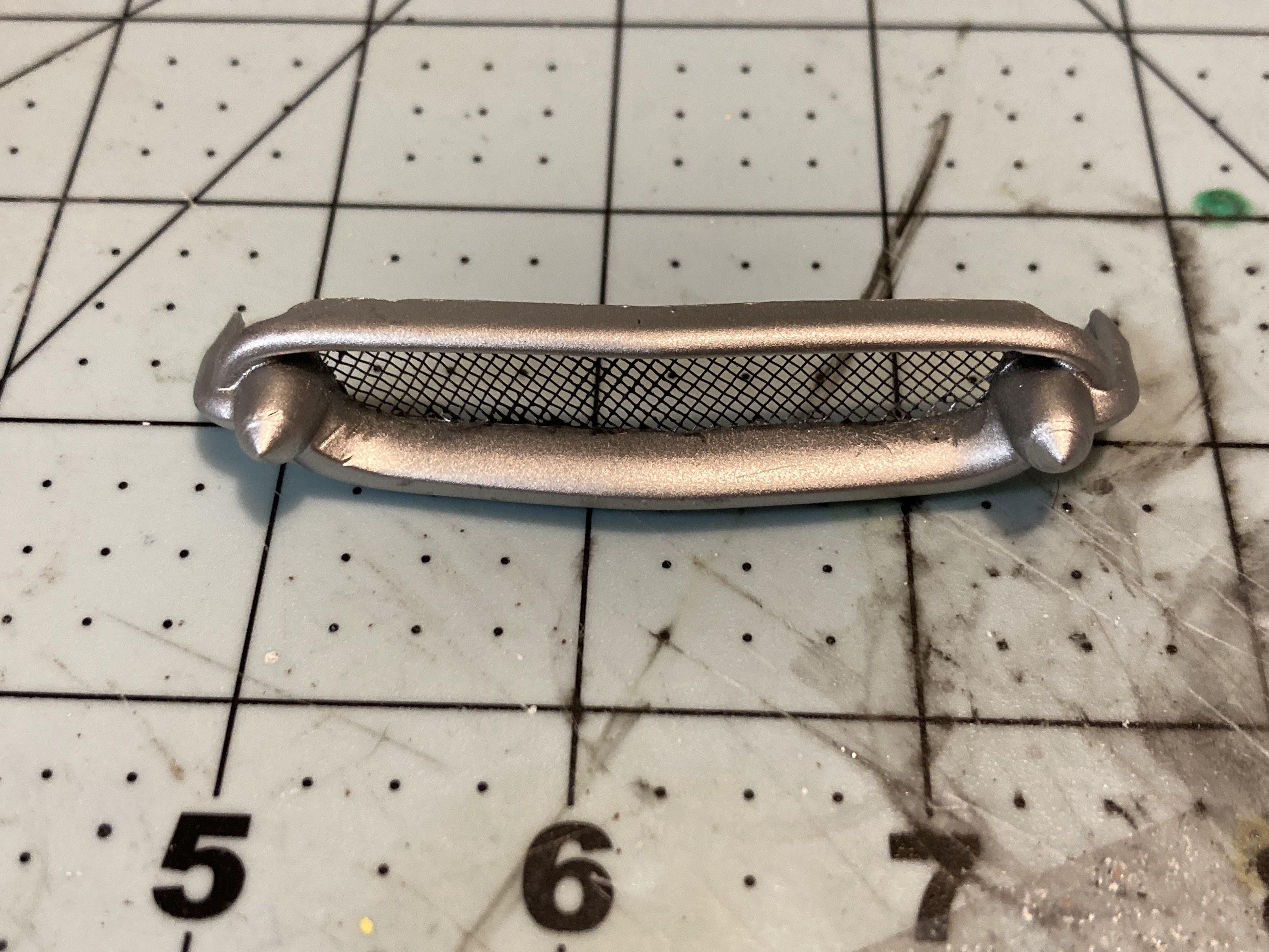

It's not much, but it's something A couple weeks ago, I stripped the instrument panel and bumper of its chrome. The idea was to cut up the bumper to make it lighter and make it look as if it was a fiberglass copy of a Chevy Bumper As you can see, I removed the bottom "lip" and cut out the middle. The mesh is from a dollar store splatter guard and will get painted black later, don't worry. I think it looks pretty good.

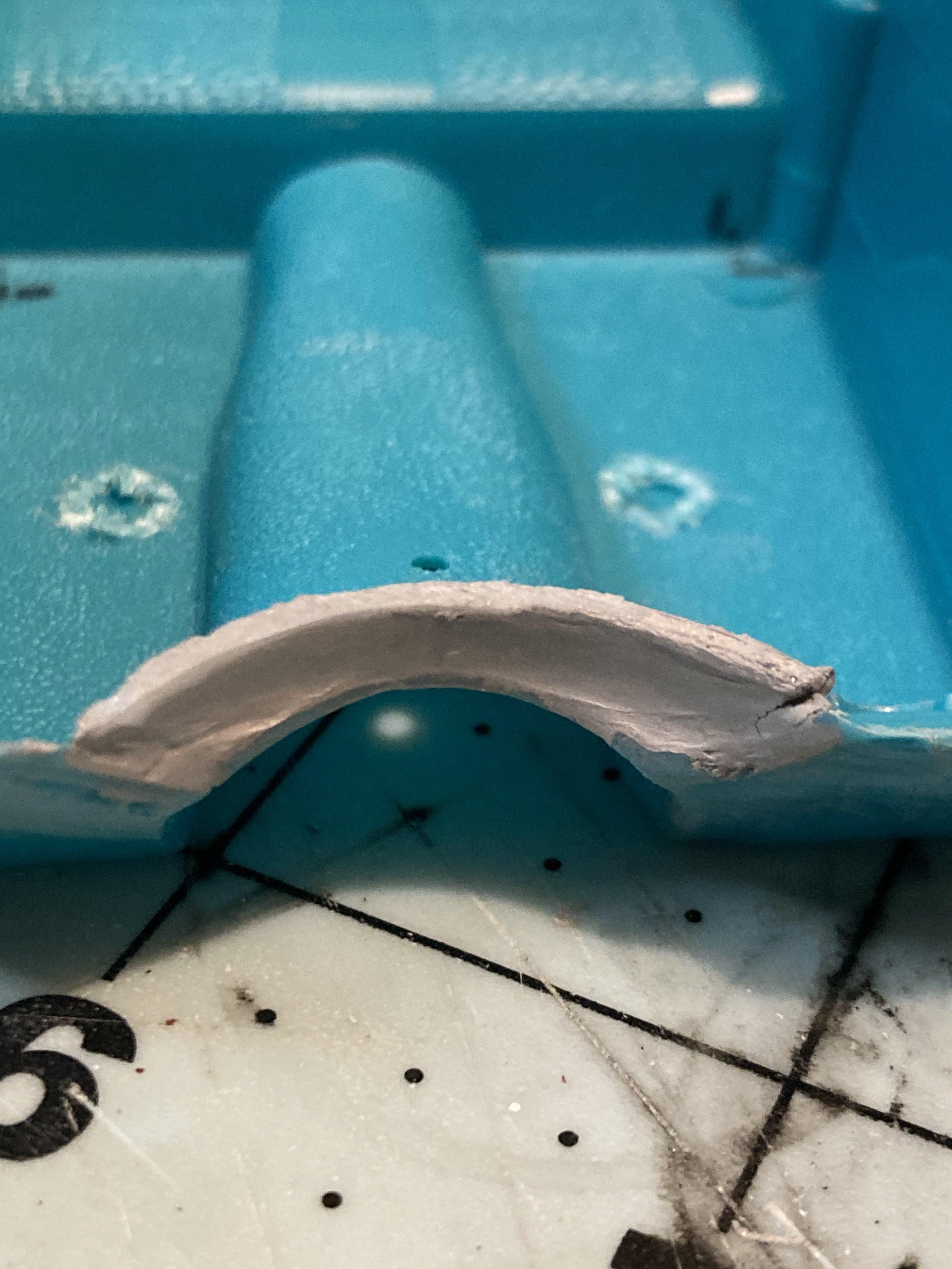

I did some bodywork to allow the Big Block that I plan on using to fit more comfortably. Here, I have grafted in the tip of a plastic spoon to make a recessed firewall. I also grafted in a piece of plastic spoon on the interior tub to mate up with the recess in the firewall Don't worry, by the way, that is not the final bodywork

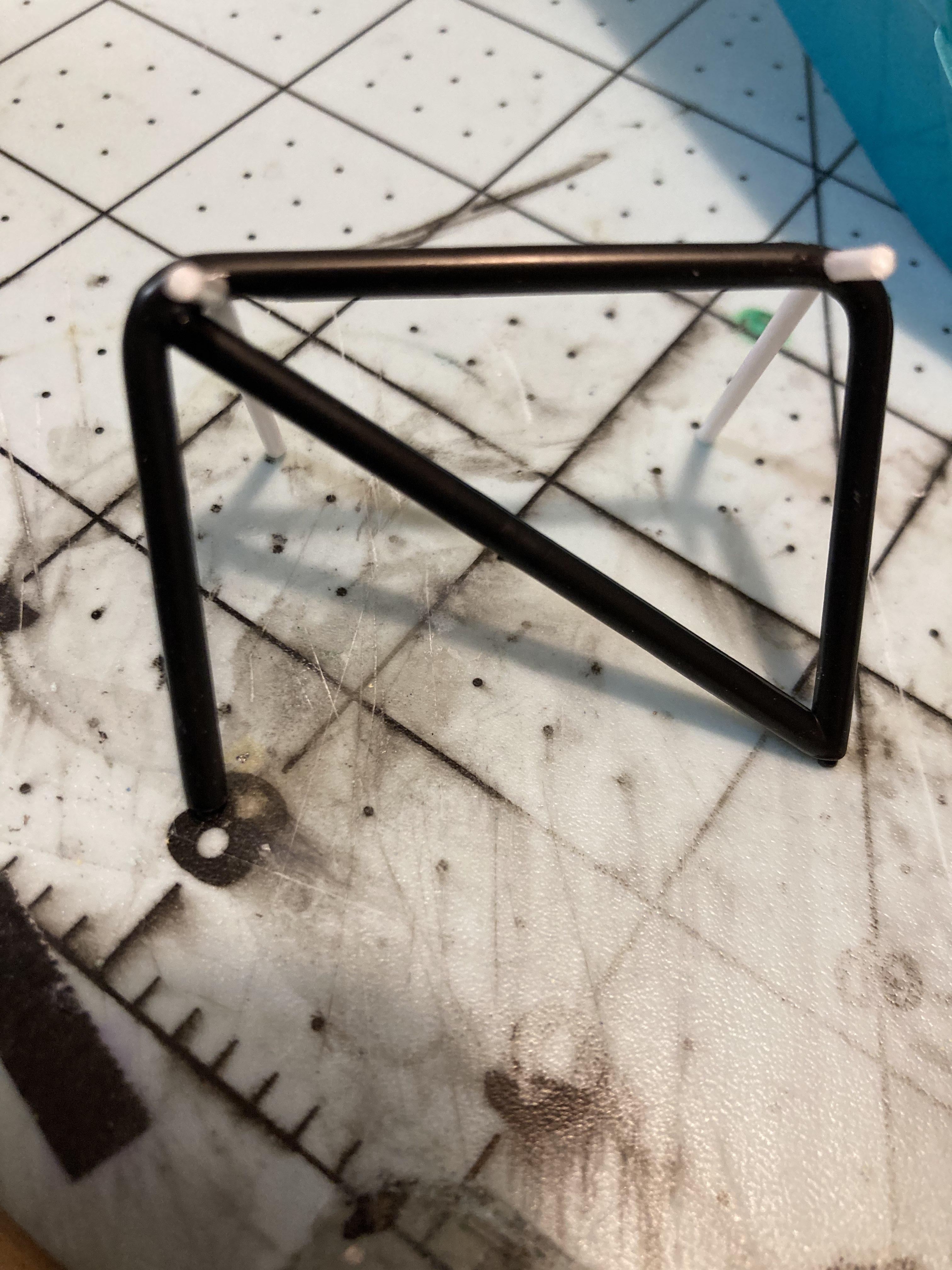

I also have started on the interior Here's the interior tub after I shaved the details off the upper half of the seat, installed the 210 trim and drilled holes for the roll bar to fit into. The bottom half stayed as a Bel Air because I didn't want to sand anymore but for the sake of the story, I'll just say that somewhere along the lines, the bottom half of the seat had gotten torn and ruined, and when the guy who made the car into a gasser got it, he just took the seat out of a junkyard Bel Air. I also removed the posts for the bench seat as I plan to install buckets. These are the seats I plan on using. They're from the 70 1/2 Z28 which I know isn't accurate for a car built in the mid to late '60's but that's what I had and I think they fit the bill. Lastly, I have modified the roll bar from the Old Pro Nova so that it fits better in the Chevy.

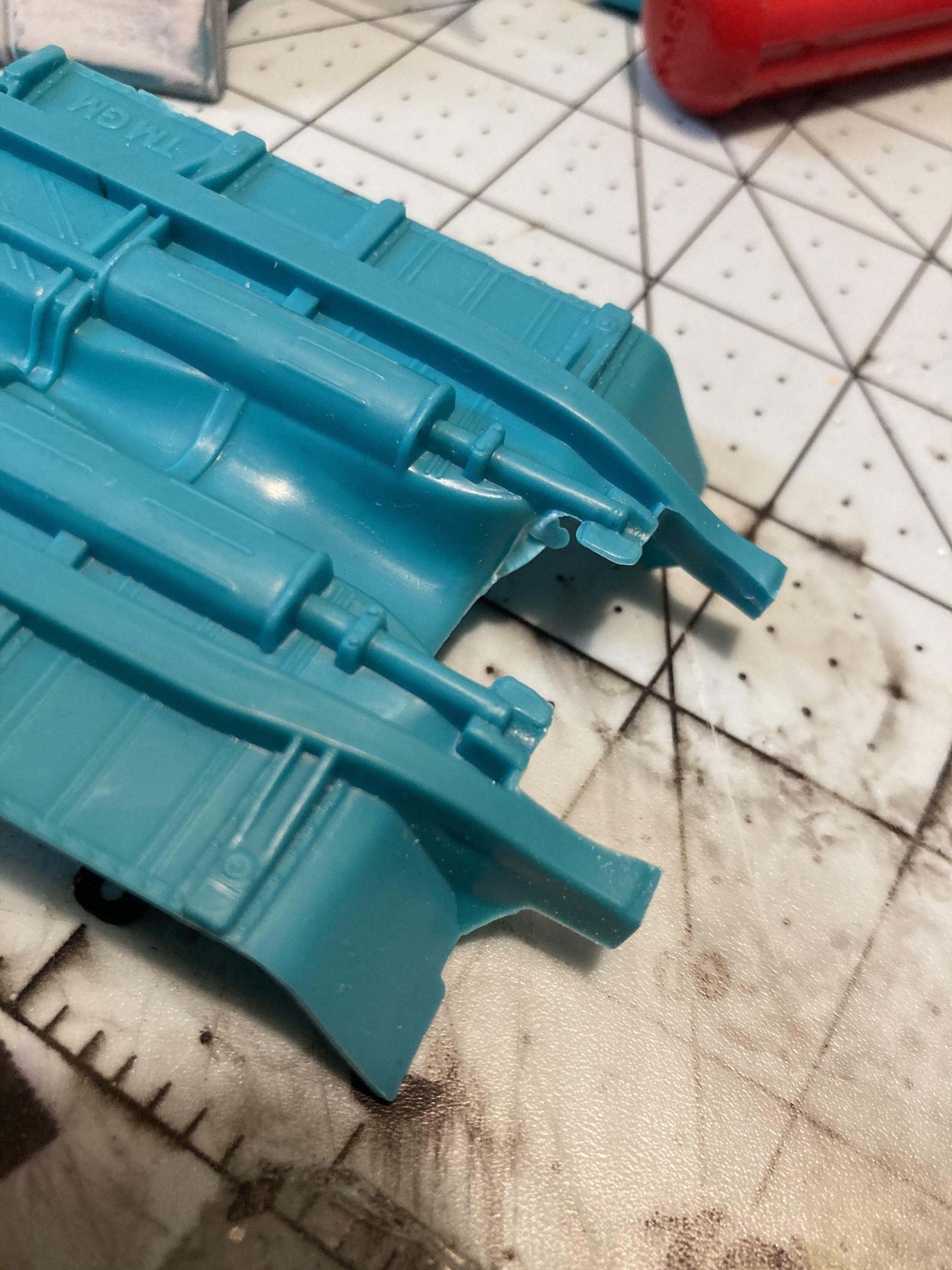

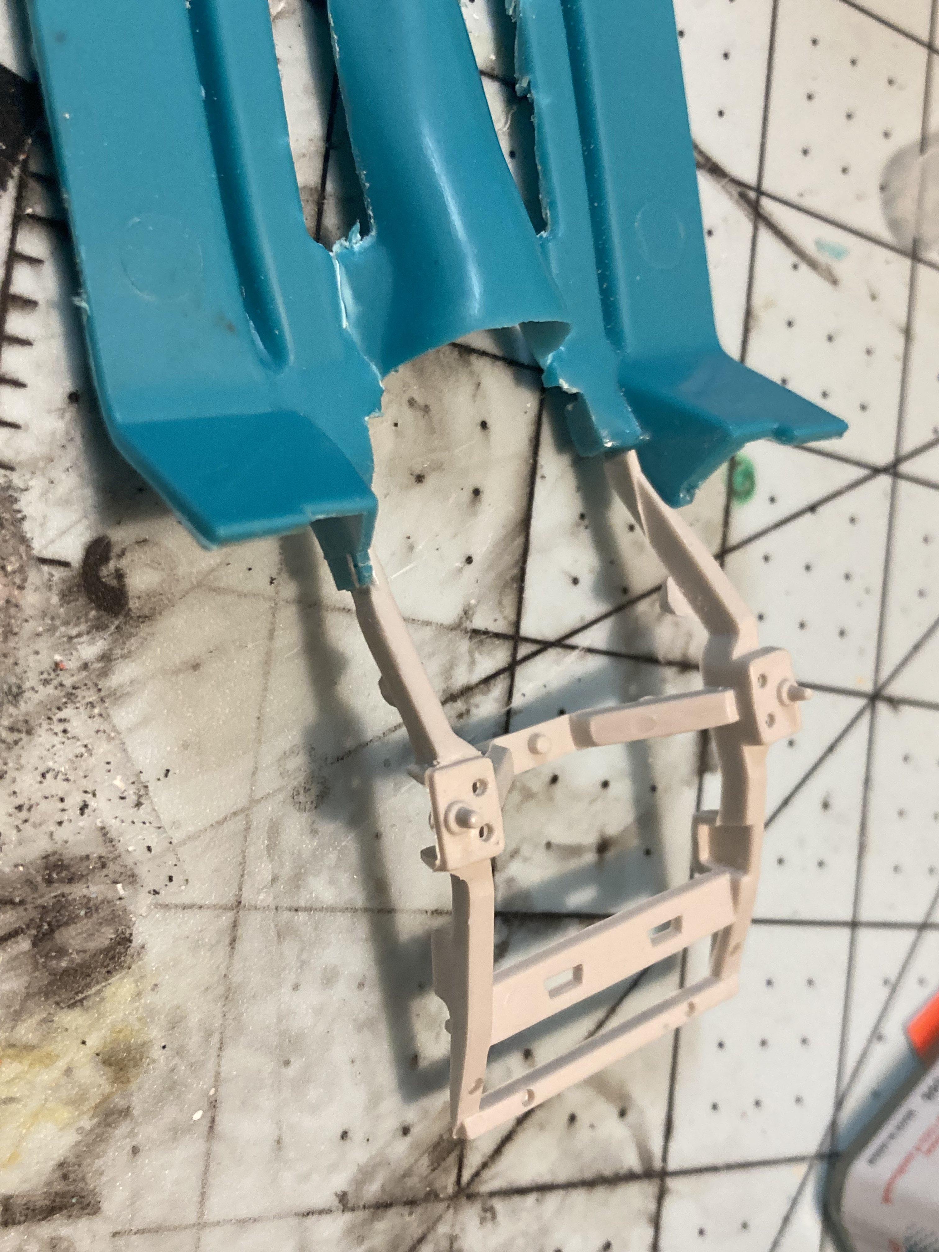

This is the sister build to the other '57 Chevy that I am working on. The first car is supposed to represent a '57 Chevy ordered by a man for his wife as it came from the dealer and the second, this car, is supposed to that same car after being made into a gasser in the 1960's. Anyway! The first thing that I had done was to cut the frame as I had planned to make a new front for it. This was a mistake on my part, I was not happy with the front that I had made for it and after viewing the Flintstone Flyer thread, I realized that I didn't have to do that So, I cut the front off a Nascar Lumina and grafted it onto the '57 Chevy frame. Here is the frame after removing the section that the Nascar Radiator mounted to. You can also see the steering wheel for the stock Chevy.
