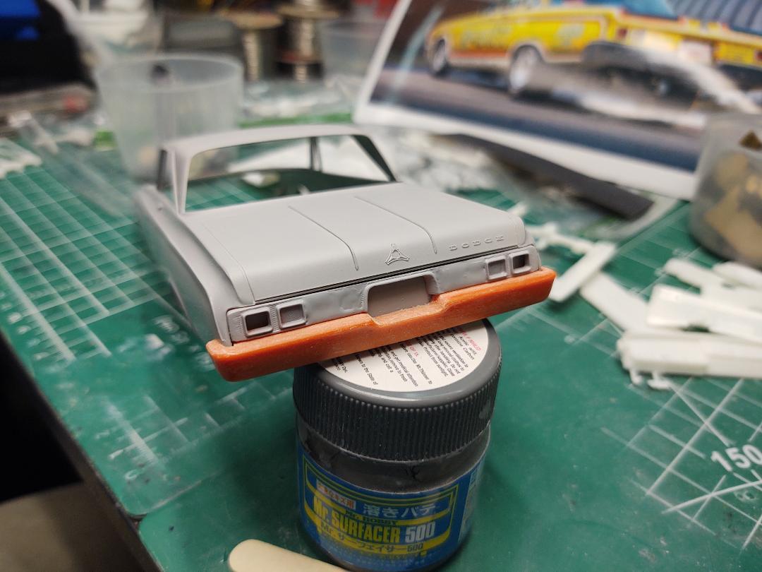

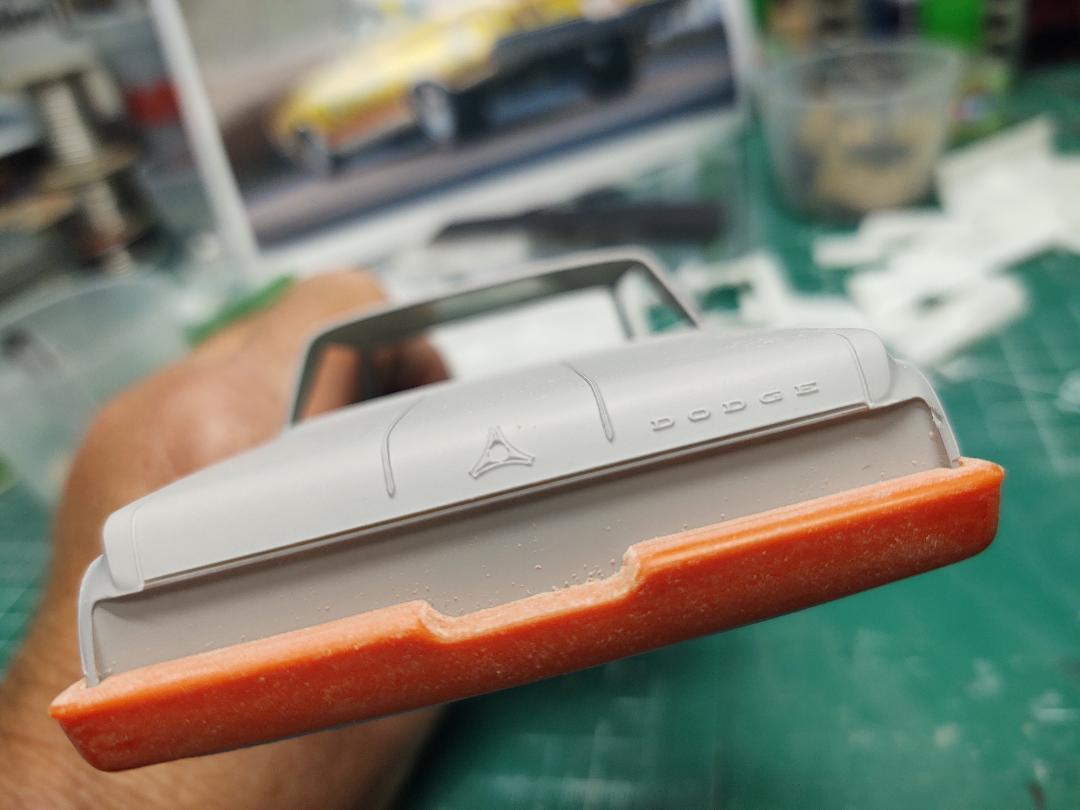

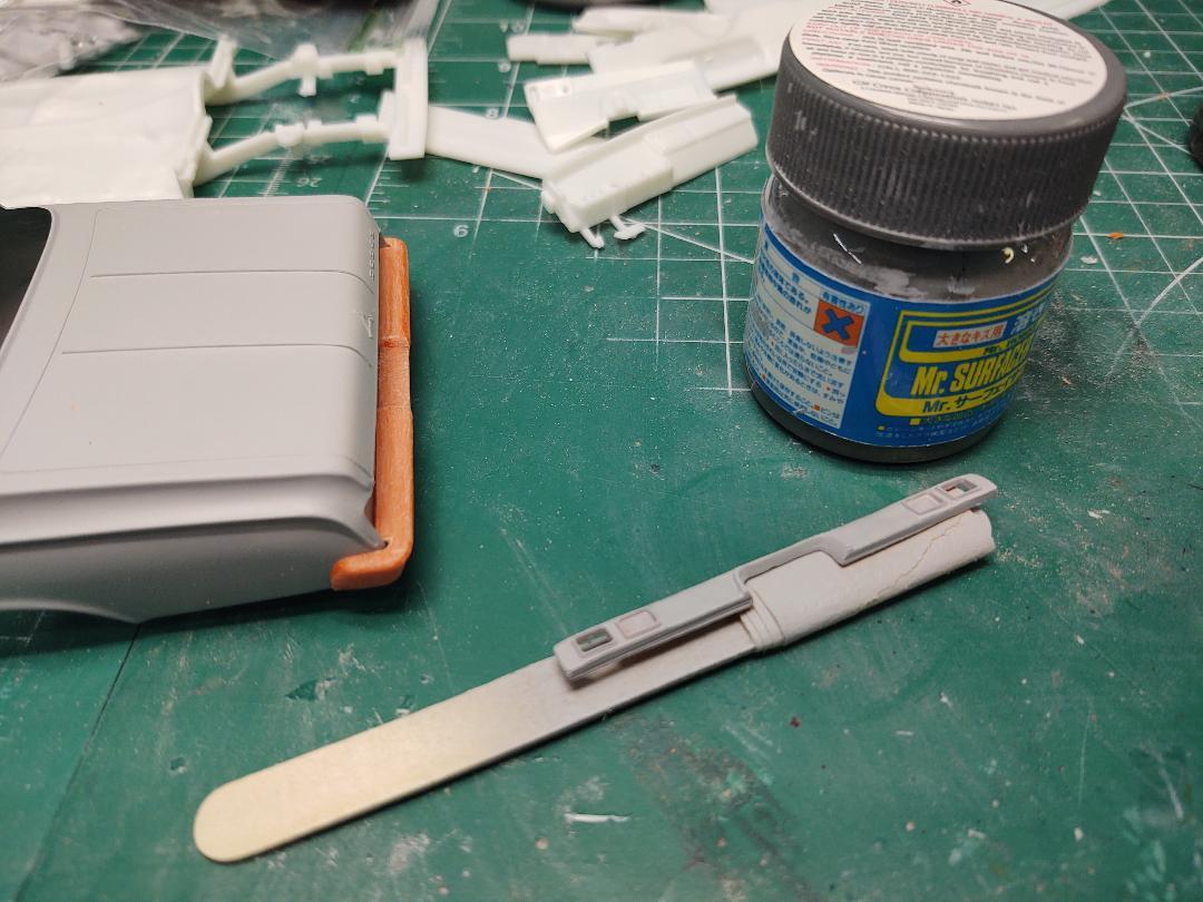

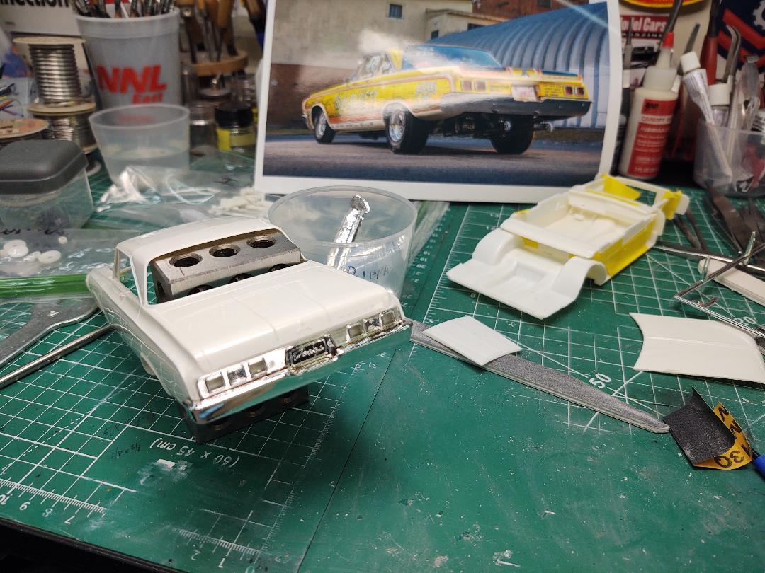

  2. At the bench watching the US Army on parade and...........on second thought,,,lol.......I cut the bumper off the tail panel and filled in the 3rd light ,,, initial filling,,,a bit more sanding ,I'll mask off the red tail and glue the panel on and fill the joint at the rear quarter
  3. Here's the decal sheet from STS.I'm going to make a slight concession with the rear tail light panel ,,,trying to use the Lindberg sedan panel on the Jo-Han hardtop won't fly and since the decal sheet does not have a section or wrap around carry over design to the back I will most likely just paint the light panel with the base color of Pearl White ,chrome the 3 tail light bezels and chrome the bumper

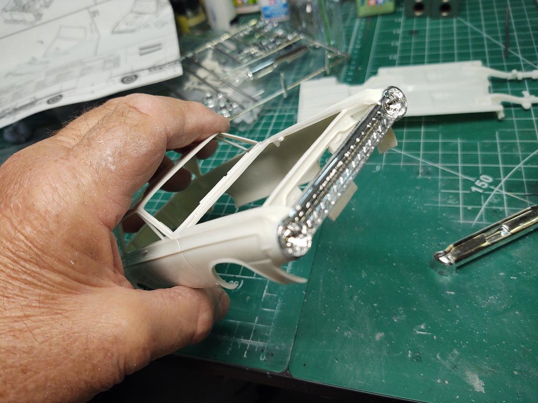

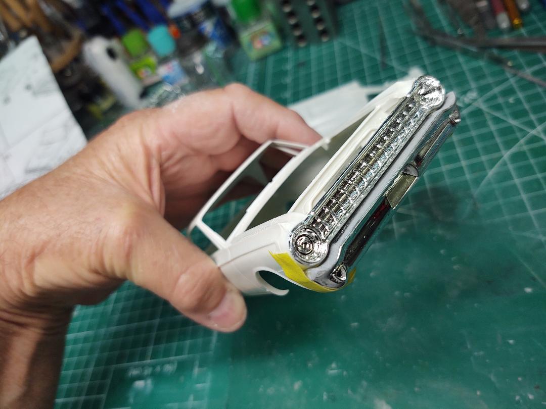

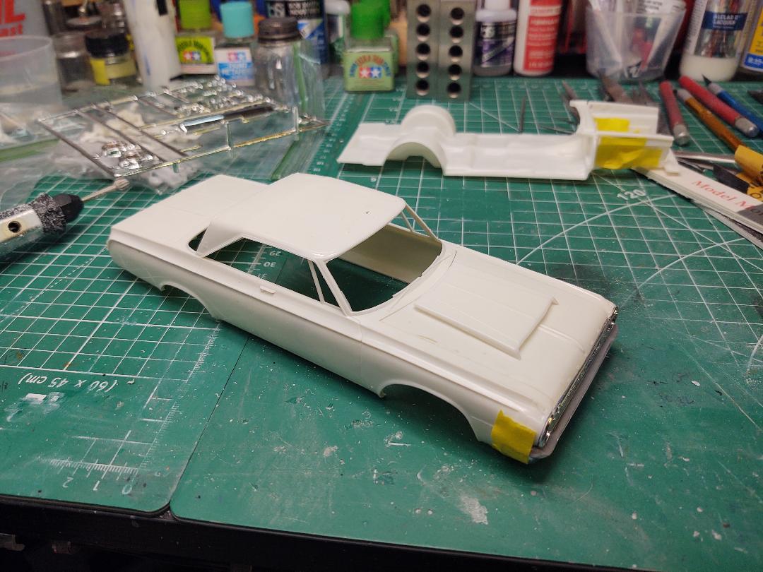

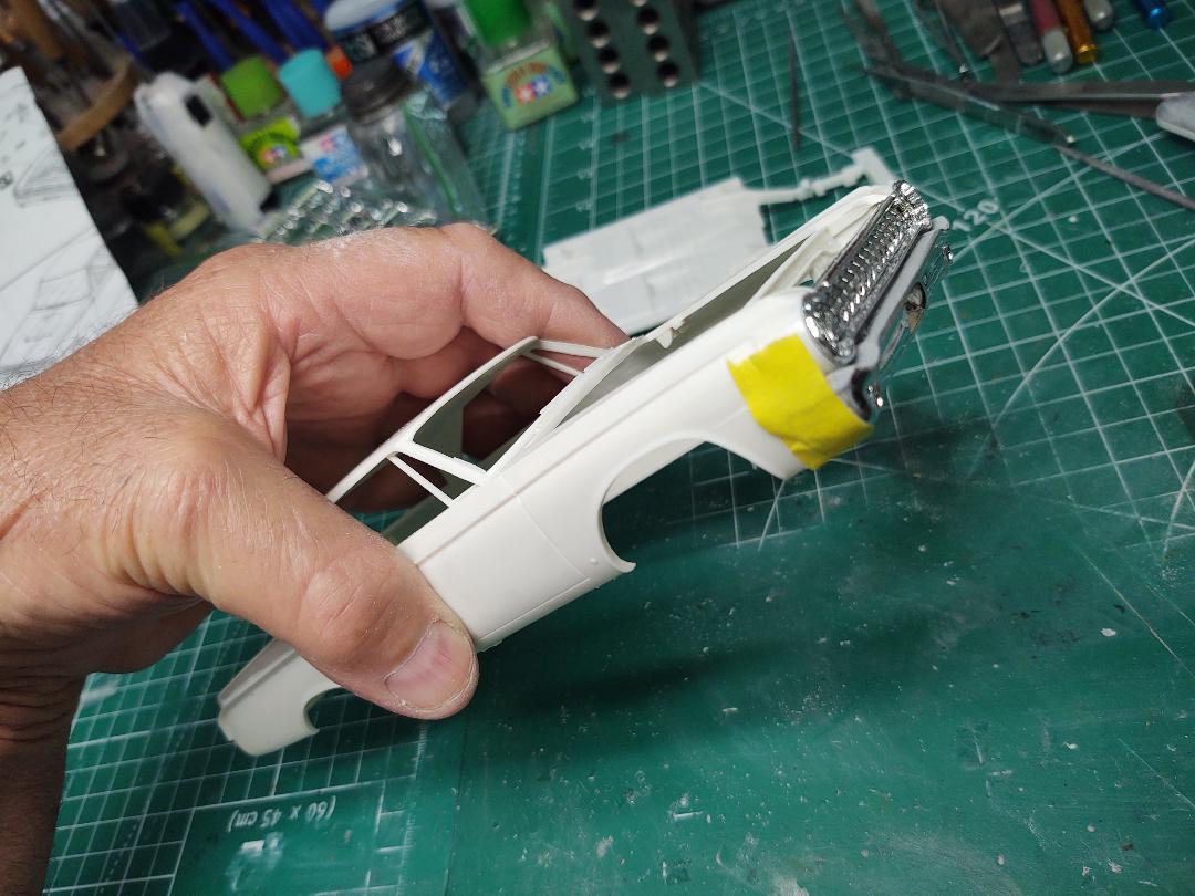

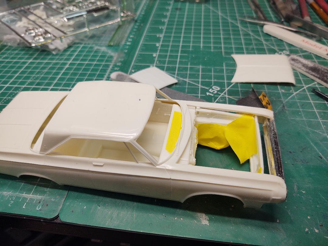

  6. ..............started cleaning up the Jo-Han body,,adapted the Lindberg single headlight grille(cut the bumper off for a better fit) and did a tape up of the Lindberg interior and chassis pan ,,have to massage the door panels and extended the package tray which I figured I would have to do anyway going from sedan to hardtop.All the chrome will be stripped and hit with Revell Chrome
  7. Doing another drag car in between the biggins' ,,,,using the Jo-Han 64 hardtop bashed with a Lindberg 64 sedan ,,,, pics to follow,,,,I've had the decals for awhile now ,,,let's see how this goes

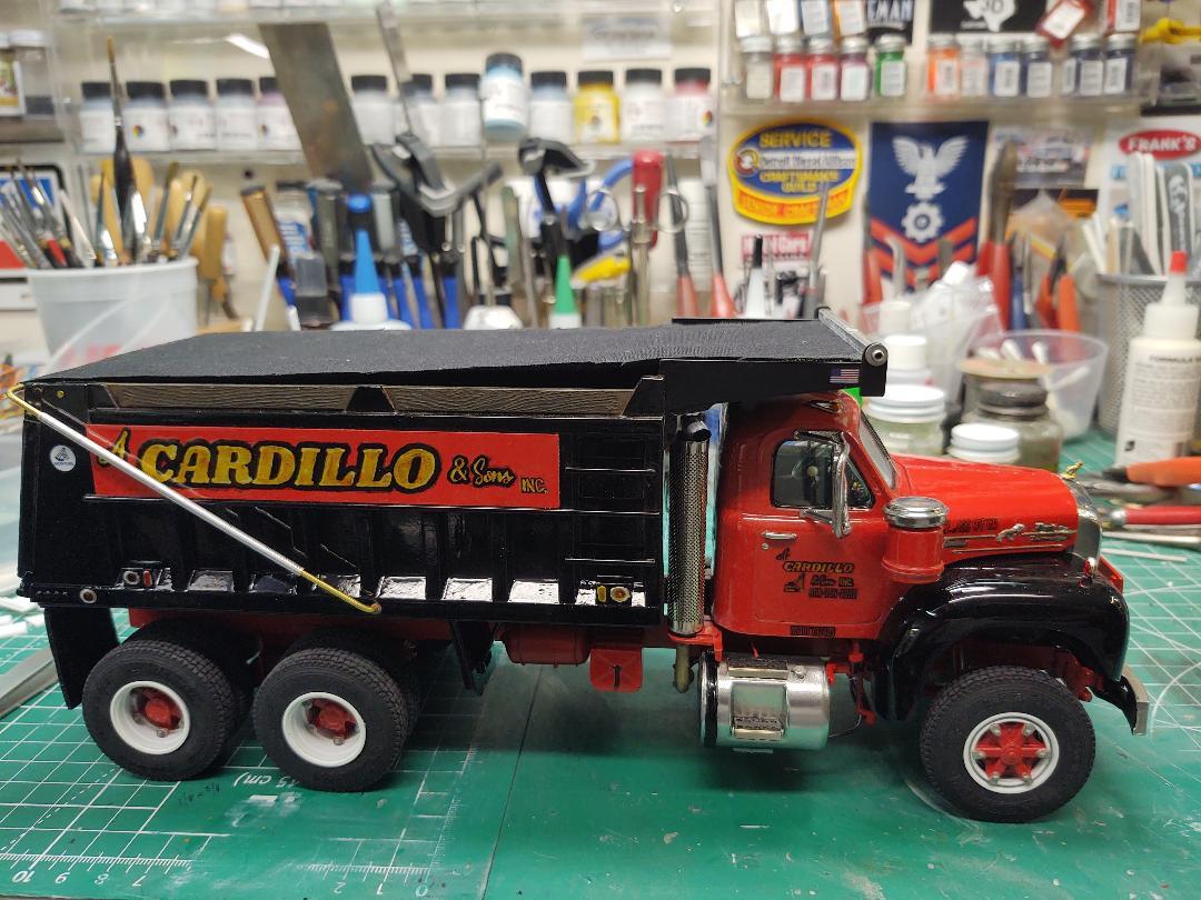

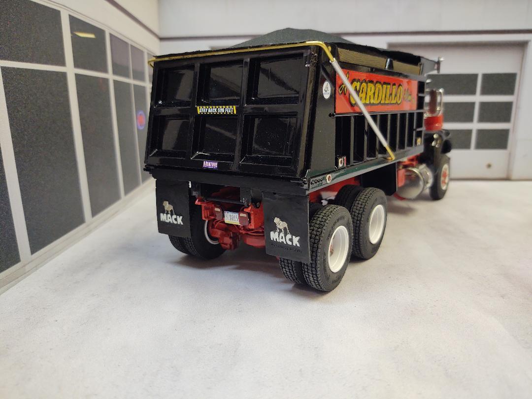

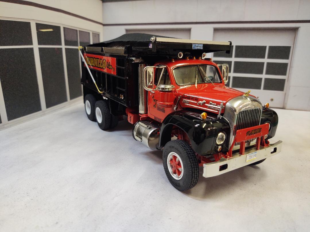

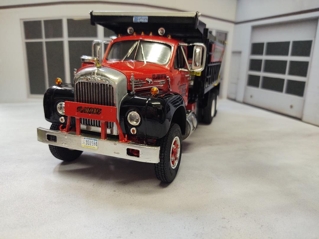

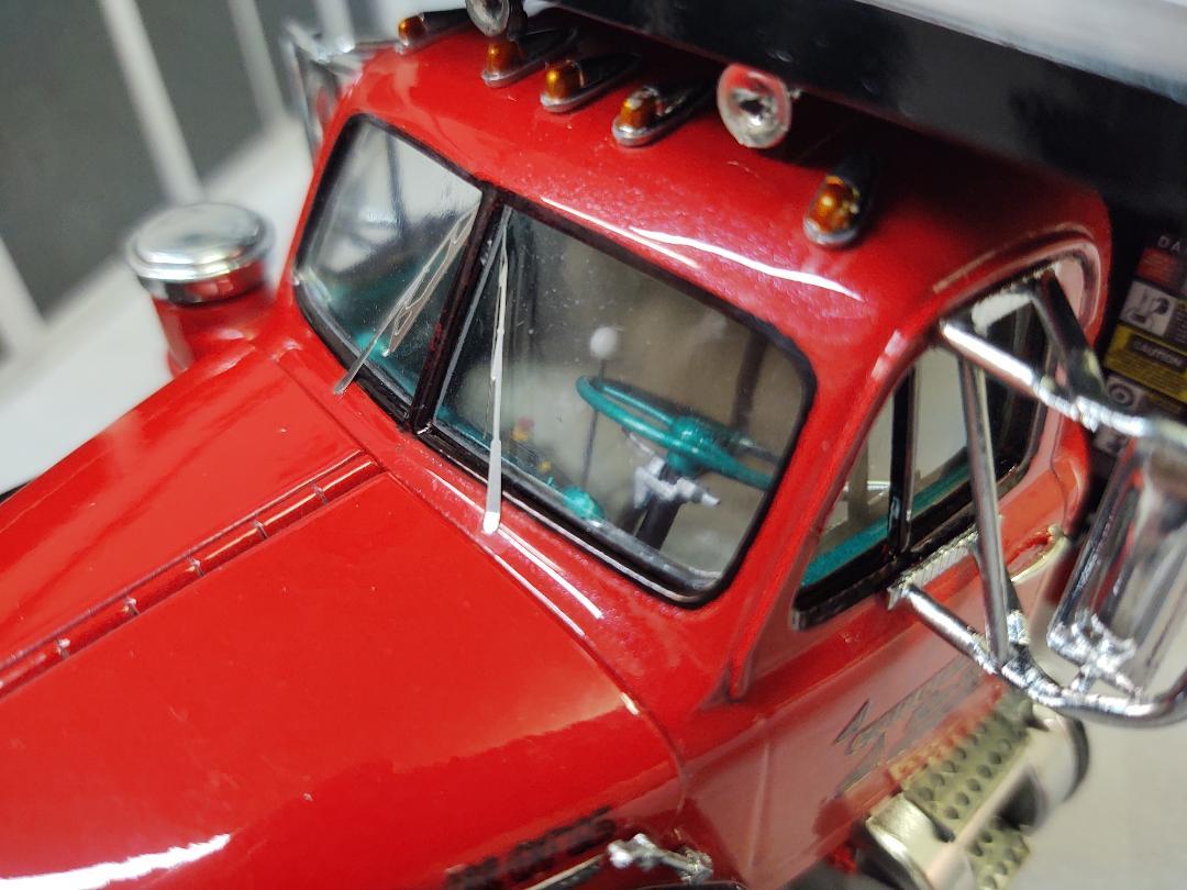

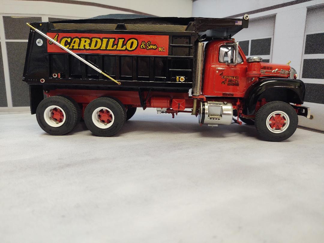

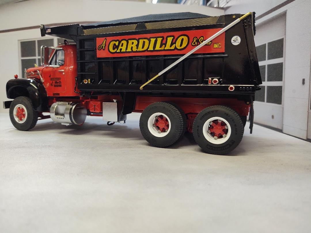

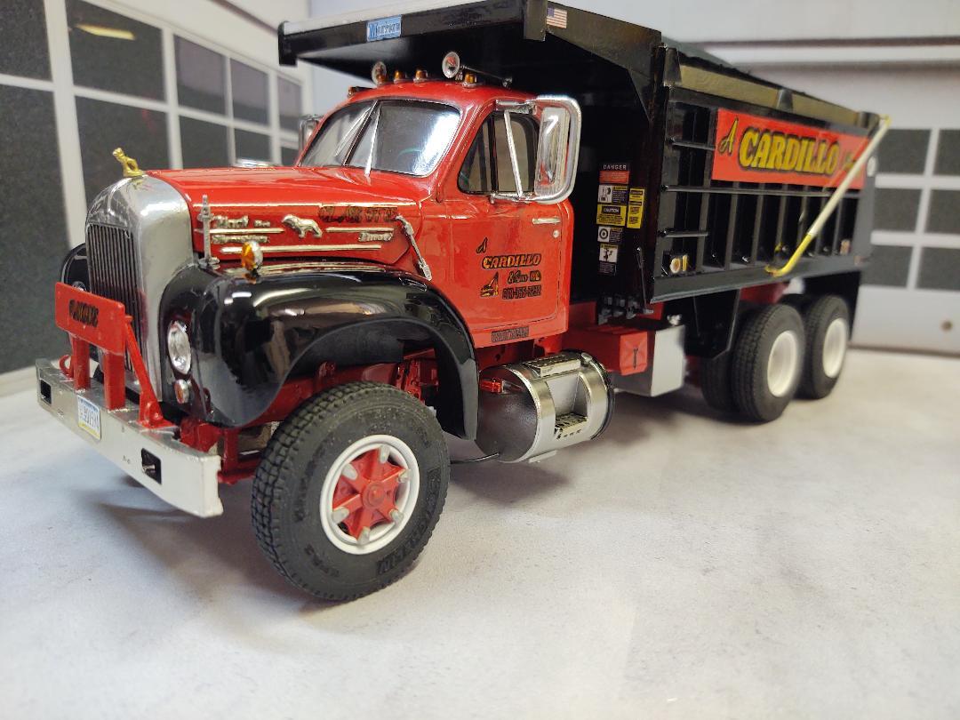

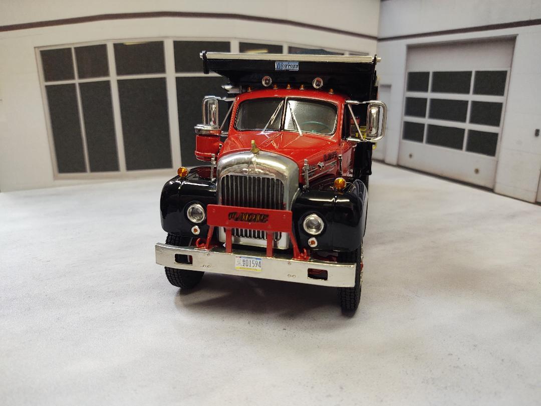

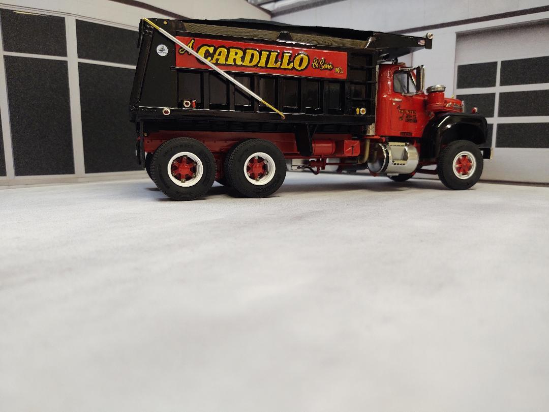

  9. .............on the fence to weather it or not,,,added the stone load,air horns and lights...she's done under glass
  10. That'll look good with the coil loads,, get the CTM chain binders to hold them down!

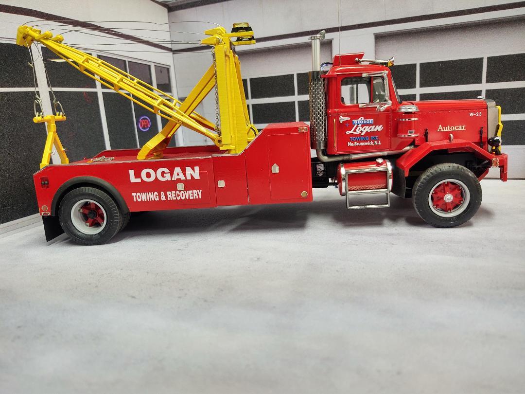

  13. Thanks for the help Warren,,, I'm still trying! Maybe I should try and reach out to Jamie Davis Towing! The boom is not too different than the one on the Revell kit I used for the FDNY truck other than the lift cylinder placement,, I could probably try and get another but that's a lot of $$$$ for just a few usable bits

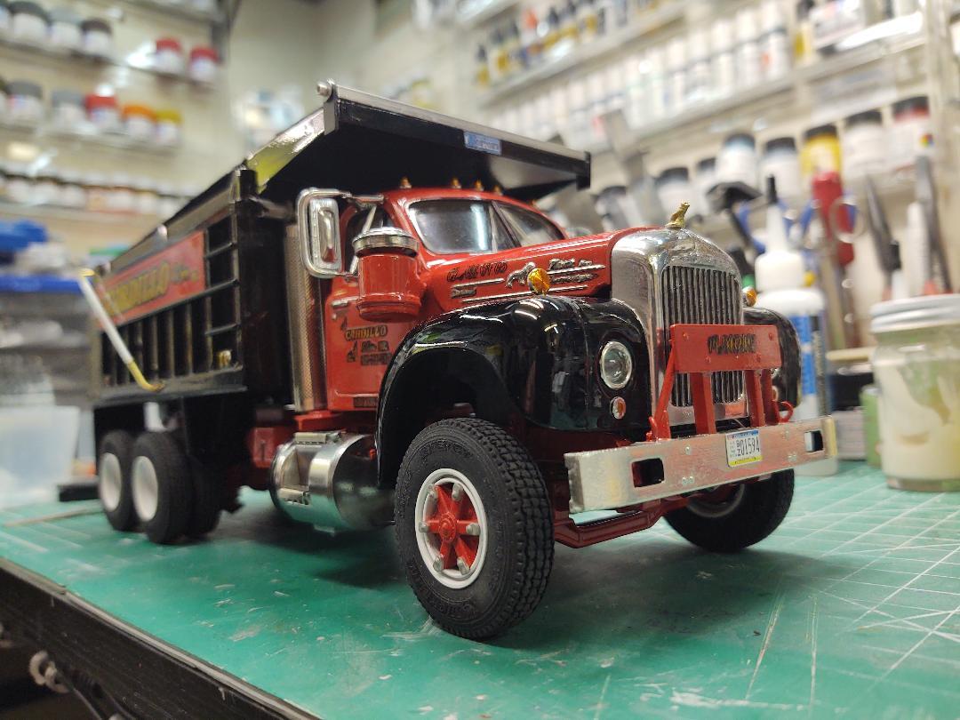

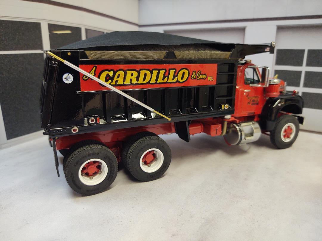

  15. .................getting close,I did a tarp deal,similar to the Earle Asphalt Reo dump I did,,I'm going to put a crushed stone load in it using HO train ballast from Woodland Senics ,have to make a false bottom,waiting on some air horns from STS Paul ,got the cab markers,front signals and rear taillights and mudflaps on ,,,a few more odds and ends to do

  18. Just that same one here's some pics of another 1801 ,,they didn't build a lot of them,,they came out right before the switch to all hydraulic/under reach lifts / rotators
  19. THE FDNY truck was semi-scratch / kitbash of the Revell kit
