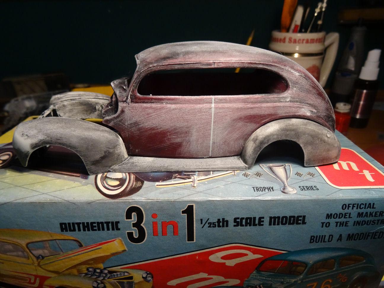

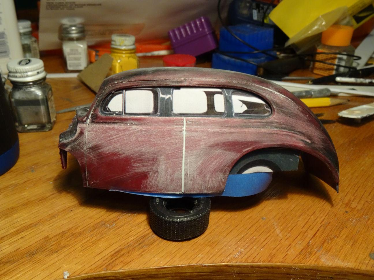

Had to get something done on the 40 this week. "B" pillar has been removed, so have the door handles and the side trim. Also the door seam has been welded shut. Now if this next photo looks a bit odd it's because I took that photo of the 40 Fordor from up above and scaled it to match the body of the kit. Then I cut it down and inserted it inside the body. Sort of like Lionel passenger cars when they had the cellophane windows with the silhouettes of passengers. Well, not exactly as there isn't anyone sitting in the car. Sorry, I digress. No, actually what I am doing here is figuring out where to place the new "B" and "C" pillars. You can see how much the "B" pillar needs to move forward. I was hoping to have more done at this point but I'm waiting for some styrene strips that are in the mail. Hopefully the USPS does there job and I can move forward on this. 'tll then Happy Trails.

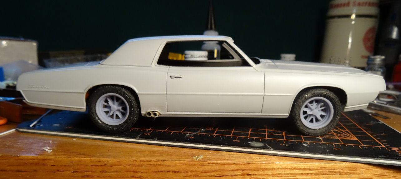

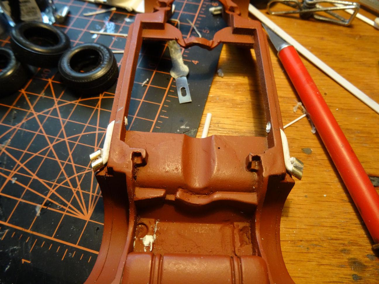

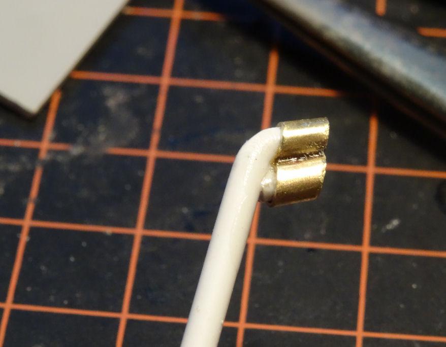

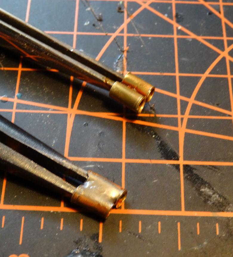

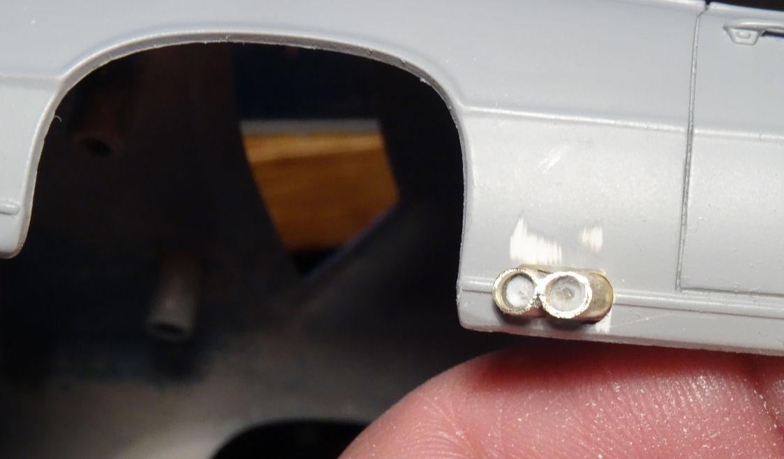

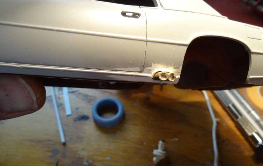

Time to figure out this exhaust. To work up the side exit I decided to go with dual pipes out each side. Started by taking some brass tubing and soldering two short pieces together for the exit pipes. Then with some styrene rod I fabricated the pipe leading up to the exit tip. These are going to run down the side of the chassis then through the frame rails. Eventually there will be two mufflers with both the inlet and outlet pipes facing forward. Trying to poke the pipes out the side of the rocker left them right smack dab through the chrome rocker trim. Decided to take the trim and go up and over the opening. Initially was considering going all the way around the opening but it just didn't look right. Had thought about removing the trim completely but leaving it for now. And here is our mock-up. What do you think?
