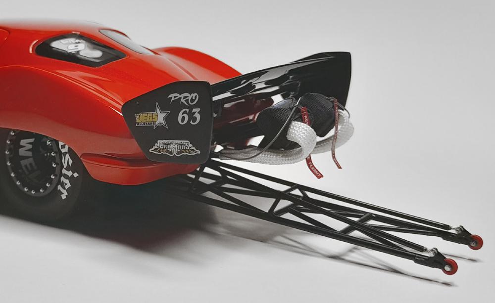

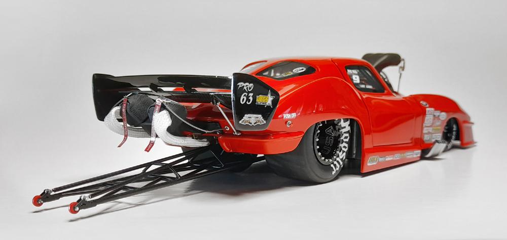

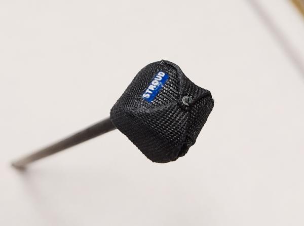

  1. Thank you all! I have about 2 ½ month to finnish this one... so........yeah... Brake shute made from bandage tape. Yepp, it´s gonna be red /Rick

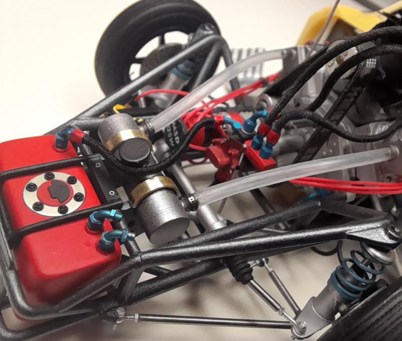

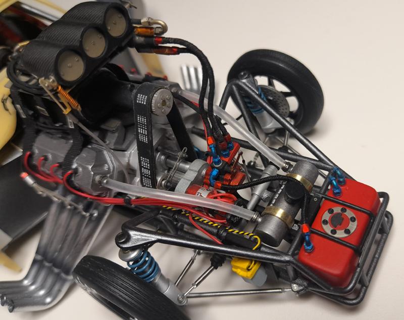

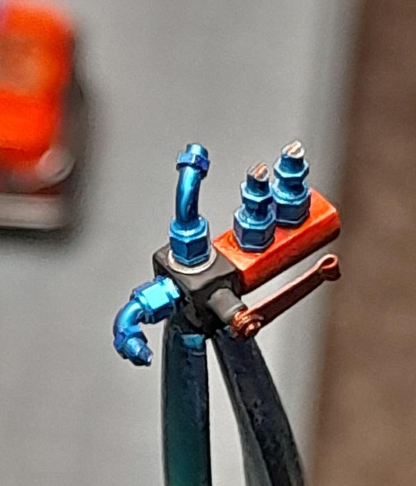

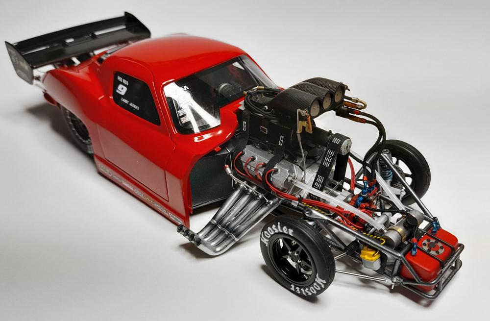

  2. Hello friends! This project has been on halt for some time now, but I have made some small progress over long time now, so there will be an larger update soon. This headers was scratchbuilt from evergreen tube and electic installation cable. /Rick 🙂

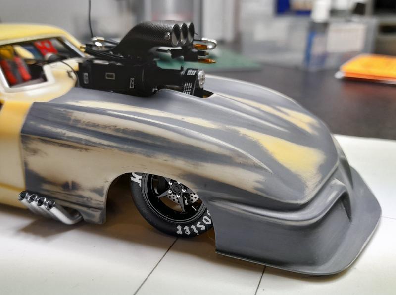

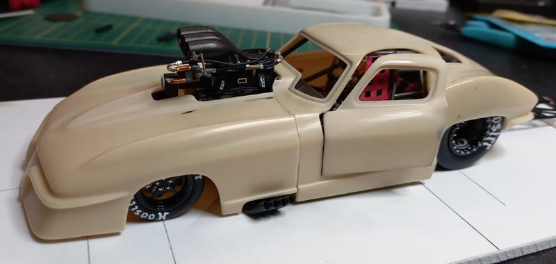

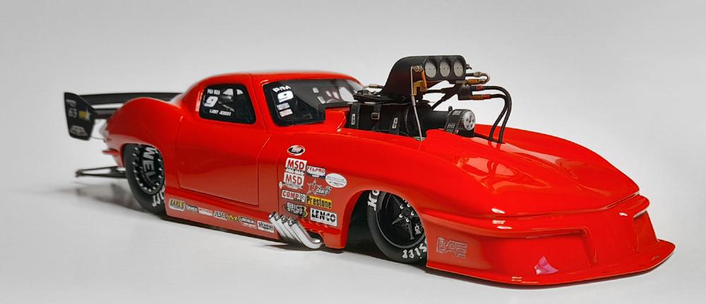

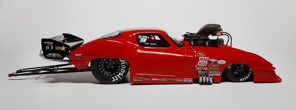

  3. Thanks for the comments! Here is a quick mock up with body! Not the best quality on the pics, but u got the idea. The stance feels right! /Rick

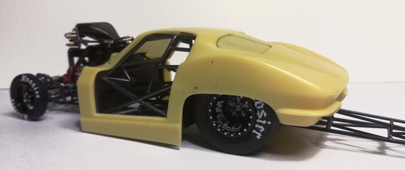

  4. yes, I´ll do that! Both rear wheels are now glued in place. The epoxi must cure over night first. /Rick
  5. Thanks for your comments guys! Today I recived some fine small parts in my mailbox Finaly I can finnish the rear wheels! thanks for looking! /Rick

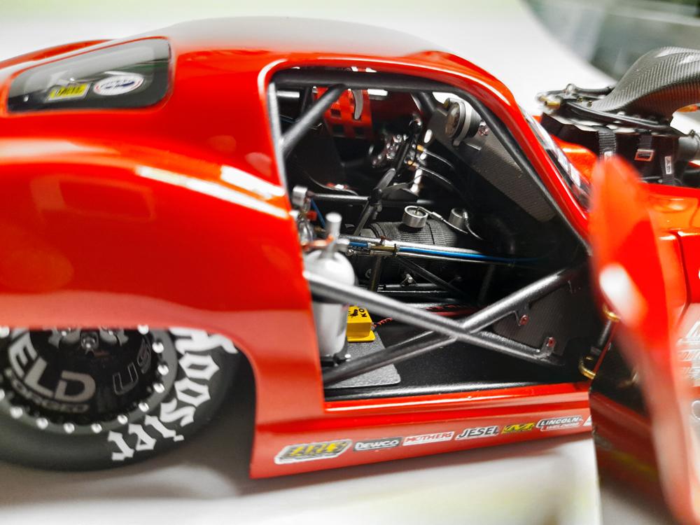

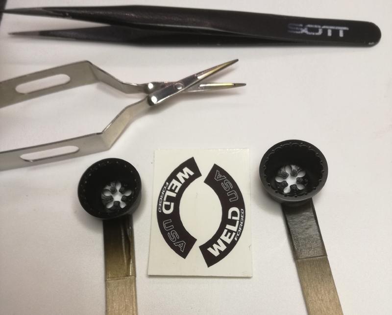

  6. Hi all! The "Weld" decals was not easy to make. I decided to buy a cheap ink jet printer and a package of withe decal paper, and from there try to make my own custom decals for the wheels. I made the design in Corel Draw on my computor. This is how they turned out. /Rick

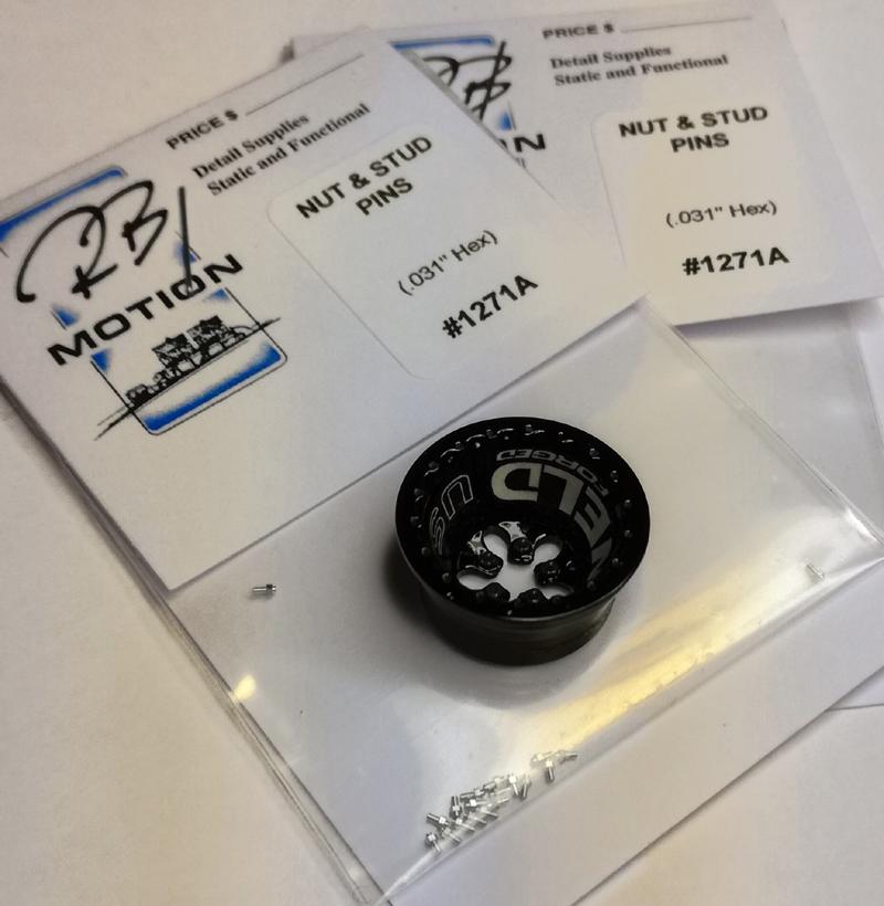

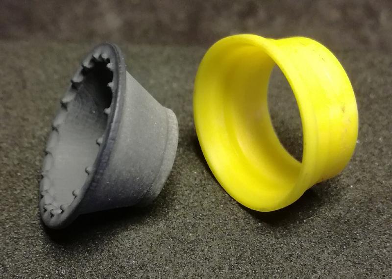

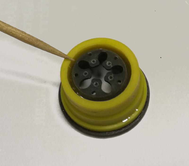

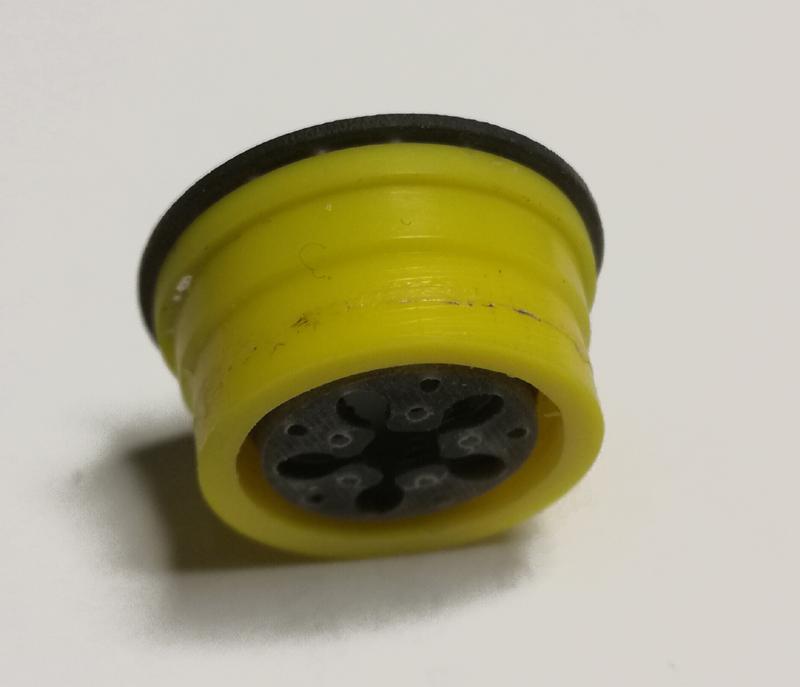

  7. Tim: You´re right, those printed parts are extremley fragile. I broke a small part off when I was removing the sprue...no big deal, it does not show... I thought I must make the wheels stronger. Another problem was the conic shape, it did not fit the tyre at all...it sort of rolled around in the hole, not good. So, I had to solve those problems. I found four Penzoil pro stock rear wheels im my sparebox. I cut out the center and sand the inner side a little. Then I glued the Deltas in the rim. To make the wheels stronger I filled the gap between the rim and the printed part with epoxy. After a light coat of primer I sanded the surface very carefuly. I sanded off the beadlock bolts and drilled holes for new aftermarket bolts. Another primer coat, and it looks like this. /Rick
  8. Thank you! If using this Weld Delta 1 wheels, the decal are most important. You naild it! ? /Rick

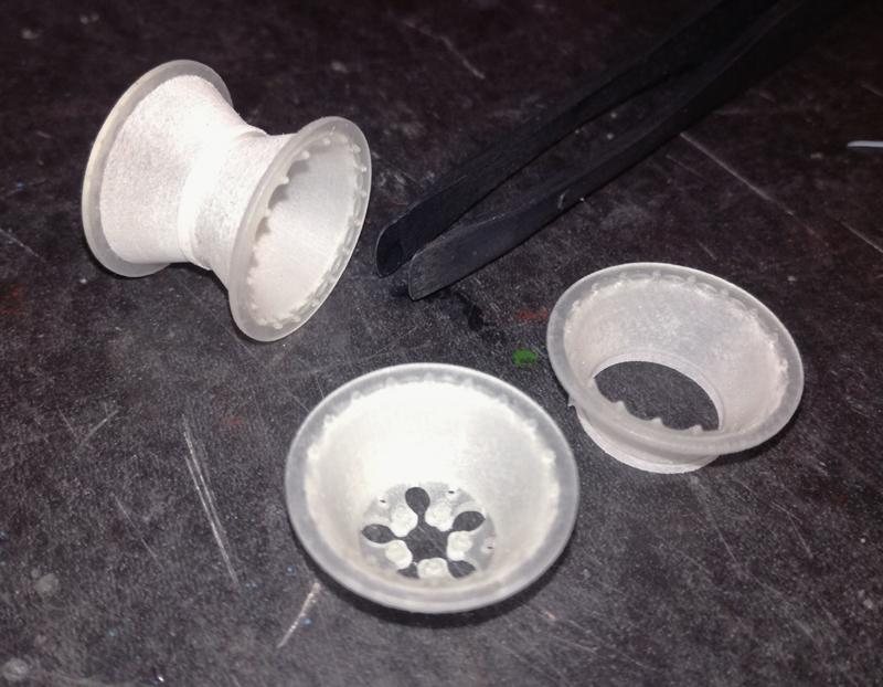

  10. Wow, those wheels looks truly amazing!! I recived a package from Shapeways today. the 3D printed Delta-1 rims looks really good what I can see. They are printed in a milky-clear filament or resin...I dont know. /Rick
