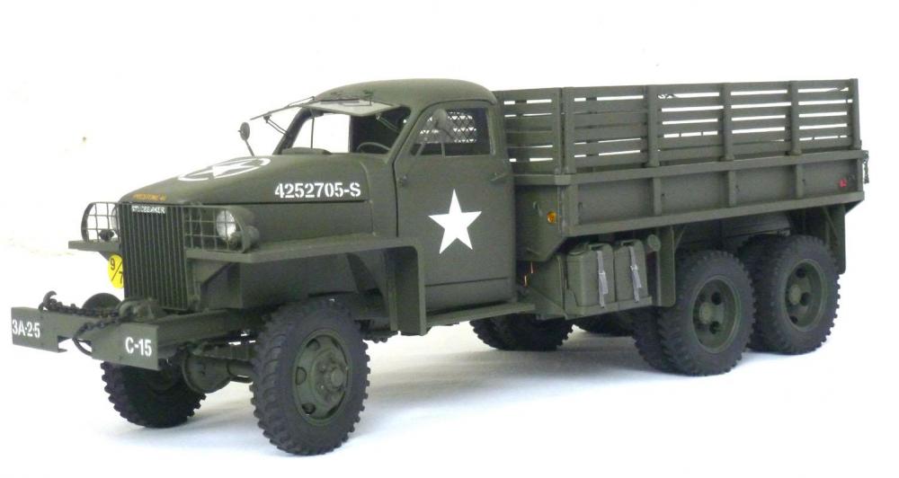

STUDEBAKER US6-U4 by Oleg Malakhov
Sergey replied to Sergey's topic in WIP: Model Trucks: Big Rigs and Heavy Equipment
Well, It is not my project. This 5 STUDEBAKERs were build by two men: Oleg Malakhov, who made it Alexandr Bushuev - sponsor and producer of project. As for the price you better ask him. Here is the e-mail of Bushuev: oldavto@yandex.ru Here is his facebook: https://www.facebook.com/oldavto He said: "One of 5 STUDEBAKERs goes on exhibition in America" Three of them can be bought. Two other for personal colection of authors. By the way, the scale is 1/18 -
Sorry Guys I was busy lately and couldn't analyze how new forum work. Model is 1/18 scale. Two of them are for creators personal colection. Three more are for sell. Here are the photos:
