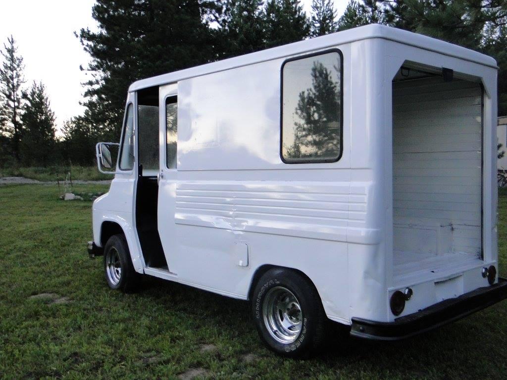

  20. I'm attempting to scratch build an International Harvester Metro Mite in 1/25 scale. A Metro Mite was used in the 1985 NBC TV series, Misfits Of Science as an Ice Cream truck. This is the version I want to build. The show is a favorite of mine. I picked up a Metro Mite Brochure on E-bay that had the specs and dimensional drawings. I started cutting out the sides using .060"(1.5mm) sheet styrene. The lower sides angle out so I'm experimenting with ways to replicate it. I would like to make the rear door roll up and I'm considering making the side doors slide open. However the doors curve out below the windows and I'd have to make the lower sides of the body curve out not only on the outside but the inside as well. The ice cream truck was only seen with the side doors closed in 2 shots in the pilot episode and the rest of the time they were open so I'm considering just making them in a fixed open position. This would solve some problems and make it easier. In the pilot the freezer unit on the roof was taller than the rest of the series so I might make it removable so I can use both. Does anyone have ideas on how to make the angled out lower body/sliding doors? I posted pictures of one test I did for the lower body. It will require cutting out the lower part of the side wall and gluing in the angled section. Another option would be to add an angled section on top of the side wall using thinner sheet styrene than I have in the picture. I appreciate any ideas and/or comments anyone can share. Thanks, Michael.
