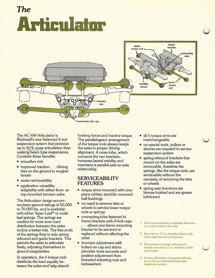

The suspension in the Autocar dump truck kit is made by Rockwell and is not exclusive to Autocar. The axles are also Rockwells and could be found on Autocars, Kenworths, Peterbilts, REO, and as a rarely sold option on International trucks as well. The weight rating for the axles was 38,000-58,000# while the suspension had a weight rating of 50.000-70,000#.

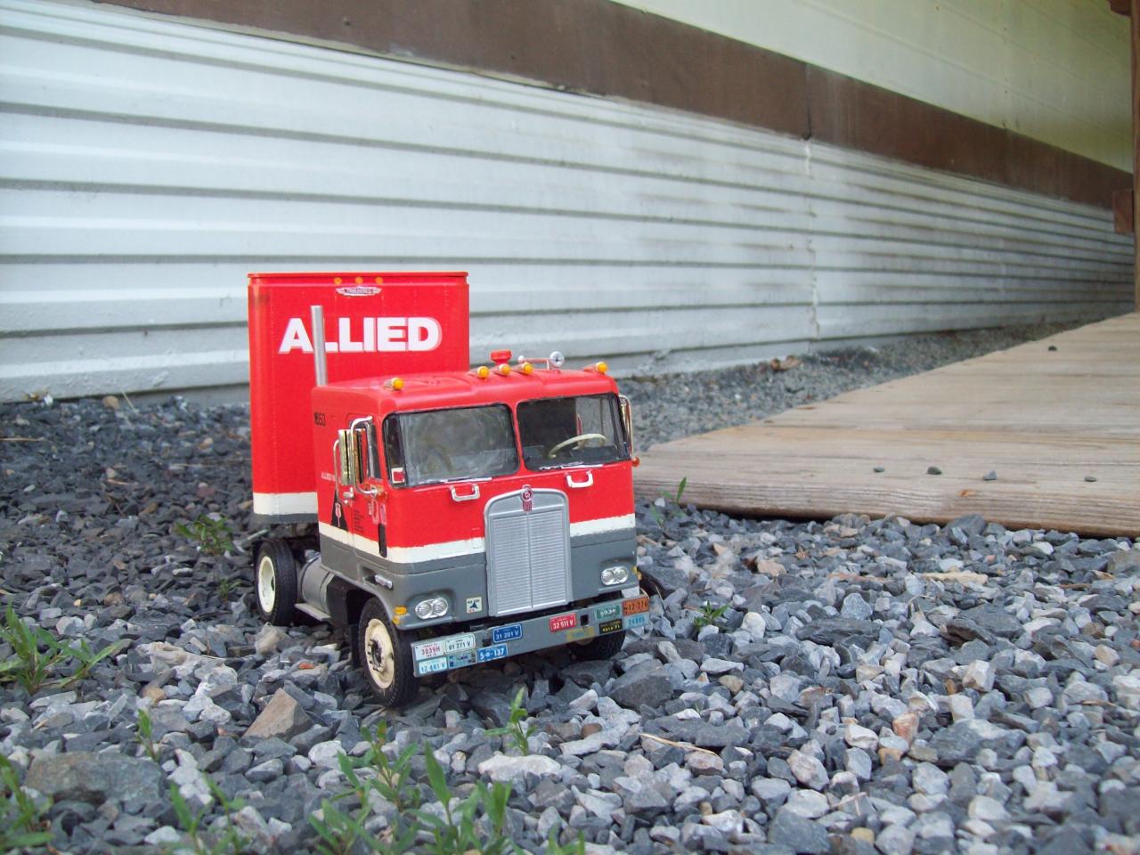

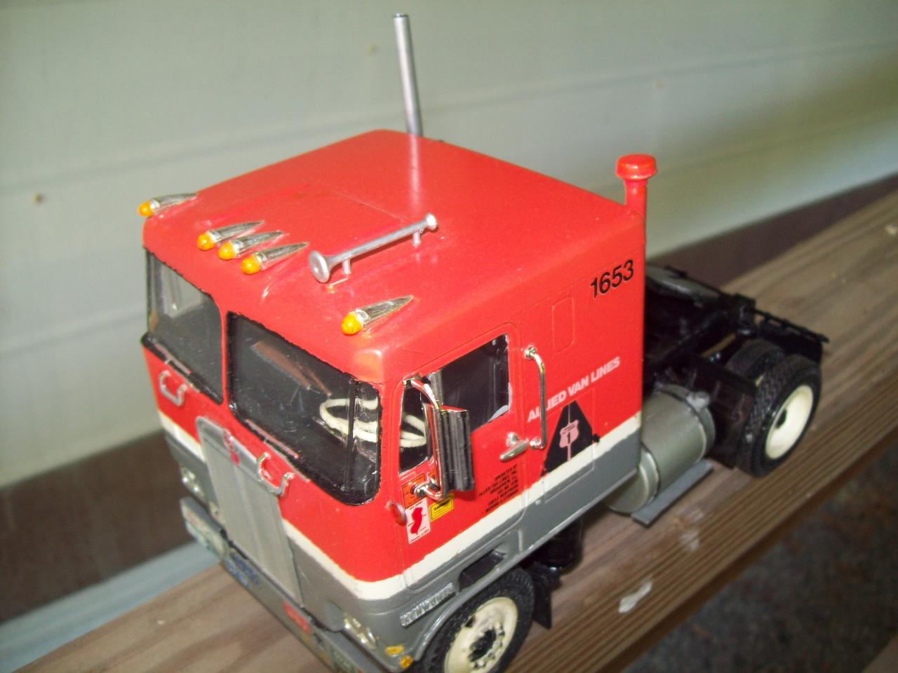

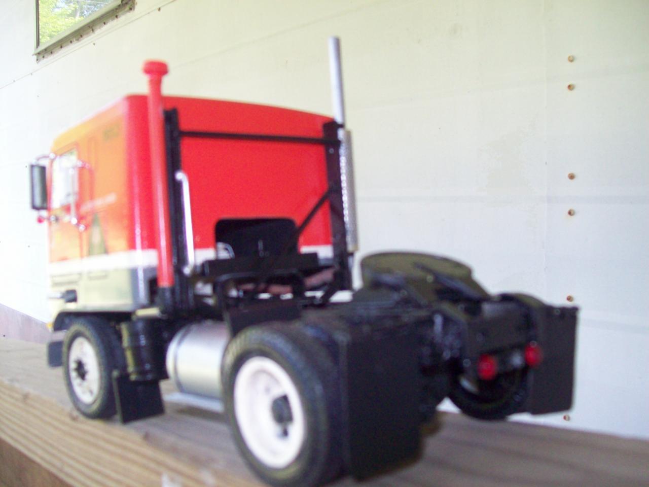

I'm calling this little moving van done. The trailer is a box stock restoration of a built up I bought on ebay. As to the tractor, it was a combination of a K123 I built and scrapped many years ago and a fresh K123 kit. I made the following modifications: The frame was shortened to a 130" wheelbase. The kit's engine converted to a Cummins NH 250. AITM 2 hole Budd steel wheels. Brass exhaust shield with aluminum tube stack. Scratchbuilt driver's step. reduced size air cleaner with srcratchbuilt piping and stack. Air line and engine details. Shortened fuel tanks. Conversion to single exhaust.
