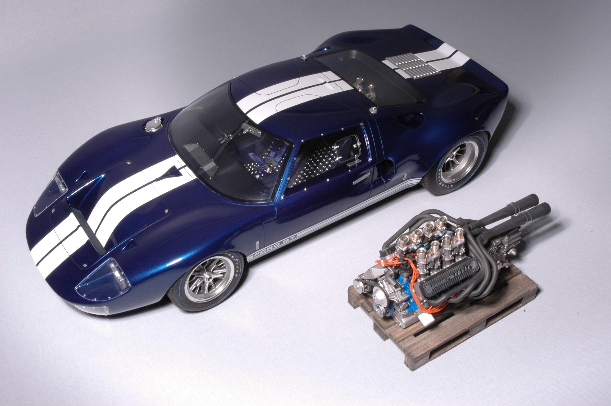

  19. Alright you convinced me - I'll look into producing the Can Am version and make it available at Model Builder's Warehouse. Just gimme some time.
  20. Thanks for the kind words everyone! Gramps, thanks for the photo, in color too! Wish I had been there to see and hear those run. About selling copies: I guess since this is a very special engine a stock version (single Holley?) would be of more use to you guys? I would suggest a "block only" version, without headers and gearbox, that would keep pricing much lower too. What do you all think? And if you have any pics of the engine out of the car please show 'em!
  21. Hello everyone, can't seem to find the time doing 1/8 work, so here's another one of my 1/24 engines. As usual, no attention to color, wiring etc, simply made of printed parts with no finish other than an overall thin layer of silver. It's a real beast this one, the only time Ford tried to win something in the Can-Am using it in the G7A with Andretti driving. He said he couldn't reach forward to shift when the torque came on. If you notice any mistakes I'd be glad if you tell me since the 1/8 version is still in the builds. I need all the input I can get since pics of those engines, especially of the front and underside are really rare. I did the entire 3D modelling myself this time, only having some block drawings from a nice guy on a forum and some photos. Was a blast, especially those "knuckle" rocker covers! Hope you enjoy it too! Thanks for looking!
  22. Hello, just wanted to thank you for buying not one but two of my GT40 engines. Especially when you had to pay the higher price due to shipping etc. You're right about this engine being used widely in racing, you can get a 4-Weber version from Model Builder's Warehouse now and I'm planning for a Holley one. I'm really sorry for not adding instructions for assembling the headers, it's really a tricky thing but can be done:
