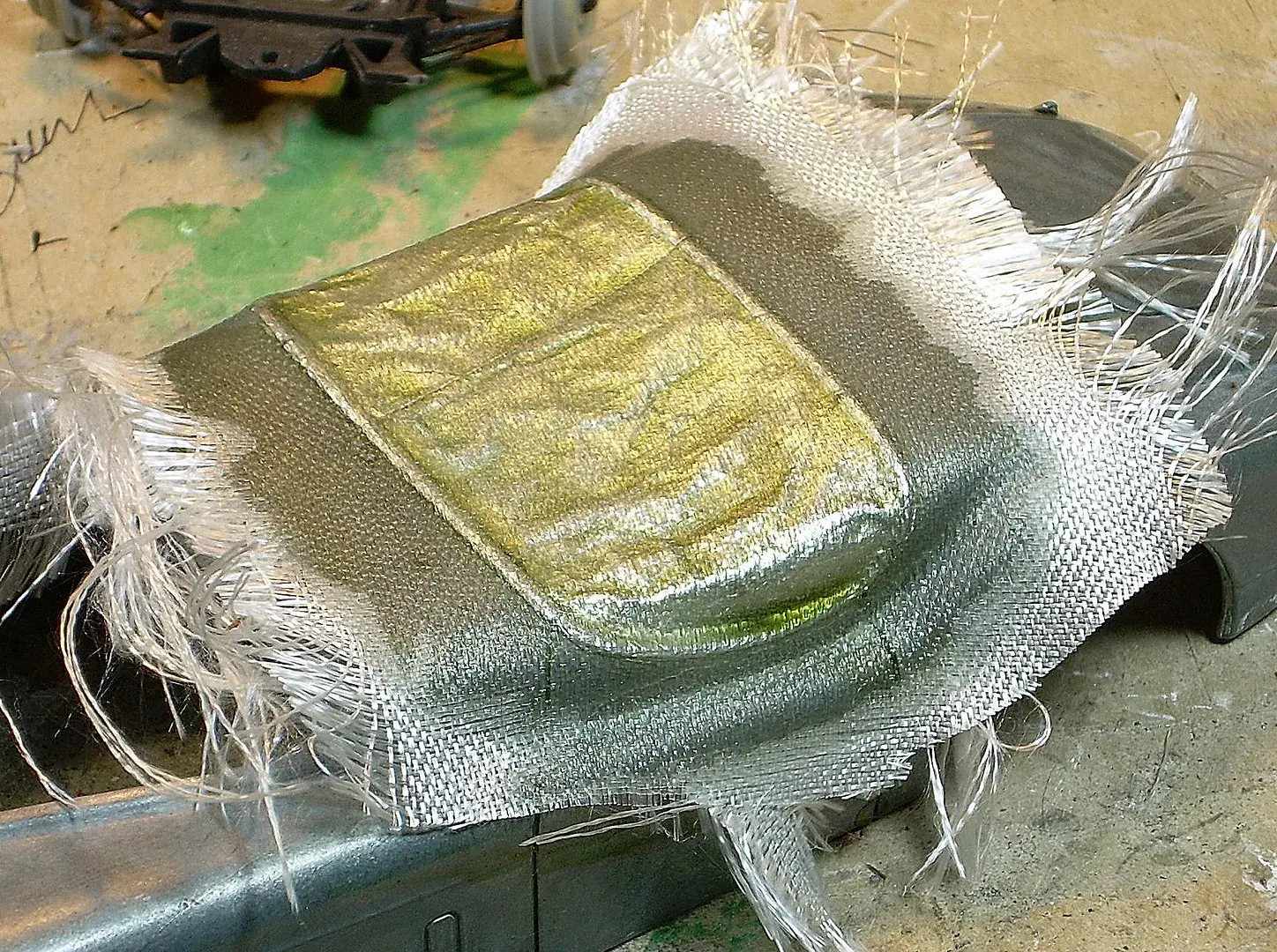

  9. Blobular chassis trimming and cleanup almost complete. First new rear axle test fit. Unit is for 6-bolt wheels mentioned earlier, from Revell '41 Chevy pickup. Spring spacing is spot-on. Interior underside with trans tunnel is now visible. Interior opened up and disassembled. Interesting design, as door cards are molded flat, integral with floor, then folded up and glued in place. I'll be opening the rear deck, and as the casting is quite thick, there's no easy way to save the decklid, so I made a fiberglass mold of the area. When the mold is cured, I'll make a copy of the original deck. Those familiar with my earlier work will have seen something like this many times. To get acceptable strength in a part that's only about .020" thick when finished (the mold is about twice that), I use a very high strength aircraft epoxy that HAS to be mixed on a gram scale.
