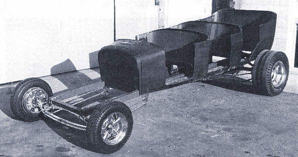

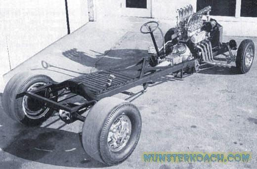

  8. Barris wasn't ever a form-follows-function-first kinda guy. Anybody remember the V8-powered Munster's Coach had 10 fake carbs and ram-induction pipes?

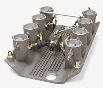

  16. Same basic casting, set up for EFI: EDIT: In the photo immediately above, the fuel injectors live in the old mechanical injector bosses on the inner side of the ports. The lines you see on the outer sides of the ports are vacuum to the MAP sensor. BIG pictures of the Hilborn manifold EFI setup at link below. Manifold casting itself is almost identical to the old-school mechanical unit. http://fepower.net/simplemachinesforum/index.php?action=profile;area=showposts;sa=topics;u=38
