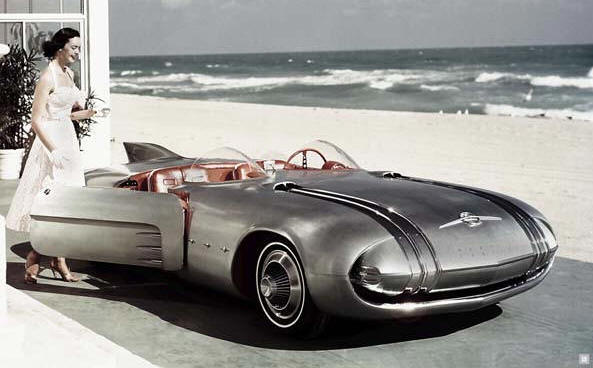

Here is the best picture I have been able to find of the original car.

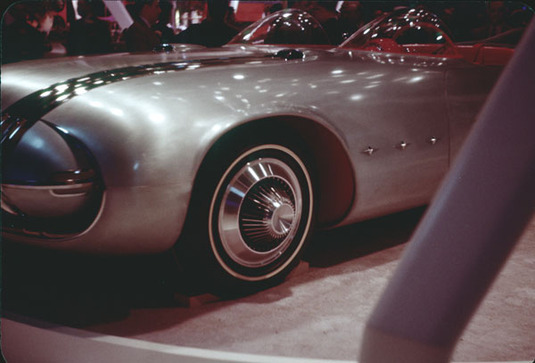

And in these pic it sure looks like its a brushed aluminum with at least a blueish tint to it . I' 'think ' this is the original car.......

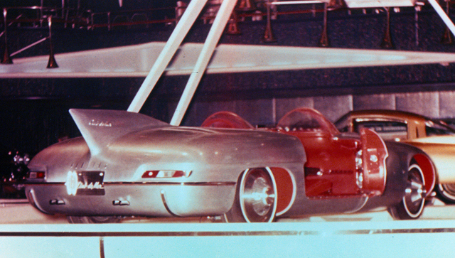

Then in some pics I've found it really looks light light blue ....what to do,,,what to do .
Was thinking to do it in a silver base with a VERY slight blue tinted clear top coat. Then cear it all .
I would love to hear ideas on the best way to do this one.
