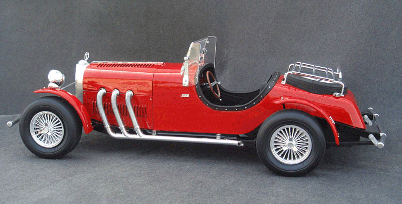

The real car is a repro of a Mercedes SSK that looked like this:
The original concept was to look like this:
The resulting car (and model) ended up like this:

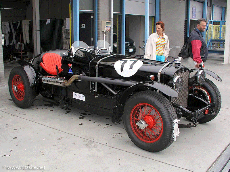

A Volvo

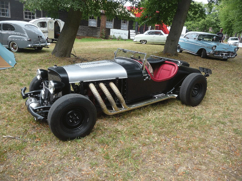

A rat rod Excalibur from Europe (this is REALLY cool):

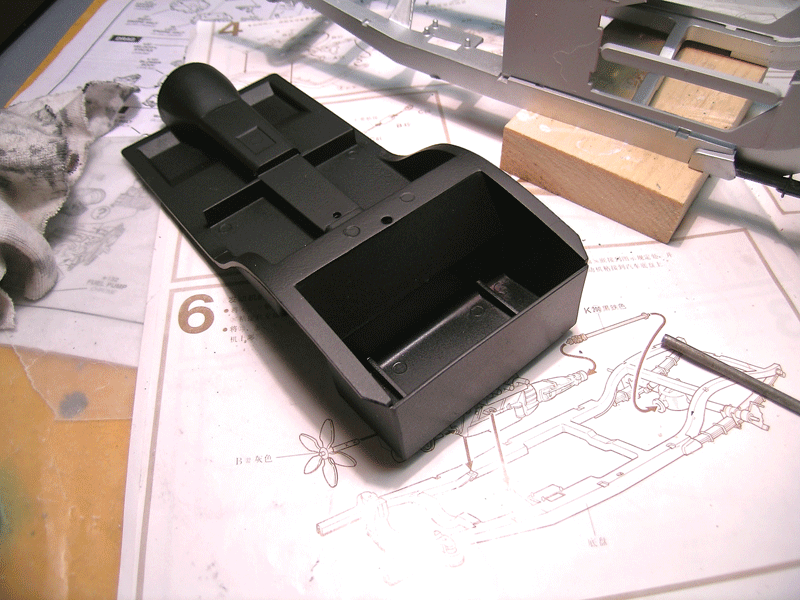

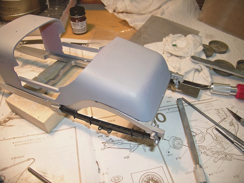

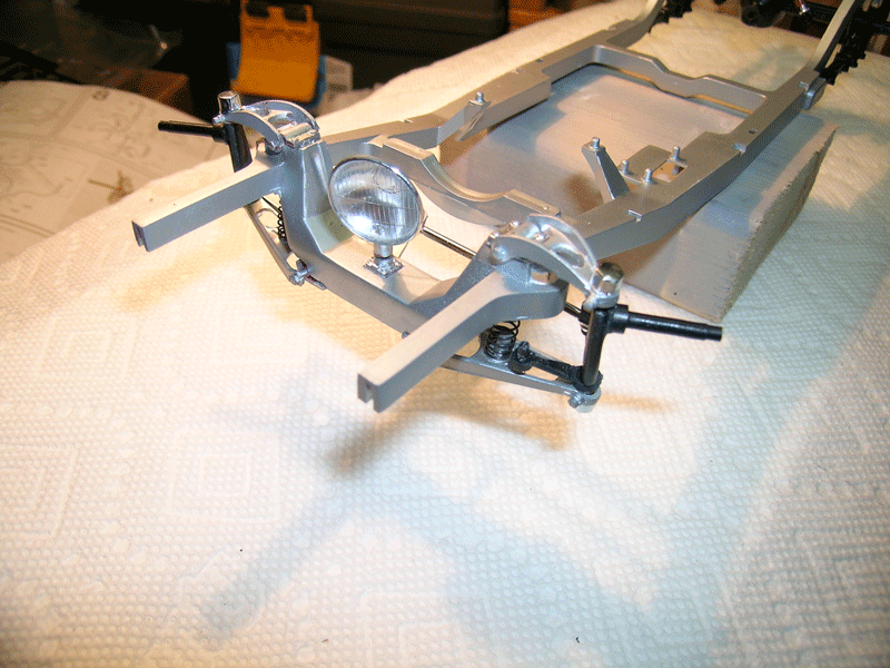

The first thing was to take a foot off the back end (1/12 is great since that would be an easy inch-wide masking tape). This shows the chopped, plugged and sanded back section with the frame (still with tape on it) about to be cut too:
Here's a closeup with the instructions showing the difference:
And here it is with the primed pieces with the shortened leaf springs:

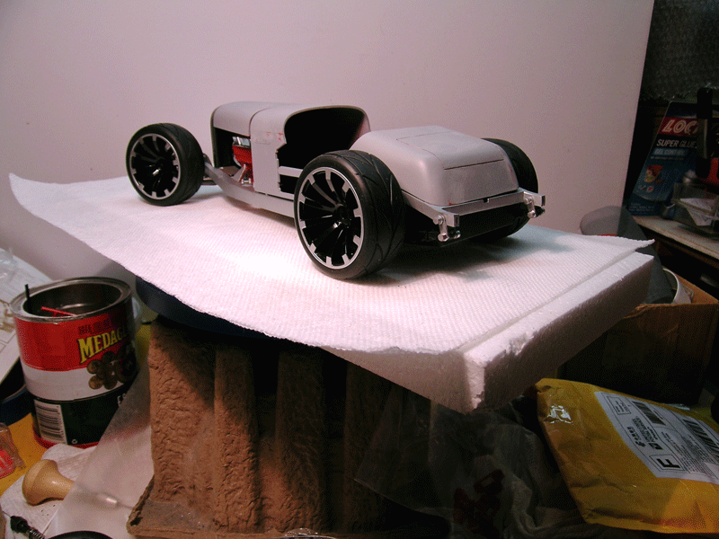

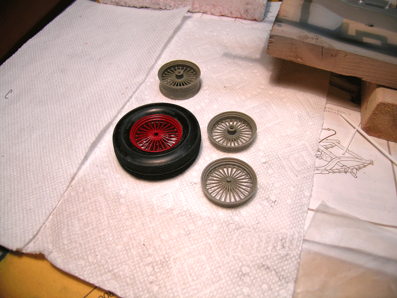

Now that the backend is shortened, I want to lower the car. But first I have to decide on the wheels since I'm not crazy about the stock chomed "wire Wheels." The tires and spinners are great — but the wheels are straight spoke poor reproductions of vintage wire wheels. But I figured I could improve on them by de-chroming and painting, say red:
But I originally had ideas to go with a wilder modification and got some giant 1/10 wheels to fool around with. Here're some ideas I've got set on temp axles (it'll alos help me figure out the chasis height):
Inspired by the Volvo rod above
As inspired by the rat rod above but with the now painted stocks in front
With the stocks on all corners inspired by the Stutz. As much as I try to loosen up I can't get away from "old school" style.

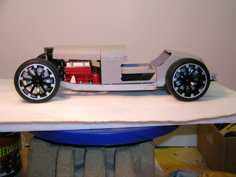

Although I don't have my mind made on which wheels, I do have the ride height i'm looking for ...
Edited by LaughingIndian

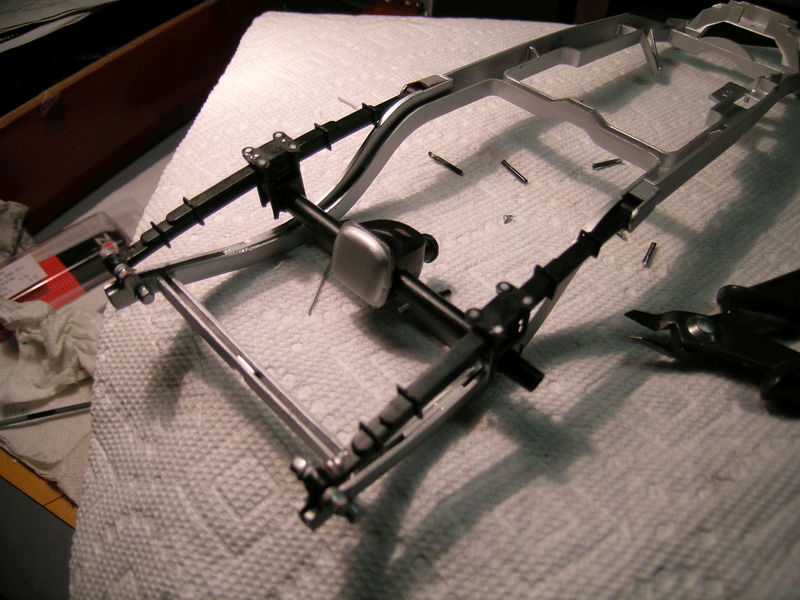

I figure lowering approx 5-6" scale will do it. I figure I can do it without altering the frame anymore than I already did.
So a simple block on the rear spring shackles and switching the front spindles will be the plan.
First the rear:
Elongated shackles
Then a block of milliput putty epoxy under the axles
Finished with trimmed shackle bolts (I went nuts with the lengths to make sure I got it right in one try)

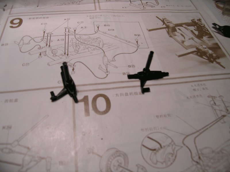

Next the front spindles:
Before
And after
The front end with raised axles on spindles

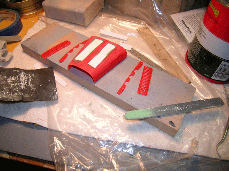

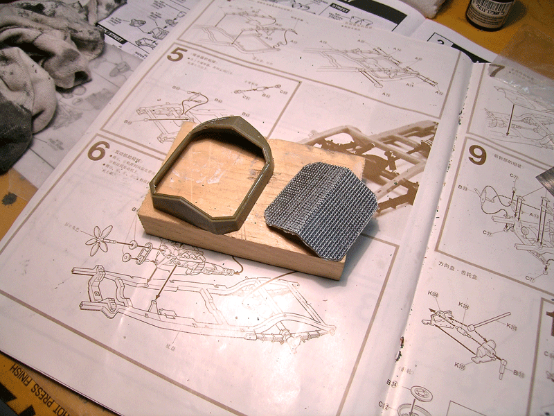

To get the right fit I figured i have to get the hood and radiator prepped.
First the radiator:
With metal mesh added:
... and painted. I can't get away from a satin black like the Stutz and rat rod
One of the many good features of the Bandai kit that Im using is the vented hood. But were the kit skimps on the engine, I'm going to "enhance" it, and the the hood will be reduced and opened up. So the vents are coming off:

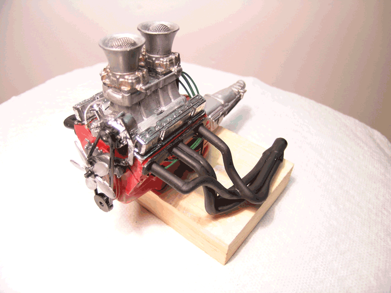

I like your style, but I got an engine that set me back a few days:
Like I said, the kit engine is/was bad without an alternator or distributor and the intake was a simple air cleaner without a carb and the thing looked overly simplified for a model with such a great vented hood.
So I grabbed the alt and headers (with added length to the manifold) from a separate buy (Ebay) Camaro engine and altered the intake stack and carbs from my '57 (I got me a 427 'vette that has a blower I can use to replace it). I jammed some mesh in the stacks for a little "texture."
I decided to build a distributor from styrene tubes and tree. I used old fly-fishing line for the plug wires (neat green) and fuel lines (painted silver).
I then washed with acrylic flat engine black ... I think I better do a little more cleanup after seeing the photo ...
