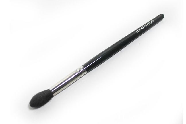

Harry P. Posted March 22, 2015 Author Posted March 22, 2015 thats beautiful.... do you brush or spray on the future? Future is very thin... almost like water. I've tried airbrushing it but it tends to run and sag... you have to be really careful. Now I just brush it on. I do one section at a time (a fender, the hood, the doors, etc) and let it dry before I go on to the next part. That way I have more control. It's slower than spraying it on, but it works for me.

landman Posted March 22, 2015 Posted March 22, 2015 Future is very thin... almost like water. I've tried airbrushing it but it tends to run and sag... you have to be really careful. Now I just brush it on. I do one section at a time (a fender, the hood, the doors, etc) and let it dry before I go on to the next part. That way I have more control. It's slower than spraying it on, but it works for me. Harry, what type of brush do you use? Wide/thin, skinny, pointy?

Harry P. Posted March 22, 2015 Author Posted March 22, 2015 Harry, what type of brush do you use? Wide/thin, skinny, pointy? I use a big, soft brush like this... Because it's pretty big, I can flow on the Future without a lot of small strokes, so brushing it on goes really fast.
