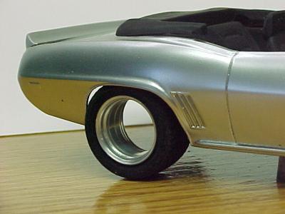

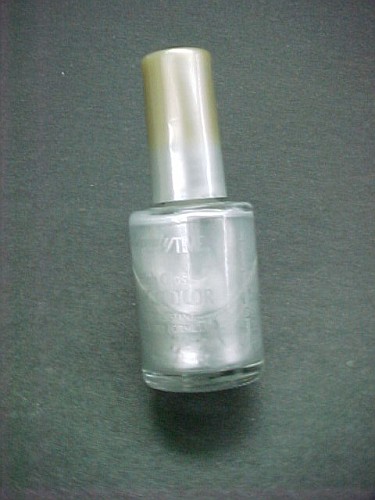

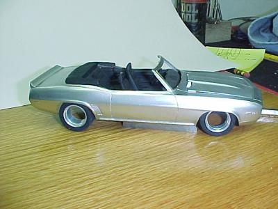

astroracer Posted May 4, 2015 Posted May 4, 2015 (edited) Not to muddy the waters but I have migrated away from most "automotive" type paints and moved into the nail polish realm... This Camaro was shot with a Chrome nail polish over Dupont sandable grey primer. You need to use Dupont or Rustoleum primers as most nail polishes are laquer based and are "hot" to the base plastic. Buying a couple bottles of nail polish at the dollar store is MUCH cheaper then a rattle can, even at Walmart. And the colors are endless. You will need a bit of laquer thinner for mixing and cleaning the airbrush but a quart of that is pretty cheap and lasts for a long time. Mark Edited May 4, 2015 by astroracer
DrGlueblob Posted May 4, 2015 Posted May 4, 2015 The general rule of thumb is -Never shoot a lacquer over an enamel. The really cheap buck-a-can Wally paint are enamels.
Lightsunglasses Posted May 4, 2015 Author Posted May 4, 2015 That car looks great with the nail polish; unfortunately I do not have access to an airbrush so it's not an option for me. Has anyone had success with the cheap Walmart color paint spray cans? How comparable are they to a testors paint spray can?
