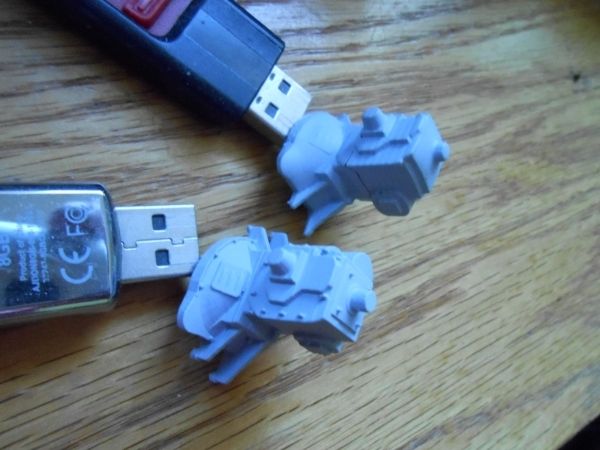

my66s55 Posted June 5, 2015 Author Posted June 5, 2015 (edited) These 2 and most of the prints from here on will be printed on my high resolution dlp printer that I finished building this last Christmas. Many of the pieces have not been drawn yet. I did this Stromberg 2 barrel downdraft carb this week. The exhaust and intake manifolds had been drawn and printed out individually and smoothed last summer. It's much easier to join them in an stl. file and print them out like this. These are exactly as they came off the printer and have a thin coat of primer to make them more visible. It appears as though I have left over cured resin trash in the print vat that showed up on the manifolds print. I need to strain it. The carb is a little less than 1/2 inch high. Edited June 5, 2015 by my66s55

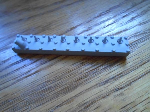

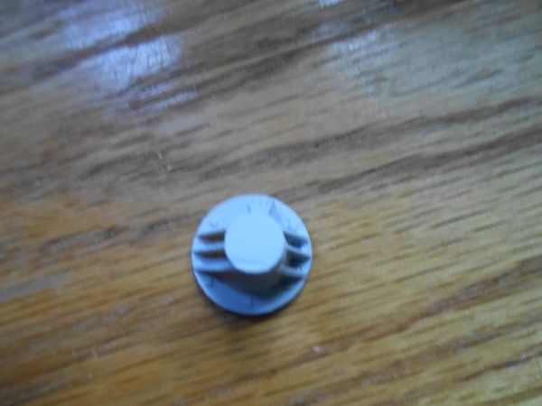

my66s55 Posted June 8, 2015 Author Posted June 8, 2015 I'm working on finishing up the engine parts and had good progress over the weekend. These parts were printed on the high res dlp printer. I am extremely pleased with the engine head. It has bolt heads, goose neck and spark plugs. The second photo has the air cleaner, front of the engine bracket with timing chain cover and bolt heads and the water pump. I'm not happy with the water pump as it appears that I need to do a bit more work on the drawing. Again, these are exactly as they come off the printer with only a light dusting of primer. I want people to understand just how well parts can be printed at home.

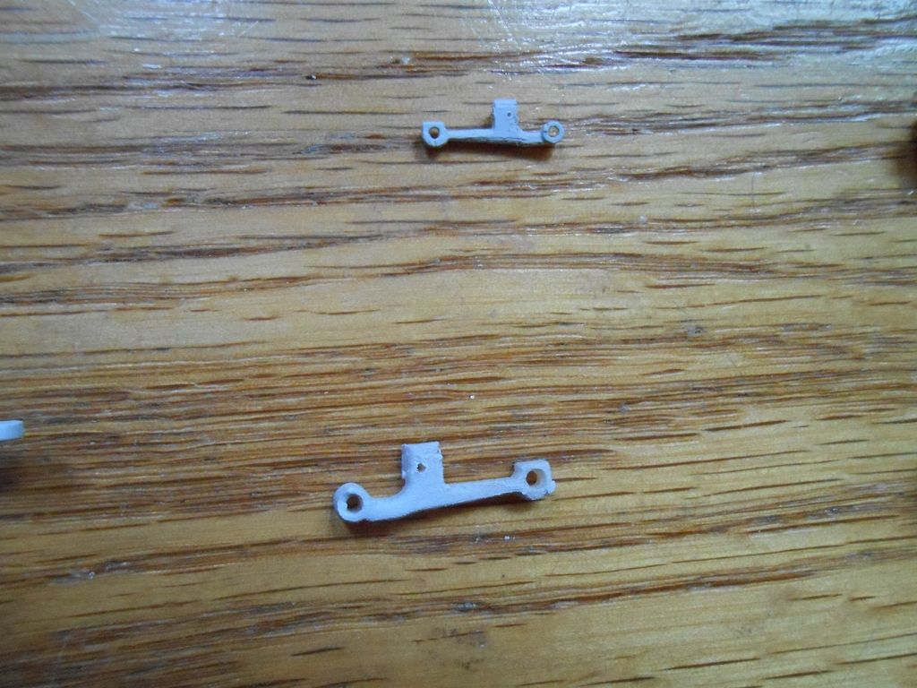

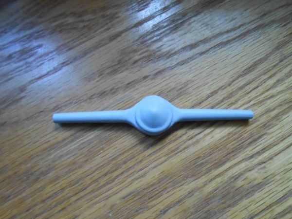

my66s55 Posted June 11, 2015 Author Posted June 11, 2015 Sorry Charles, I don't. I'm still learning plus it takes all of my time and effort for my projects. Here are the rear axel,printed some time last year on the fdm machine and surface finished and the pig, recently printed out on the high def dlp machine.

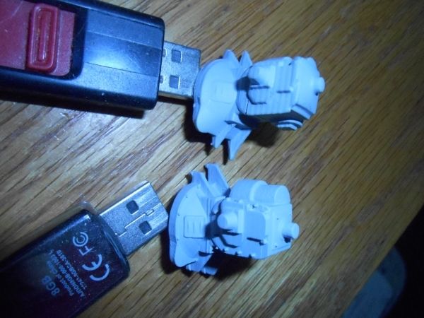

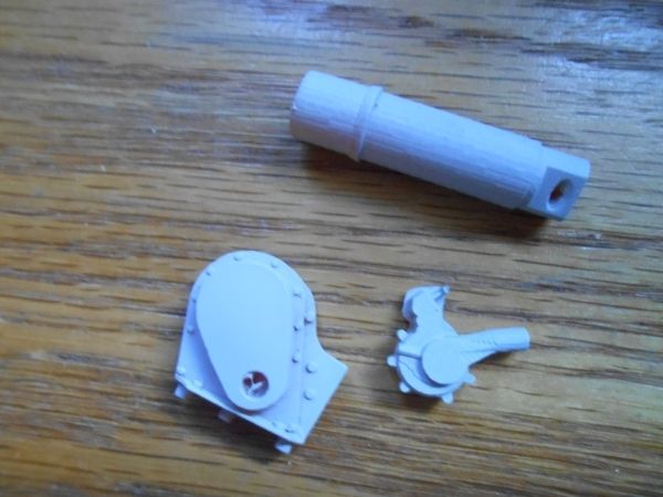

my66s55 Posted June 14, 2015 Author Posted June 14, 2015 Thanks to all for the encouraging words. You are correct, David. I taught myself to use Blender. There are tutorials on You Tube and other forums to show anyone how to set up the background jpegs and even how to make a mesh for a car. Tons of instructions on the Blender website. Blender is open source and is developed by those who use it. If you go to Shape ways website and check the section on preparing a file for 3d printing, you'll see Blender mentioned. It is very 3d printer file friendly. Producing the file is only the first step. Here is an example of learning how to get a good print vs just a print from the high def dlp printer. These are photos of the bell housing and trans. The part on the top side of each photo was printed a few weeks ago and was the original parts from the fdm machine that I joined together in the stl. file and printed out on the dlp machine. The part on the bottom of each photo was printed on the dlp high def machine a few days ago. What made the difference? I added some parts that could be added because they will show up on the dlp print, and I made two changes in the printer setting. I changed the expose time for each slice from 3 seconds to 2 1/2 seconds and extended the length of time between the period the build plate surfaces and the projector flashes from 10.8 seconds to 30 seconds. You can see the difference.

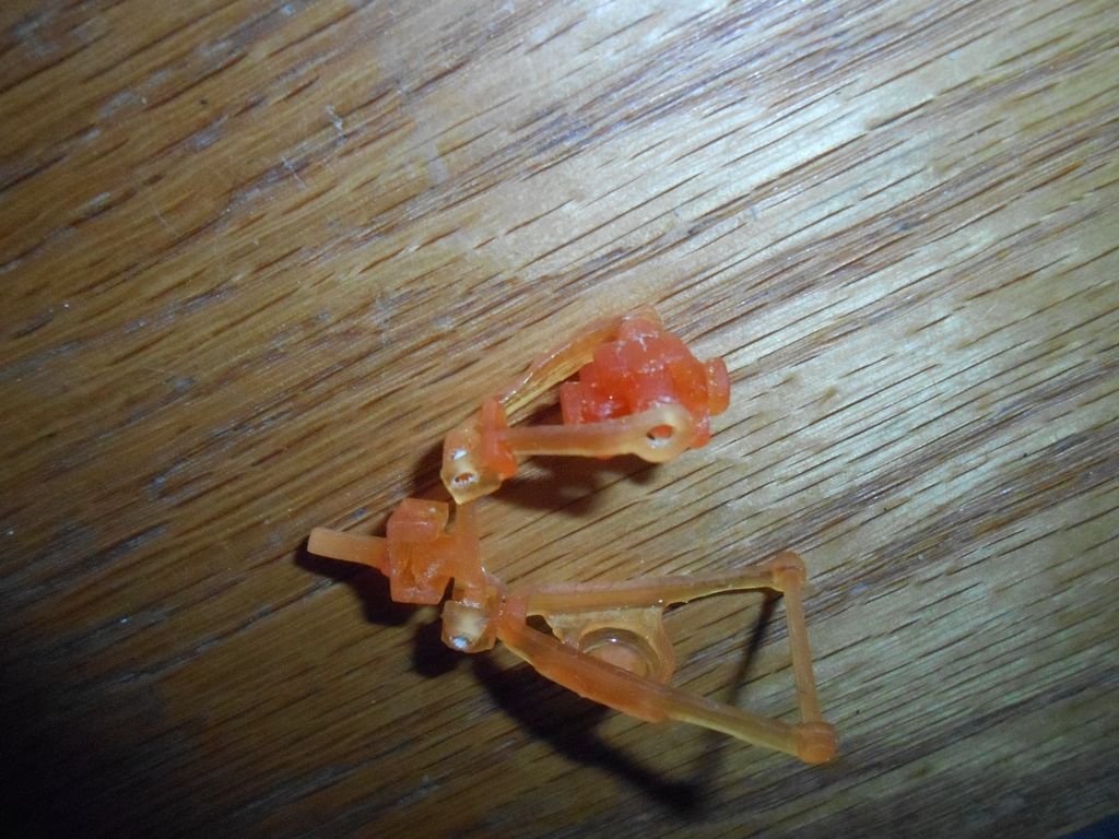

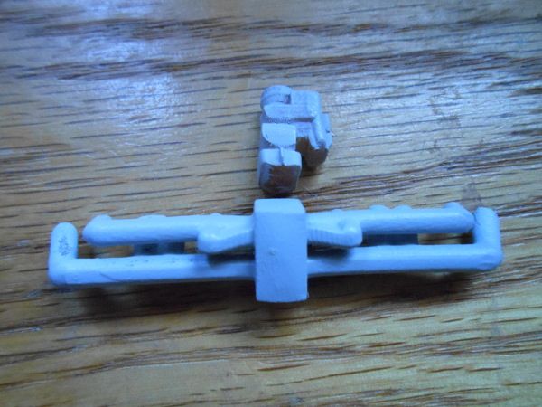

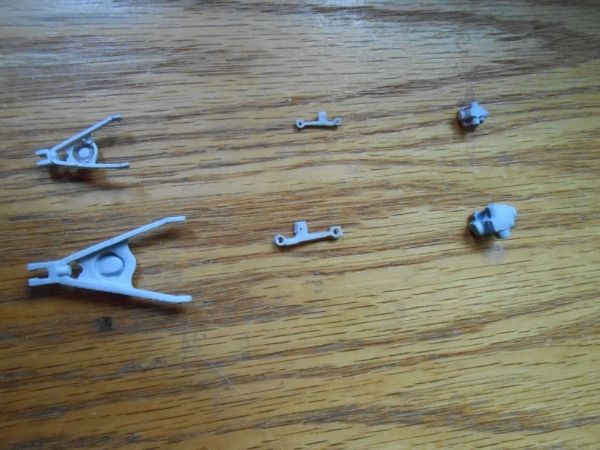

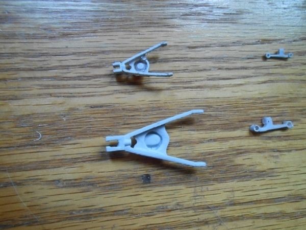

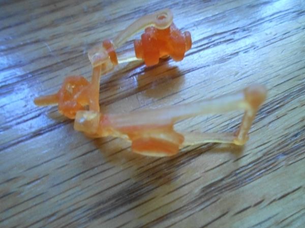

my66s55 Posted June 17, 2015 Author Posted June 17, 2015 Here are one side of the front suspension pieces. It took about 3 days to do these as I had to make a few minor changes in the drawings for it to be the way I wanted. Also, this resin is very brittle and with small pieces as these they break easily. This caused me to make many replacement parts. That's one of the advantages of 3d printing. Break a part, print a new one. There is a new resin due out any day that claims to be similar in make up to injected plastic. I'll be using that as soon as it is available. These are as they came off the printer. No primer.

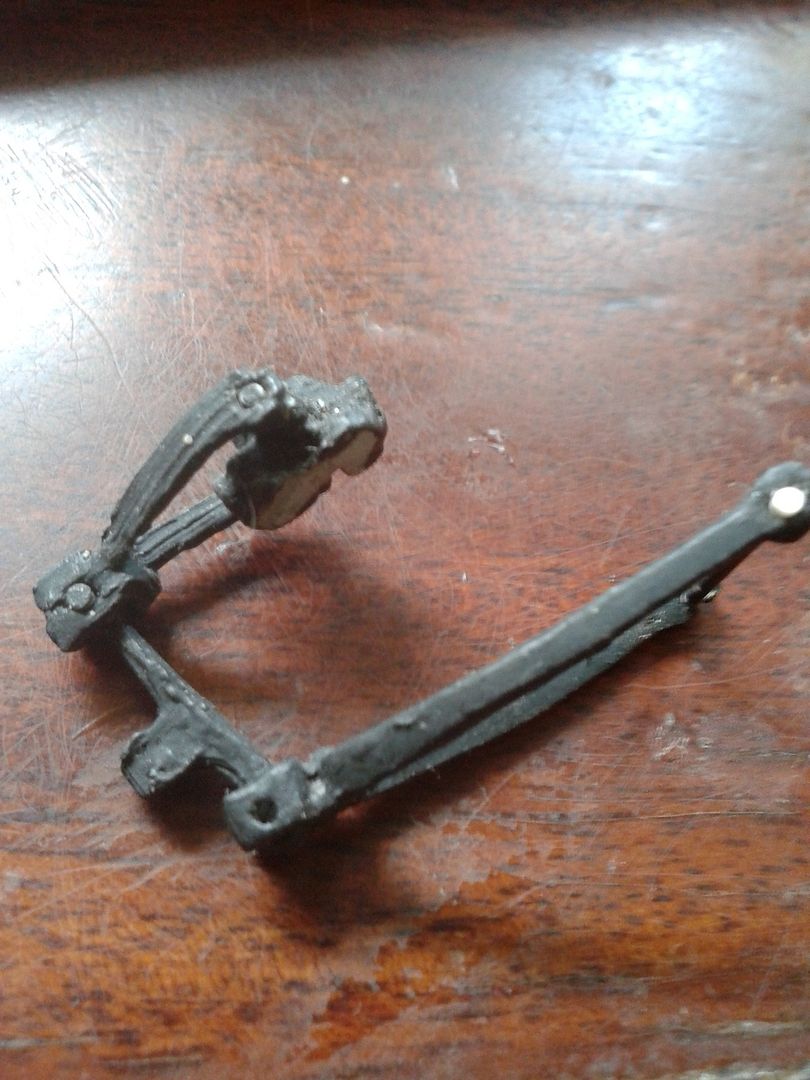

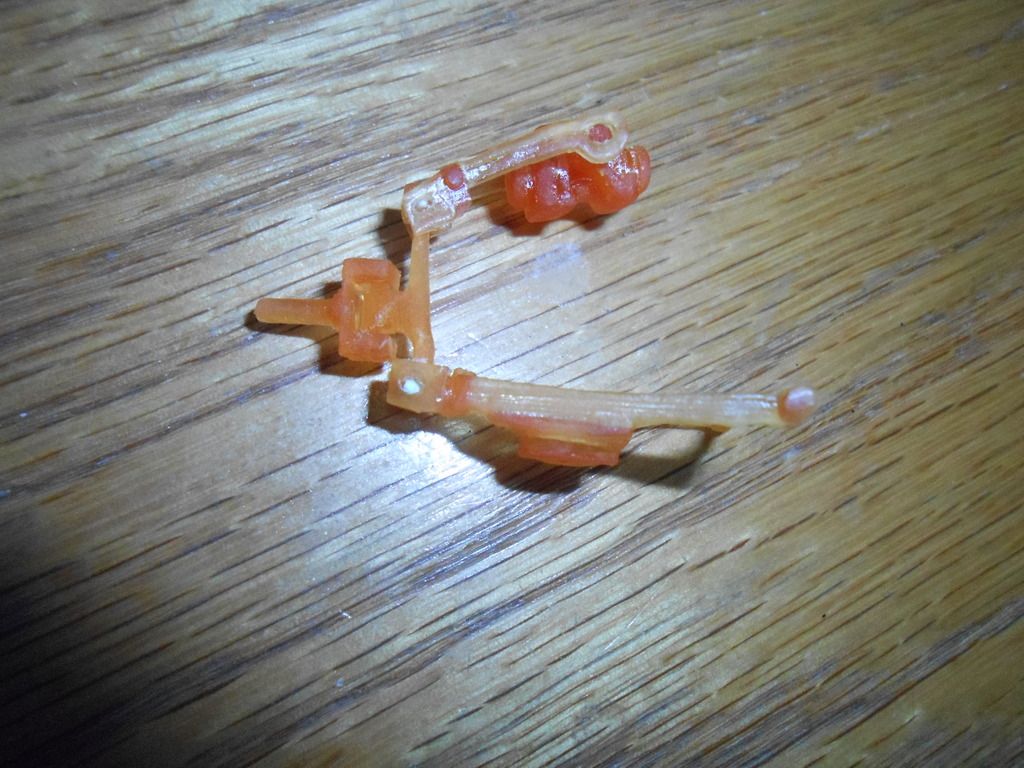

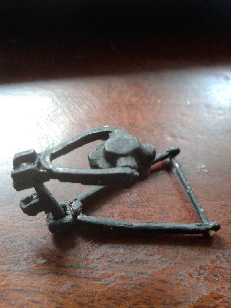

my66s55 Posted June 17, 2015 Author Posted June 17, 2015 (edited) Hear are the original prints off the fdm filament printer. The main reason this project is in 1:18 is because these parts couldn't be printed in 1:24 is that there would be no detail, just blobs of melted plastic. Of coarse, as I have shown, it is now possible to do in 1:24 and smaller. These are after some surface prep. Edited June 17, 2015 by my66s55

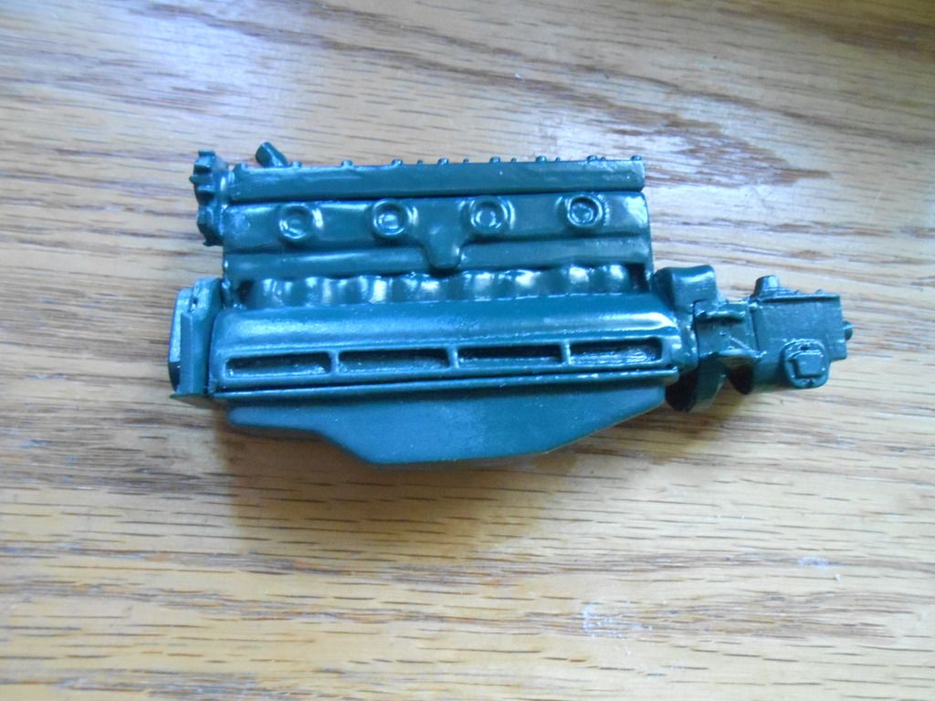

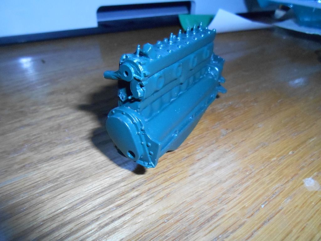

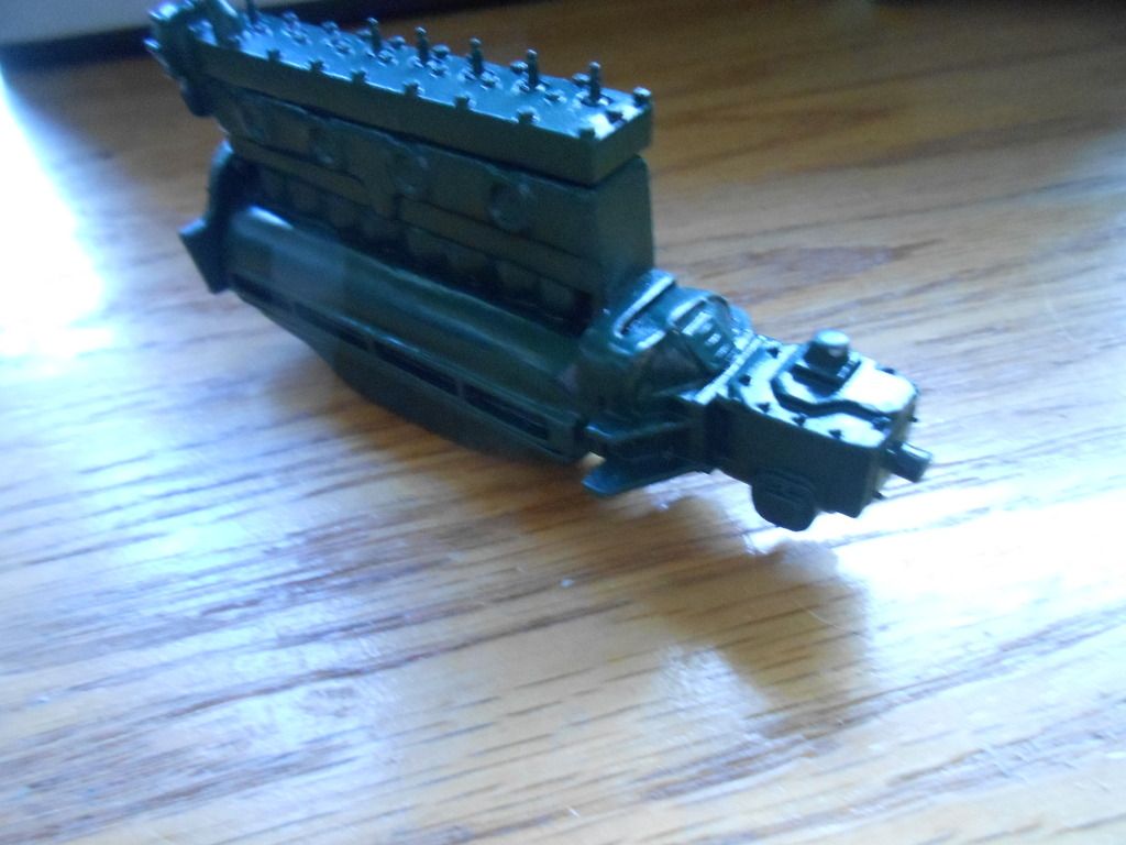

my66s55 Posted July 1, 2015 Author Posted July 1, 2015 So ,o.k. It's been awhile since my last post and I promise anyone watching this that I will try not to post any non progress posts. I am waiting for resin. I can't do any more printing on the dlp machine. I've started assembling the engine and trans. Here are the results.

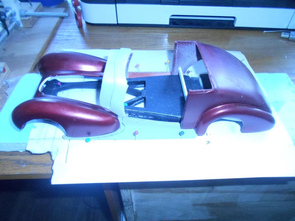

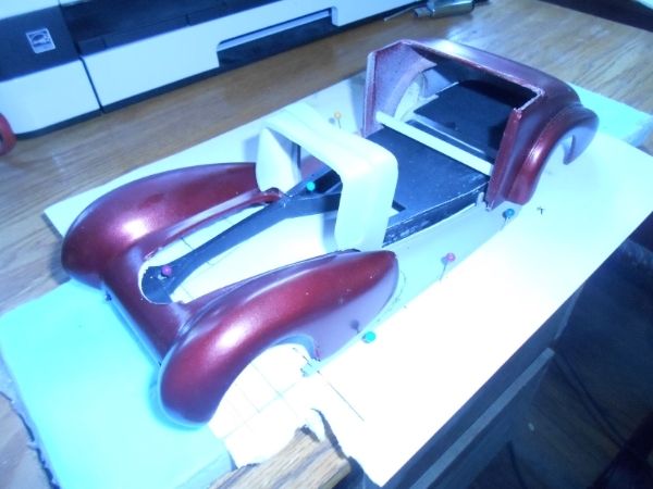

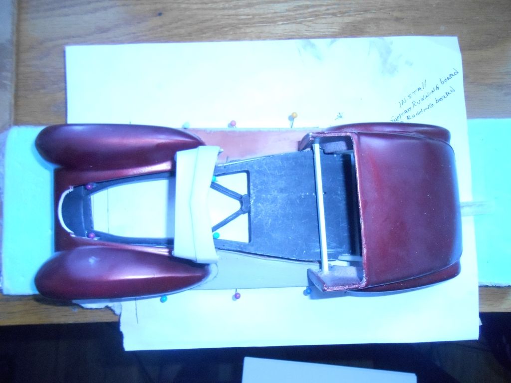

my66s55 Posted July 6, 2015 Author Posted July 6, 2015 I'm still waiting for resin. It should be here this week. Mean while, I'm working with what I have. This is the mock up of the frame, front fenders, front of body cowling, running boards and rear body shell. None of it is glued together. The running boards were printed over sized and trimmed to fit. The doors are also printed slightly longer to allow for shrinkage. Now that I have this mock up, I can get a correct length for those parts.
