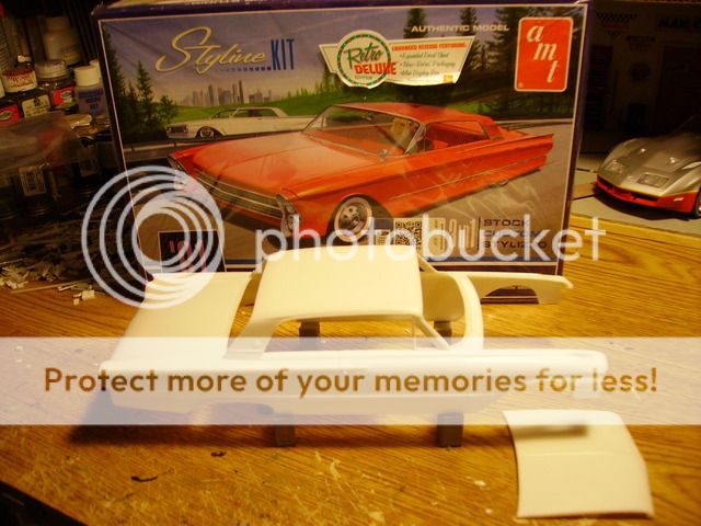

I typically enjoy building super stock drag cars and gassers. So I jumped back on this build that I've been working on periodically. This is the reissued AMT 1961 Ford galaxie styline kit. I got this as a christmas present from my inlaws a couple years ago. Its a pretty basic curbside kit centered around exterior 60's style customizing with very little chassis detail. Comes with some neat custom parts but I don't normally build customs. The hood is molded shut on the body and it has a one piece chassis plate. But since this was so different as a subject, I immediately started brain storming with it. First thing I noticed was the large rear wheel openings in the chassis plate. I had a set of AMT MH Racemaster jumbo slicks that fit perfectly in there and my decision was instantly made to build it as a super stock drag car. Since I wanted an engine in this, I carefully cut loose the hood and set out to make the necessary modifications to convert this kit into something better.

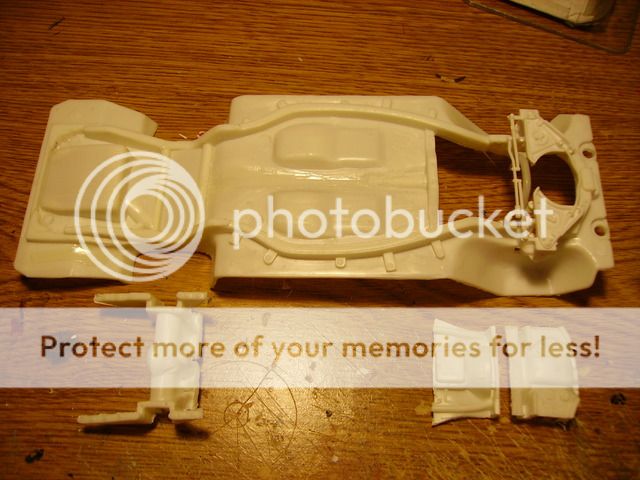

I moved on to the chassis plate and cut out the molded in front suspension/ engine bottom and the molded in rear end. Used my dremel tool to grind off the molded in drive shaft, stock single exhaust and muffler. I filled the rear hole using the plastic customizing sheet that came with the kit. Also filled the rear sections of the gas tank and frame with plastic where the plate screws normally went. The 61 galaxies shared the same if not similar suspension chassis parts as the 57 Fords. Luckily, I had these front suspension pieces in my parts stash thanks to the generosity of a friend in my model club. He had build a Revell 57 Ford sedan into a gasser and gave me all the left over stock parts. After some minor fit work , the front upper and lower A arms fit rather nicely. I used the engine mount cross member from the AMT 57 ford kit. The AMT Ford suspension parts will work as well, but the Revell parts were better detailed.

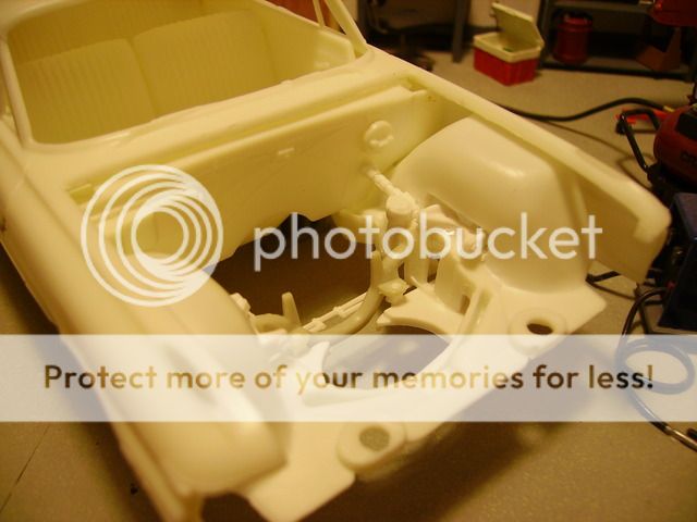

Heres the engine bay detail in progress. I had a firewall in my parts stash that fit perfectly with a little trimming on the edges. I have no idea what kit it is from..Note the use of the Revell Ford steering box and the relocated master cylinder wall mount and steering column section. I had to cut small slots in the fender wells to slip the upper A arms through to glue them to the frame. I have yet to figure up a radiator support.

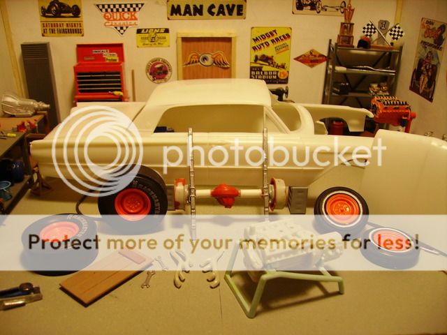

Heres an overview of some of the main pieces I'll be using. The AMT jumbo slicks and some skinny front white wall tires with the steelie rims from the Revell 64 fairlane kit. The Ford rear end and leaf springs I found in my parts box. No idea what kit this is from either. It was from an old unknown gluebomb and was broken in a few places. I repaired and narrowed the track width with evergreen tube to fit the Ford chassis.. More digging through my parts turned up this early 60's Ford engine. I think its from a AMT Thunderbird kit but i'm not sure. Most of the pieces for it were there and it fit pretty good. Has a tri carb setup but I might change that later. I filled in the metal axel hole slot in the block that was typical of early AMT kits.

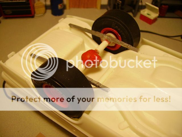

Heres a shot of the rear end with the AMT Racemaster jumbo slicks. The fit is great. Still have to find some shocks and a driveshaft in my parts.

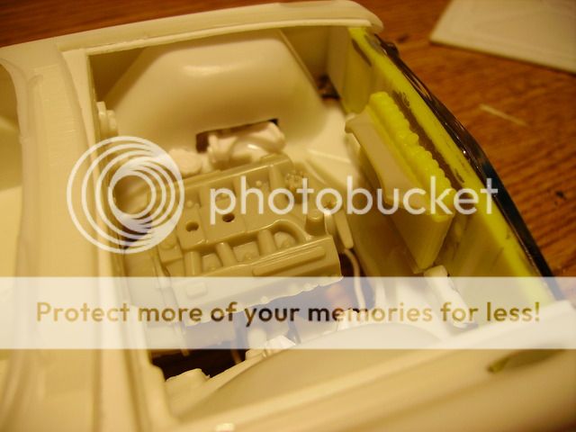

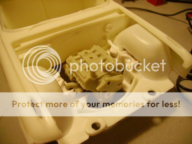

Shot of the engine mockup in the opened up bay. Everything seems to clear nicely so far.

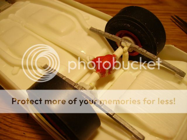

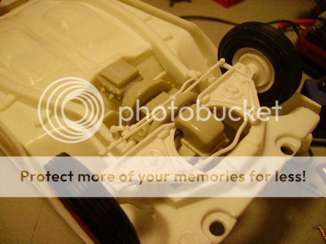

Shot of the underside of the front suspension section. The Ford engine fits asweome here. Note the "slushbox" transmission and how it transitions into the molded in tailshaft behind the cross member. Excellent illusion to blend in with. Amazingly, the offenhauser headers clear everything with no mods. I also cut down the kit wheel back shafts to fit the suspension track width. I even retained the metal axel piece for added strength.
Shot of the rough chassis mockup and stance. Stay tuned.

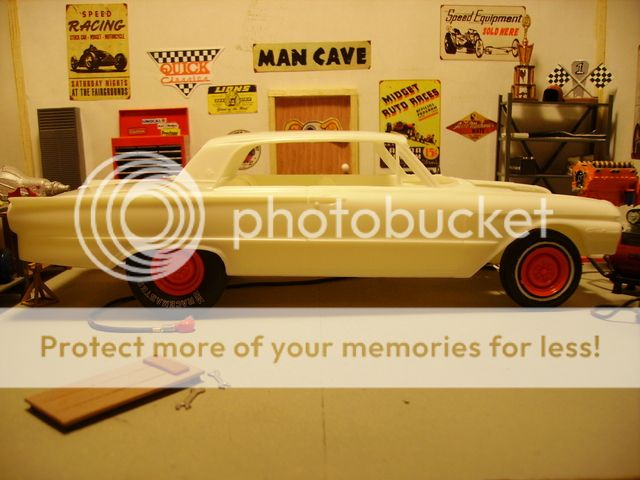

Been messing around with it some more today. Got a few details like the rear shocks and drive shaft figured out. Glued the firewall into the body and filled the center floor gaps in the transmission tunnel area to blend better with the lower edge of the firewall.

Heres a few pics of my progress. As I said earlier, I found some coil over shocks, I believe from the Revell 32 Ford kit, made some shock mounts on the spring hangers and crossmember, then made up a driveshaft from my parts box items.

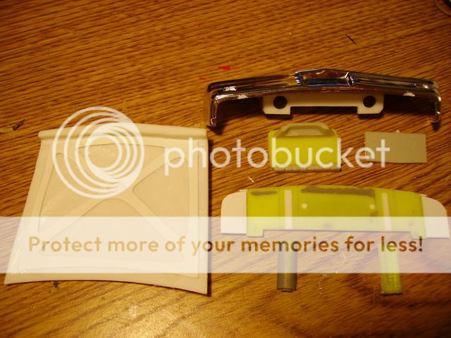

Digging around in my parts again, I found a radiator support that would work and had a nice upper brace curvature already. This is one I had cut out of a AMT 65 Chevelle wagon body 26 years ago. Never throw parts away. you will eventually use them. It did have the molded in screw posts as typical of those old AMT kits. I cut the post humps flush with the support wall and filled in the remaining recess with evergreen half round rod. I then added some evergreen sheet scraps to the ends to extend the support on both sides. I amazingly still had the Chevelle radiator from the same wagon kit as well. I cut a upper fan cowl and side tanks off another parts box radiator and glued them to the Chevelle radiator for better detail. I then notched the mounting section on the front bumper to clear the radiator bottom tank.
After a mock fit of the front engine bay, everything seems to be going together fine.
