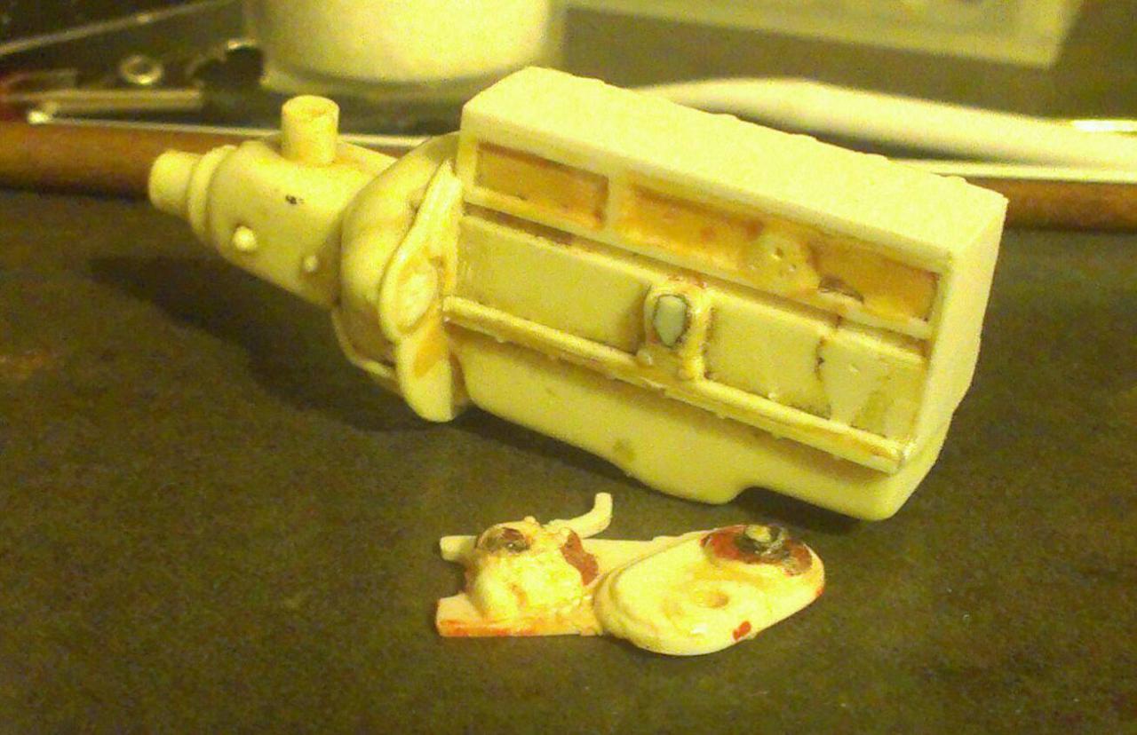

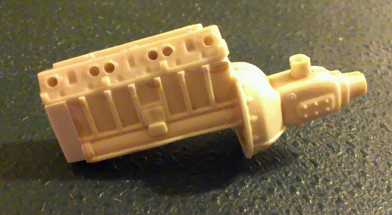

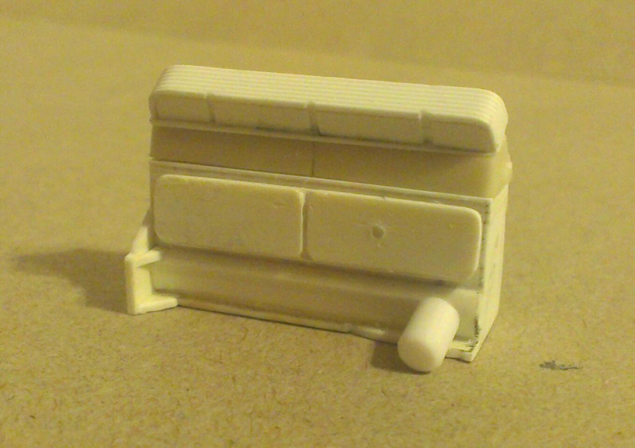

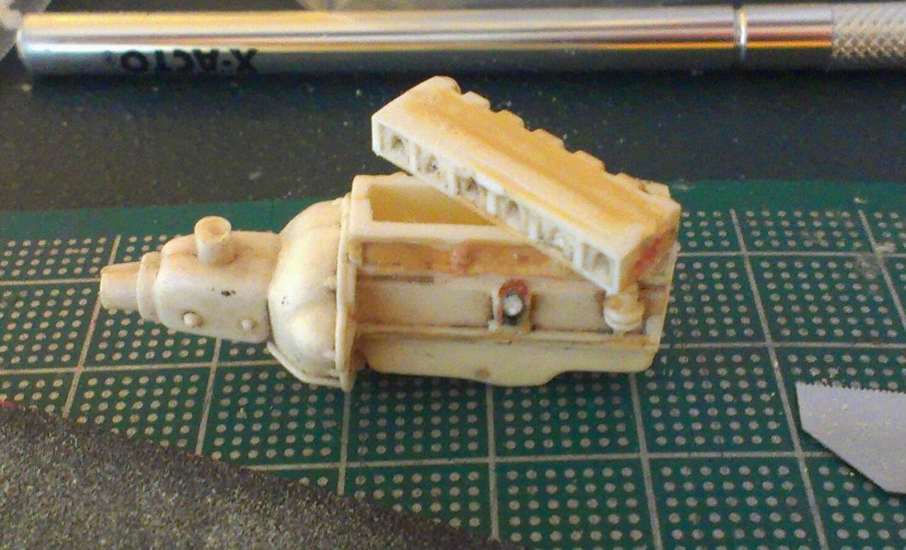

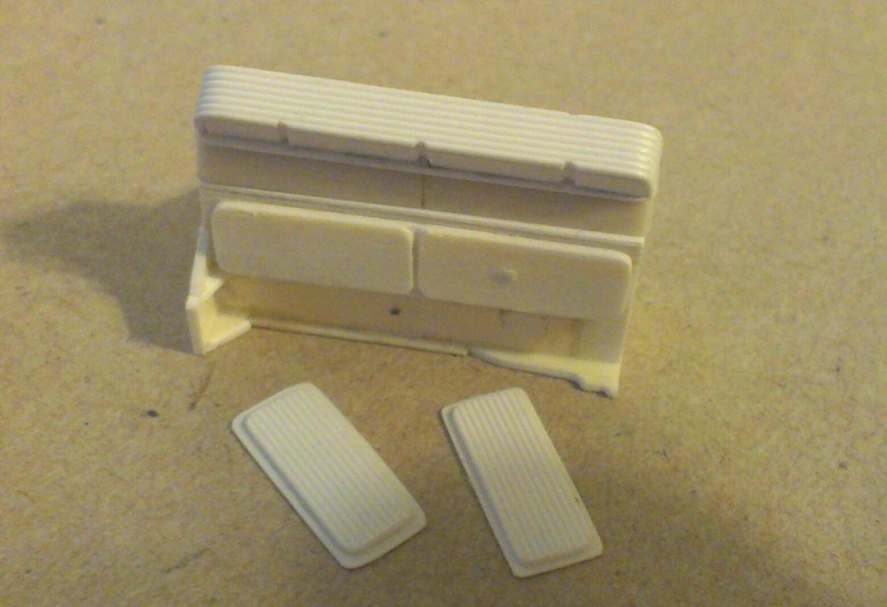

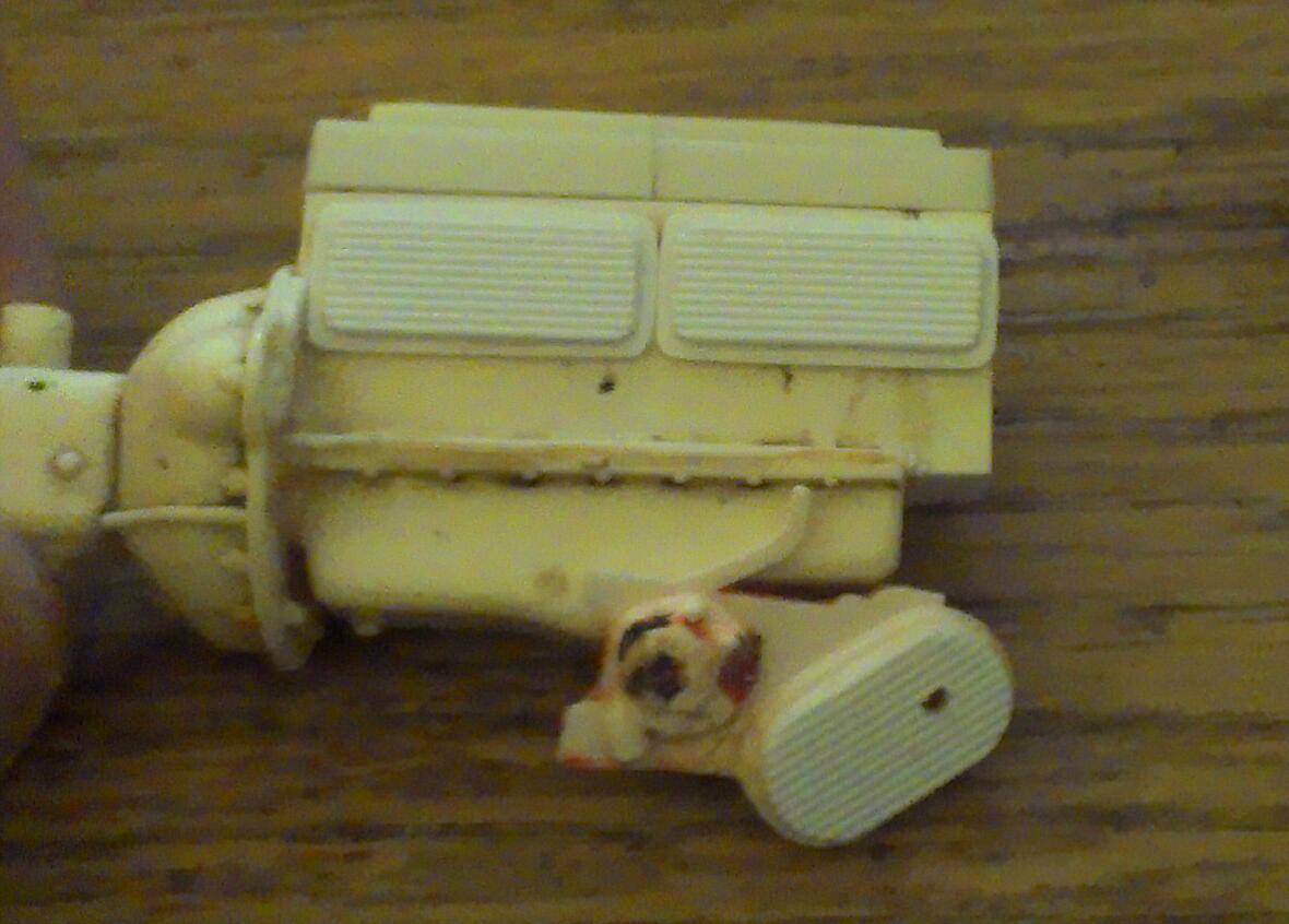

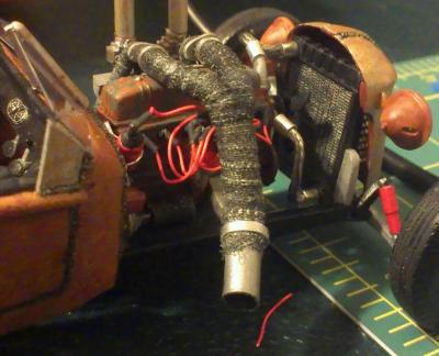

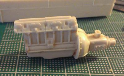

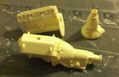

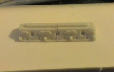

Motor maker Posted June 8, 2015 Posted June 8, 2015 (edited) Eventually there'll be work done on a stock version but this one has SBC heads like Leo Santucci's dragster. Progress photos (EDIT ADDED) I started with a 216 L6 and removed the head and the front of the glue bomb motor. I duplicated the SBC heads from the 34" Ford 5 window coupe kit and chopped them to Santucci's Inline dragster motor. I used the new head as a basis for the motor length. After the block was lengthened to match the head. I started working on the detail on the passenger side first. The original transmission had to go. Most recent progress photos: Edited June 14, 2015 by Motor maker
Rotorbolt73 Posted June 9, 2015 Posted June 9, 2015 Cool. Love 6 bangers. Looks like the block is evergreen scratchbuilt with a resin head. Nice work. Never thought about trying replicate that engine..much less using his 6 cyl power manual for reference..

Motor maker Posted June 9, 2015 Author Posted June 9, 2015 (edited) On 6/9/2015 at 1:14 AM, Rotorbolt73 said: Cool. Love 6 bangers. Looks like the block is evergreen scratchbuilt with a resin head. Nice work. Never thought about trying replicate that engine..much less using his 6 cyl power manual for reference.. I have both editions. I'd eventually like to build a lot of inline 6 models. However since no kit maker made the 250 or 292 motors something needed to be done... Edited June 9, 2015 by Motor maker

Motor maker Posted June 11, 2015 Author Posted June 11, 2015 On 6/11/2015 at 1:07 AM, Rotorbolt73 said: The Trumpeter 63 Nova kit has an excellent 194/ 230 inline 6. I avoided the trumpeter motor as a donor block for a few reasons. It is too small and I only had two. My 292 next to a 72' trumpeter inline 6:
Motor maker Posted June 11, 2015 Author Posted June 11, 2015 Currently my 292 is long enough but too wide. I hadn't gone out to measure the width of the 250 in my van, but instead matched the width of the SBC joined heads.

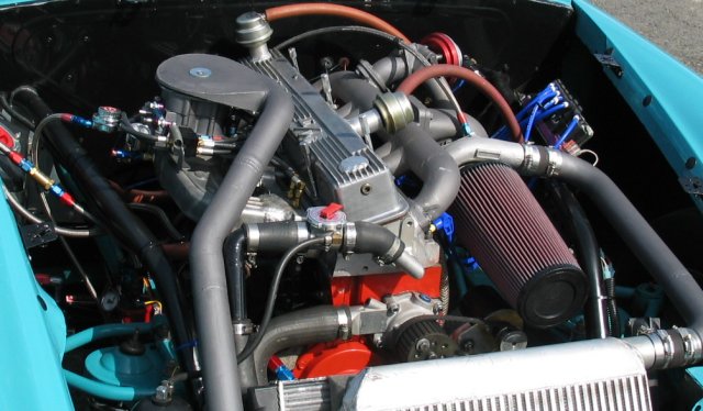

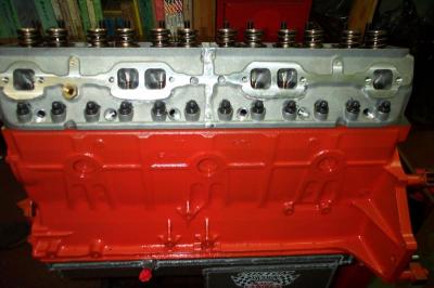

Motor maker Posted June 14, 2015 Author Posted June 14, 2015 Leo Santucci's Turbocharged 292 is the inspiration for the current build up of this motor project. I probably won't go turbocharged, or with a Studebaker body but we'll see. A build up progress shot of Santucci's motor. I'm not eager to add all (or most) of the casting details.
Motor maker Posted June 14, 2015 Author Posted June 14, 2015 I edited the OP to include build up photos.
