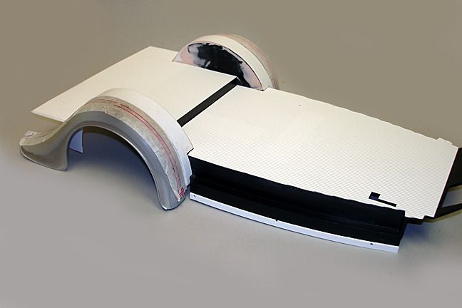

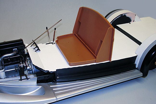

Harry P. Posted July 12, 2015 Author Posted July 12, 2015 Here is the floorboard, with the extended rear floor and finished wheelwells, with fenders installed. A little Bondo on the fenderwells to smooth things out. And I covered the floor with some corrugated styrene sheet to represent ribbed rubber flooring. All of this will eventually be painted flat black (except the fenders, which will be gloss black) This is the stuff I used to simulate the ribbed rubber floors...

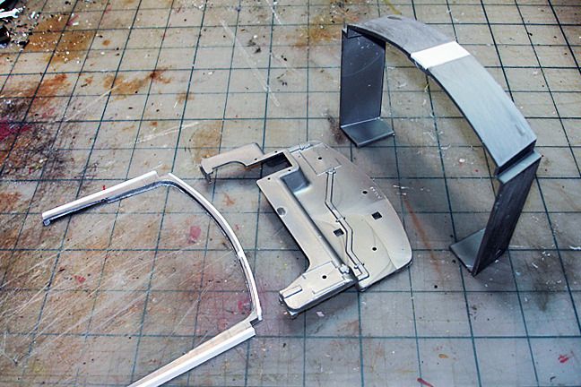

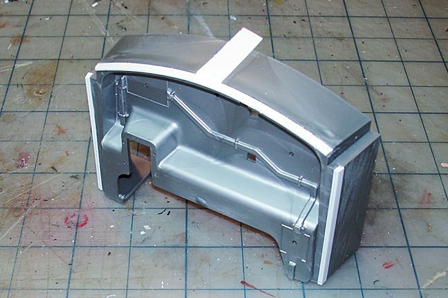

Harry P. Posted July 12, 2015 Author Posted July 12, 2015 The firewall as done by Pocher is wrong. The bonnet rub strips are in the wrong place, and the "walls" of the firewall are incorrect... the firewall itself is only a thin piece that gets bolted to that "shroud" that should actually be part of the cowl sheetmetal. First step was to sand down those incorrectly placed bonnet panel rub strips and fill in that incorrect channel with styrene strip. Also, that "cutout" at the top is wrong and needed to be filled in as well... Next, a razor saw was used to cut the "shroud" away from the firewall. Due to the shape of the firewall and how it's molded, I also had to use the back of my knife blade to scribe certain areas to release the firewall from that shroud...

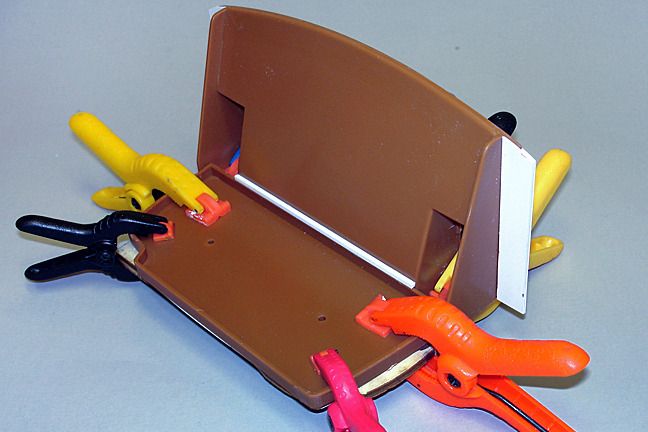

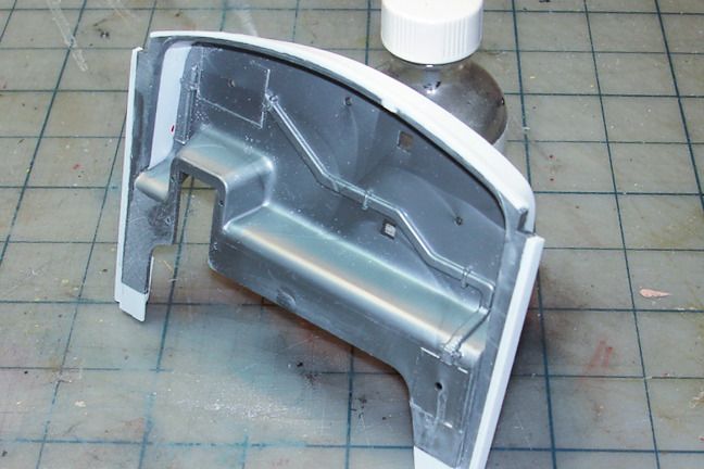

Harry P. Posted July 12, 2015 Author Posted July 12, 2015 Now that I had the firewall in pieces, it was time to rebuild it to look more like the real thing. Here is the rebuilt firewall with sheet styrene added to "fill in the gaps" resulting from cutting it away from the shroud...

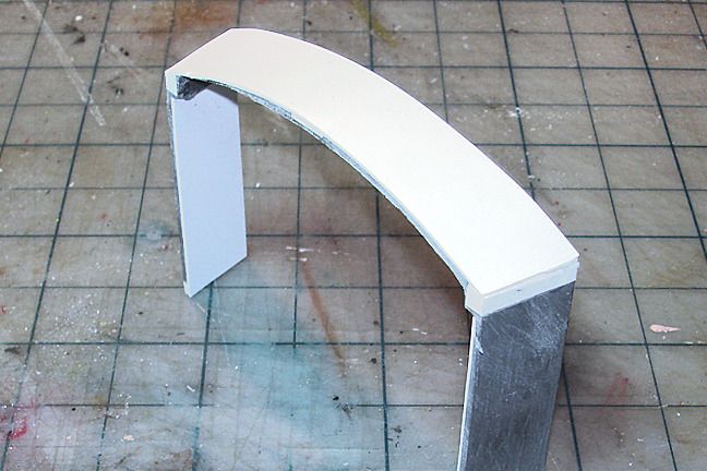

Harry P. Posted July 12, 2015 Author Posted July 12, 2015 And here is the shroud part, with incorrect areas filled in. I also had to redo the top arced section to match the contour of the cowl. If you build this kit out of the box, there winds up being a huge gap between the shroud and the cowl, which is wrong. There should be no gap at all, since this piece is actually part of the cowl sheetmetal...

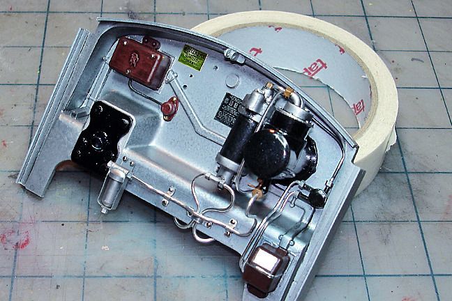

Harry P. Posted July 12, 2015 Author Posted July 12, 2015 And here is the firewall, almost finished. Still need to add the linkages that control the starter carburetor and the radiator shutters. I scratchbuilt a new steering column plate, the kit piece is way wrong. I also added a scratchbuilt fuel filter and several other doodads and valves and solenoids and general "stuff," based on photo references. The fuel filter could be mounted on either the left or right side of the firewall (my reference photos show it done both ways). In this case, the filter would have been a really tight squeeze on the left side, I think the magneto would have interfered with it, so I moved it to the right side where there is a lot more open space. BTW... that vertical cylinder is the oil tank for the "automatic" chassis lubrication system. All you had to do was press a small foot pedal to send oil out to various points on the chassis. And that other large black gizmo is actually the fuel pump. RR called it an "autovac." It had a large outer tank (the part you see) and a smaller inner tank with a piston/float mechanism inside. That inner tank sucked the gas from the main gas tank by creating vacuum. Then the gas was transferred via an internal valve to the outer tank, and from there to the carb. I added a scratchbuilt drain valve at the bottom, the two fuel line fittings at the top, and the fitting at the bottom for the fuel line that runs to the fuel filter, and ultimately to the carb. I also added a scratchbuilt bracket for the radiator support rod at top center (the kit had the support rod going into a hole in the firewall, which is wrong). And I added flanges along the edges of the firewall where the bonnet rub strips will go.

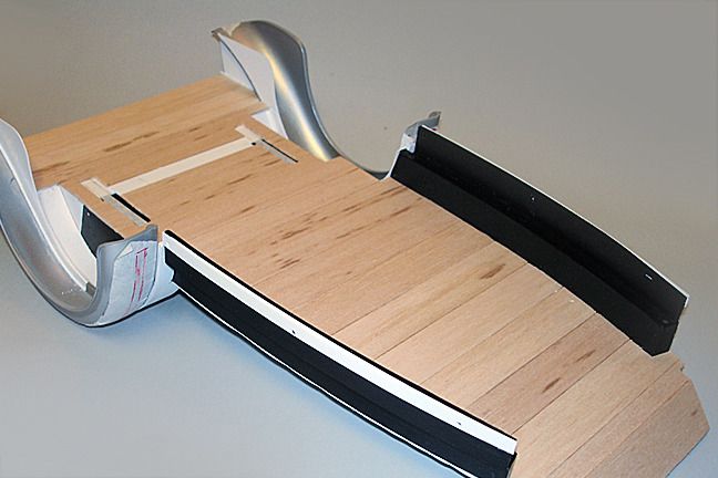

Harry P. Posted July 12, 2015 Author Posted July 12, 2015 This car had floorboards made of actual wooden boards. The Pocher piece has a pretty decent woodgrain pattern embossed on the underside of the floorboard, but I covered up the battery box because I don't intend to bother with working lights on this model, and I cut away a depression in the floorboard that was meant to house the rear fold-out auxiliary jump seats' hinges. Cutting away that depression left me with a big hole in the floor that would have to be filled. Both that hole and the battery box hole are covered on the top side with my ribbed styrene sheet "rubber" floor, but the patches were still visible from below. So since I had to cover up those two floor patches with something anyway, I figured what looks more like real wood than real wood? I used 1/16 balsa that I cut into "boards" or planks and covered the surface. Those strips in back where there is no balsa are areas where the tops of the frame rails are flat and come in contact with the floorboard. I wanted to keep those areas bare plastic so that when I attach the floorboard to the frame, I can use not only the kit's nuts and bolts, but also some glue in that area. I want as solid a connection between chassis and floorboard as possible. Ultimately all the surfaces you see here will be painted black, and with the chassis in place it'll be virtually impossible to tell that those floorboards are real wood... but like I said, I had to cover the patched floor with something anyway... so why not real wood?

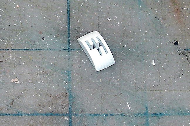

Harry P. Posted July 13, 2015 Author Posted July 13, 2015 Here's a part that Model Motorcars doesn't offer, but should. The shift gate. Pocher doesn't include it, so I scratchbuilt it. I took some sheet styrene, the thickness of which matched the thickness of the slots I wanted. There are seven layers laminated together here, with the shift pattern formed by leaving the appropriate gaps to form the slots. Then I used a Dremel sanding drum and hand sanding with a sanding stick to form it into the half-round shape needed. A little more fine tuning by sanding, then gloss black and finally "chromed" with Spaz Stix. BTW... on this car reverse is left and up, 1-2-3-4 are to the right of reverse.

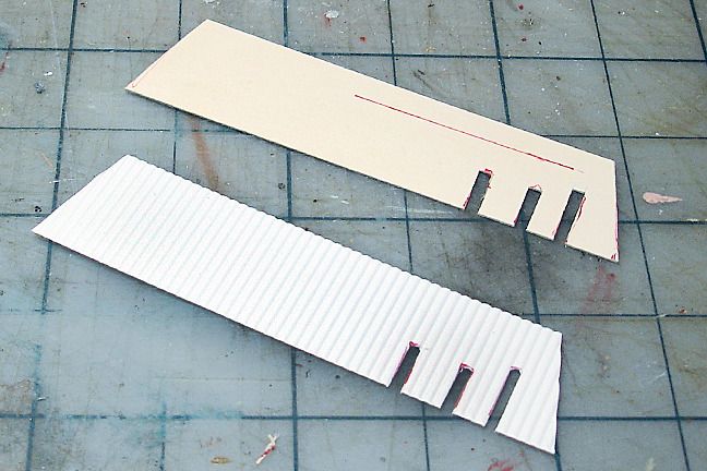

Harry P. Posted July 15, 2015 Author Posted July 15, 2015 The toeboard part of the floorboard had three individual cutouts to accommodate the shafts of the gas, brake, and clutch pedals. But these cutouts were spaced differently than the actual spacing of the three pedals, so I cut away the portion of the toeboard around the pedals, then made a cardboard template, and finally a new toeboard with slots aligned to the pedals, using the same corrugated styrene sheet as I used on the rest of the floor. I also made the new toeboard bigger... there would have been a big gap between the firewall and the kit floorboard... this new, extended-forward toeboard gets rid of that gap. And here is that new toeboard installed, and cutouts made for the brake lever and shifter. I will be using the kit's front seat frame/bulkhead panel, but not the kit upholstery, as I don't like how the kit seats are engineered. I'll redo the seats and upholstery from scratch... Since the woody body will be slightly wider than the kit body, I needed to add some material to the bulkhead (the ends of which is where the door posts will attach). I also added some square styrene rod as reinforcement between the seat bottom and the bulkhead for added strength.
