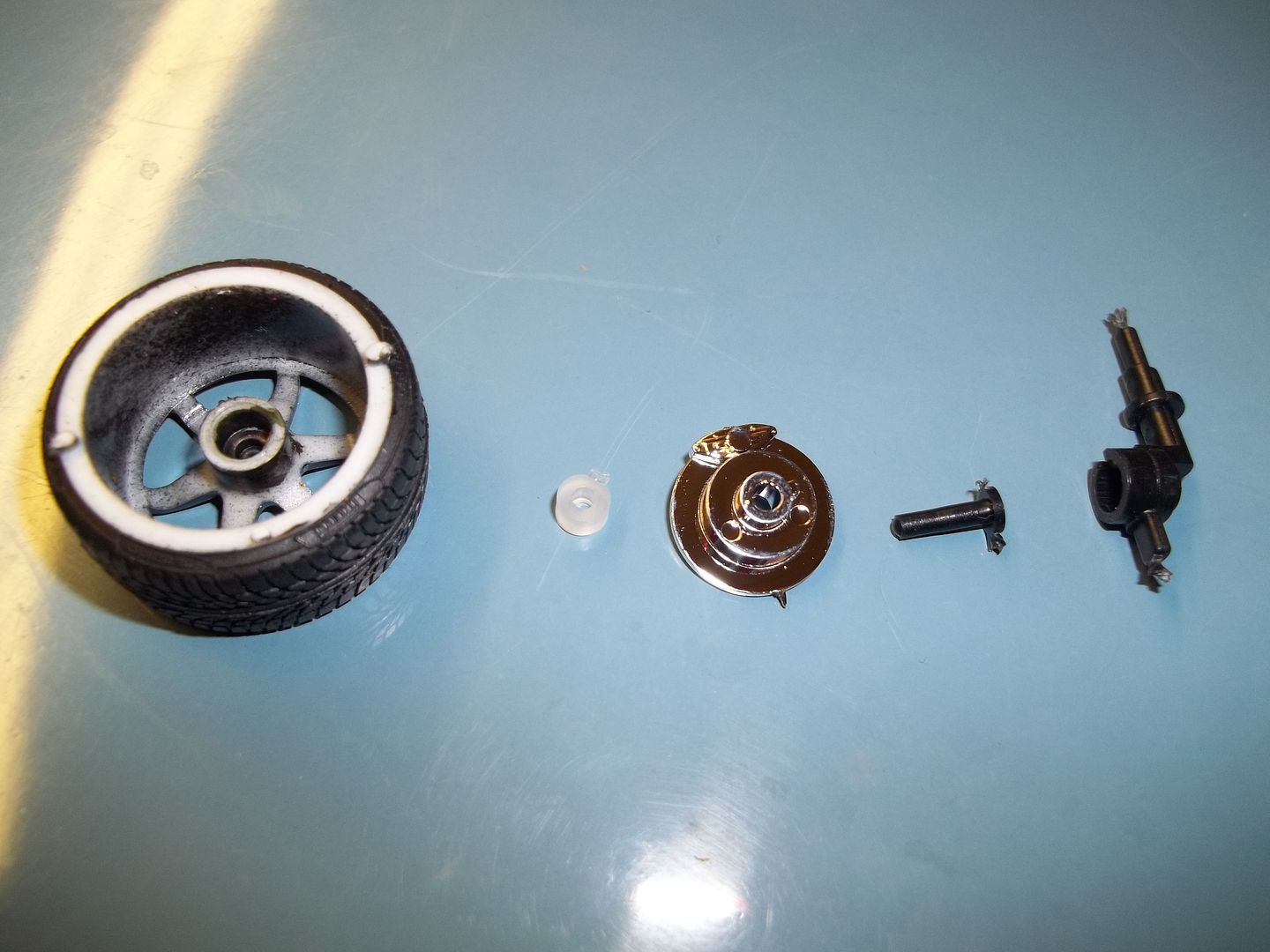

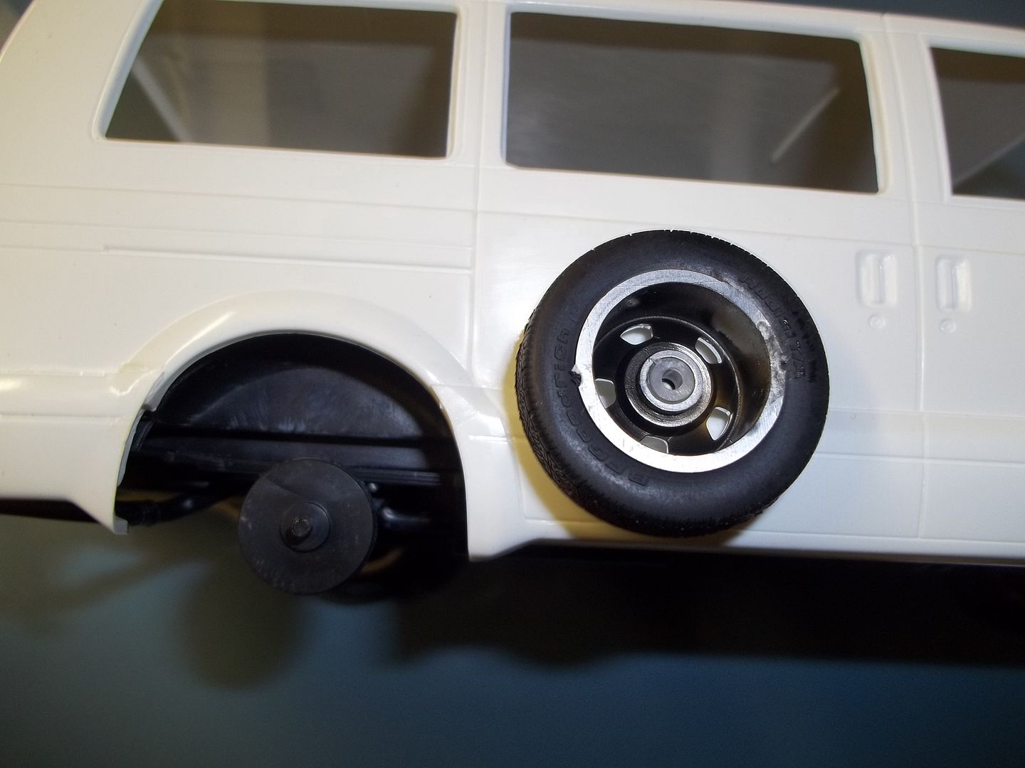

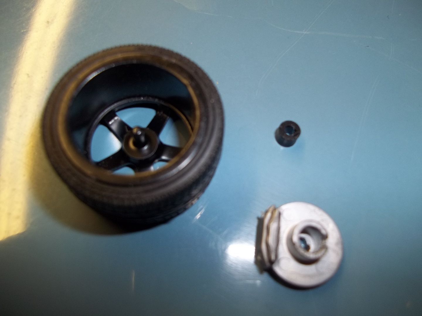

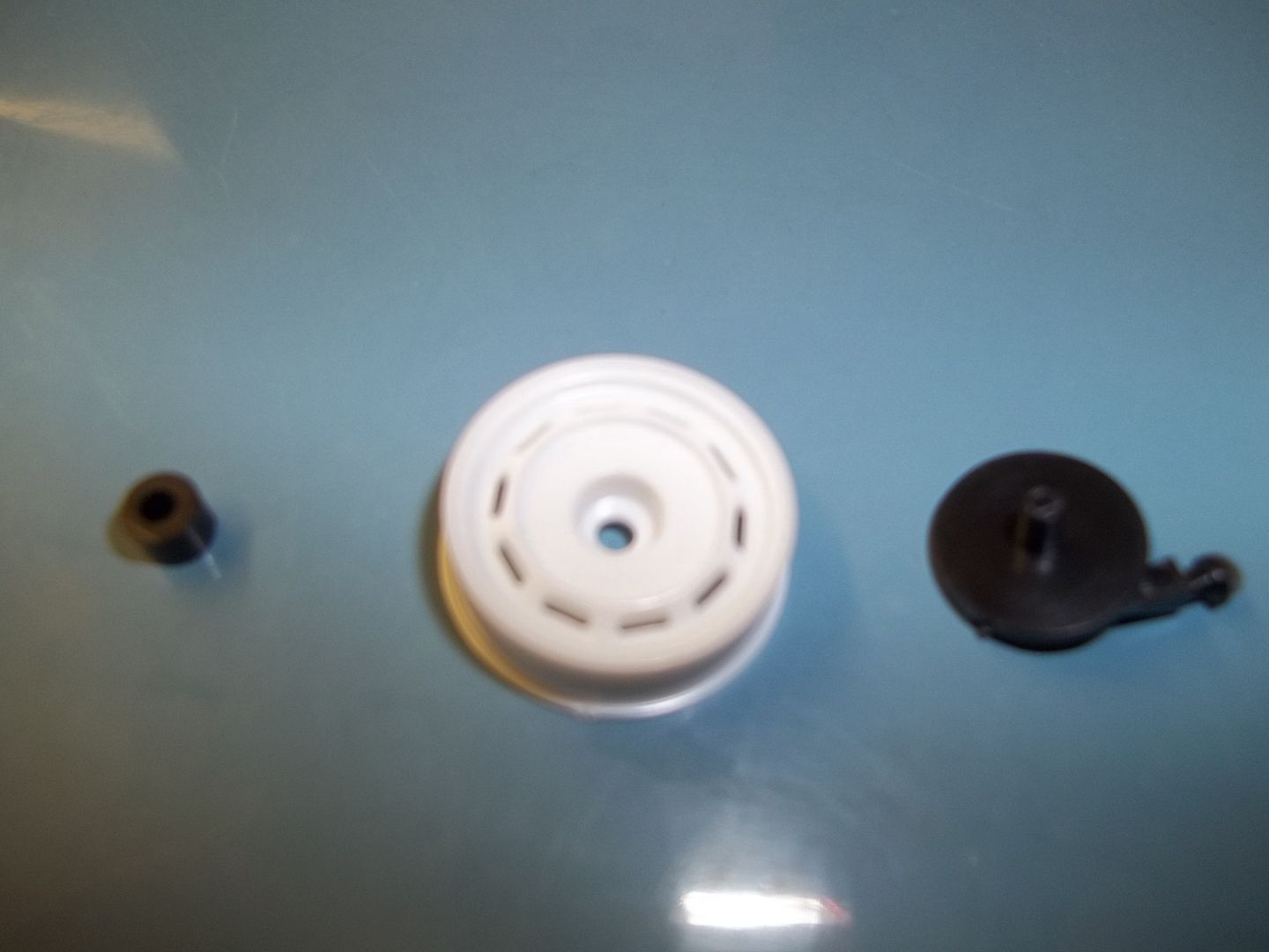

Longbox55 Posted July 1, 2015 Posted July 1, 2015 The black piece on the right is a poly cap. In addition to being used for wheel mounting, they are also used in scale models of mecha figures (Gundam, Macross) for the joints. The one shown is for a Tamiya Skyline, the cap mounts inside the brake rotor. another style, poly cap is the translucent part next to the rotor. This one is also for a Skyline, and Aoshima Top Secret version in this case Cap mounts in the wheel from the inside, and slips over the pin, which is mounted in the spindle and trapped by the rotor Another variation, Fujimi Astro van in this case. The cap is already installed in the wheel, it goes in from th inside of the wheel and mounts on the molded in pin on the axle. One last variant. This is the Hasegawa VW Type 2 wheel I spoke of in my earlier post. In this case, the cap goes in from the outside of the wheel, and is trapped by the hubcaps (not shown). It mounts over the pin on the spindle. As mentioned, there are a few other variants, such as mounting on a metal axle, plus the MRC wheel adapters mentioned in a few posts. I can get some pix of those as well, if anyone wants to see what they are.
