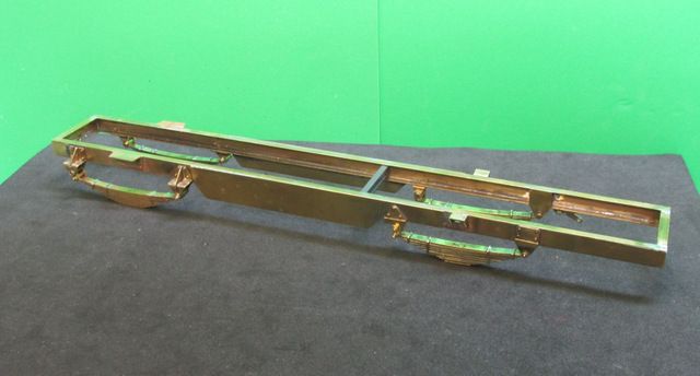

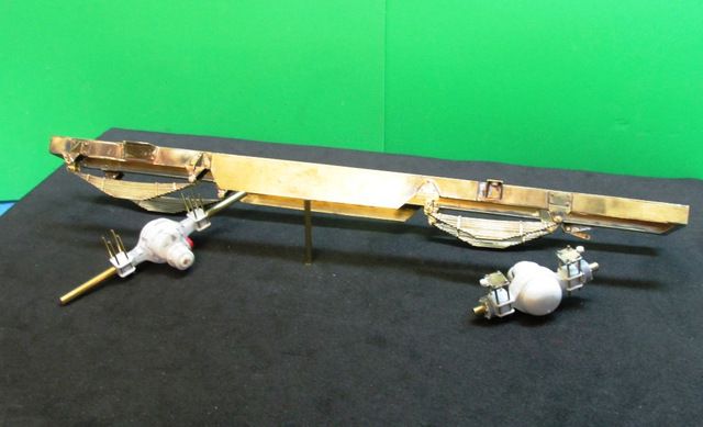

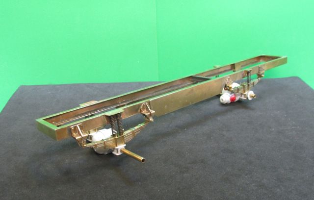

Rear springs are in the can, so to speak.  "U-bolts" that tie axle to springs are made up and coil shocks are in place temporarily.  They need to be secured by gluing some bits of plastic tubing to the bracket and top of the spring plates to hold them in place.  Front ones are done that way.

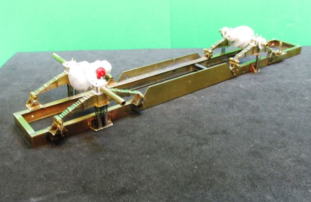

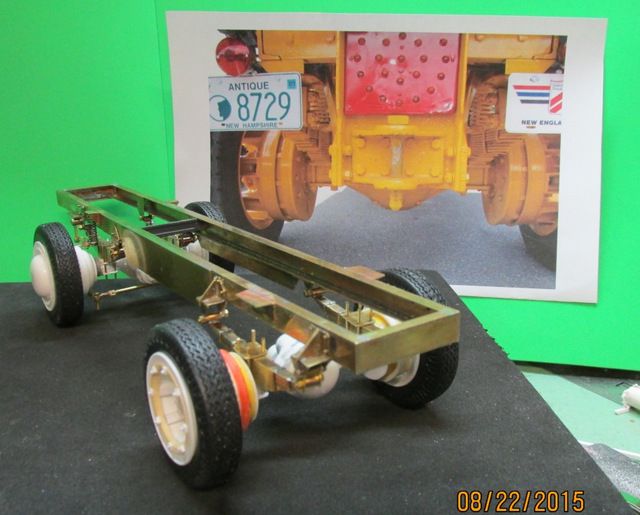

Well, it's up on all fours.  But not to my liking.  The back sits about 3mm higher than the front so I have to do some tweaking in the form of artistic license.  I'll cut a notch in the rear springs enough to bring the back down close to level with the front.  If I can get it dropped 2mm that will be enough.  I can live with a 1mm "rake".  The rear hubs are not made so that I can slip off the center part, slide it on the brass axle, secure it with a brass washer and then slip on the rest of the wheel and secure it with some two part resin.  Securing it with superglue would not allow enough time to make sure it is even all around and doesn't wobble.  Besides I need to do a lot of detailing and painting before the outer wheel can be set in place.  And the rear coil shocks need to be secured with some small pieces of plastic rod.  This has been kind of an engineering puzzle as well as a modeling one so it has been fun to do.

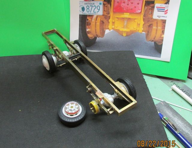

In the third photo you can see the center part of the wheel that looks like a small gear.  That is the part that slips out and is then put on the brass axle with a washer in front of it to secure it.  Then the wheel slides back over it.  To do that and get it centered I measured the inside diameter of the plastic tubing that it sits in.  Then measured the outer diameter of the "gear" tubing.  The difference is then divided in two and small strip stock is glued to the gear tubing that is half the difference.  Doing that in several places insures that when the two pieces are brought together they will be centered.  The same procedure was used to center the wheel's outer rim to the 8 spokes and center hub.  It made it so simple to do and with practically no sanding.
I don't know for sure if the rear wheels could be doubled up given the spacing of the wheel and brake drum but many of these old trucks used single wheels because it put more weight on a smaller surface for traction.  The track of the rear wheels is only 80" outside to outside.

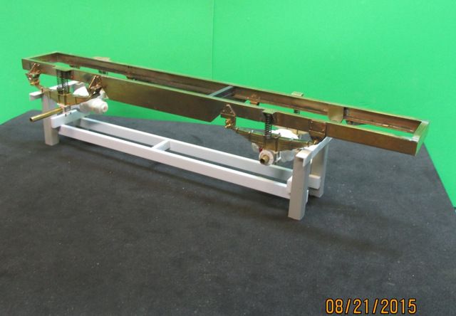

Today I worked on getting the frame to sit level.  Instead of notching the rear springs like I mentioned above I decided to modify the shackles themselves by raising the tubing that makes up the connecting points for the ends of the springs.  The old ones had to be cut off, the face of the shackles ground down and new tubing was soldered in place.  then the extra tubing was trimmed off leaving the small round openings in the shackles for the bolts to go through.  The results were good.  Now the frame is only a half millimeter or so out of being level from front to rear and I'm not going to try and improve on that.

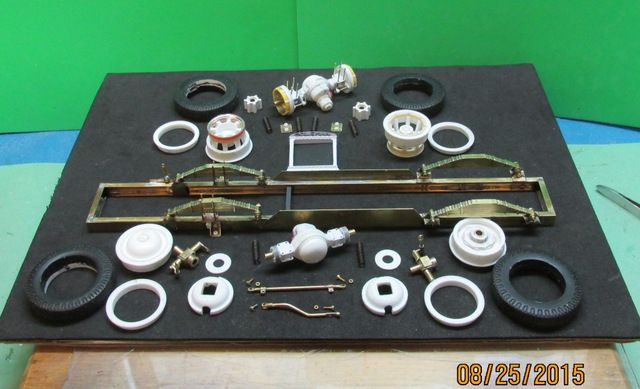

Thank you all for your kind comments.  Here is a pic of the parts so far.  I didn't take the springs out of their mounts but you get the idea.  Next could be the engine and then the drive train.  Lots of things going on with those details.
I just noticed!  I forgot the front wheels and tires!:unsure:  So a quick trip back to the bench and a new photo!:D

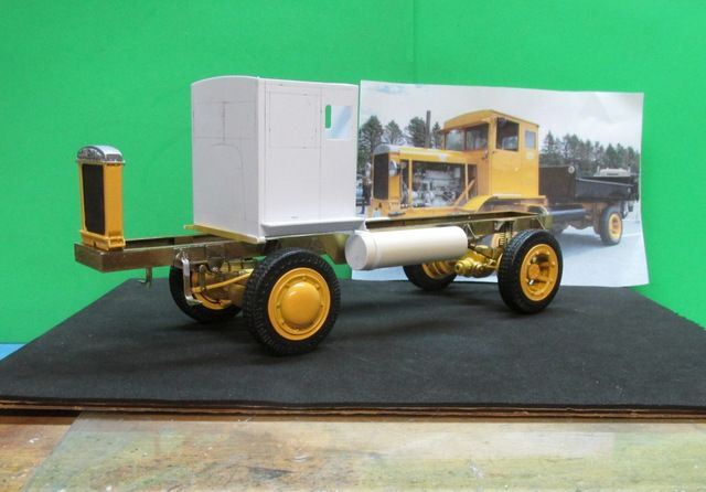

Here's an update on the build so far.
Fuel tanks are made up and in position, front fender brackets are mounted, the radiator was re done with a smaller top and the cab shape has been completed.  Lots of cab details left such as opening up the doors and doing some rivets along the corners.
I found a good yellow color at Michaels craft store  The frame will be shot with Duplicolor etching primer before receiving the finish coat.  Now that the radiator is positioned and the cab location is set I can begin to set up the engine block and drive train assembly.
