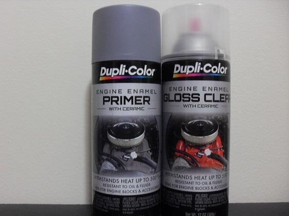

paints_001.thumb.JPG.75cfea75ff515ed9b07
I just wanted to show you guys these awesome products I ran across......... The primer lays on super smooth and thin, and is "tough" enough to handle the Perfect Match paints.
The clear won't craze itself like the acrylic enamel will, and is rock-solid dry overnight........... I didn't like the spray pattern the tips made, so I switched them out for Perfect Match tips........
