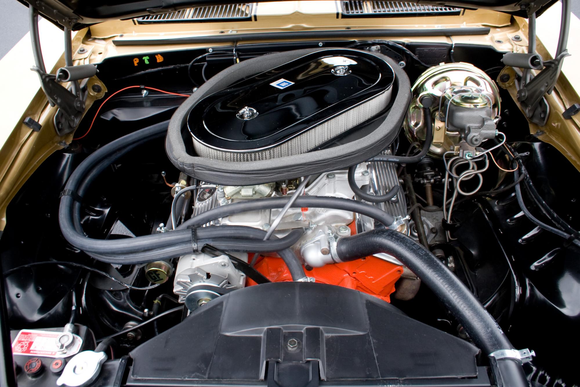

gtx6970 Posted August 2, 2015 Posted August 2, 2015 Check me if I'm wrong here, but weren't/aren't parts such as hood latch striker plates (indeed the latch itself) and hood hinges originally cadmium-plated? ArtDepends entirely the car / model being replicated. I think most GM stuff is / was a dark grey phosphate .Mopars are/were a dark brownish red colored zink on the hood latch stuff and the trunk latch stuf is clear zinc.

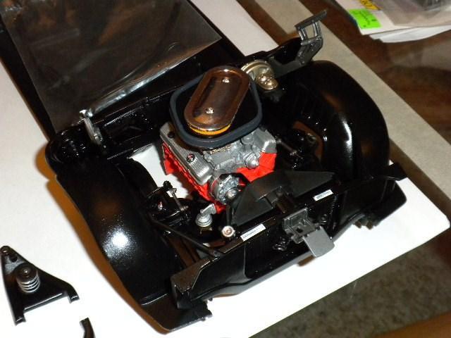

swede70 Posted August 9, 2015 Author Posted August 9, 2015 (edited) Just a brief update, ...this would be my 1:12th Camaro taking shape. MM Titanium in a rattle can was used on the sketchy hood hinges, while the hood striker plate will likely need something different yet. Notice I'm playing around with air filter colors, trying here to approximate a dried out and long neglected low mileage original. Thanks... Mike K. Edited August 9, 2015 by swede70
