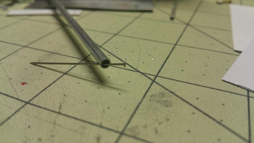

Nytrozilla Posted October 26, 2015 Author Posted October 26, 2015 (edited) Hi Guys. I'm still working on it. Sad news to report though. I've tried Gorilla CA, Loctite, and Z-A-G. Too bad none of them worked. It took next to zero pressure to pop the connection.I went out this morning and picked up some JB Weld, which I've been wanting to try. I'll let you know the results later, but I'm also going to pin the connection. In other words, I'll be using a larger diameter tube for the spindle bolt, but I'm going to drill a hole in the side of the spindle tube and literally insert a pin through the inside that will insert into the axle. I've already checked to make sure the spindle bolt clears the pin head inside the tube.Pictures will help better than I can explain.Wish me luck..................................where's that stupid mailman? Edited October 26, 2015 by Nytrozilla

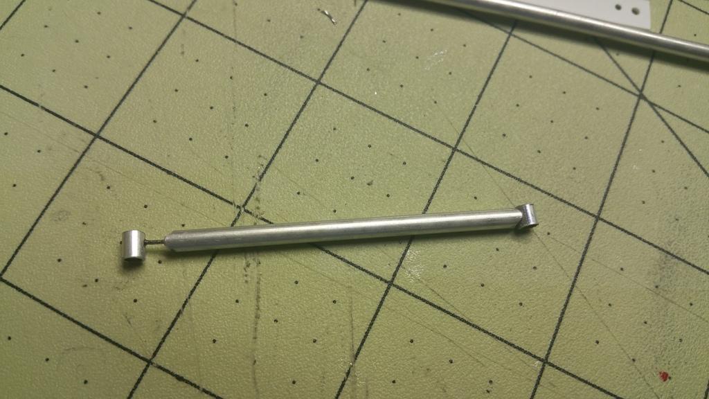

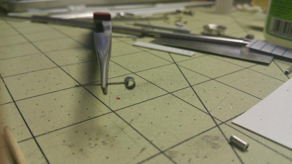

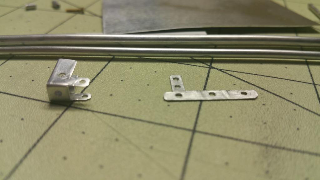

Nytrozilla Posted October 26, 2015 Author Posted October 26, 2015 Brad, thanks a lot boy, just the same. I've always wanted to say that. Thanks Gene & Michael. I'm including a pic of the Z-A-G I got. There's no expiration or "use by" date on it so I don't know how fresh it is. I sniffed it real hard and now I can't find my navel. LOL Here's what I'm trying to accomplish. This will be the front axle. The tubes with the pins in them are what I'm calling the spindle tube that will have a bolt running through. That's why I called it "load bearing" earlier. Also here are some preliminary spindle bracket designs. Please keep in mind this is all preliminary, subject to abuse according to the wrath of the builder. Oh, one last thing Brad. Package received. Now I can honestly tell people if they get help from you, you'll give them sheet. Seriously, THANK YOU TOO MUCH. I'll use the thicker one for the new spindle brackets. NICE!!!!
