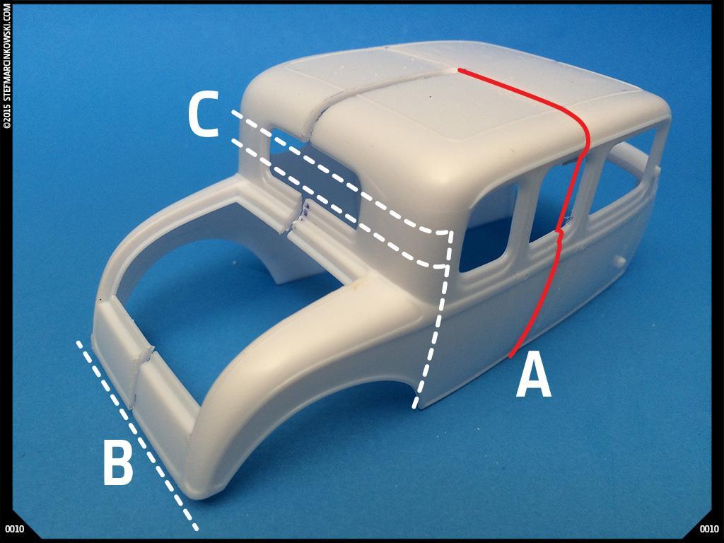

Stef Posted September 29, 2015 Author Posted September 29, 2015 (edited) Hello everyone I noticed the middle passenger side window was too wide, so I risked taking a super-thin slice out of the body (A). That delicate cut ended up working out OK, and also straightened out the misaligned rear valence (B). I've rethought the hunchback trunk cuts, which I now think can be done by simply hacking out a horizontal slice from the rear window/sides, and pushing the trunk up (C). Hope this works. Hey, misterNNL, I totally overlooked the necessity of a beefy frame. I was prepared to start with the kit-supplied rails, but now you've inspired me to create something thick and meaty, from scratch. Thanks! Ha ha, mod3l Lover, yes, that would be total badassery. I have the 1/25 Revell Peterbilt 359 that I would LOVE to gut for this thing, but I already have plans for it. Photoshop mockup attached. I hope I can get to this some day. Edited September 29, 2015 by Stef forgot to add "(C)"

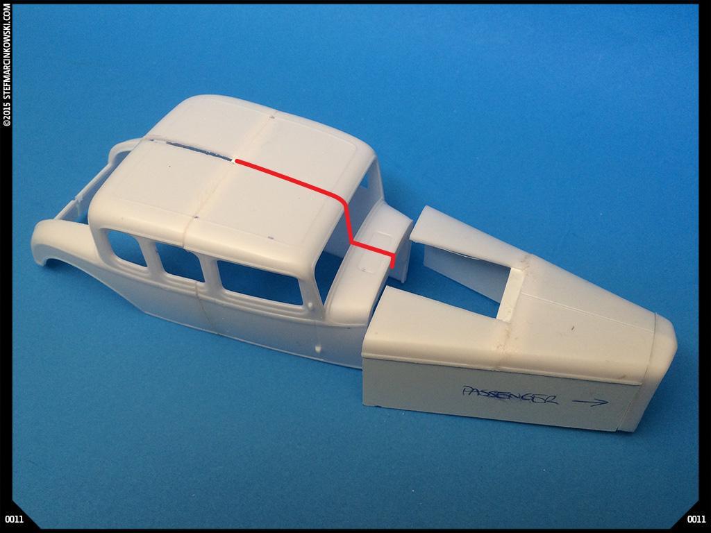

Stef Posted September 29, 2015 Author Posted September 29, 2015 I've created some basic hood sides from .020 styrene sheet, and mated them to the hood tops. To ensure proper vertical alignment, I taped the grille shell in place. Now, I'll split the hood and body down the middle, tape the left halves and right halves together, wrap them around the engines, then trace out a frame pattern. Also, hoping to finish the revised Photoshop side view mockup ASAP.

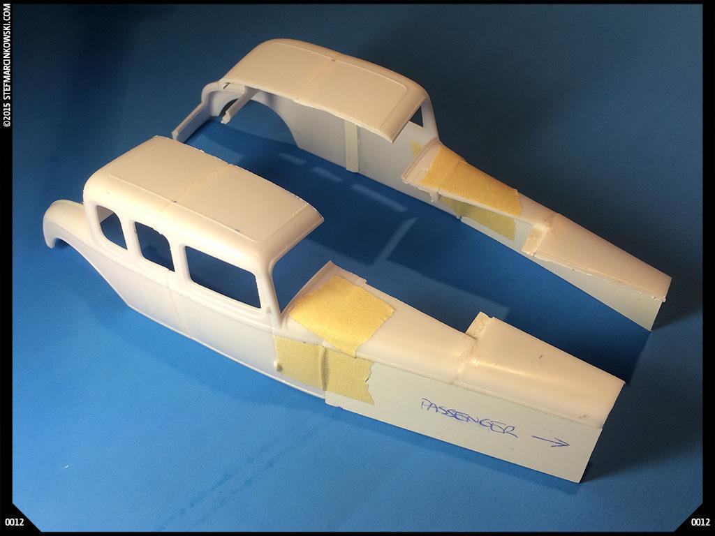

Stef Posted October 4, 2015 Author Posted October 4, 2015 Sliced the body and hood down the middle, and taped the left and right halves together.

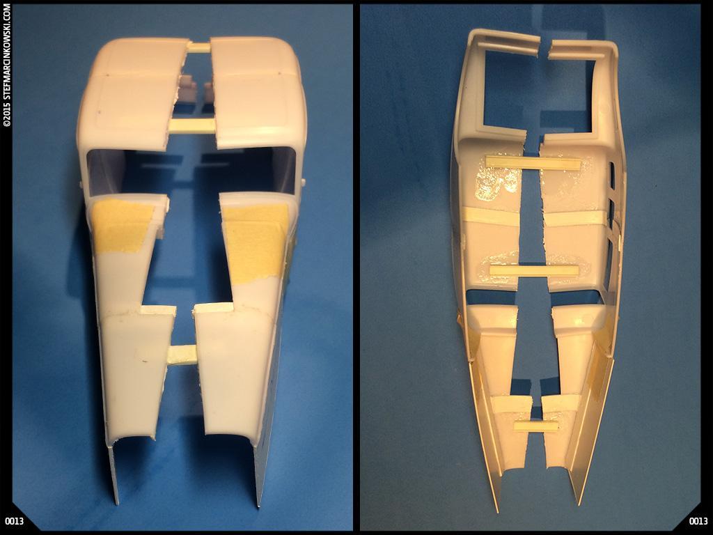

Stef Posted October 4, 2015 Author Posted October 4, 2015 Spread the body apart at the rear, and spread it further apart at the front to clear the engines, while creating a wider grille opening. Tacked the left and right halves together using styrene strip. Next up, filling in the roof and hood with styrene sheet, then slicing off the trunk and repositioning it to create the hunchback. Still working on the revised sideview mockup. Coming soon.

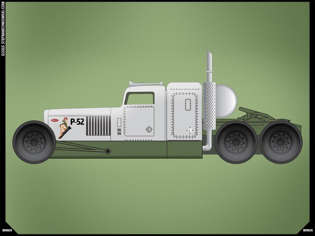

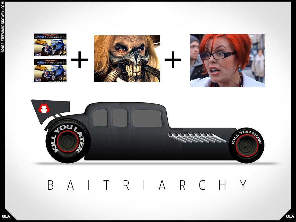

Stef Posted October 9, 2015 Author Posted October 9, 2015 Thanks everyone for your awesome encouragement; you all rock my world! I've refined my initial concept, and come up with a name. Here's a more concrete vision of where this baby is going. Been an insane week; aiming to get more progress done ASAP.
