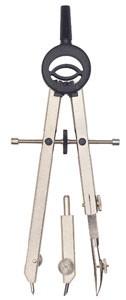

SfanGoch Posted September 21, 2015 Posted September 21, 2015 You can also use a ruling pen attachment on a compass to spiffy up them Red Lines and Blue Streak Racing Specials. You have more control than would be the case with a tire spinning on a drill.
