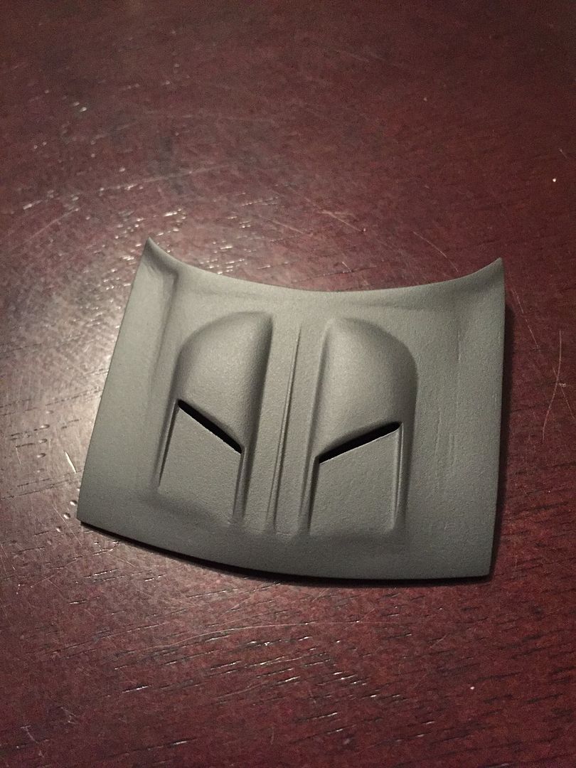

kymdlr Posted October 3, 2015 Posted October 3, 2015 Need some advice on how to over come this snag. Essentailly I grafted one hood onto another and used filler strips of plastic to fill the gaps. Sanded it smooth then covered it in automotive polyester finishing putty. Sanded that down then added two coats of bondo glazing & spot putty. After sanding the bondo, I sprayed a few coats of primer hoping that i would have a smooth finish and no problems. As you can see, even after a couple coats of primer, you can see the lines through it. What do I need to do?
CoyoteCrunch Posted October 3, 2015 Posted October 3, 2015 Man, your so close now. Maybe just some more light sanding in between a few more light prime coats will fill these lines.
Ace-Garageguy Posted October 3, 2015 Posted October 3, 2015 (edited) I do a lot of heavy mods and bodywork, and I have a few ideas and suggestions you may want to consider.1) The shrinking of the lines in your filler under the primer is a common problem. It occurs because of the difference in solvent absorbency and sensitivity between different materials. As Tom suggests immediately above, sanding the entire bad areas and re-priming, perhaps repeatedly, will most likely kill the ghosting eventually. It depends on what type of primer you use too, how wet you shoot it, how long you let it flash, and how long you give it to dry thoroughly.2) To minimize this kind of problem in the future, try to fit your inset panels very well. Tight seams require less filler.3) When you have your inset or spliced panels glued together and the glue is THOROUGHLY dry, sculpt the seam surface BELOW the level of the surrounding panels. This will allow you to fill the seam with your 2-part automotive putty, without the seams showing as they do on this work before it was primered. You'll then have a more even substrate that will tend to shrink at closer to the same rate.4) Try to do your bodywork as perfectly as you can BEFORE you primer. Don't hesitate to fill and sand multiple times to get the surface as good as possible. 5) You can do ALL your bodywork with the 2-part material. The single-part material is really pretty obsolete, is extremely sensitive to the solvents in primers and paints, and is well known to shrink and cause ghosting like you have here. Though some people still swear by it, to me, its ONLY use is for filling TINY pinholes and almost invisible flaws.6) There's no easy guaranteed tricks to this stuff. Experiment to find techniques and materials that work for YOU every time. I've been doing custom bodywork on 1:1 vehicles and models for well over 40 years, and I could fill a book with tedious explanations of procedures most people aren't going to read and follow anyway. Practice and experiment, and DON'T TRY TO RUSH IT.PS: I do know a little about this stuff. Here's one of mine... http://www.modelcarsmag.com/forums/topic/65965-mickey-thompsons-challenger-one-still-alive-feb-8/?page=1 Edited October 3, 2015 by Ace-Garageguy
Snake45 Posted October 3, 2015 Posted October 3, 2015 Quick & easy solution to your problem at this point: Fill your lines with superglue.Do it right over the primer. Sand down into the primer, reprime, repeat as necessary.

kymdlr Posted October 4, 2015 Author Posted October 4, 2015 So "ghosting" is my problem. I will try to fill with superglue then sand and see what happens. Bill, The bondo putty you pictured is the same that I used on this hood. Normally I use Dupli-color high build gray primer following body mods like this and its usually successful. This time I used a normal duplicolor gray which the results you see.... For future reference If I use a "primer sealer" would it prevent ghosting?

Tom Geiger Posted October 4, 2015 Posted October 4, 2015 The issue I find with using super glues as filler is that it sands at a different rate than the primer around it, sometimes leaving it's own edge to repair. One of the things I do with very small imperfections is fill them with the same primer that you have used. Sometimes a dab of it into a small imperfection, like a rain drop placed from a toothpick, will dry down a bit and the remainder will be easy to sand blending right into the surface around it. I've also taken same primer, sprayed into a small cup and left to thicken up a bit as it dries out. This works well too.
