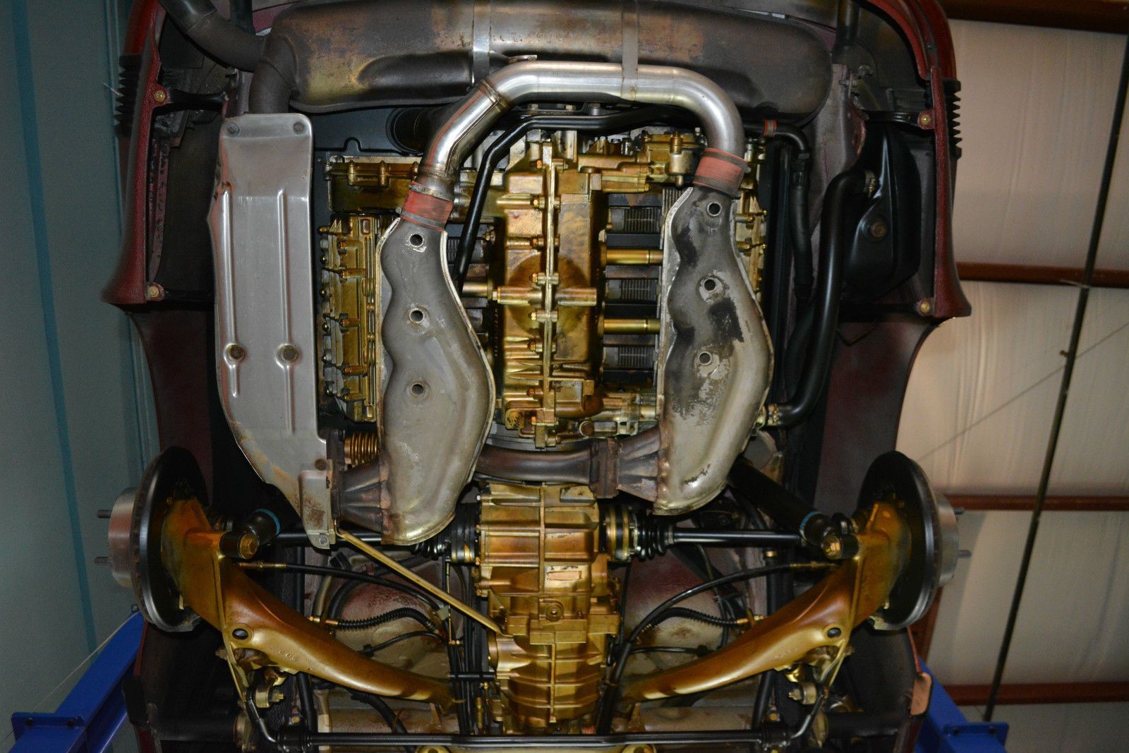

The cosmoline I'm familiar with, applied to new cars before shipment (particularly new cars coming by sea) was a yellowish-brownish concoction looking exactly like this goop on the underside of a Porsche. We removed it with mineral-spirit-based solvents.
