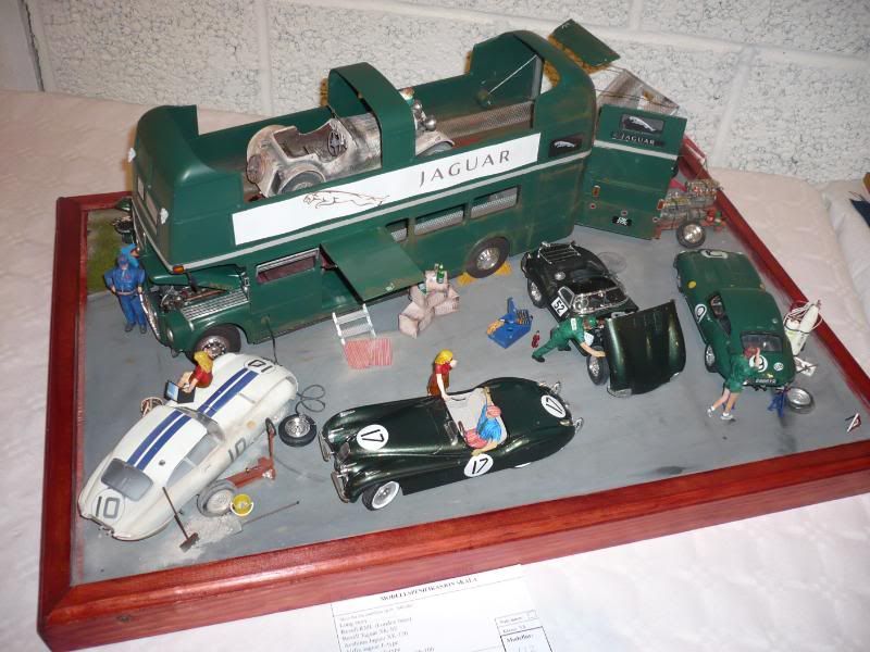

Atmobil Posted October 29, 2015 Posted October 29, 2015 Fantastic idea, I really dig this one. I don't want to spoil you fun but a guy in the Norwegian IPMS did make a race transporter out of this bus a few years ago. Here is a picture of the diorama he made at the 2012 IPMS show. He called it "A lord and his lorry"

The Creative Explorer Posted November 8, 2015 Author Posted November 8, 2015 Thanks guys again! @Gaute, a little bit, but not too much. I am planning to make my transporter quite different. So, no biggie. @Tom; Well, don't forget I am living in Europe, they are quite less expensive. I think I paid around 50 dollars for it. Time for a huge update, lots of pictures too. I started with making the ramps on the lower deck inside, these will be fixed ramps. Added a guide edge to it I made a new wall/divider for the lower deck, this will divide the car from the small workarea/storage. Including a door Dryfitted together I started with swapping the door and window area on the left side of the bus The window is now moved one slot to the right and in the remaining hole will come the door.
