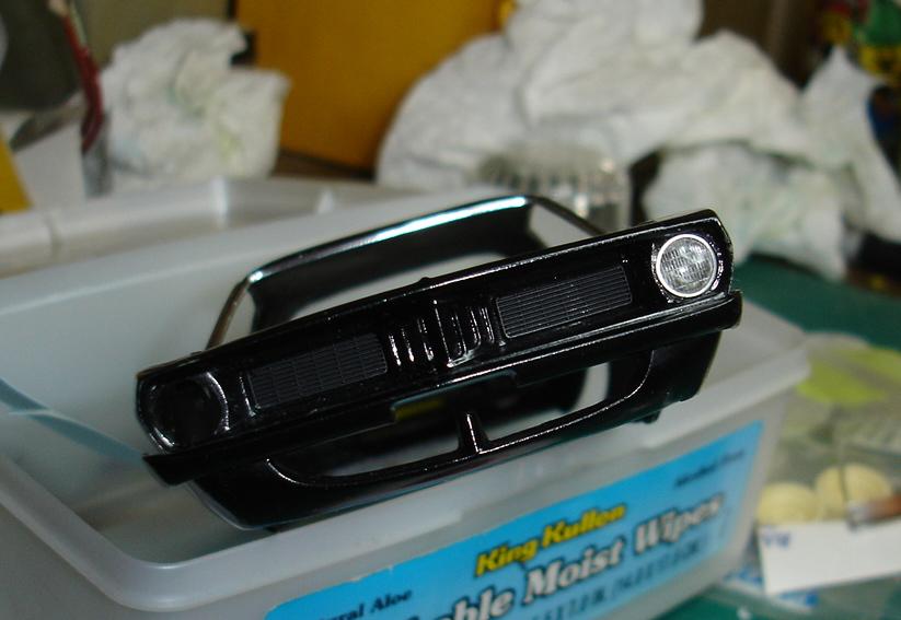

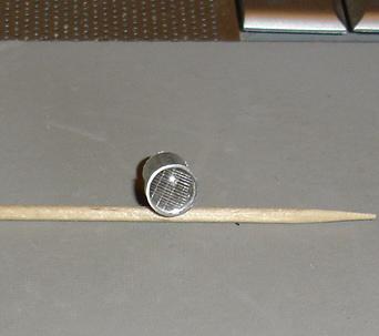

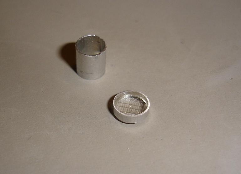

The headlights were relatively were relatively easy to make. This idea of mine was featured as a tip in Scale Modeler magazine a few years ago.
You'll need a few matching headlamp lenses and some aluminum tubing. I used KD 9/32 x .014". A mini tubing cutter is also needed as it makes the "lip" that acts as the trim ring and also holds the lens in place.DSC03042-vi.thumb.jpg.56a05cffb736a648b8
In the second pic you can see the trim ring. This is caused by the tubing cutter. You won't get an even result if you roll the tube with a hobby knife.DSC03043-vi.thumb.jpg.b230912cd7898a6658
DSC03045-vi.thumb.jpg.26f01e3ec3bbed5f22
Drill out the existing "bug eye" headlamp to a size that will accommodate the assy. that you just made and glue in place.DSC03047-vi.thumb.jpg.268e9d2bbbcefbf864
I would spend some extra time and fabricate a  foiled bucket to fit behind the lens to make the lamp more reflective.

Sinking those headlights flush goes a long way toward improving the front end. Eliminates the kit's "bug-eyed" look.
Are you going to modify the inner rims of the buckets so they come out flush with the edge of the grille? This is the part that's hanging me up. I can think of several ways to do this, none of which would be particularly quick or easy.

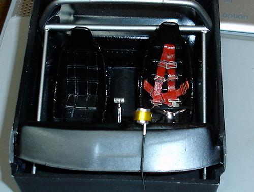

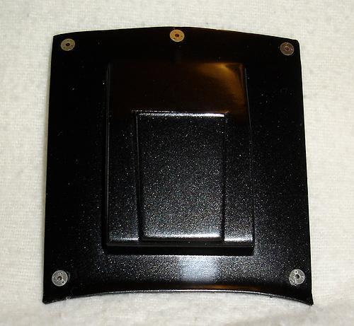

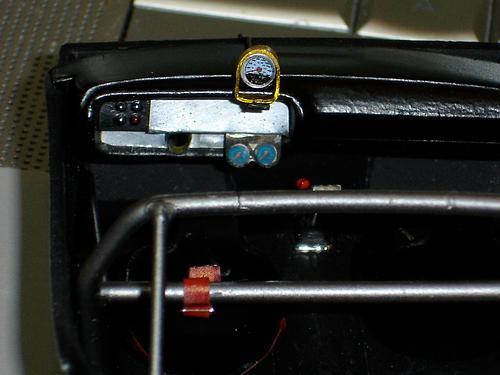

Interior tub:
I hate making harness assemblies with photo etch! It strains every fiber of my being! A real test of patience. But they look good when finished. Always attach the shoulder belts to the cross bar.
DSC03017-vi.thumb.jpg.91adb809559f8f8446
I copied the tach from the Hot Rod magazine photos.
DSC03013-vi.thumb.jpg.1dc02b27589473a1b4

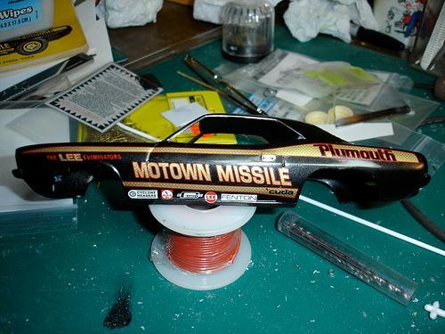

Slixx decals are simply awesome! Good thing that I bought two sets because I somehow got glue on one sheet.:(
DSC03041-vi.thumb.jpg.eb0d2522b9a96d1ac3

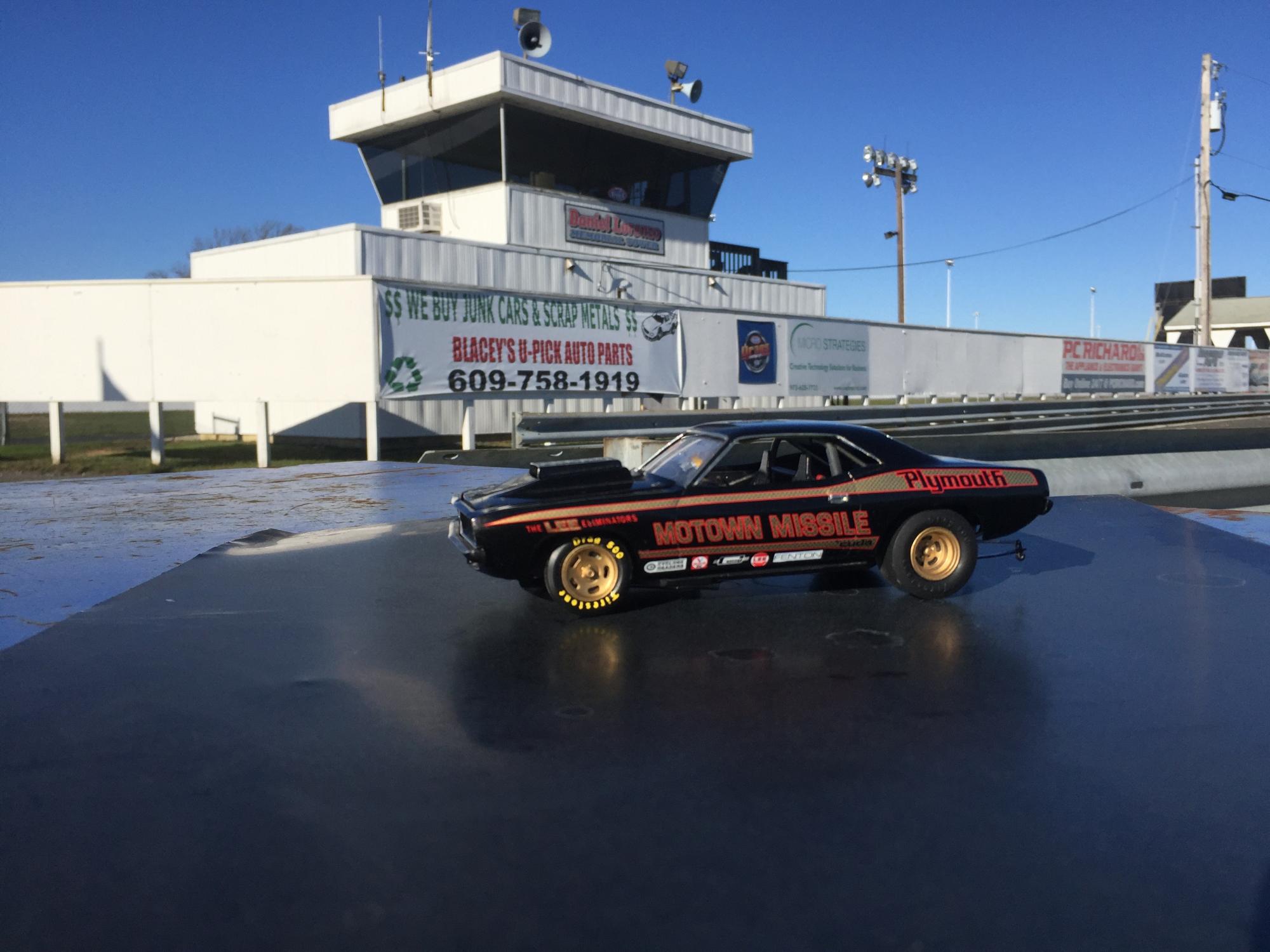

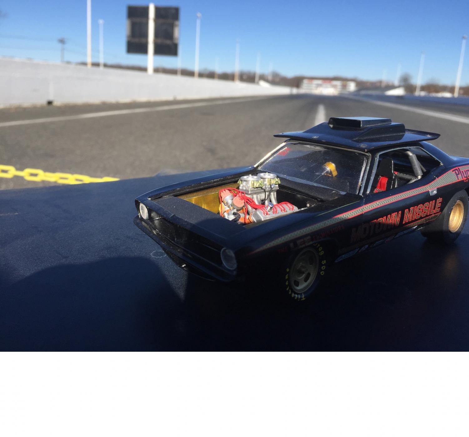

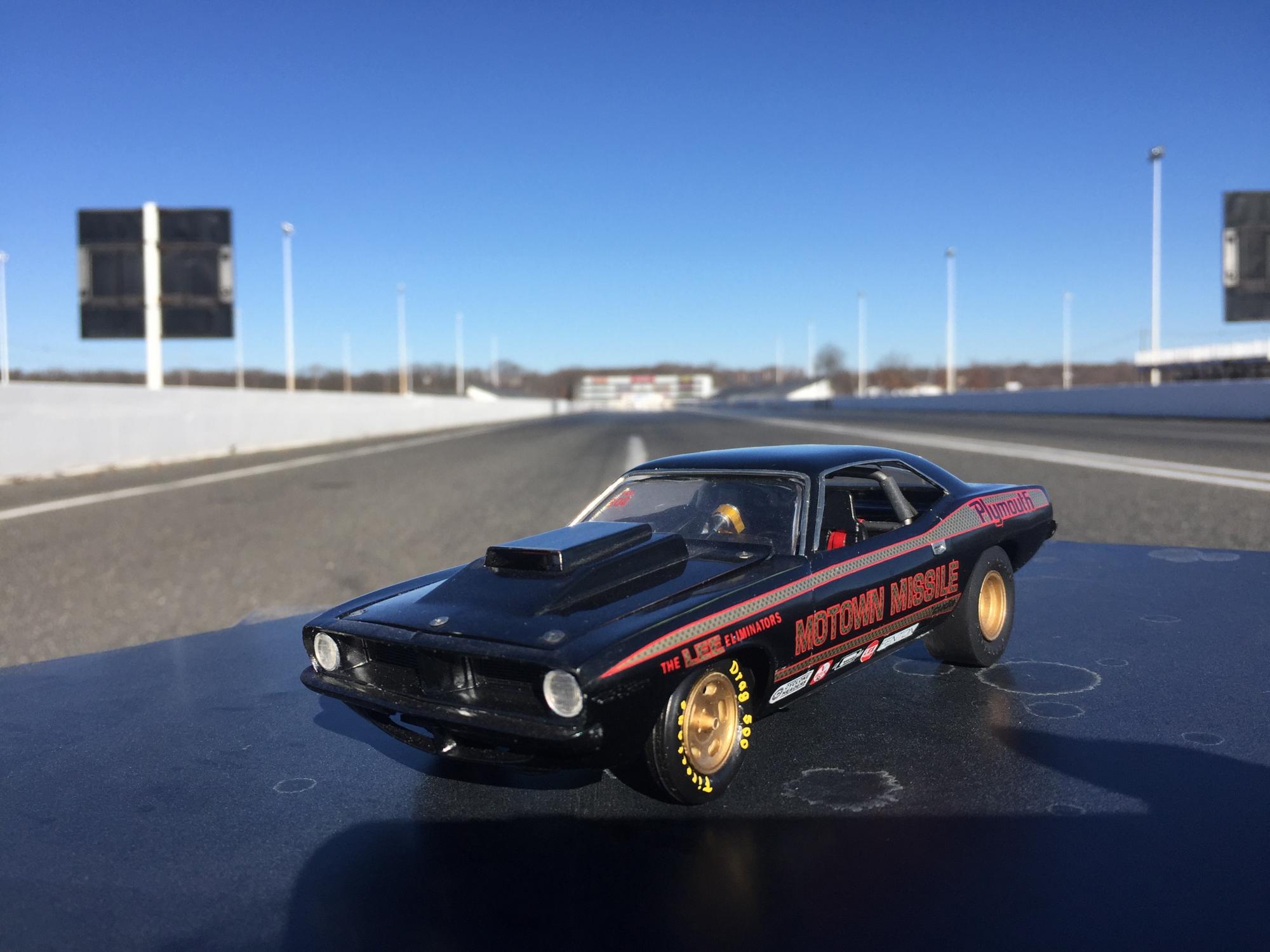

I just knew that the metallic black was gonna suck! I think that I'm gonna strip it and do it over again! The metallic is just too reflective. The sun makes the paint look lumpy and sometimes looks grey. I'm only gonna show you the best pics!IMG_2345.thumb.jpg.32a8d929d9f86c52edcaeIMG_2346.thumb.jpg.a588d58c628a8ea391c8eIMG_2352.thumb.jpg.577ff7cc76f781314cb1aIMG_2353.thumb.jpg.23fec9f99035f011d677cIMG_2355.thumb.jpg.0c648c894f562894a5e60
