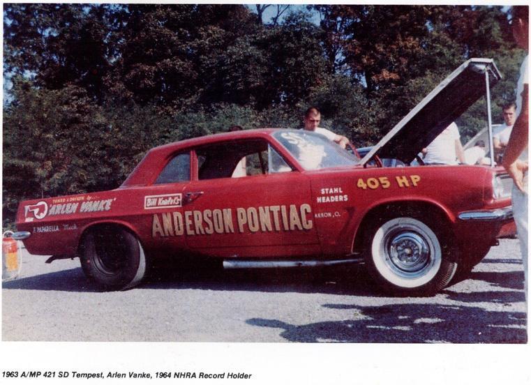

MCW Resin has available 1963 Tempest that can be built into the Super Stock SD 421 cars.  I purchase a couple of these kits and found them to be nicely done.  The versions that I will be building is Mickey Thompson's Yorktown Blue prototype.  This Tempest coupe has markings 755 AF/X on the doors and was driven by KS Pittman and Bill Shrewsberry.  Second version, although not a factory SD421 car, but built with factory support was Arlen Vanke's Marimba Red "Running Bear" sponsored by Bill Knafel's Anderson Pontiac.  The M/T car required modification to the rear glass, as the base Tempest had a larger rear window than the LeMans version.  I have nearly completed the rear window, all that is left is the moldings.  That said, the Vanke car, a base Tempest had the smaller LeMans rear window.

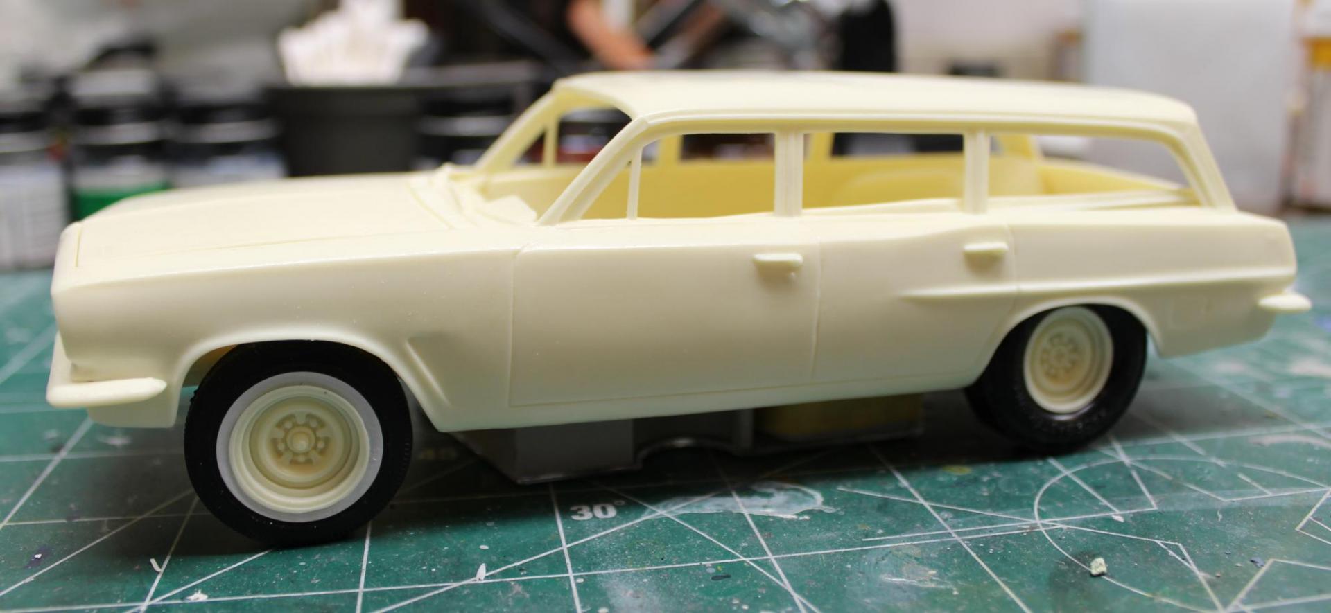

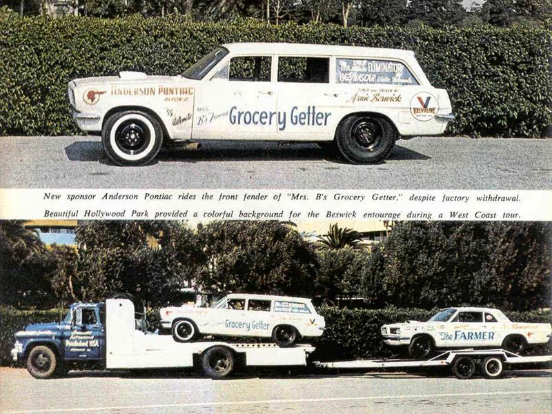

Here is the first of the six 1963 Tempest 421SD wagons.  The first three will be Beswick's car, Vanke Anderson Pontiac, and Royal cars.  This one will be Beswicks Mrs. "B's" Grocery Getter.  Van Winkle Pontiac and Al Hodges Pontiac cars to follow.
