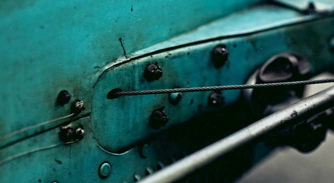

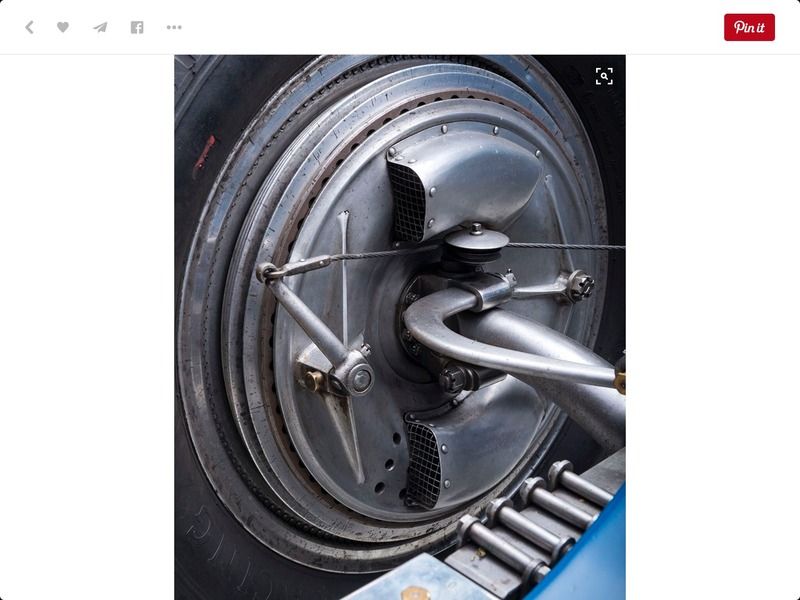

Thanks Mr Skip, some great high resolution pics there and some views I have not seen so very helpful
and brake line routing with subtle "safety wire" body wiring:D

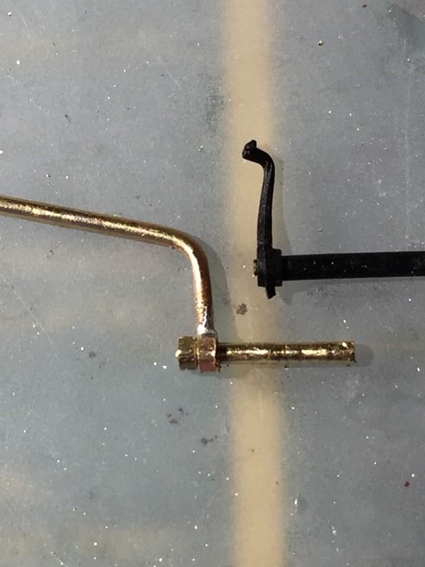

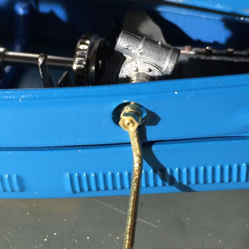

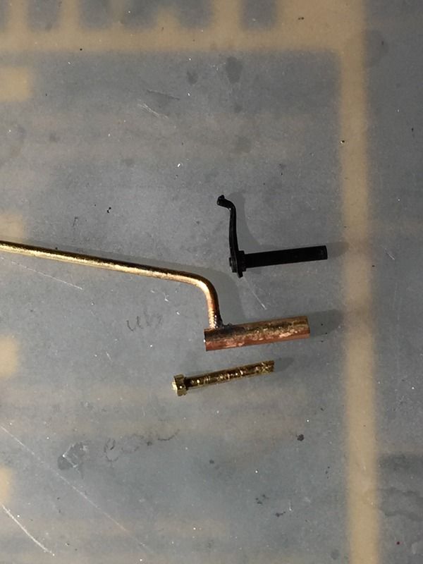

Last night making the steering linkage out of brass rod, nut and tube with silver solder and flameB)
I threaded one end of the solid bent rod and tapped a hole in the tube. That allowed me to screw them together, solder them and then drill out the tube and cut it off to form the ring. Hope that makes sense.
Black is the kit part using as reference

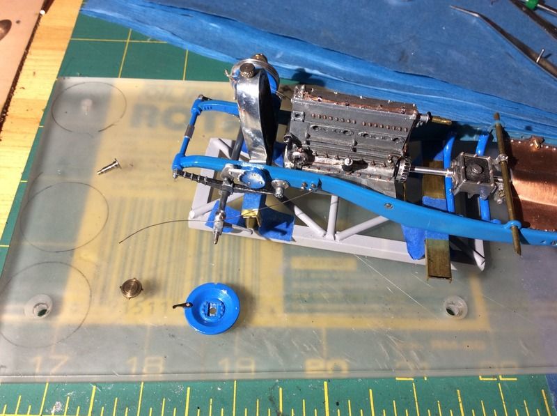

Test fitting onto the chassis
Still have to file the shape more and cut the rod to proper length.
Edited by Twokidsnosleep
Just curious... why not use the kit part?
The plastic linkages are really weak and prone to breakage. I want to be able to solder or screw them where I can
One of the plastic front wheel assemblies did a little creak/crack as I tightened it and I am awaiting a disaster there
So to make a long answer short...Why: to torture myself, practice scratch building  and make it stronger

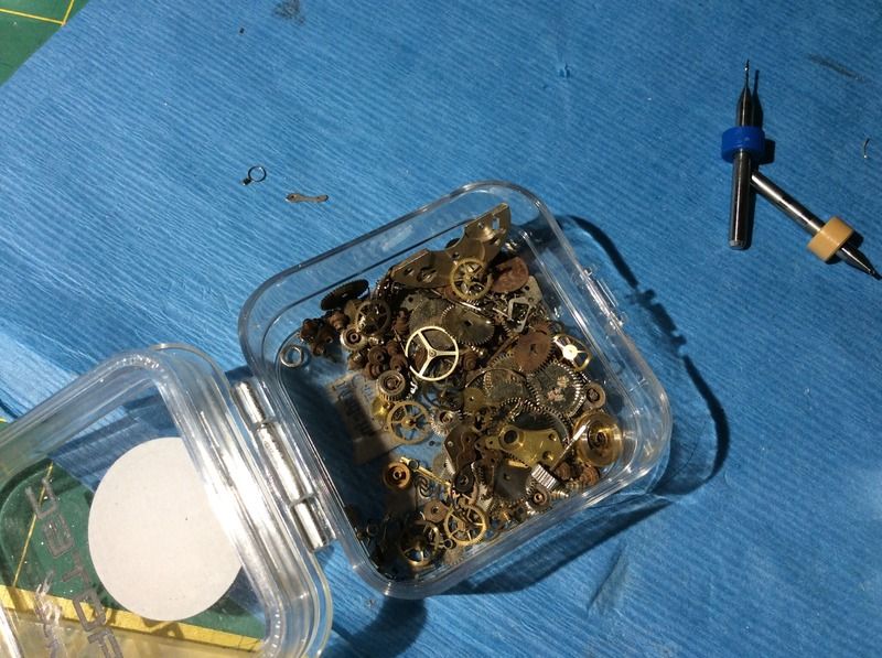

Very cool gadget making Scott. Nice idea and collection of watch parts. Did you buy them as a collection of parts commercially or collect them at home over the years?
Thank you sir :D
I make no claim on the originality of that idea. Our own Skip Jordan suggested  to me a year or so ago watch parts as dashboard accents, switches etc.
You can find them on E Bay very inexpensive
http://www.ebay.ca/itm/5g-VINTAGE-WATCH-Parts-Bits-HO-Model-Train-Slag-TINY-Sprinkle-Steampunk-Confetti-/201508597032?hash=item2eead92d28:g:RQoAAOSwpRRWoXy4
Thank you sir :D
Thanks Scott. Maybe a bit small for 1/8 scale but loads of doo-dads there in 5gm bag...

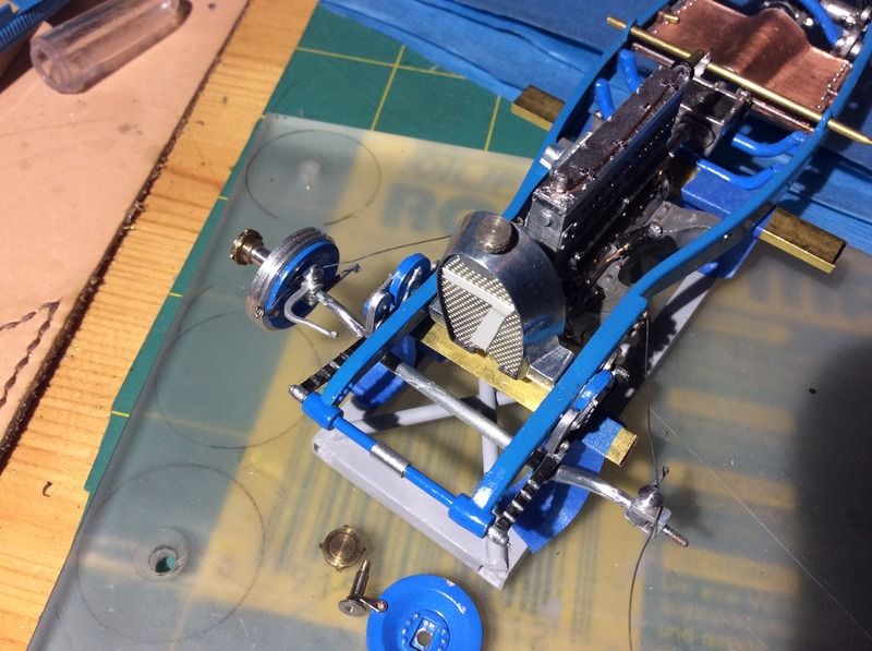

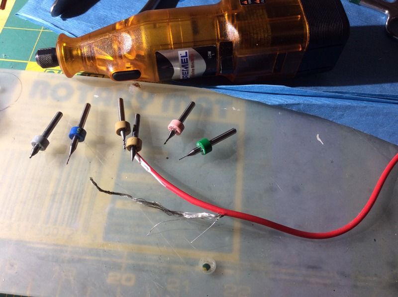

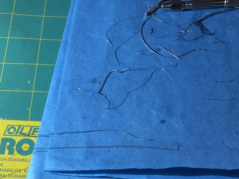

I broke down the brake lines and rethreaded them so they are braided...just intertwined two lengths
It looks better, could just hear the unbearable silence over those skinny wires
I have saved myself from Skip-harrasment;)
Sounds good. How will you keep the wires from unraveling? I'm going to school on your approaches.
Looks easy enough to do, but I'm wondering if there might be commercially available wire in this small size for a lazy guy like me.
Edited by sjordan2
Your silence was deafening!!!
Every time I looked at the wires, I heard your voice in the back of my head...."those should be braided" well, because, really, they SHOULD be braided
 Used a simple winding technique with of two wires, they seem to hold together well as long as not overwound and kinked...then it breaks. I could silver solder I suppose at the ends.
I will get some pics up soon, just a bit busy and currently fighting with wheel hub fitments
Edit: now I look at that great reference photo you posted and see the gauge difference with the brake line and the safety wire..so I am glad I did the braided the cords and will use the single strand as safety wire
What diameter is the wire you  need?  Many computer ribbon cables (like  the ones used to hook up the IDE hard drives, CD-ROM drives or floppy drives to the motherboard) use 30 AWG (approx 0.010" diameter) tin-plated stranded copper wire. You just have to strip the insulation.  It looks just like the cable in Skip's picture.
Edited by peteski
So double wrapped the wire and silver soldered both ends. Larger diameter looks better and the single diameter will be good for the safety wire
I have some of the computer wires as well...they are a bit too thin and floppy for this application (i.e. they droop) but useful elsewhere
I'm not sure we are talking about the same thing. Maybe you are thinking of magnet wire?  The one I was recommending is not floppy at all. Besides, it will be strung between 2 attachment points to keep it taut.

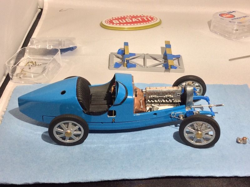

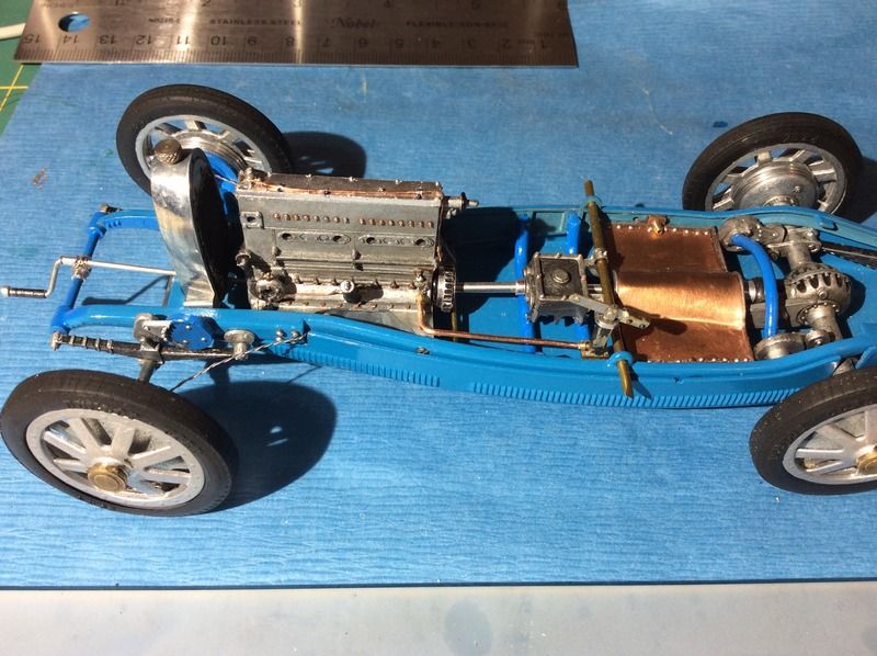

I am getting there with this one, trying not to bore everyone with small progress pics.
Seat is cemented, dash and firewall as well. Made the rear brake lines and attached them to the axle. Was working on the throttle linkage tonight to add some realism to the engine bay. The body is not attatched just yet, still some time to fiddle with fit and get some details in.
I did manage to get a CA glue thumbprint on the back boattail of the body...dead centre top too. It has been wet sanded and the gloss is drying. Few steps forward and then some more back :rolleyes:
