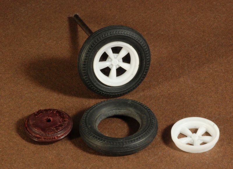

Foxer Posted February 3, 2016 Posted February 3, 2016 (edited) I have a 1/20 Promo of a 51 Plymouth, which I believe to be a Product Miniature Corp. promo. The wheels are a hard rubber and the rims are believed to be styrene. I have soaked them in hot tap water and they did soften but still are difficult to stretch far and I'm concerned about damaging these 60 year old tires. I want to soak them in boiling water but afraid that might be too hot. I know this has been discussed here before and googling it didn't come up with anything. Does anyone have any experience in this that could relate your experience? these are the tires ... Edited February 20, 2016 by Foxer

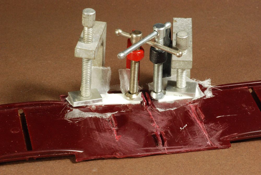

Ace-Garageguy Posted February 4, 2016 Posted February 4, 2016 (edited) Whoa !! You can do the press thing with the clamps you have here...It looks like the one on the far left should have enough height. Support the tire with a ring of PVC pipe, and press the wheel through it using the screw (with an appropriate round washer to feed the load evenly into the wheel). You may need a taller C-clamp to get everything in there, with the end of the clamp under the bench, of course, but it ought to work. Edited February 4, 2016 by Ace-Garageguy

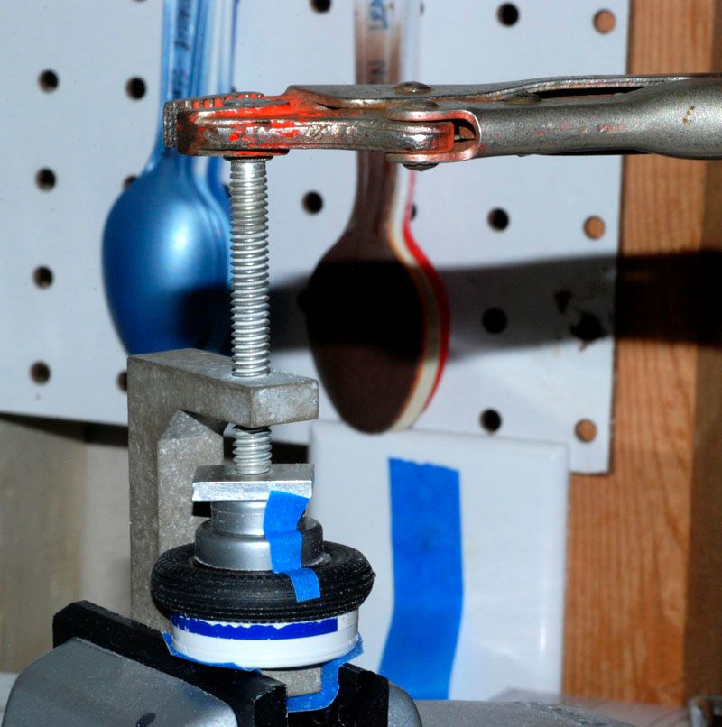

Foxer Posted February 4, 2016 Author Posted February 4, 2016 One trick I have had good luck with is simply laying the wheel face down on some sort of "block" system that just contacts the tire & not the wheel & holds it about an inch from a hard surface like a concrete floor. Then I just give the back of the wheels "light taps" with a hammer checking constantly to see if the wheel is working it's way out. Eventually, it should pop out. I've done this many times & have not broken a wheel yet. Whoa !! You can do the press thing with the clamps you have here...It looks like the one on the far left should have enough height. Support the tire with a ring of PVC pipe, and press the wheel through it using the screw (with an appropriate round washer to feed the load evenly into the wheel). You may need a taller C-clamp to get everything in there, with the end of the clamp under the bench, of course, but it ought to work. Very interesting. That tall clamp has 1.5" spread. I don't need much more than 1/4" or so to press the tire out. I should be able to use pretty short lengths of tubes or dowels. Warming the tire with a hair dryer as I press should help too. I'll have to see what I have to rig that up. I'm waiting until I get the new rims before doing anything, though. I like this idea a lot.

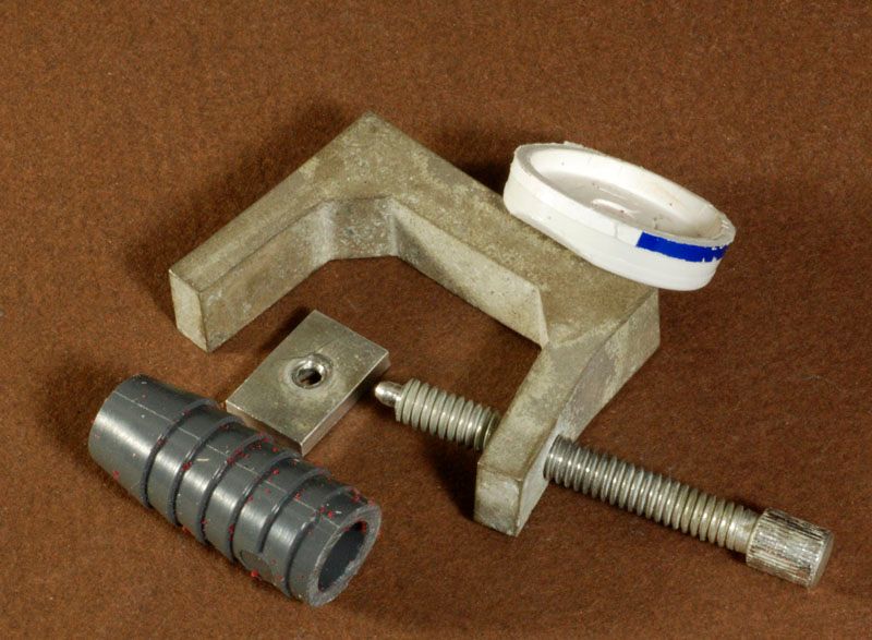

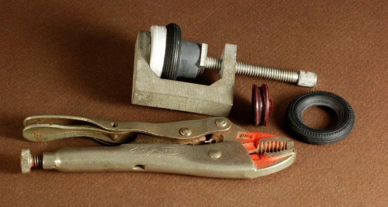

Foxer Posted February 20, 2016 Author Posted February 20, 2016 (edited) I really appreciate all the suggestions generously given and the tires are now off the wheels! I made a press as suggested with a bottom of a pill bottle and a piece of a 3/4 plastic pipe. It all fit in my clamp and most went thru the process well, the hard tire softening under a heat gun as I slowly cranked down on the clamp. One wheel got a bit too hot and deformed but it will not affect the final piece. The original rims will be used only as wheel backs. Some resin rims fit perfectly in the tires from the front. The clamp also deformed on the last wheel with the pivoting end prying lose .. the clamp is dead. Edited February 20, 2016 by Foxer
Kit Basher Posted February 20, 2016 Posted February 20, 2016 ..... the clamp is dead. I've done that before myself, trying to press the center out of a bearing. At least it was the last one, not the first one. Now you have an excuse to buy a better clamp! The wheels and tires look great.
