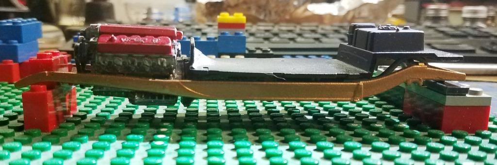

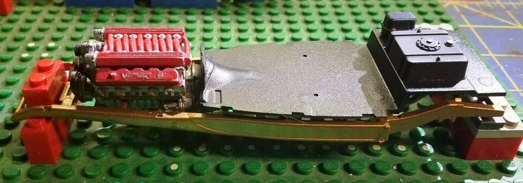

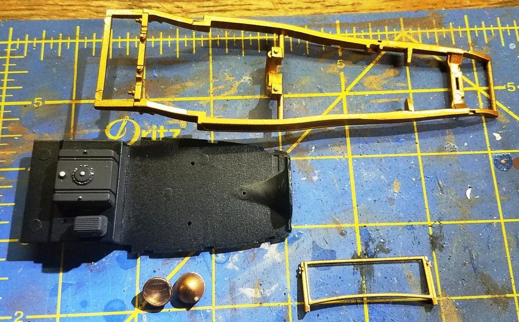

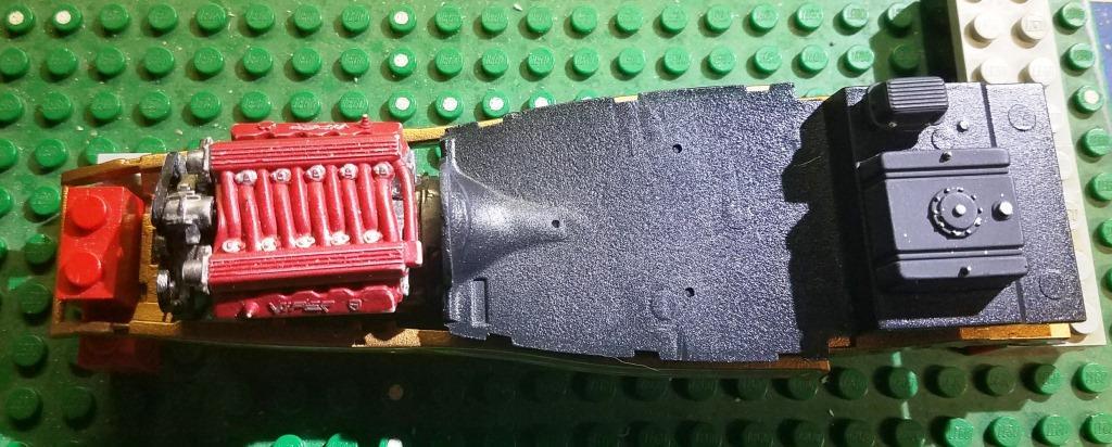

Got a little work on this tonight.  Test fitted the bottom of the body to the frame and installed the gas tank and battery box.
20170405_202206.thumb.jpg.1351c1643c1bf3
20170405_202202.thumb.jpg.839ed07f620535
The engine looks like it sits in the correct spot from the side

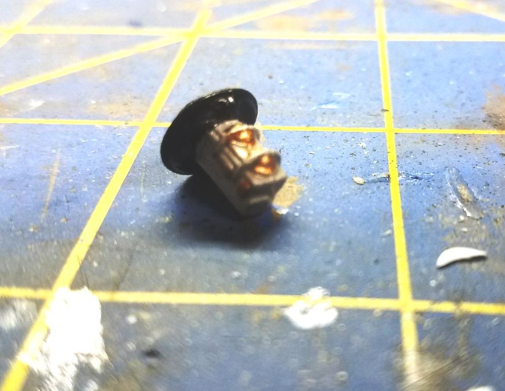

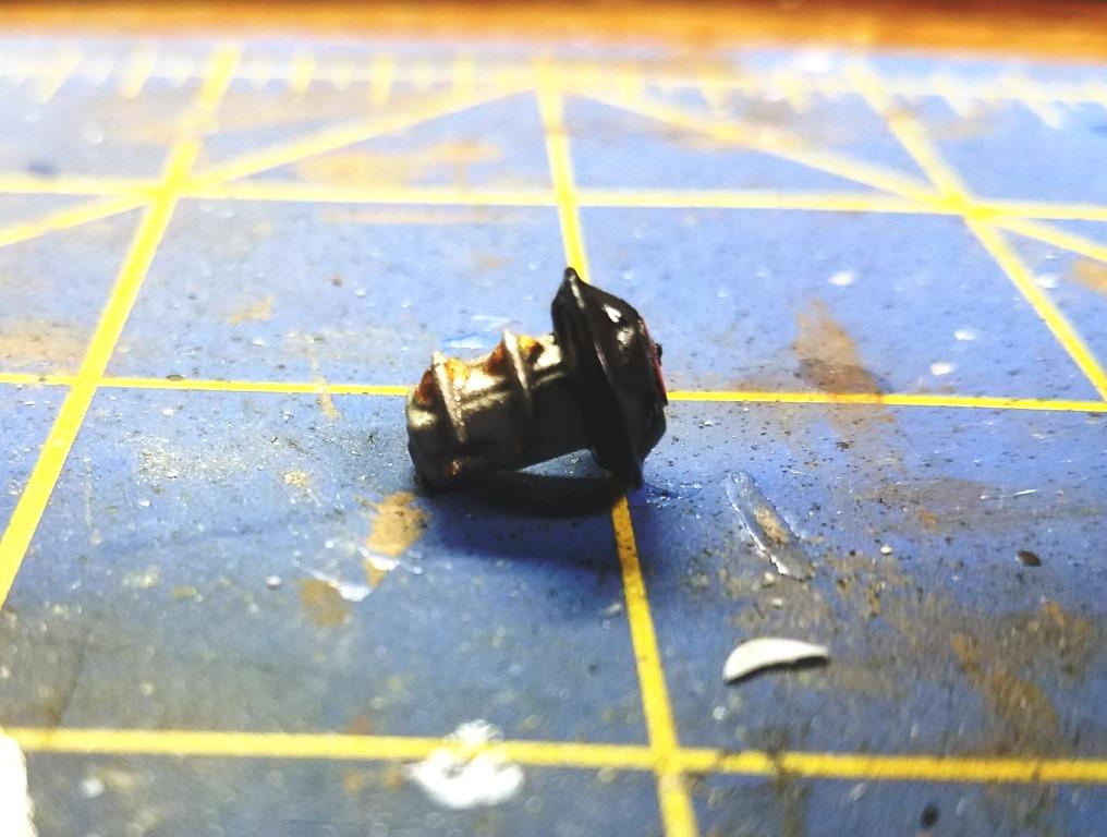

The finished brake booster.
20170405_205101.thumb.jpg.c3e6790ff98232
20170405_205051.thumb.jpg.869c26acc9eac7

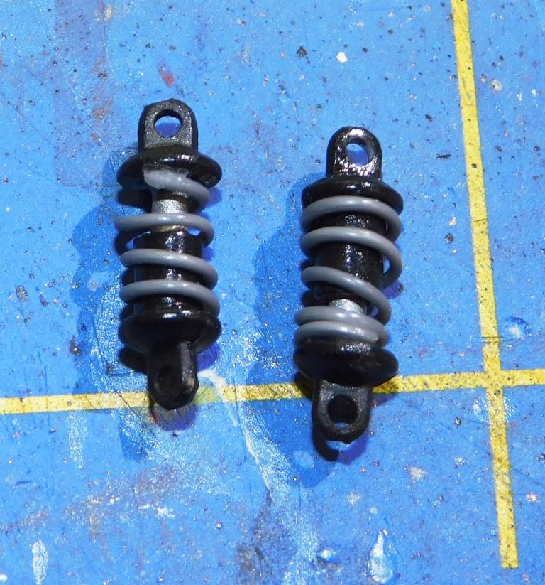

I finished both rear shocks this evening.  They both are functioning shocks.

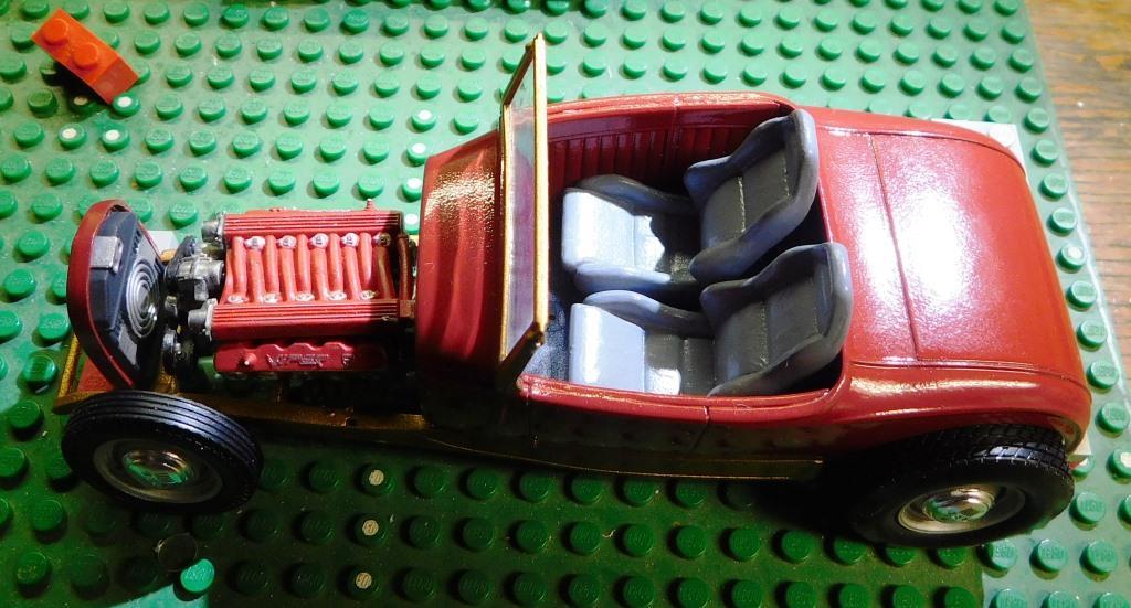

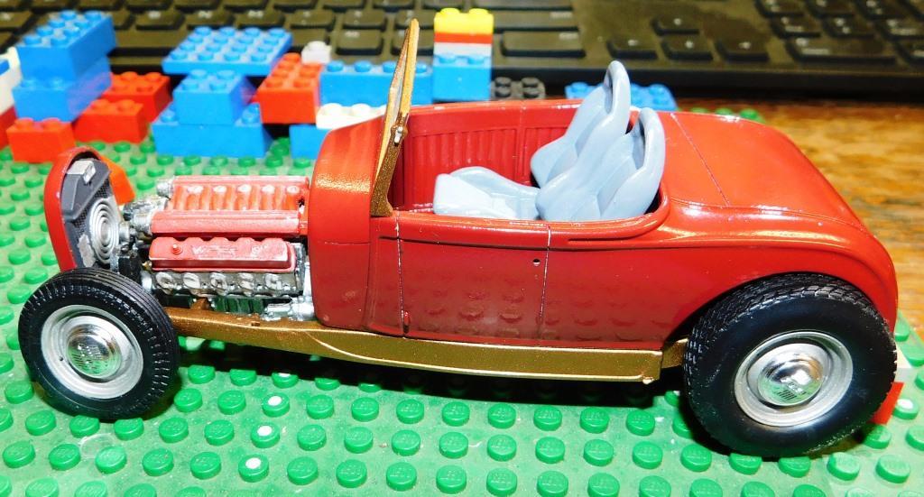

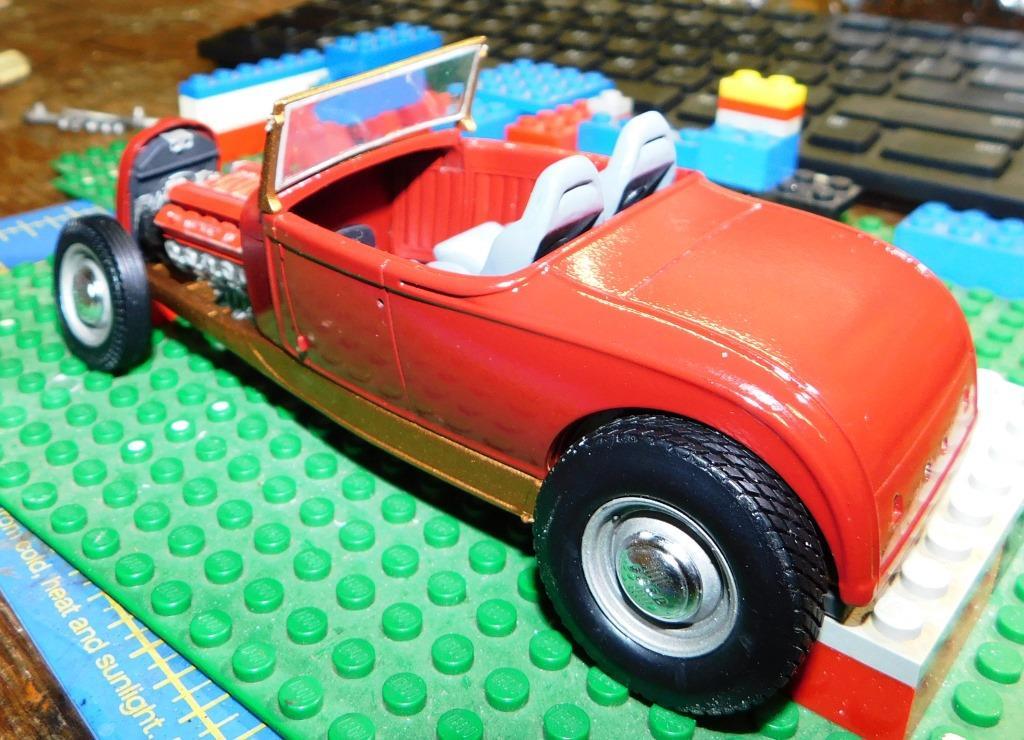

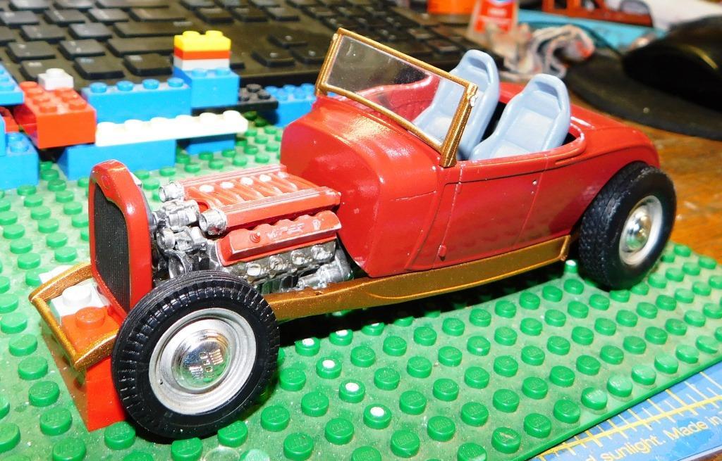

Worked some more this evening.  Spent some time attaching wires and boots to the coils.  After a bit of cussing and wanting to put some tweezers through the wall, because I kept getting glue on them.  I painted the seats a couple of nights ago and decided to take another look at the whole thing together.  I mocked the engine, frame, grill, windshield, wheels and seats.

I was struggling with the grill staying upright.  I was looking over these pictures and I kind of like the grill tilted back a bit.

For your next project: Don't worry too much about the firewall. Get the engine sorted out, and then the firewall can just fill in the empty space around it. Recessed or flat firewalls with indents for the transmission and distributor are extremely common in 1:1 hot rods.
My usual process for fitting an engine: set up the body/frame at desired ride height and angle (can be sitting on axles and wheels/tires, or just on blocks). Place the engine where it looks good in relation to the body and grill, with space for the pulleys and fan, and clearance under the oilpan. The intake manifold should be parallel to the ground (not the frame) and the transmission tailshaft should point straight at the rearend/differential.
Now that the engine is well situated, I note where the new engine mounts will have to be located, and their angle/length, and build 'em. Then a transmission mount to keep that tailshaft in place.
And now...hack the floor and firewall as much as required in order to fit them around the engine and trans!

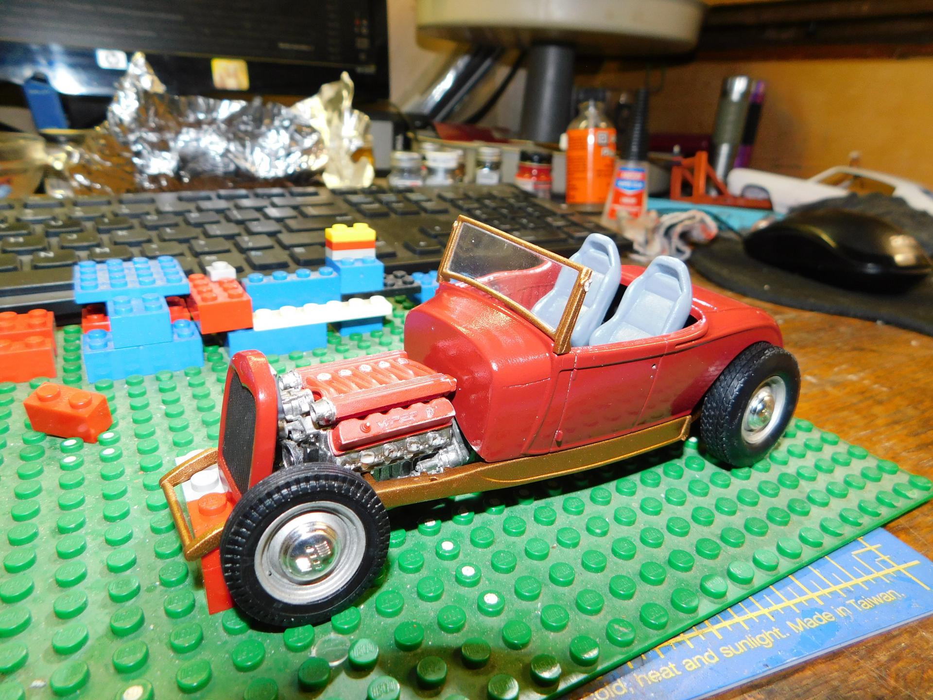

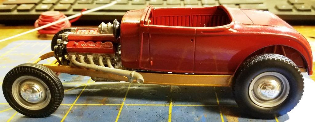

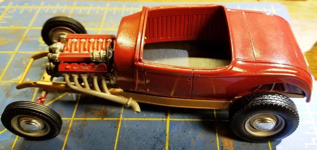

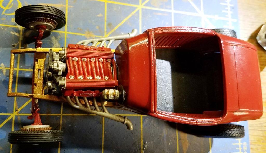

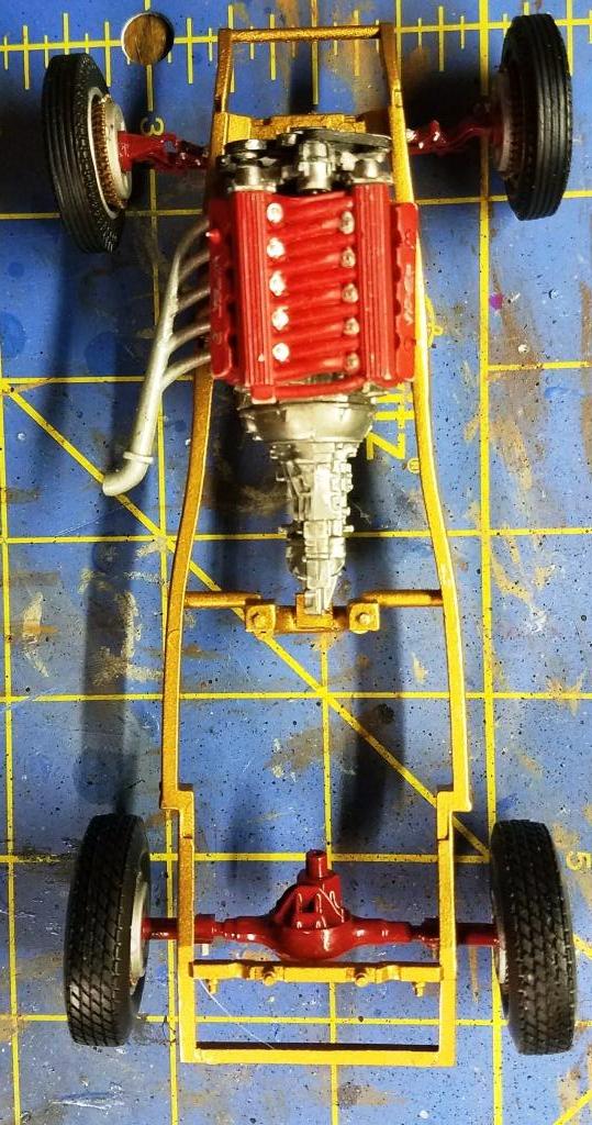

Worked on painting some little pieces on this one tonight.  Just about ready for some assembly.  While I was waiting for stuff to dry and free up space in my dehydrator.  I mocked stuff up... again.  I placed the wheels on (no glue) to get an idea if the engine would clear the ground.  Please don't mind the crooked wheels.
I was also looking at the engine and could not wrap my head around how the exhaust fits, so I put a drop of glue on one of the flanges and placed the header loosely on the engine.

This is a look from the top without the body on
20170414_205305.thumb.jpg.81f10effc69910

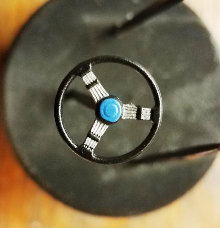

I also wanted to add a little bit to the steering wheel and I came up with this idea that the center of it could be blue like the arc reactor on Iron Man's chest.
20170414_205318.thumb.jpg.88677e56e89693

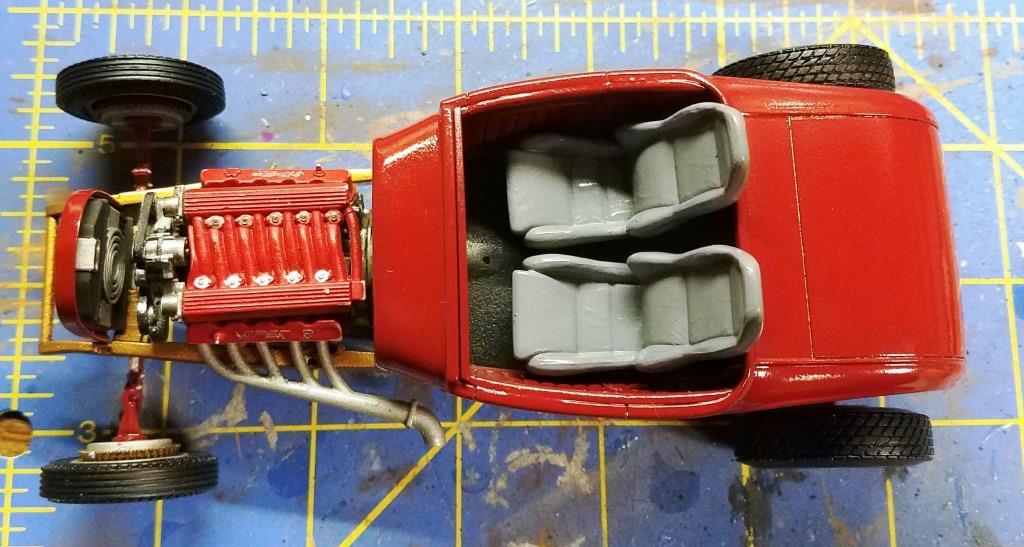

I also was looking at the plain looking grey seats I thought that they needed something also.  So I figured maybe a small Iron Man face as if it was embroidered in the seat.  I have some decal paper and was looking at using one of the two below.
Seat_Emblem.thumb.jpg.94a7620625d3bdad73
Seat_Emblem_B-W.thumb.jpg.539ca7f5cbb3b0

This is a cool build, and I've been following along. I give you credit for the way , when you've come upon an issue, have found your way to work around it.
Just a small nit from me, but would you consider swapping out the seats, or at least modifying them? IMHO, they are far too tall. I know you're probably keeping them because they are from the Viper, so if you could possibly sever the seat at the bottom of the back and remove some of the height. This is just my suggestion.
And, so you can keep the Buick style brakes, but simulate a performance upgrade to discs, there is already a 1:1 solution in place. The aftermarket sells disc brake sets that look like the Buick brakes. On a quick glance the only way to tell is there is a scoop on the backing plate to facilitate cooling. You could replicate this by adding the scoop. Sorry, I don't have an image, but try Googling it.

Good to see someone applying themselves to making a design decision work in a reasonably realistic manner.  Kudos!

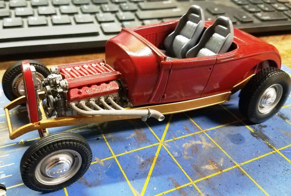

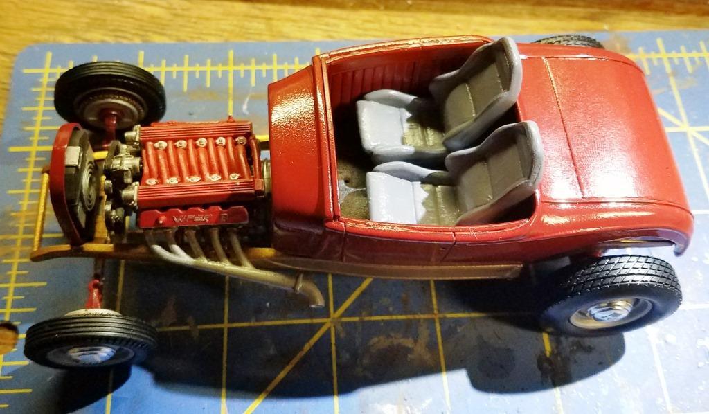

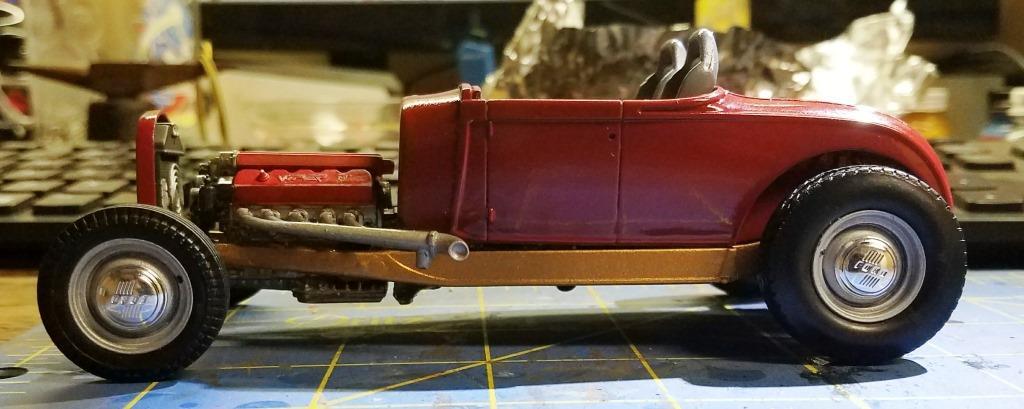

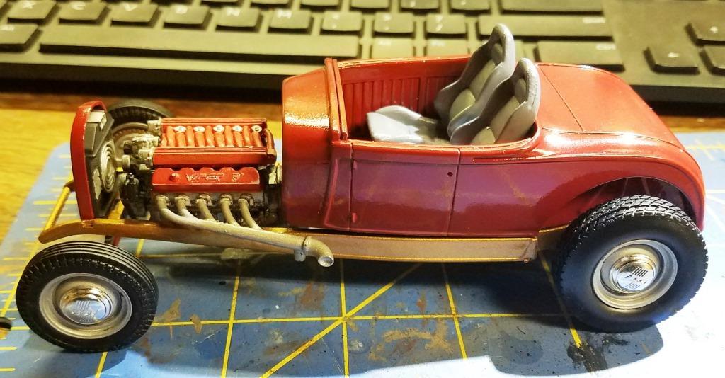

I worked a bit on this one this past weekend.  Have no been getting to much done due to an out of town week-long vacation and my wrist bothering me.

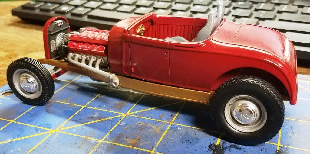

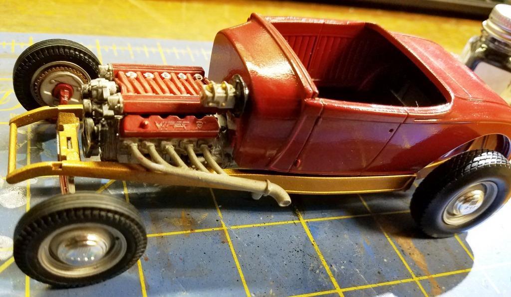

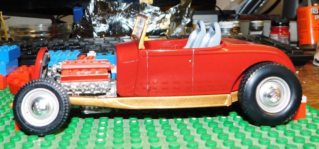

I attached the exhaust to the engine and placed it in the frame to measure it up for the extensions I will need to add before the muffler.  I could have just bent up some styrene, but I have not had too much luck with bending the stuff lately, so I just added to the existing and painted it (in the dehydrator currently).  Below are some pictures of the engine with exhaust in the frame with the body sitting on top.

Mr. Metallic and Jantrix:
Thank you for your input, but I think once the windshield is put on it helps take away from the height of the seats and the look fine.  I don't look at the car being a '29 with a Viper engine.  I look at it as being something that would happen if a '29 Ford and a 90's Viper spent too much time alone in the garage together ;).
