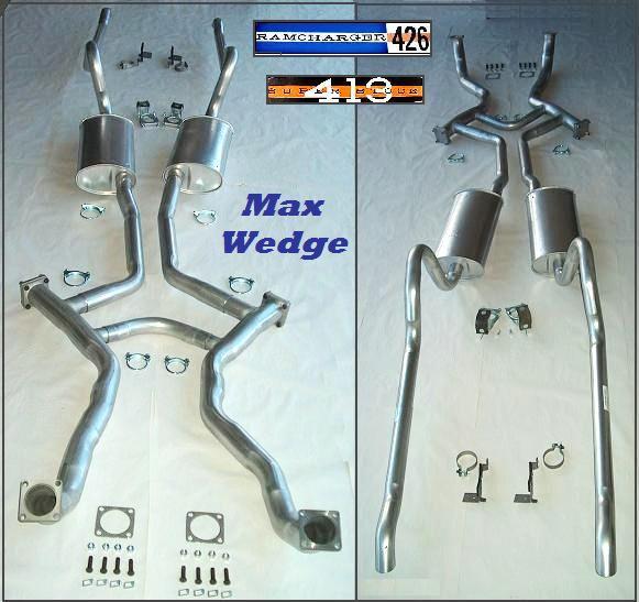

Jon Haigwood Posted February 25, 2016 Posted February 25, 2016 Looking for a exhaust set up like this for a Max Wedge Mopar Thanks
DR JAY Posted February 25, 2016 Posted February 25, 2016 ...You and me both. BUT--from what I have gathered and seen in pictures, the soon to be released 1965 Belvedere from Moebius will have some pretty sweet Max Wedge manifolds as well as the dump tube exhaust. I have one reserved at my LHS for a build I'm doing now. I'll try to find the post...here it is
69NovaYenko Posted February 25, 2016 Posted February 25, 2016 (edited) On page two of the thread `65 Plymouth Hemi Super Stock "Melrose Missile" Moebius/Model King which is found in the Car Kit News & Reviews section; Dave Metzner posted test shot photos of Moebius soon to be released `65 Plymouth Belvedere I. The kit will feature the factory dual exhaust Max-Wedge exhaust system with cut-outs that you are seeking. The Moebius`65 Melrose Missile kit will feature factory Hemi headers with cut outs in a single exhaust configuration. Here`s a link to the page: http://www.modelcarsmag.com/forums/topic/109184-65-plymouth-hemi-super-stock-melrose-missile-moebiusmodel-king/?page=2 Hope this helps. Edited February 25, 2016 by 69NovaYenko
Mike Kucaba Posted February 25, 2016 Posted February 25, 2016 If you can't wait, the same exhaust is in the Polar Lights "65 dodge Pre-painted kit.
High octane Posted February 25, 2016 Posted February 25, 2016 They are in the new '65 Belvedere Sedan kit as I saw one of the test shots last Saturday at a club meeting, and like MIke says you can also find them in the Polar Lights '65 Coronet kits as well.

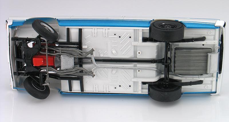

gtx6970 Posted February 26, 2016 Posted February 26, 2016 Max wedges cars used a single head pipe Hemi cars used the snake looking setup with 4 pipes per side as shown above The Hemi dint come out till mid year 1964. So the max wedge was still avail the 1st part of 1964.But was long gone by 1965

Force Posted February 26, 2016 Posted February 26, 2016 (edited) Max wedges cars used a single head pipe Hemi cars used the snake looking setup with 4 pipes per side as shown above The Hemi dint come out till mid year 1964. So the max wedge was still avail the 1st part of 1964.But was long gone by 1965That's why I thought the engine choice in the Polar Lights 65 Dodge kits was a bit strange, they should have had the Hemi instead of a Max Wedge for the racing version. Edited February 26, 2016 by Force

gtx6970 Posted February 26, 2016 Posted February 26, 2016 For the max wedge exhaust , use the aforementioned Polar Lights Dodge stuff. For the Race hemi , either find a set from a Johan kit Or wait till the Melrose Missle car hits the shelves
